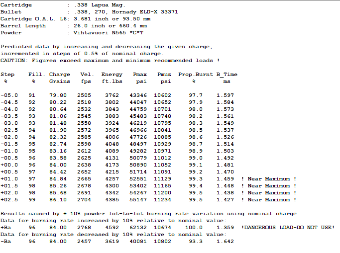

Has anyone here loaded the 270gr ELD-X with N565? doesn't seem to be any data online for this combo. Vihtavouri website has data for 250 and 300gr but no 270.
Vihtavouri has min 80.4grs to max 90.3grs for the 250 scenar and min 77.2grs to max 84.9grs for the 300 scenar.
Should I just split the difference and start around 78.5grs with the 270? Onviously I plan to work up slowly to find pressure.
Loading for a Desert Tech SRS 26" 1:10tw barrel
Reactions: JimJones65
N565 is good for that mass range of bullet.
Here's a QL prediction...

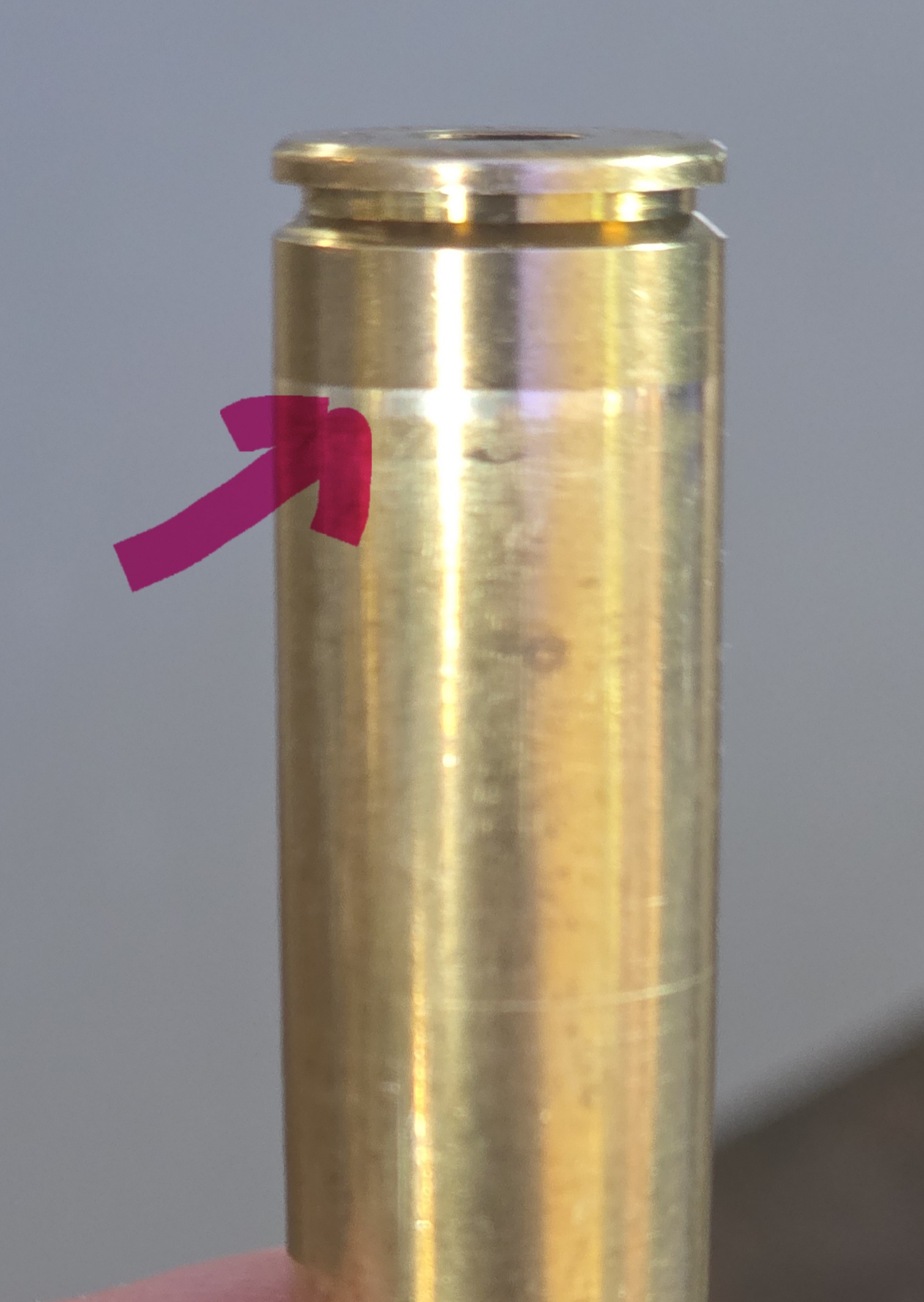

Have a dilemma and can't solve.
I have been reloading for a very long time and very successful at it,......for the most part. Shot in many competitions with my reloads and have done well. Reloaded 30 different calibers.
My one issue is 338 Lapua. I have been fighting with it for 15 years. Not accuracy but the cases don't seem to resize near the web.
Factory new case is around .5830" just north of the extractor groove . It tapers down to .5770 at what I call the web, about .1750" from extractor groove.
A once fired case (factory Berger) has the measurements at .5830" and .5820" at web. A growth at the web of .0050-.0060. No problem there just fitting the chamber. The problem occurs after second firing. That web area expands(bulges) again out to .5840-.5850. Once they get to .5850" they don't chamber without a fight. Extraction wise I have to smack the bolt to get them out and take some light force on bolt to push down.
Now this is with very light load like 92 gr of RL-33 or 85 gr H1000. Even heavy loads I have exact same results. Using berger and Lapua 300gr Bullets makes no difference. Loaded .02" off lands.
I have the Redding Type S Match reloading dies. Full length and body only. Same results with both. It doesn't resize this area at all. Shoulder gets bumped perfect but that bulge doesn't go down. The dies and the press (Rockchucker) are the only commonalities in this whole thing but there are 2 different ones giving same results(dies).
Things I have tried. Bought a newer Desert Tech , competition shell holders, annealing, different lubes, over camming, and probably many others. Most frustration thing ever as It shoots lights out and I have had it out to 2470 yards. Just cant use the cases past 2 or 3 times depending on how much it bulges.
Put sharpie on bulged case and it definitely catching (tight) right at the web.
Do other peoples dies resize in this area??? Is it simply that i have 2 bad Redding dies??? Was going to buy a foster and try next.
Any help would be much appreciated. This is very frustration and getting expensive buying cases every 2 or 3 rounds.
This picture is after I overcammed the hell out of the press just trying stuff. The arrow points at my problem area that doesnt resize at all.

You haven’t mentioned which rifle this Is in?
I have my suspicions especially when you mention that you have been fighting it for 15 years but I’ll wait for your reply.
I’ve only shot Lapua brass in my Savage 110BA without issue.
It is in a Desert tech. Both in an original and an A1. 2 different barrels. Apparently chamber is too tight.
Most likely going to have a custom die made or buy the roll sizer. Seems to be only fixes.
Have you tried different brass?
If chamber too tight, why not get it reamed?
Tried different brass.
Actually think I fixed my problem. Its Redding dies. Have FL and body die match S. Used my el cheapo rcbs I just got. Went and shot today. No problems with extraction . Don't know if Redding had a bad run way back or they are just loose.
OK, I’m glad you got it figured out. I am on my fourth 338 barrel for DT, and the first three were done with a DT Reamer, the first one a factory barrel and the next two with DT specified reamers. Sounds like your guy might have been out of spec as you haveinferred. The problem I had was my 338 in my first or second barrel was inadequate, shoulder, bumping leading to false pressure signs and difficult extraction.
This is my 2nd DTA 338 barrel. Both had the same problem. Figured might be a problem with their reamer.
They are not known for QC, and have had ENTIRE BATCHES of botched chambers and had to outsource chambering of certain calibers at one point :-(
So it wasn’t a bad guess. These days, I buy my own reamers for many calibers and have an expert gunsmith chamber them

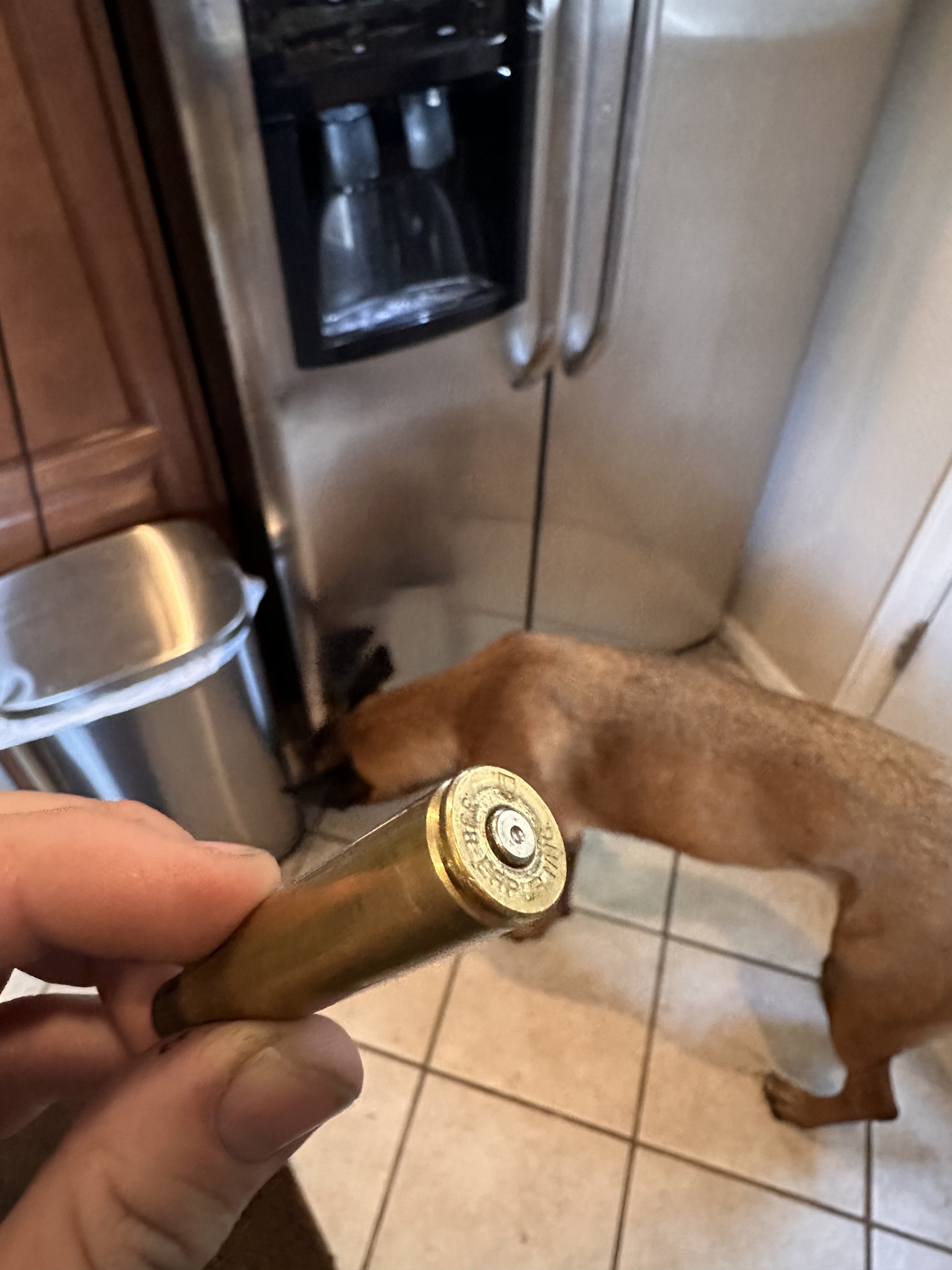

Is 2.925 base to ogive seated too low and thus over pressure using 88gr retumbo, 300gr Berger, and out of a 30 inch barrel with suppressor…??
Velocity was 2,735 - it chambered fine, but was harder than hell to lift open.

Too deep is more of a pistol concern. Generally, too long is the rifle concern. Contacting the lands tends to lead to pressure spikes.
If you’re getting hard bolt lift, 88 grains of Retumbo with a 300 grain bullet is borderline in your rifle.
