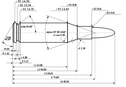

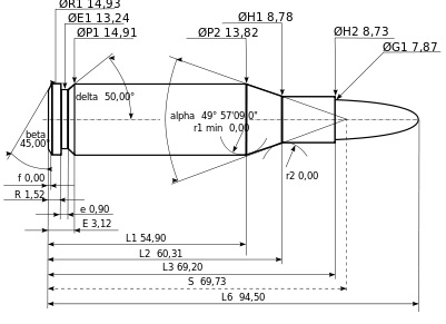

Btw: Even on the Wikipedia page: .338 Lapua Magnum - Wikipedia, the free encyclopedia ; within the first 4 words, the sizing is noted:
The .338 Lapua Magnum (8.6×70mm or 8.58×70mm)

MOST gunsmiths chamber the rifle to 8.6...In fact, the AI, Barrett and any other .338 factory rifle I could find, are chambered at 8.6...Why? 8.6 takes out 90% of the guesswork and even if you shoot the 8.58 in an 8.6 chamber, you're still good to go.
Ultimately, I really don't understand why we're sitting here, debating over 2mm...Just re-seat your rounds. The performance is the same minus a few semantics. However, once again, had your rifle been reamed to 8.6, as it should have been to begin with, we wouldn't be having this conversation right now and you wouldn't have the need to send anything back.

Masked, you don't seem to understand metric designations. The 8.58 and 8.6 refer to the bullet diameter. The actual metric diameter for a .338 is 8.5852mm. The 8.6mm comes to 0.338583". The 8.61mm shown in the .338 Lapua Magnum maximum C.I.P. cartridge dimensions comes to 0.3389764". The 70 is the case length. The 8.6x70 is a rounded up metric designation. Why there are different metric designations floating around, who knows? They all use the same diameter bullet. The only difference between CIP and the non-CIP length cartridges that were loaded to fit the original AI rifles where the overall length the bullets were seated to. Edit: E Bryant beat me to it....

In my experience with the 338lm, the primary issues I experienced were issues in regards to seating/length, thus my comments, however, you are correct because, there is a sleight variation in the cases...So, I apologize, I was incorrect.
Saami vs. CIP
That being said, the CIP cartridge is actually slightly longer than the Saami...
I do agree w/the second half of your statement.
the easiest fix is to seat the bullets deeper, sound like the rifle was built on original specs of the .338 lapua where it was seated in deep, as I understand it the CIP mag is relatively new, plus you cant just switch chassis forcing the bolt close will add much greater wear to the throat than normal taking away the accurate life of the barrel faster, I do believe defiance offers a CIP length mag cut but you have to specify when you order your action, and yes you can use a 300gr. with ether configuration of the bullet
Saami vs. CIP
Oye, I addressed this a bit, above.
As I said as well, my primary experiences revolving around the cartridge were of length. I didn't realize the two were actually necked differently.
I was incorrect and I thank you for being informative. :)
Hey, no problem. I think what's causing a lot of confusion is these various, incorrect dimensions that are being posted on the internet. That attachment labeled as 338LmCIP has bullet and neck dimensions that are way off. They list the bullet diameter as 7.87mm which is 0.3098425" and a neck diameter of 8.78mm at the shoulder which is 0.3456693". That print is for the 300 Lapua Magnum and would never work for the .338. The thing to remember is that CIP and SAAMI bullet and neck diameters are the same, just overall length is different.
Huh?
That CIP drawing looks wrong.
CIP OAL is 93.5, not 94.5 - actually the supposed 'CIP 338' shows the bullet diameter as .308 calibre.
Sorry - badshot beat me to it...
I still have never seen a SAAMI .338 LM drawing - anybody got one?
