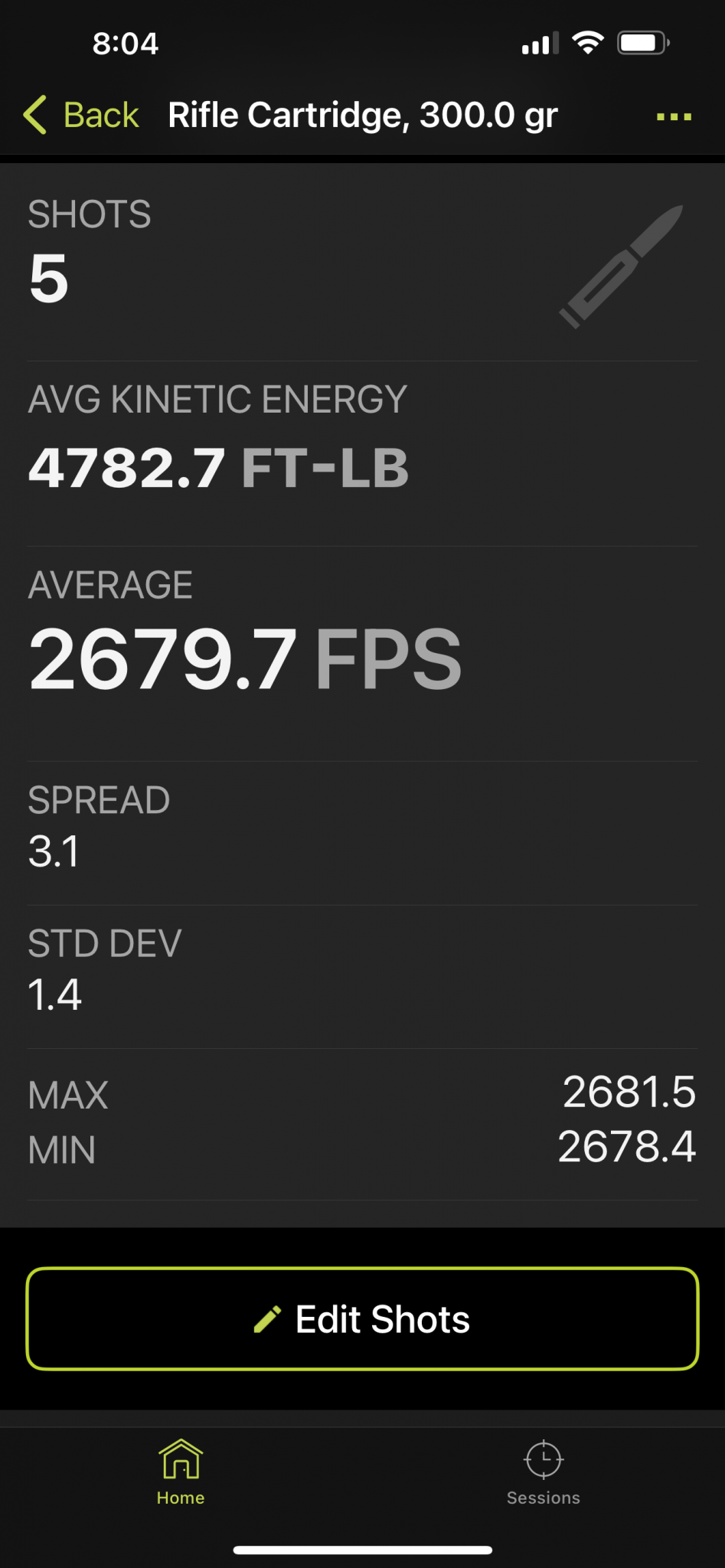

What would you all think about starting at 85.0 gns of Retumbo with 300 gn Berger OTMs in a 30 Barrel with an additional 9 inches suppressed?
We ran the 300 grain SMK’s over 89.7 grains of Retumbo and got 2,760 FPS with no pressure signs. I’d start closer to 86 grains with the OTM’s and work up. YMMV
H1000 85gr / 300gr OTM.
I took this load for 1905yards w/ 20” plate. Very good result.
