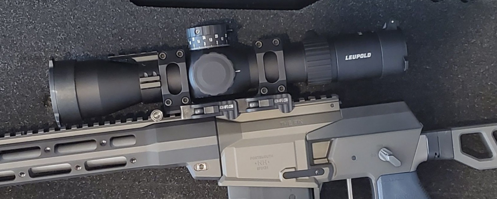

i'm using a bobro engineering dual lever mount on my .308 and so far it has be great and held zero very well after taking it off and putting it back on several times. not particularly cheap but less that a spur mount i think,
Well the votex rings look nice but dont fit an ar10 the scope rubs on the rail. Waiste of time and money. I bought the 1.26 which was the tallest I saw offered.
For the time being it will live on the 308 upper until I build a 6.5 then it will live on that upper. I was wanting to stay under 200 220 ish, but looks like the newer generation of mounts and rings are more then they were 5 years ago... oh well on to the next attempt.

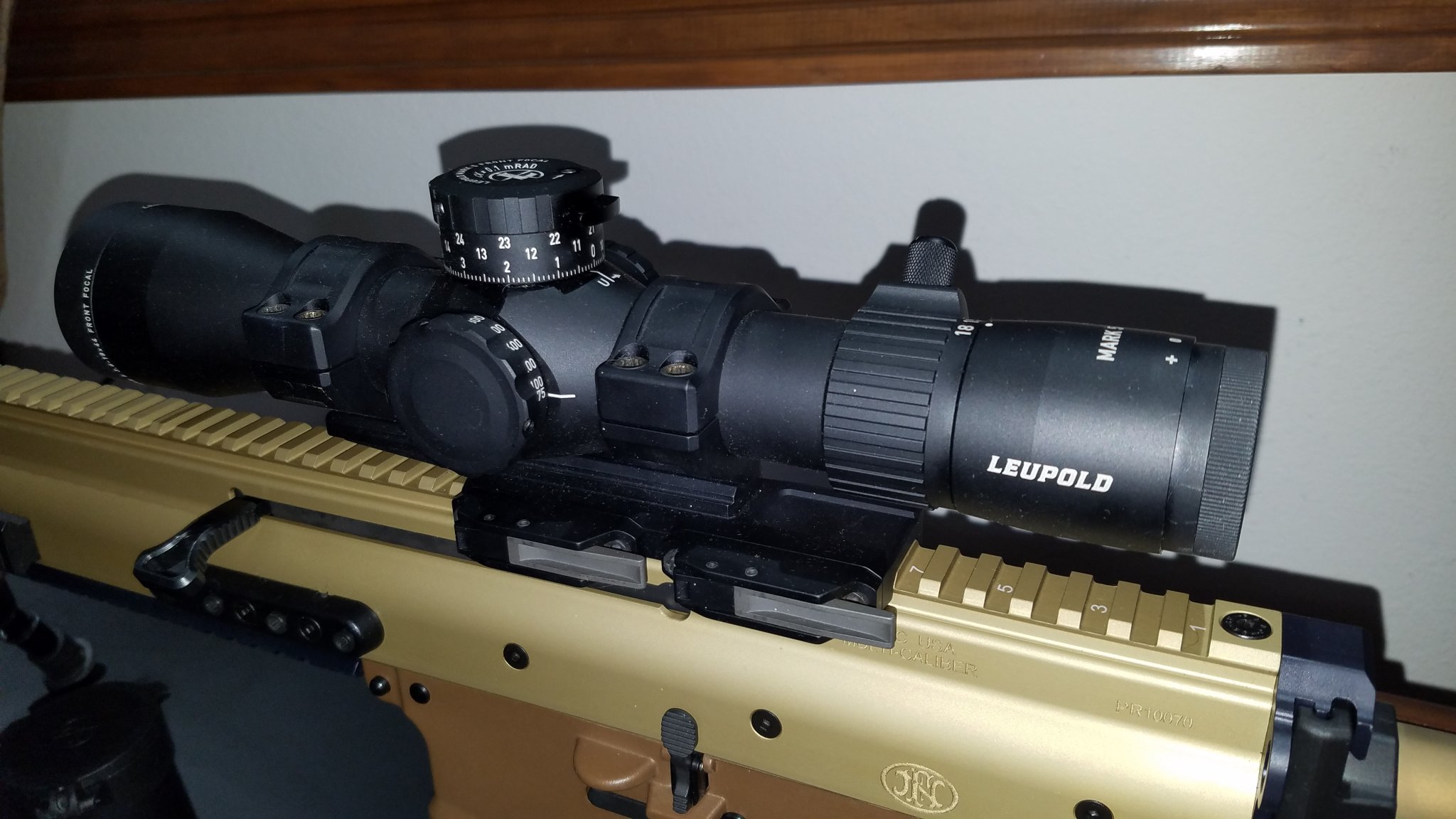

I bought a 35MM ADM Mount for my MK V. I had it on my AR10 and then moved it to my Fix. I have 3 others in 30mm and have never had a problem with them. The other nice thing is that ADM will sell separate ring portions if you want to adapt the mount to other scope tube diameters.
7118790
Reactions: theLBC
here is the bobro dual lever.
more than your budget, it keeps zero very well for a QD and you could use the same great scope on more than one rifle without too much hassle.
7118792
