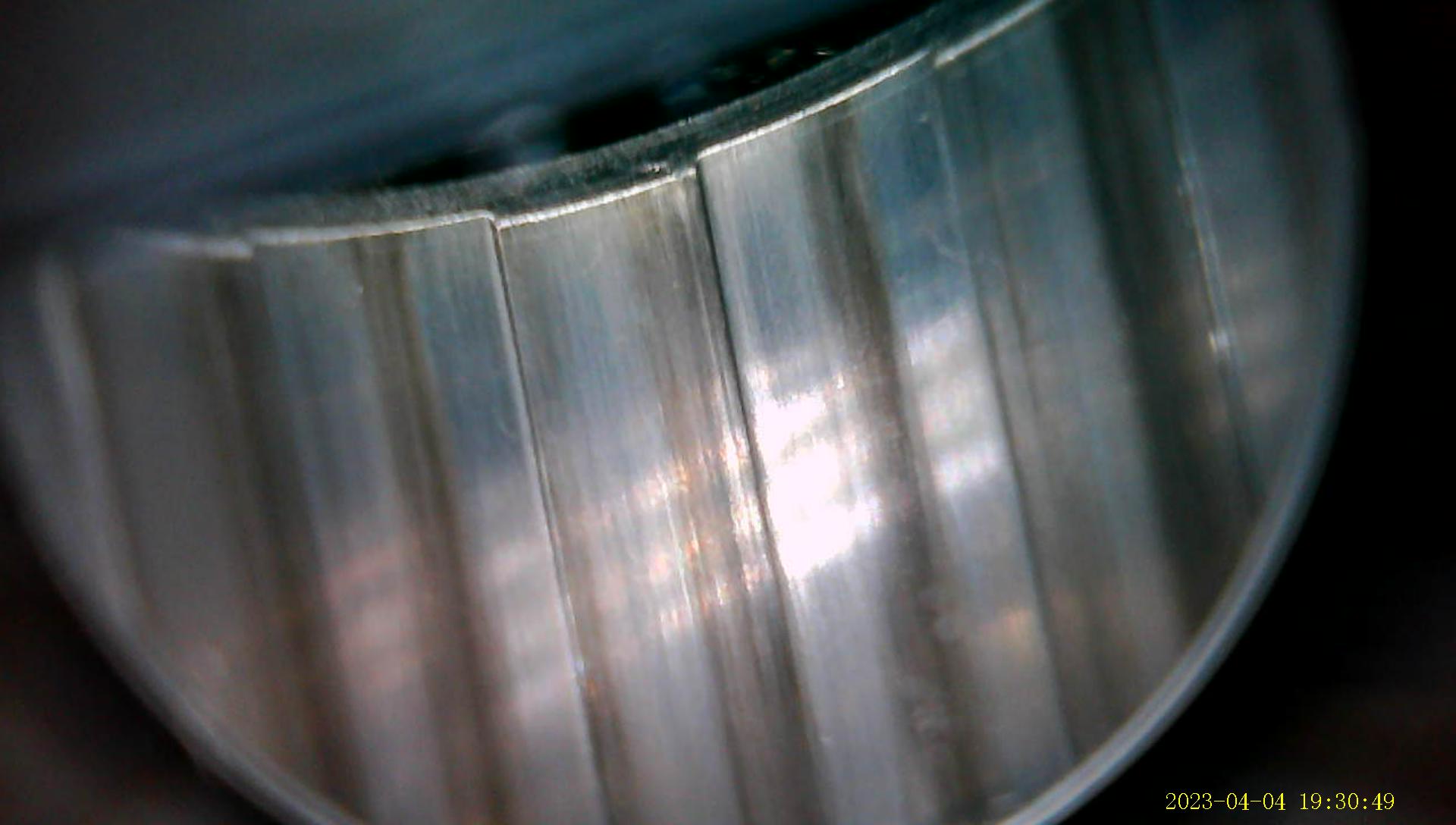

My BB is looking noticeably better than my previous barrel with the same round count. That’s the best I can give.

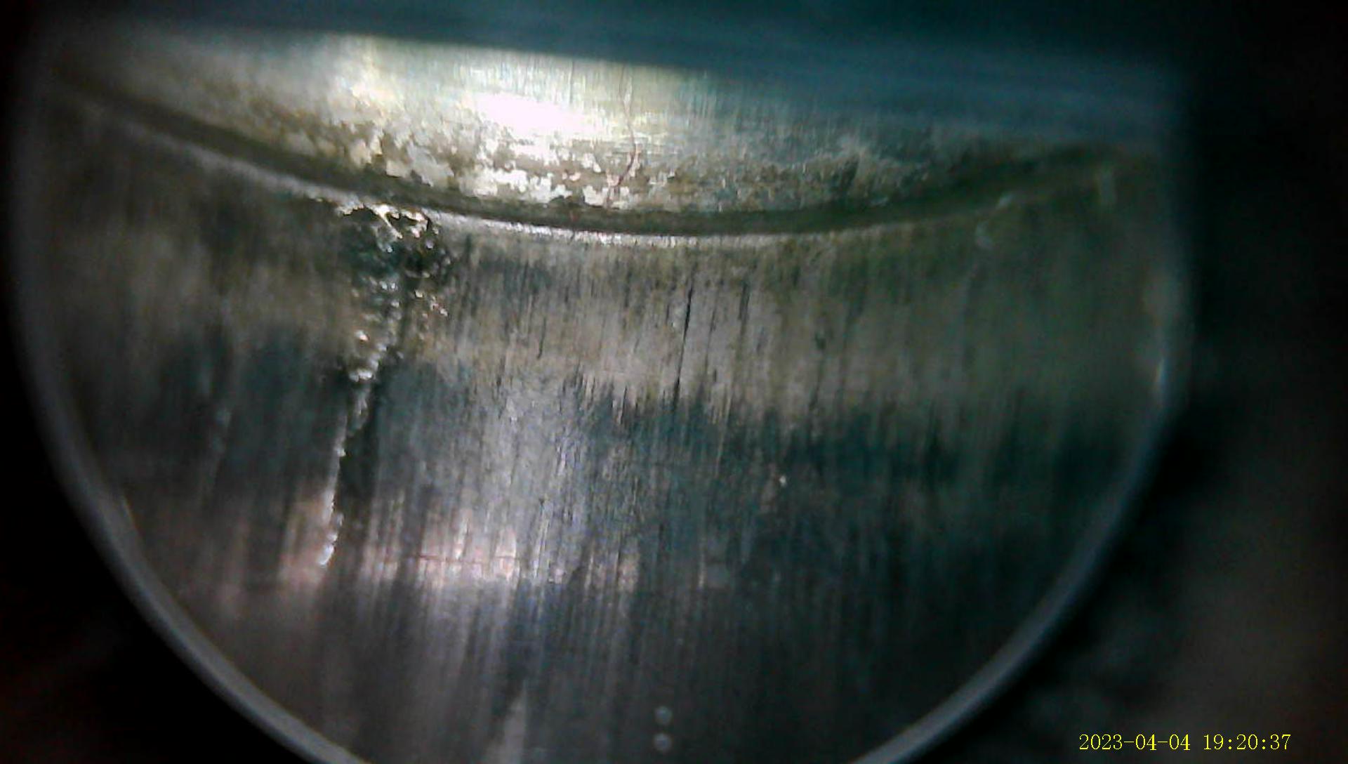

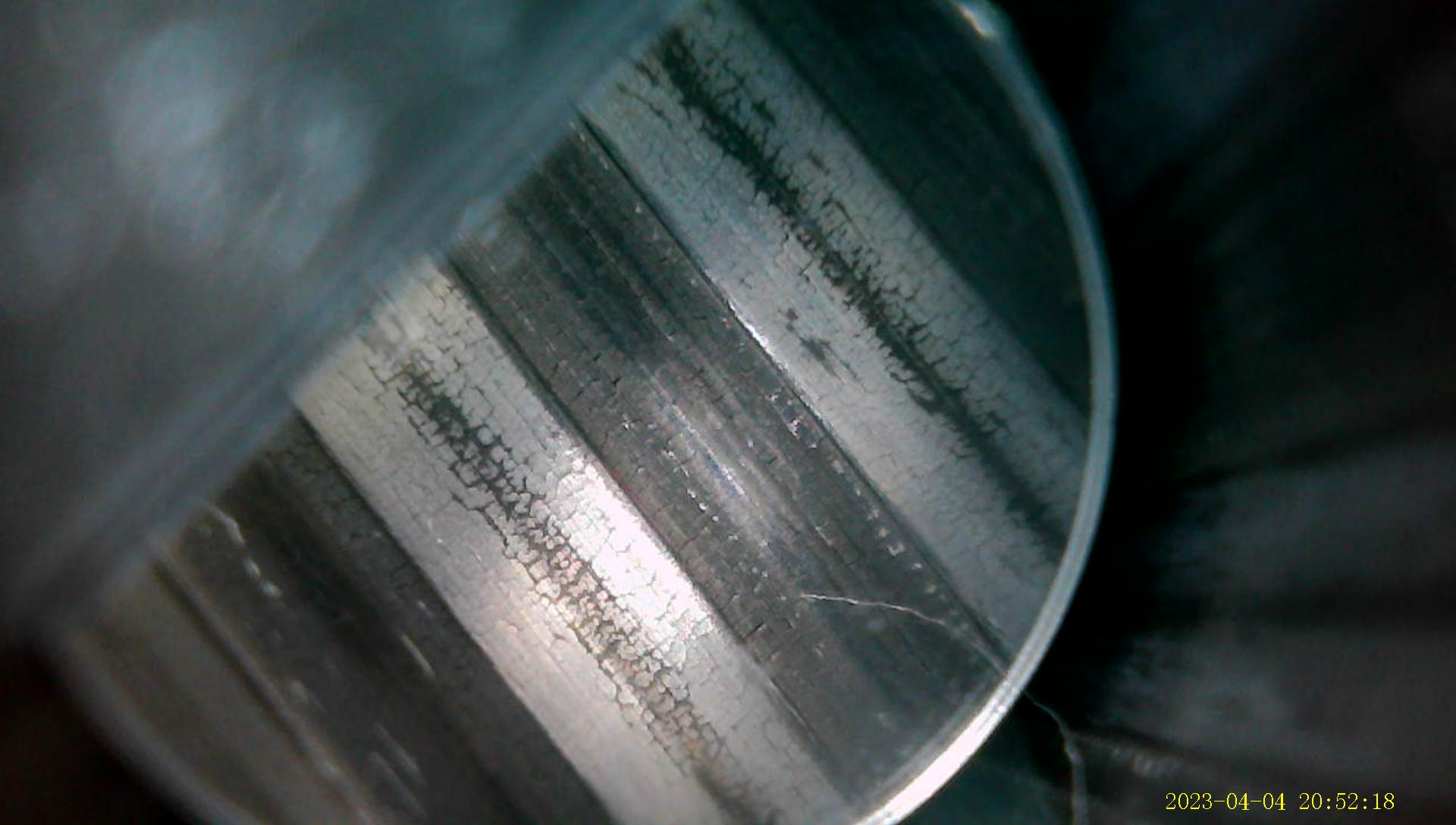

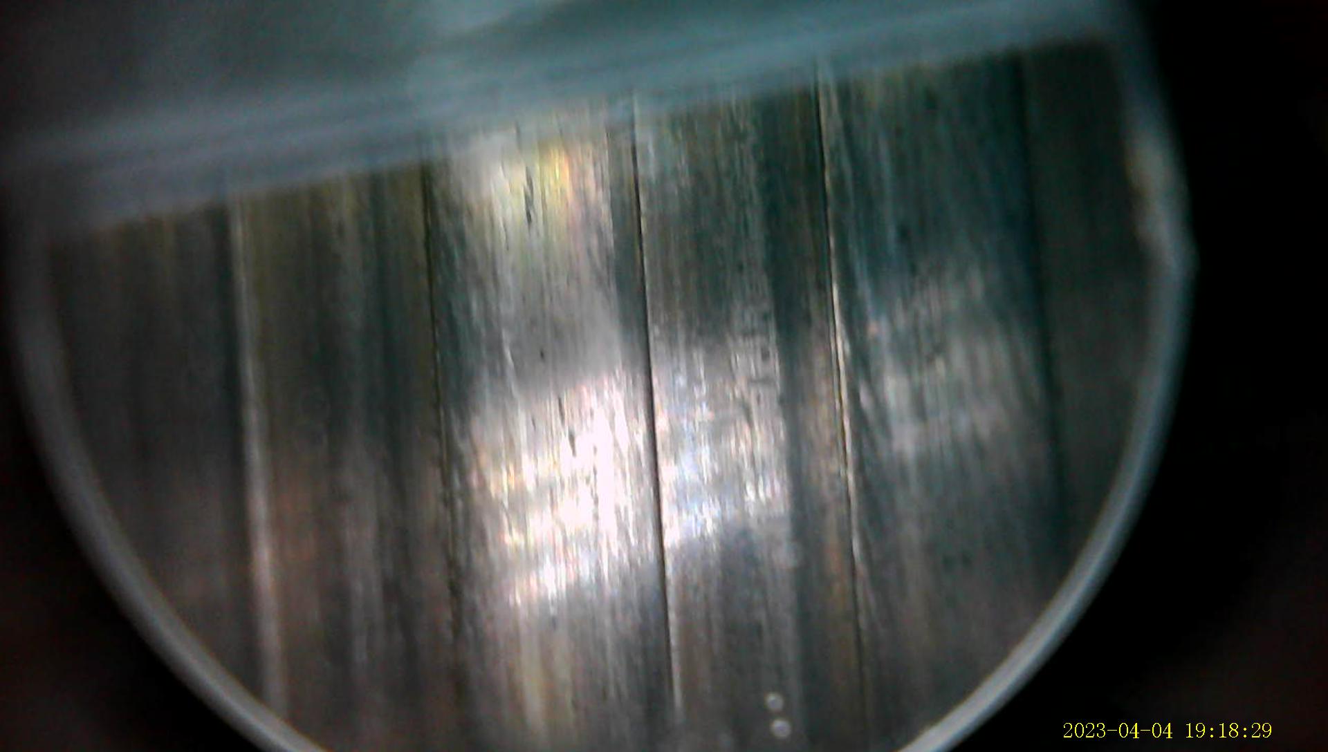

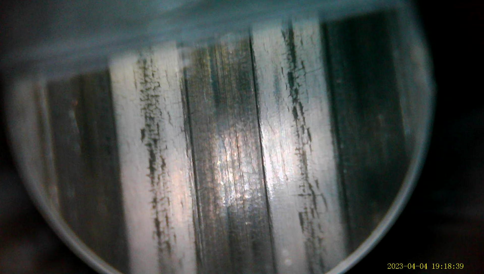

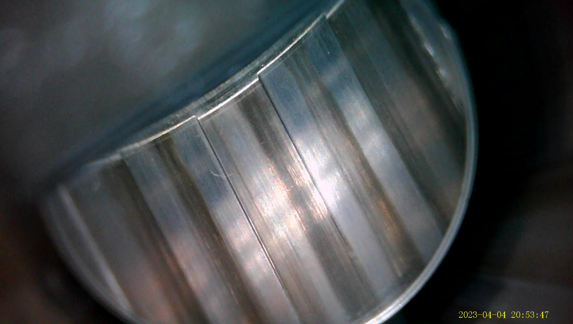

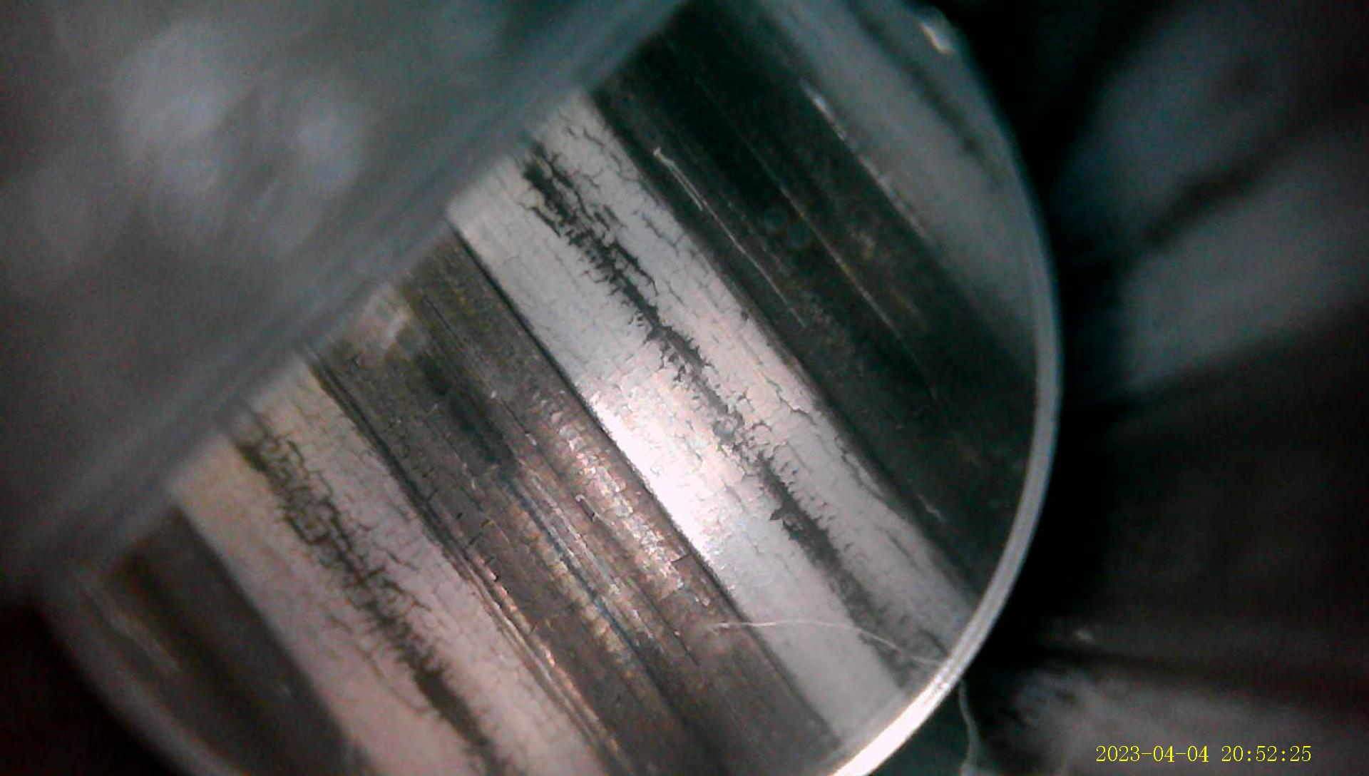

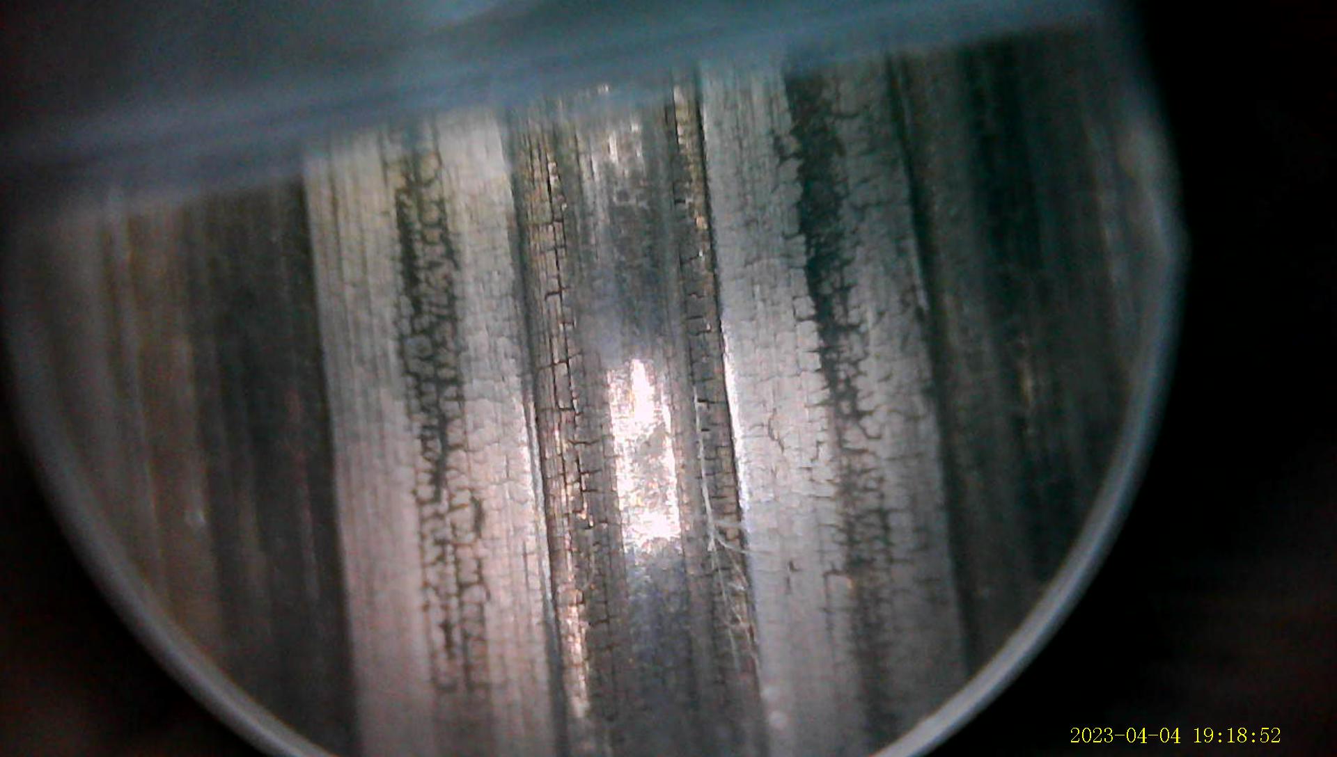

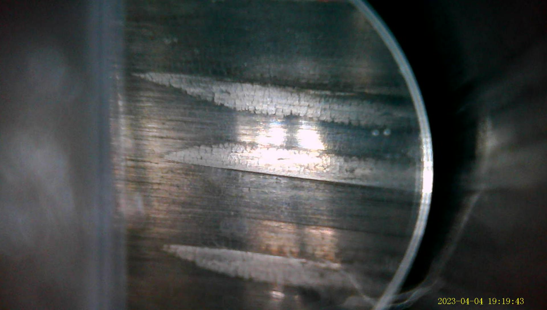

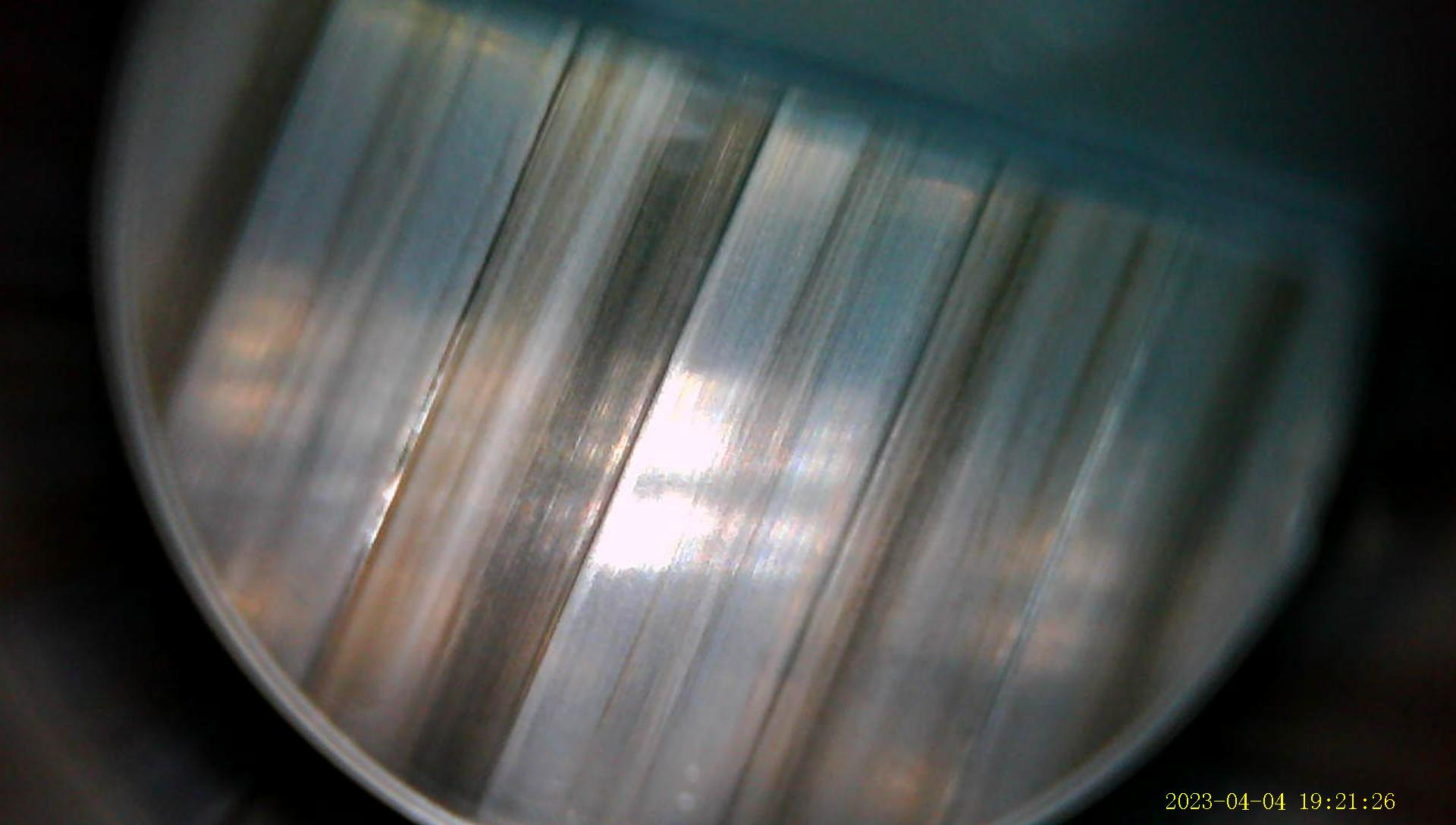

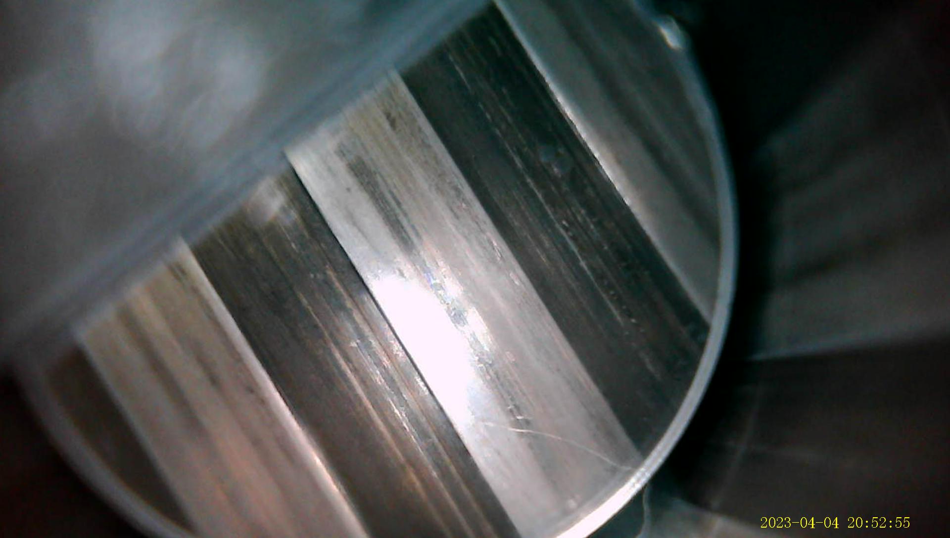

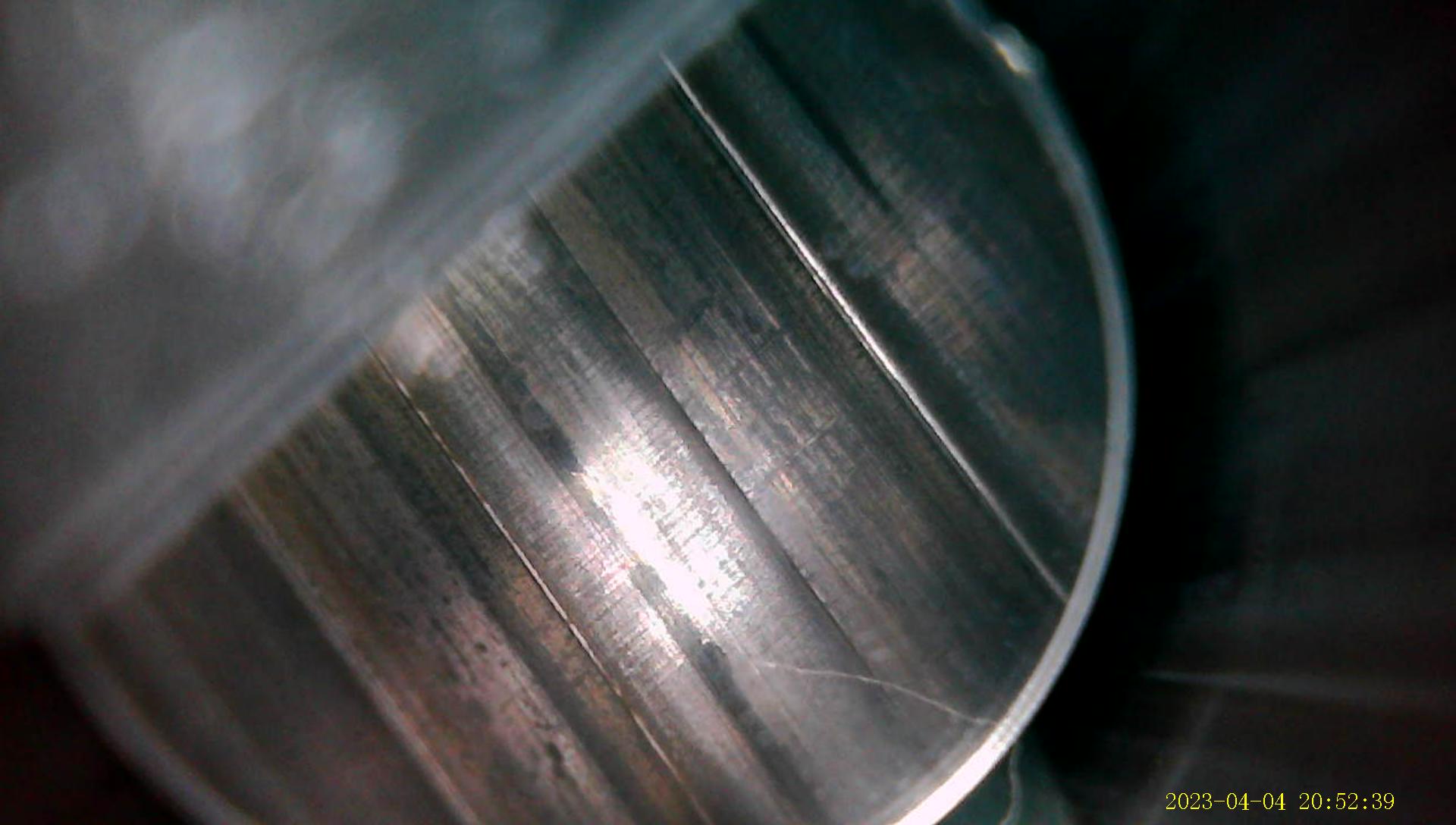

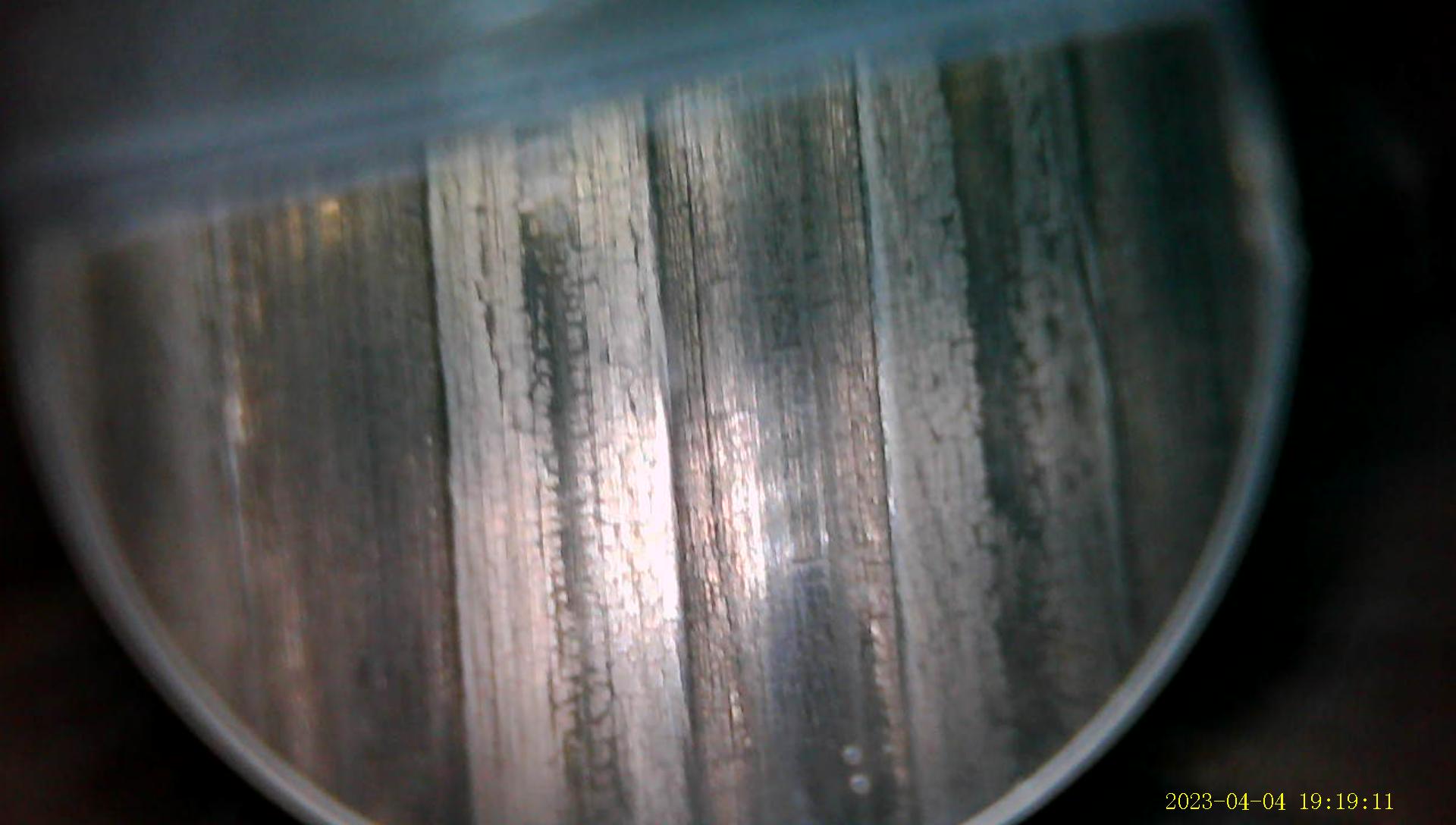

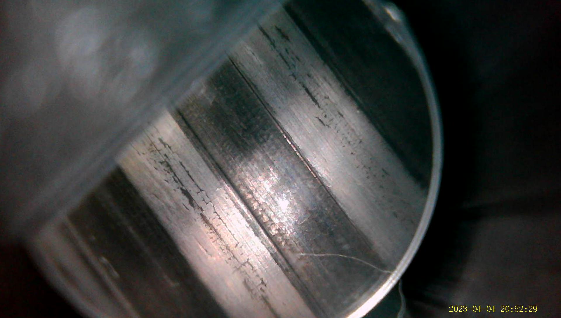

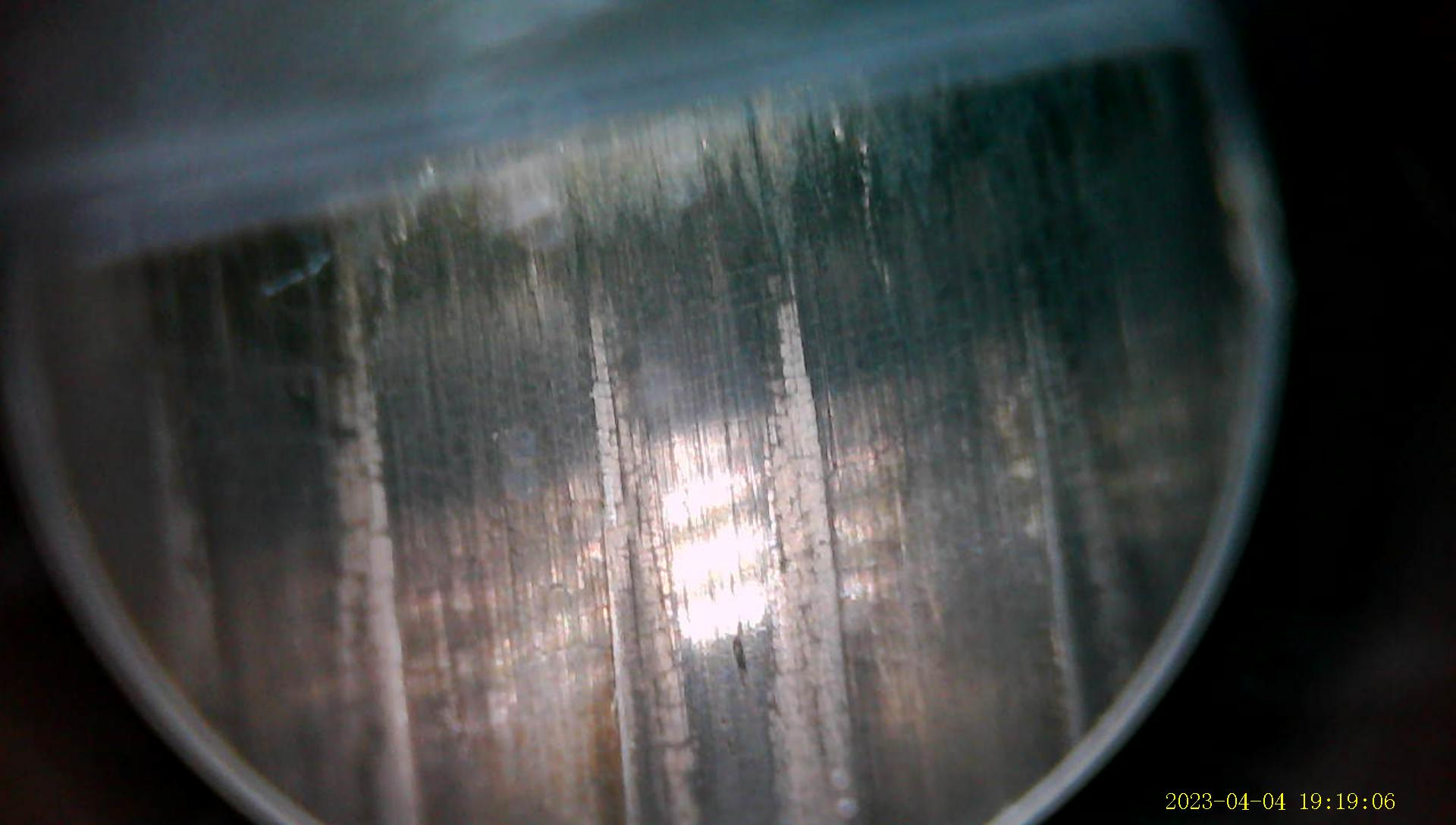

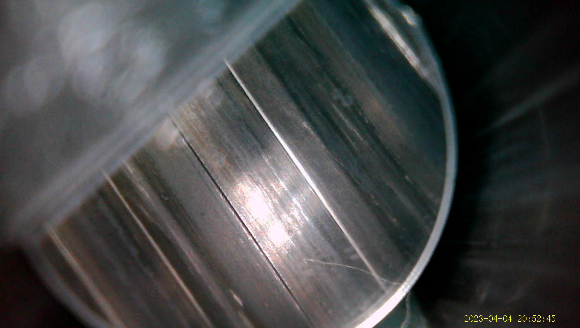

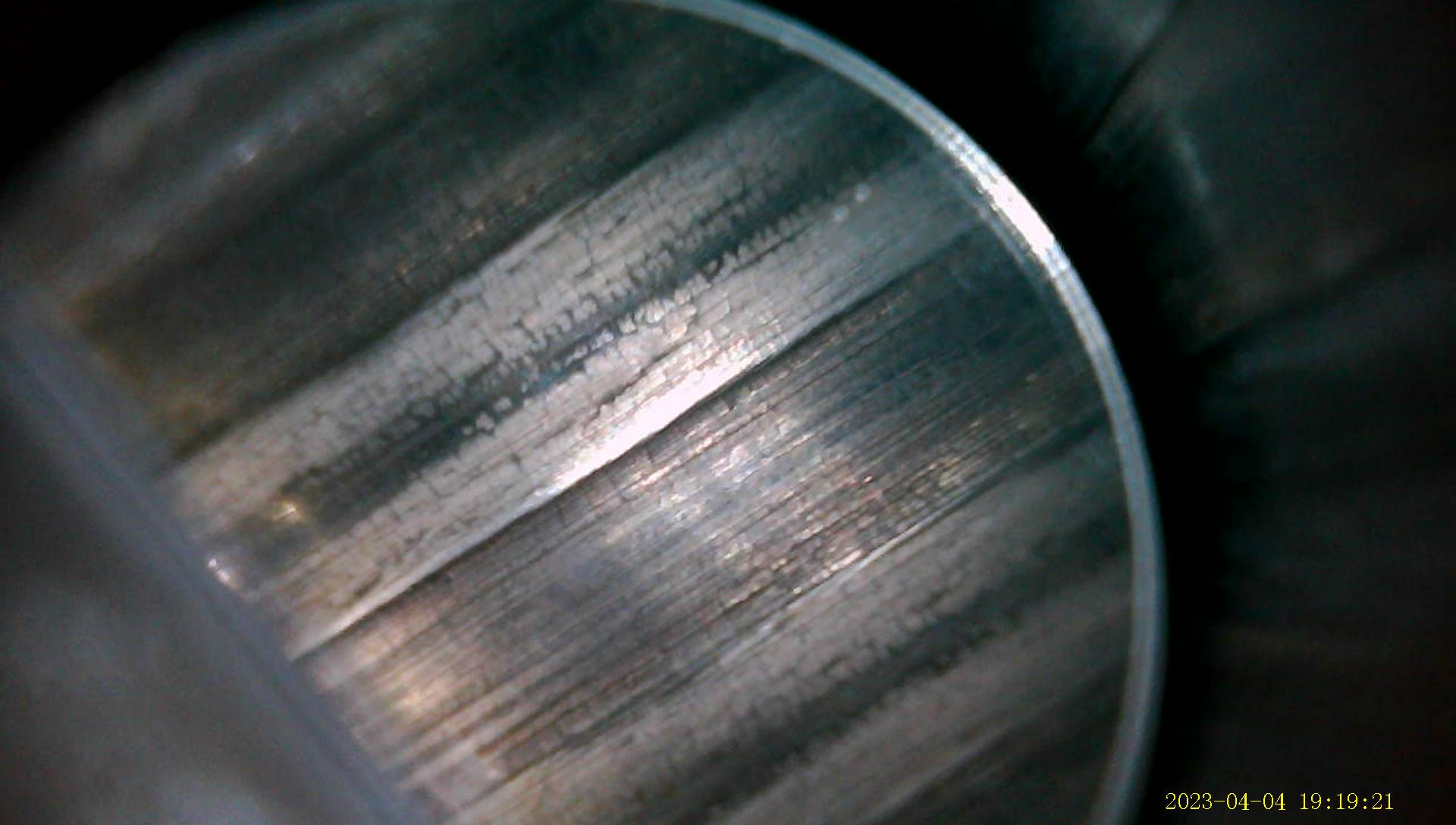

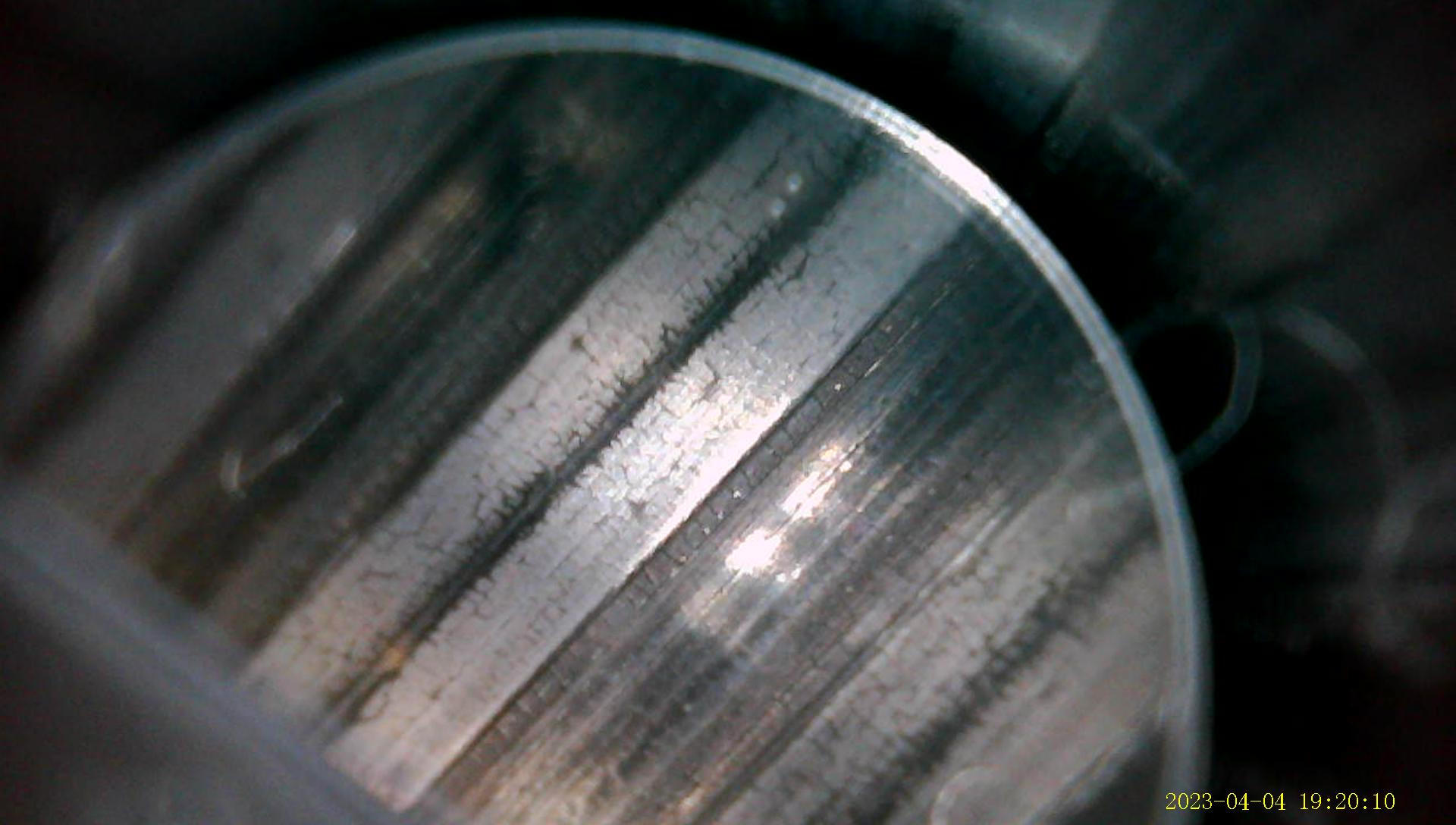

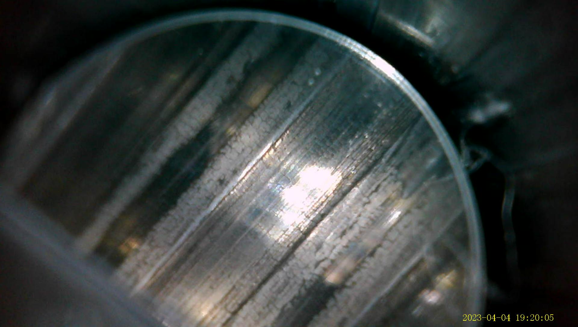

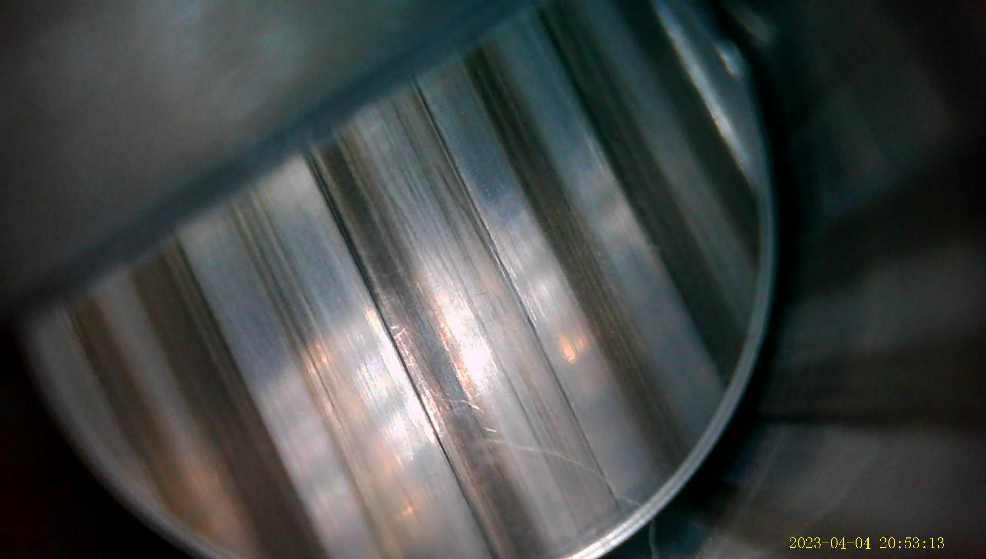

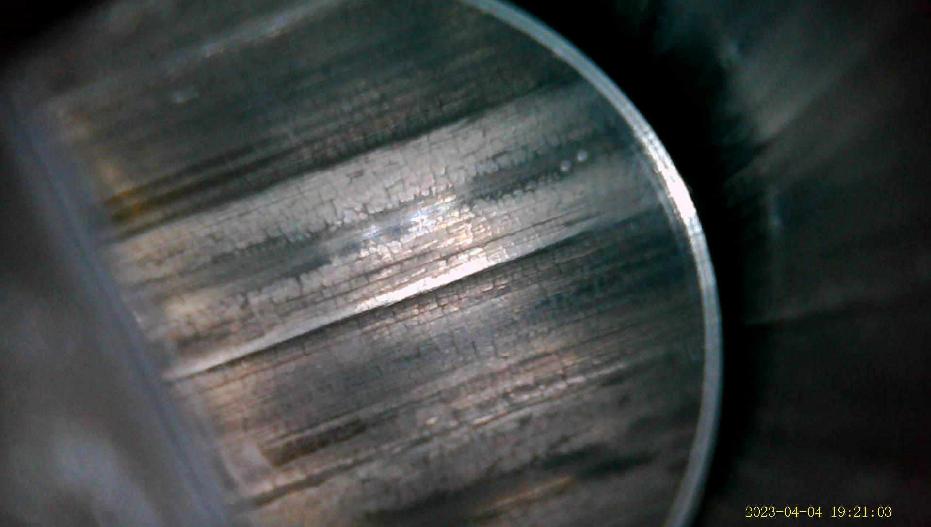

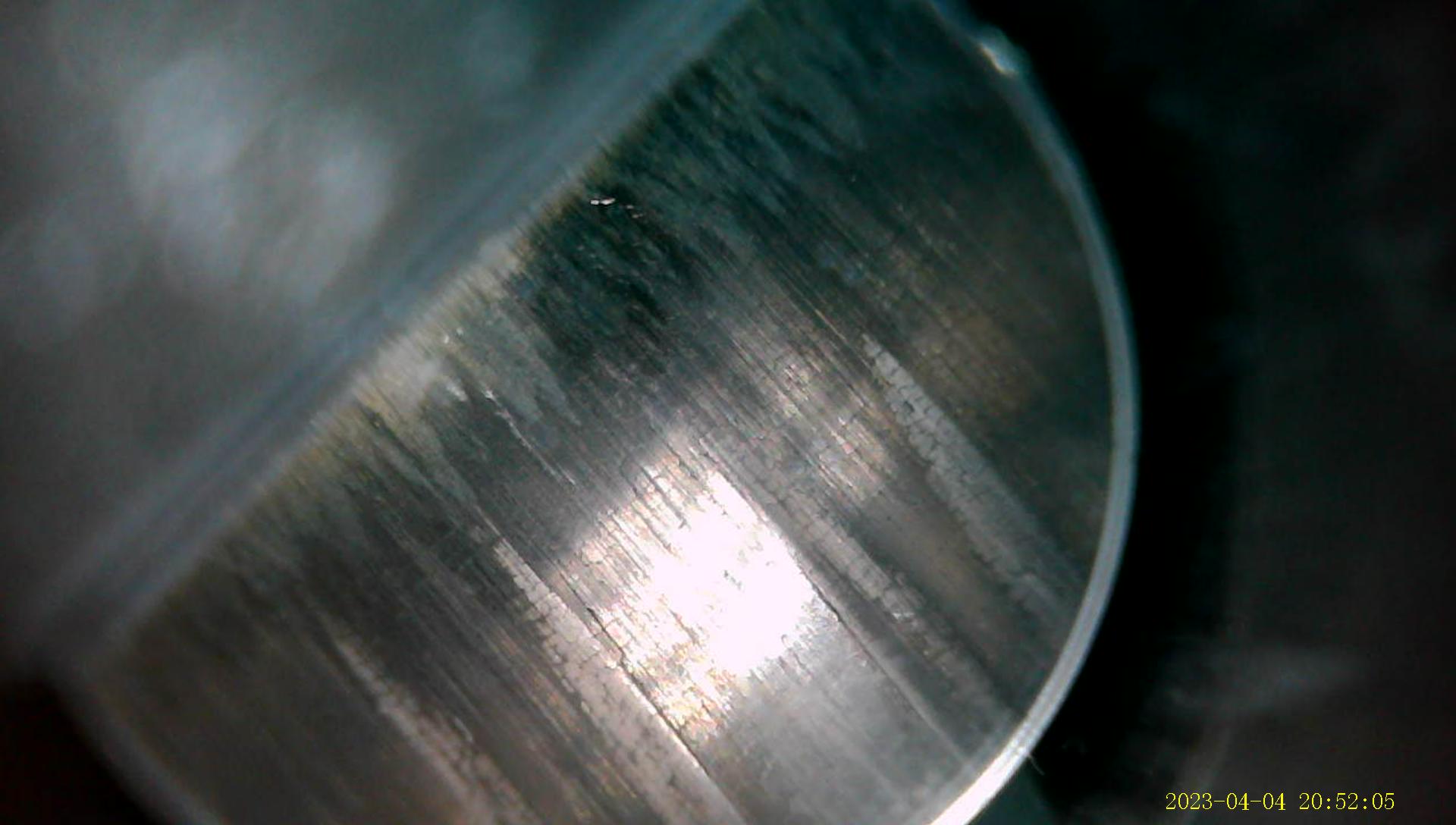

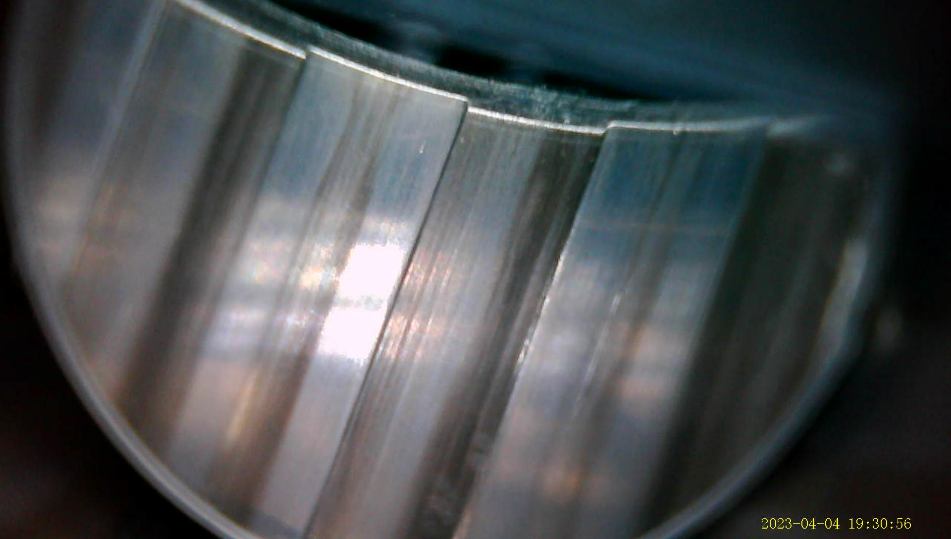

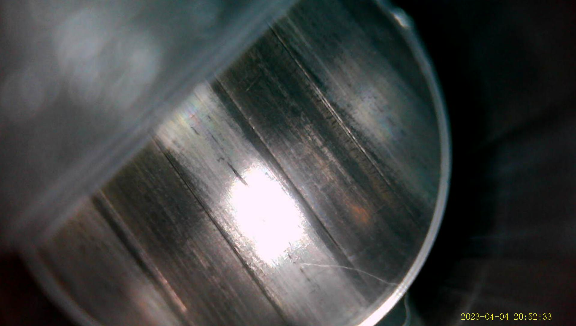

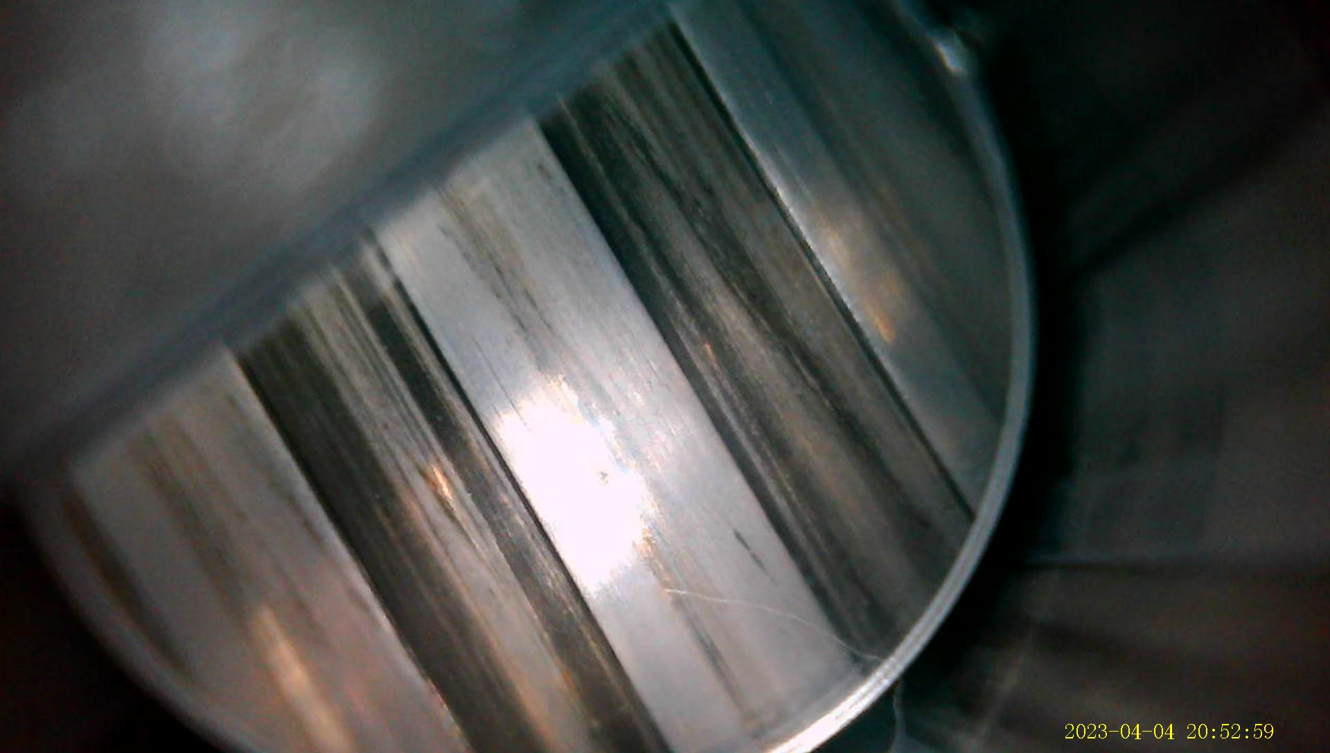

My Factory Desert Tech 375CT barrel....880 rounds...

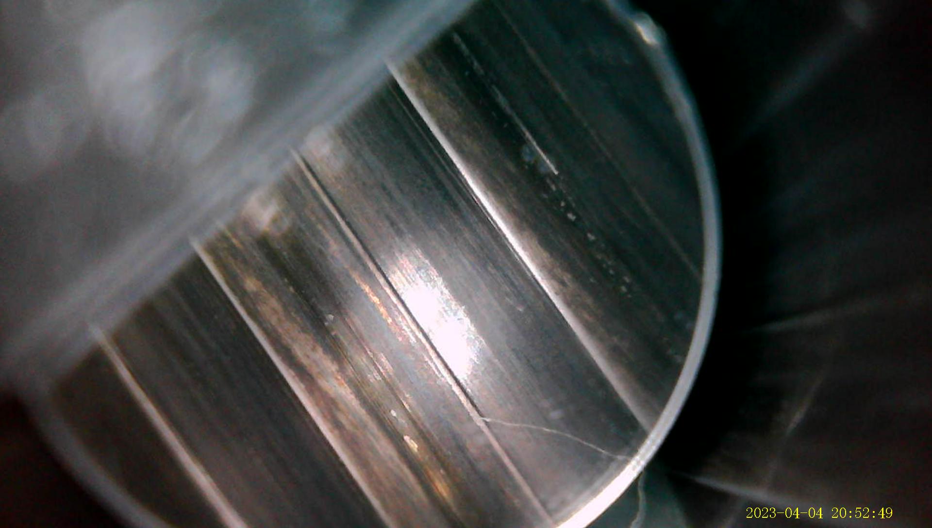

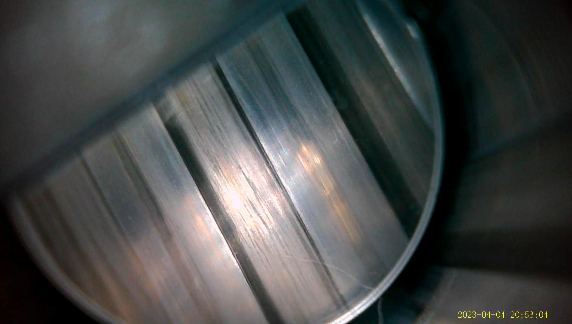

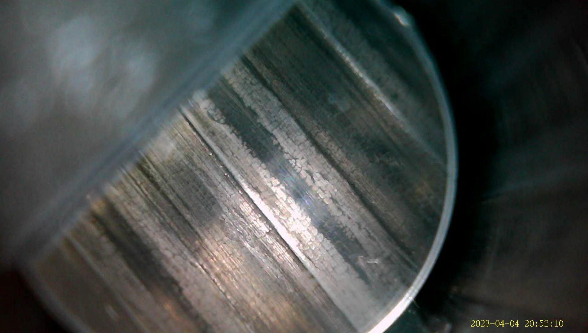

Better resolution...Chamber to muzzle...
