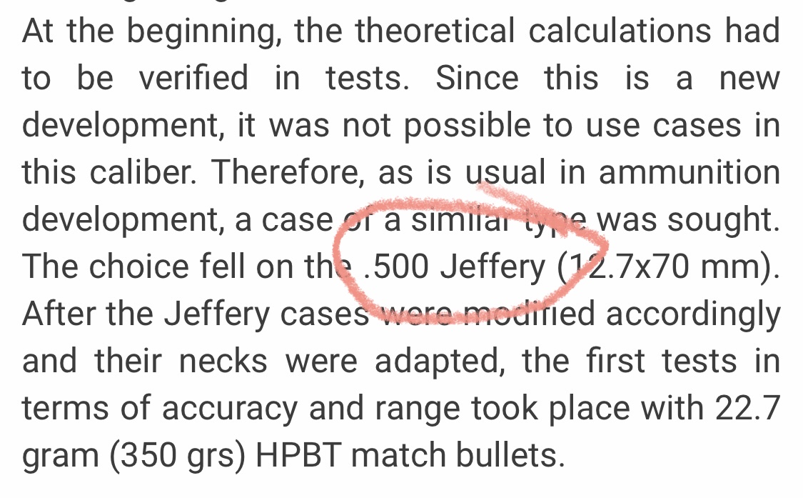

500 Jeffery parent case with 338 Lapua rim diameter ?

'' The CIP has been listing the .375 Swiss P since May 2018. The full metal jacket version will be available from April 2021, the hard core bullet is expected to be available from the end of 2021. Currently, PGM with the Mini Hecate II and Voere with the X3, X4 and X5 offer the new caliber, and the TTS Xceed is also to be available in .375 Swiss P. For the time being, the .375 Swiss P is intended only for military/LE users.''

Hi,
As per RUAG Industry Development Director the primer is RUAG large rifle magnum.
So essentially the 375 Swiss P is manufactured completely in-house at their Thun facility. This facility only manufactures for the RUAG label brand and does not interconnect/overlay any other products from any of the companies under their corporate umbrella.

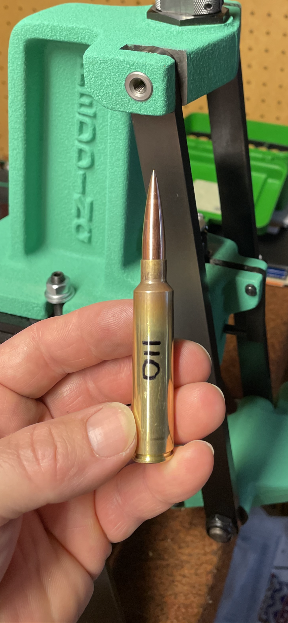

So measuring last night the 375 Swiss body dimensions are considerably smaller than Geno’s 338 Carnie.
I think that would be a cool base cartridge to shorten enough for Solids in a CIP friendly oal with good case capacity still.
I’m going to measure tonight where 110 grains of N570 ends up in it for powder column height.
It would possibly look like a 25WSSM on steroids.
I may try my hand at making a Rube Goldberg die for it as I have a piece of steel at the shop that would harden up nicely.
I’ll see if Geno has some more smoked cases he’ll send me.
