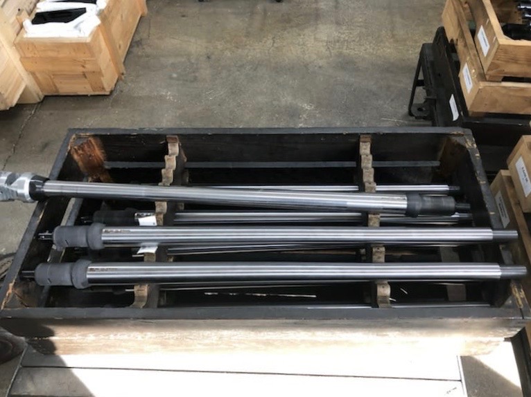

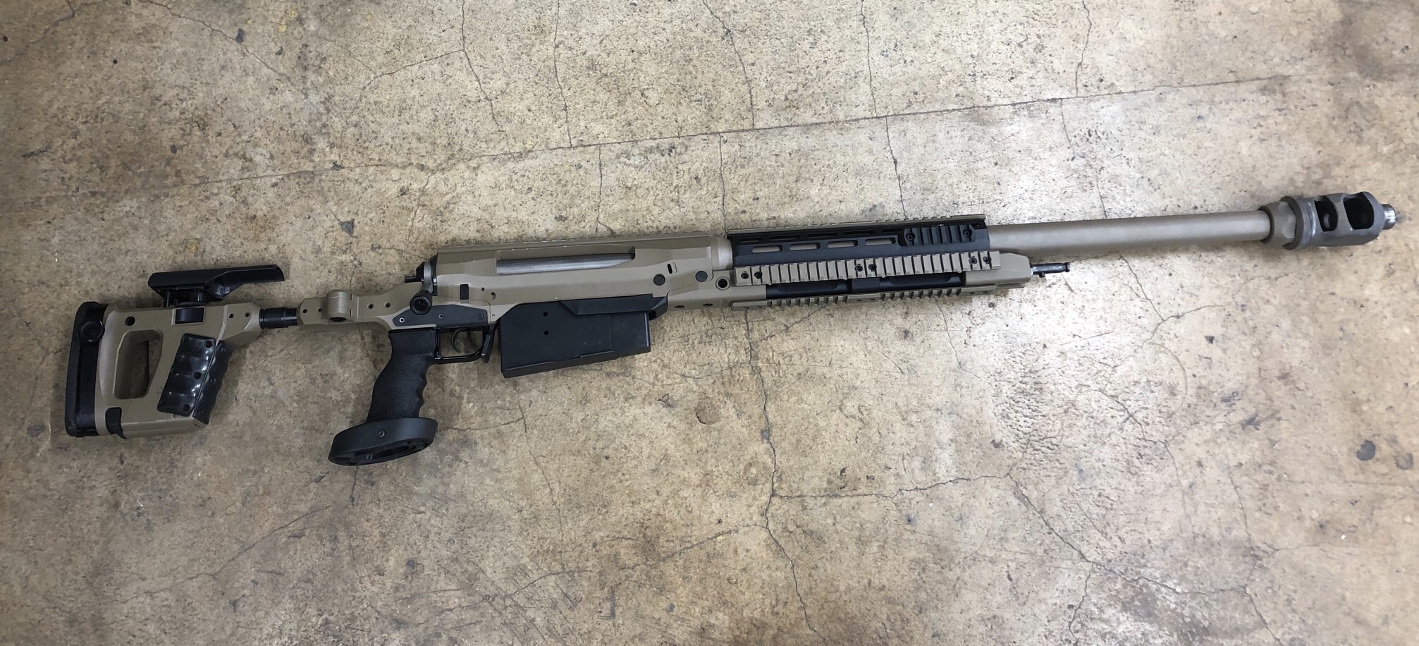

He sent me these pics of the X5 (and crate of 416 Barrett & 50cal barrels) with their extended forend which will allow me to use my Accuracy Solutions Bipod eXt ELR. (Currently on my M99)
Sven has been most helpful.

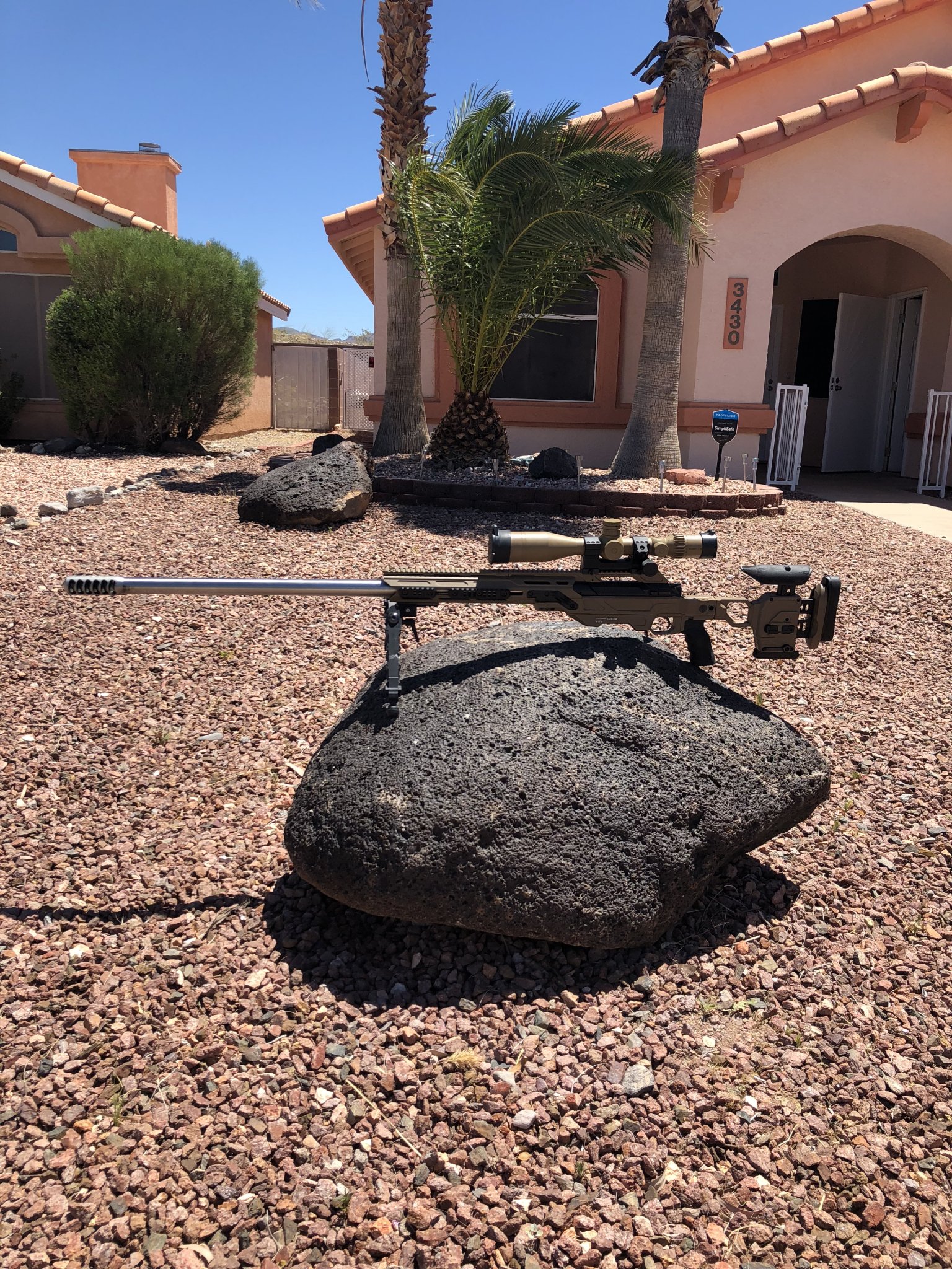

I just had my Cadex 375ct re-barreled. I went with a 34in Bartlien 1-7 twist heavy contour. Its 1.265 at the muzzle. The factory Barrel was a lighter contour Bartlien 32in 1-7 twist. I was able to get over 1000 rounds out of it before it was pulled. The accuracy was good and at a match i went 5x5 on a 40 inch plate at 2195 and 2x5 at 3090. The new barrel give me an AVG FPS of 3066 with the 400 gr Cutting edge Lazer bullet. Robert Vestal did a great job on the re-barrel.
