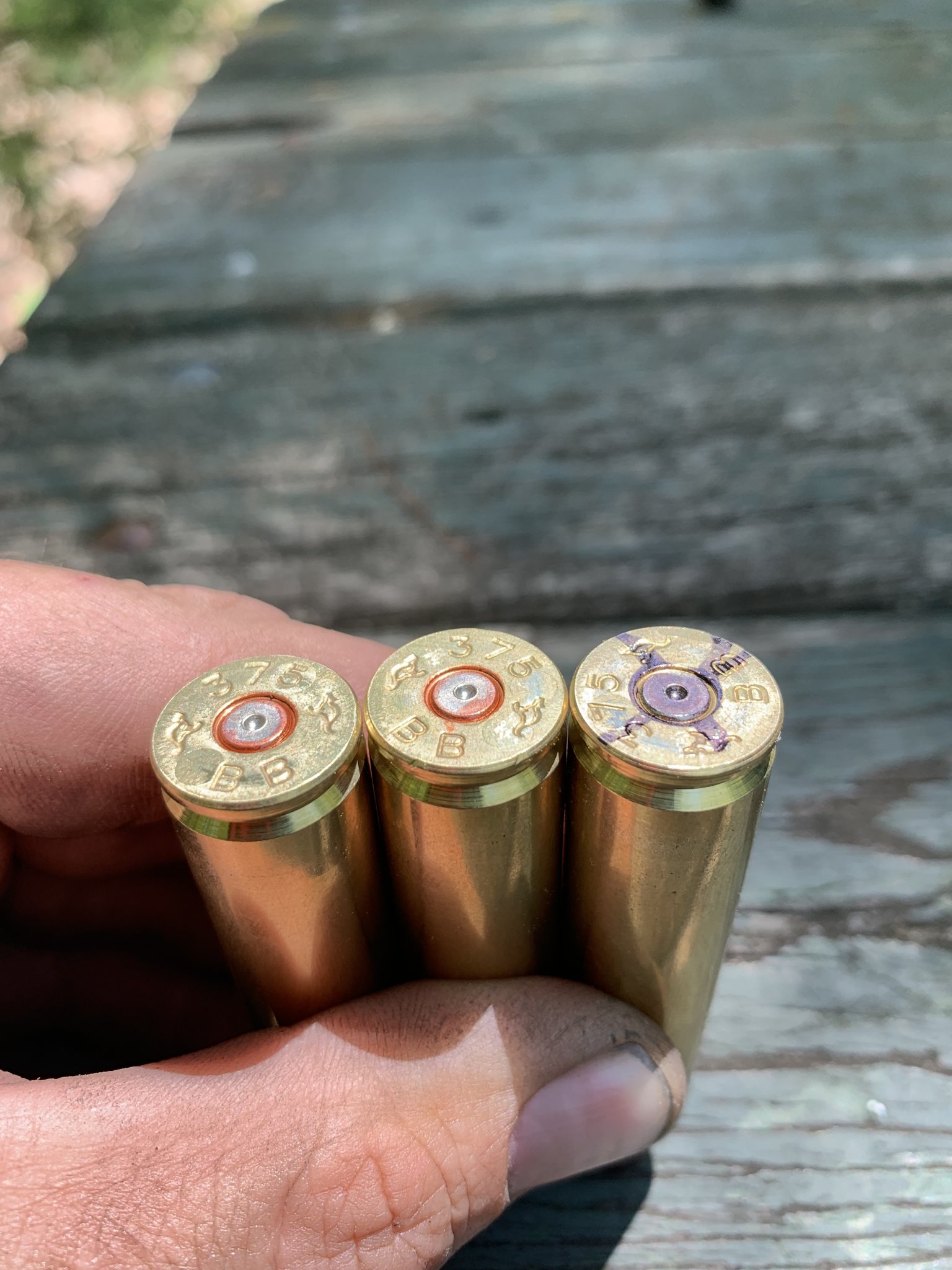

No neither, was maybe 15 f warmer than load development but I also tried one grain less charge with same results
I may do a pressure test again just to rule everything out

Your brass is fatigued. Start over with new stuff
I'm experimenting with the same condition with Barrett brass . Most of what I,m seeing is a lot of guys are running at the top or over to obtain velocities. Not good.

I can understand the 6th firing lot getting fatigued but why the 3rd? And why would the 6th firing lot not show signs till now and not on the it’s 3rd,4th, or 5th

I am wondering now if I am running things too hot for the savage action. Even the rim is .002” over size and the groove. Surprisingly primer pockets are still tight.
This is with both lots
If pockets are tight, I would assume your case heads haven’t grown too much to extract. Again, it goes back to you having the same problem with 3rd and 6th firing brass with the same load. If you’re running the same load and lot of brass but one group is giving you problems at 3 and the other group at 6, but they both started having the problem on the same outing, I’m still thinking you have a different problem

That’s my suspicion
Standard action+moderately sized tenon+extra meat lost by running a barrel nut= equals prison rape level stretching.

Gist of it was excessive side wall expansion because of the lack of barrel thickness surrounding it with a Similar mechanic as receivers stretch on firing allowed brass to grow more then the receiver shrinks back to original size(not stretched to yield but brass was) and locks the brass in
The rim and extractor groove isn't supported with any action. The brass is on it's own for the length of the bolt recess, plus the bolt to barrel end clearance, plus the chamfer on the chamber. The large shank Savage tennon is as large as most dedicated 338 Lapua custom actions and has a finer pitch thread.
I'm running a 33XC on a Savage 116 action. The pressure QL gave for some of my development loads were over 75 ksi w/o pressure signs on the brass. The brass became difficult to size as the modeled pressures approached 80 ksi, but I never saw an ejector mark. I've seen no growth in the headspace in 300 rounds.
If you post the details of your loads with their velocities, I'll set up a QL model and post it. I think you'll be surprised at the pressures. You simply can not run Cheytac velocities with less case volume without running higher pressures. My guess from the information provided is as the round count went up on the barrel, so did the pressures. Have you been tracking velocities?
I'm also wondering if your chambering method left the chamber a little undersized. Do you have the tools to measure IDs to the tenth thousandths?

I talked to another savage/37XC shooter and he is having the same issues as I am
My headspace is .030 long, I’m running 361gr flatlines with 120 gr h1000 at 3039 FPS from 32” 1:10 using fed 215m’s. No ejector swipe but primers are slightly flatter than when primed. Still round at the edges
4.780 coal

Hasn’t changed since I worked up the flatline load. So 78 rounds. All of the new lot and half the firings on the old lot are with flatlines
Totally forgot about the barrel break in so to speak with the smks
Most likely because 15 over ambient put you over what the brass will withstand. Work hardening at the bottom limits sizing via springback. The only way to try to reclaim that brass is push thru die to sweage the base diameter back to as new
Sometimes that works, sometimes not
Your extractor undercut diameter is a clue to being over pressure.
.002 is starting to reach limits.

Mine is using the whole ramp. And the claw is not letting go, it’s ripping right through the rim, it’s definitely brass sticking in the chamber and takes a pretty good thump to free it up. I still feel the brass is the issue and the load data from tubb is just too hot for my gun. Bear season just started so it’s slowing down my progress on the issue.
