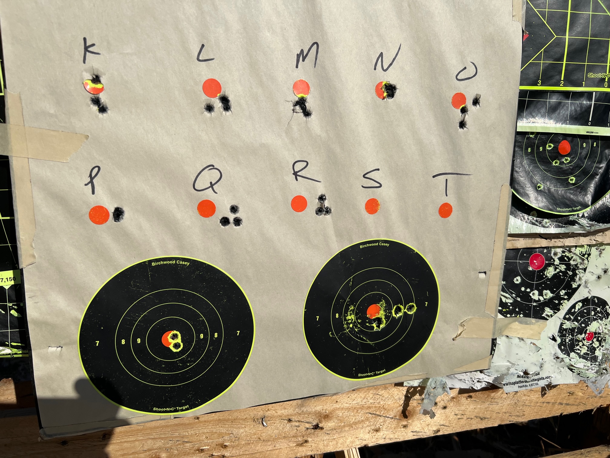

Another range report:
- I dropped the charge weight on my "Champion" charge from 118.4 gr to 118.3. At 118.4 I had a few that jumped up in velocity last go. It was a little cooler today, and with the lower charge weight/temp, everything stayed tight in the 3050 fps range.
- SDs were 6.2 fps over 30 rounds, which I'm quite happy with.
- I tested a few additional charge weights (4-shot groups). One at 119.1 gr got me 3080 fps with a 3 fps ES. Not sure it's worth doing more load development there as I'm getting good results at 3050ish fps.
- I, correctly this time, tested additional seating depths, starting at .130 off and going out at .003" increments. The image below shows results. Note that I still had open dots from my last test board, so I just reused it. The .130 is N, O = .133, P = .136, etc.
I have to admit that the .133 surprised me. I'm thinking that either something was off with me on that group, or something was off with the ammo. It doesn't make sense that .130 would be an extended hole, and .136 would be a single hole, and .133 sucks so bad. I'll be retesting there.
EDIT: I fired 70 rounds today. I likely won't be doing that many again :)
EDIT 2: I also took it out to 1300 yards and had some success there. I have to say, however, that the solids are tougher to self spot than jacketed - even on my Berger 230s with my 300 PRC. I missed two hits that were high on the target and didn't see because the target didn't move and the mark was slight. I'm considering on my next barrel for this going down to either a 33XC or a 338 LM Improved so I can use a jacketed bullet (Berger 300) - and get an arbor press seater.

love the Detail, thanks for taking the time to post.
questions :)
I'm with you on the question of target 'O' ; 'N' at .130 and 'P' at .136 .....
Edit - when you shoot your string, do you cool between each shot? or shoot 3 and then let barrel cool? (Hopefully you didn't already answer this in a previous post that I might of missed)
Edit 2 - have you bought a camera/video to put on your 1300 - 1500 yard shots? .. example, longshot 1 mile video system, or whatever... This might help you on your spot; since you can rewind and look for the misses near hits :)
I use a spotter and an apple iPhone to record. works great except for high mirage, granted you have to wait for the scope to quit moving before hitting record, lol. Sometimes, you can see the bullet trace (which is cool as hell).
Edit 3 - thinking about this, yea, unless you're shooting against a chalk wall, that solid would still be hard as hell to see, (unless your hitting steel).
last final thought - I vote 33Xc on your next barrel, since all you have to do is to neck down the brass from the 37XC
love the Detail, thanks for taking the time to post. :) questions :)
I'm with you on the question of target 'N' at .133 and 'P' at .136 ..... Do you think 'O' could of been off? maybe they were tightening with N.. O was an off load, and P shows the (damn near 1 hole) results?
N was .130 (my current "champion" seating depth) - all the rest were challengers with O being .133, etc. - I doubt I would be that far off on all three shots, so my current assumption is that it was something to do with the case/load.
My biggest issue with this rifle right now is that I don't have, and can't economically get, a seater die for an arbor press, so I can't tell if the seating force is consistent. LE Wilson makes one for the 33XC - and they make a FL bushing sizer for 33XC too - but nothing for the 37XC, and the bullet size for the 37 precludes modifying the seater for the 33. I can get a custom seater from Warner, but it's like $800.
Also, my current bushing is sizing down the neck too much. The mandrel is really working the brass when I open it back up. I talked to David Tubb this week and they are going to polish down the inside of a bushing to try and get me another .001" or so. My concern here is that because of the force I need to use with the mandrel, I'm deforming the brass lengthwise when I use it. I'll be playing with that this week to see what's happening.
Edit - have you bought a camera/video to put on your 1300 - 1500 yard shots? .. example, longshot 1 mile video system, or whatever.. This might help you on your spot; since you can rewind and look for the misses near hits :)
I've considered it. A guy I went shooting with like 6 months ago had a Long Shot. It was very cool, easy to set up, etc. I just have so much frikkin' equipment to take already, between targets, rifles, spotting equipment, etc., that I'm not sure I want to spend $800 to bring more.

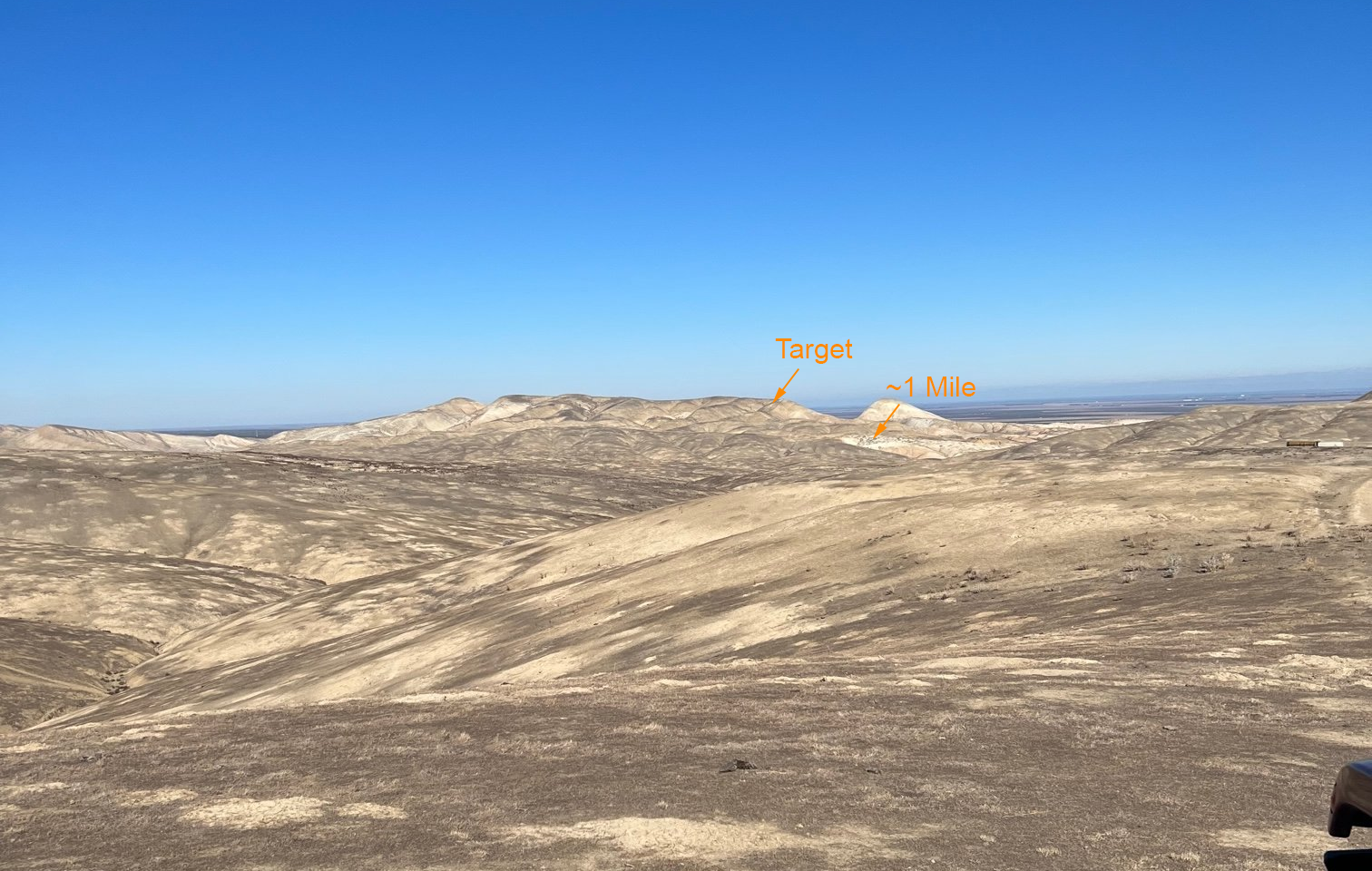

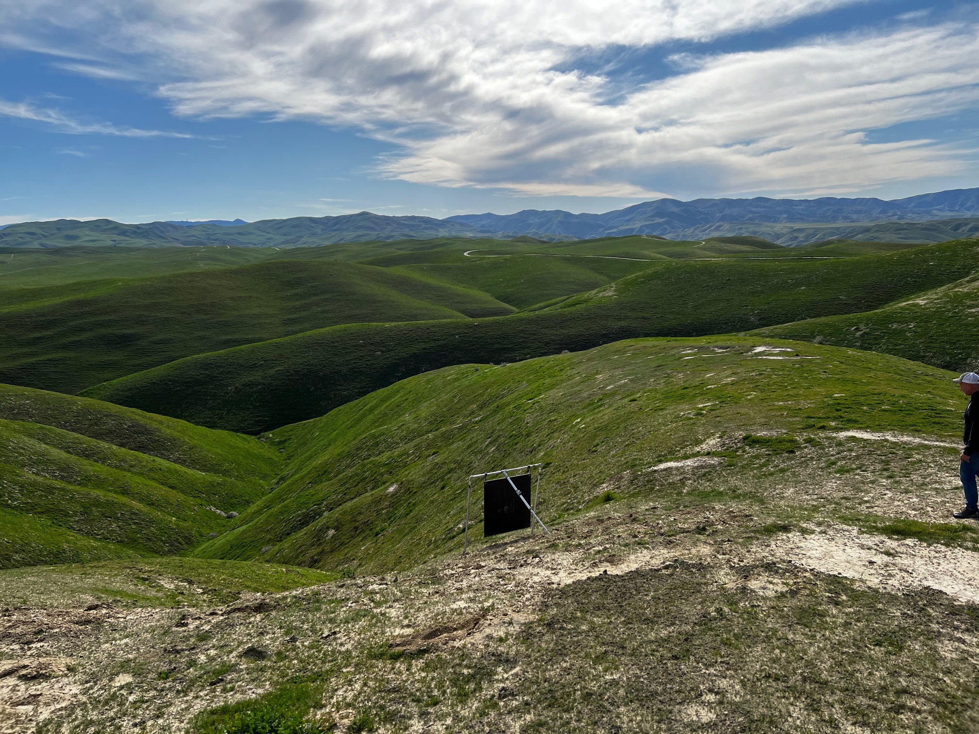

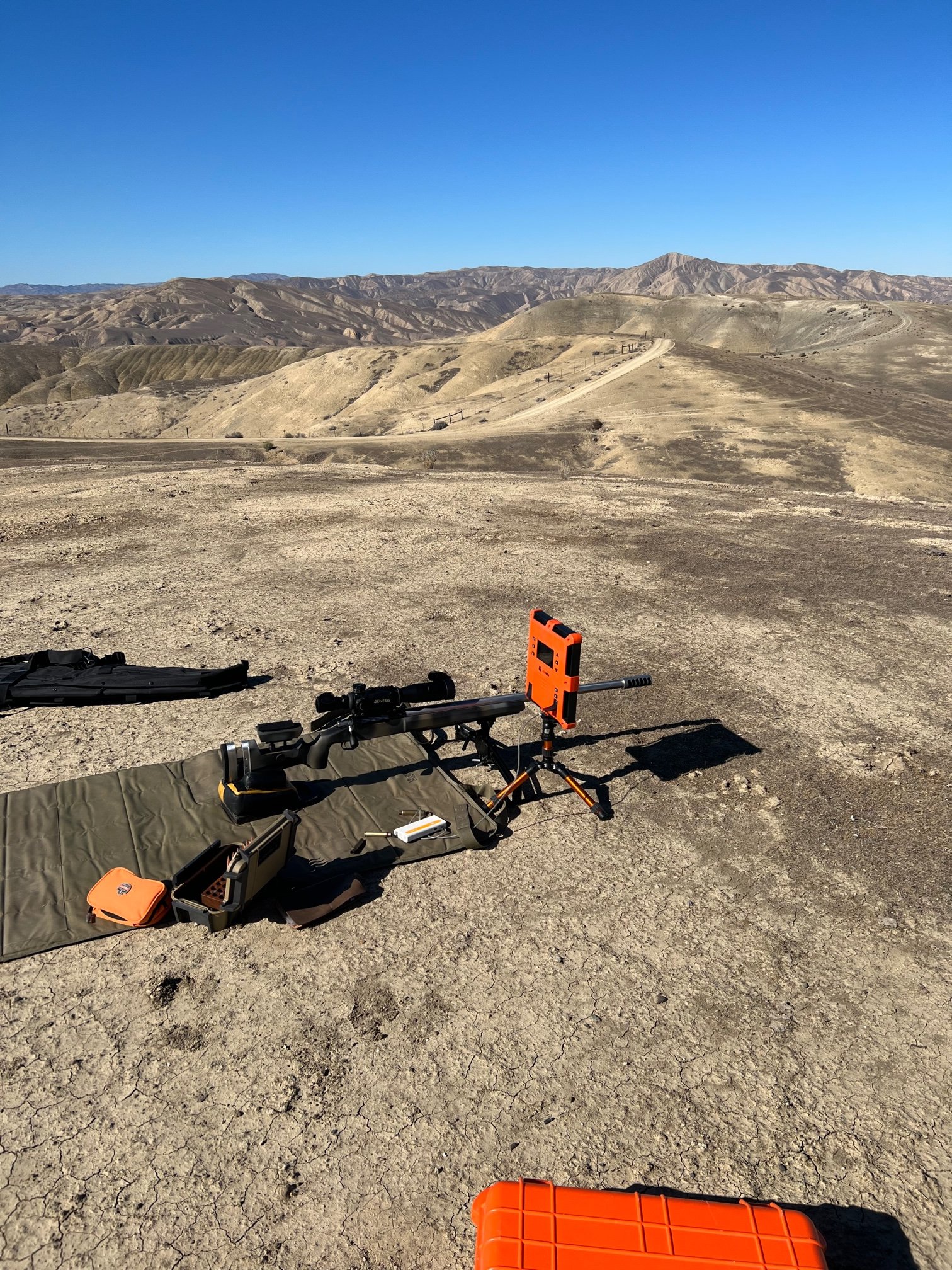

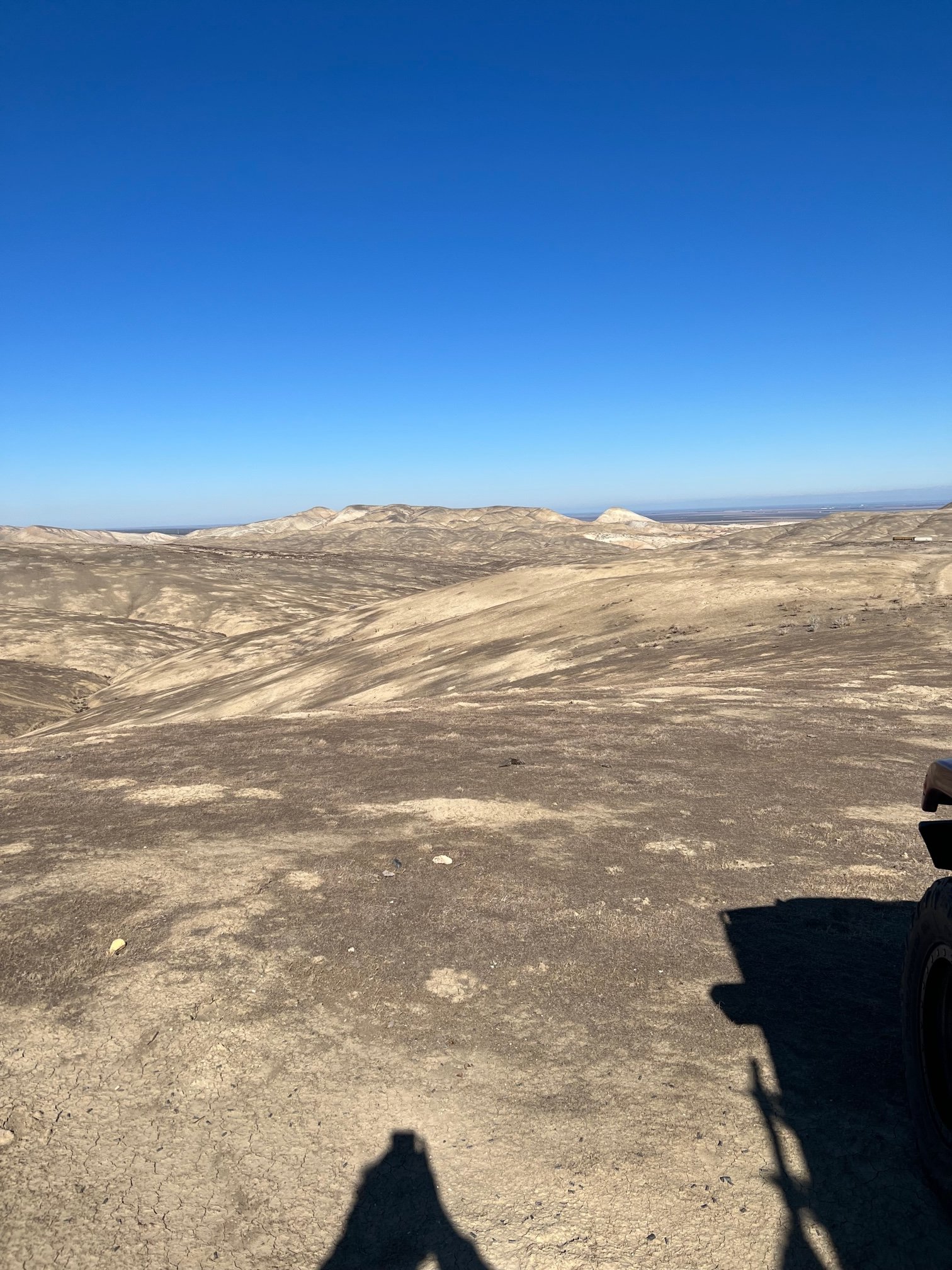

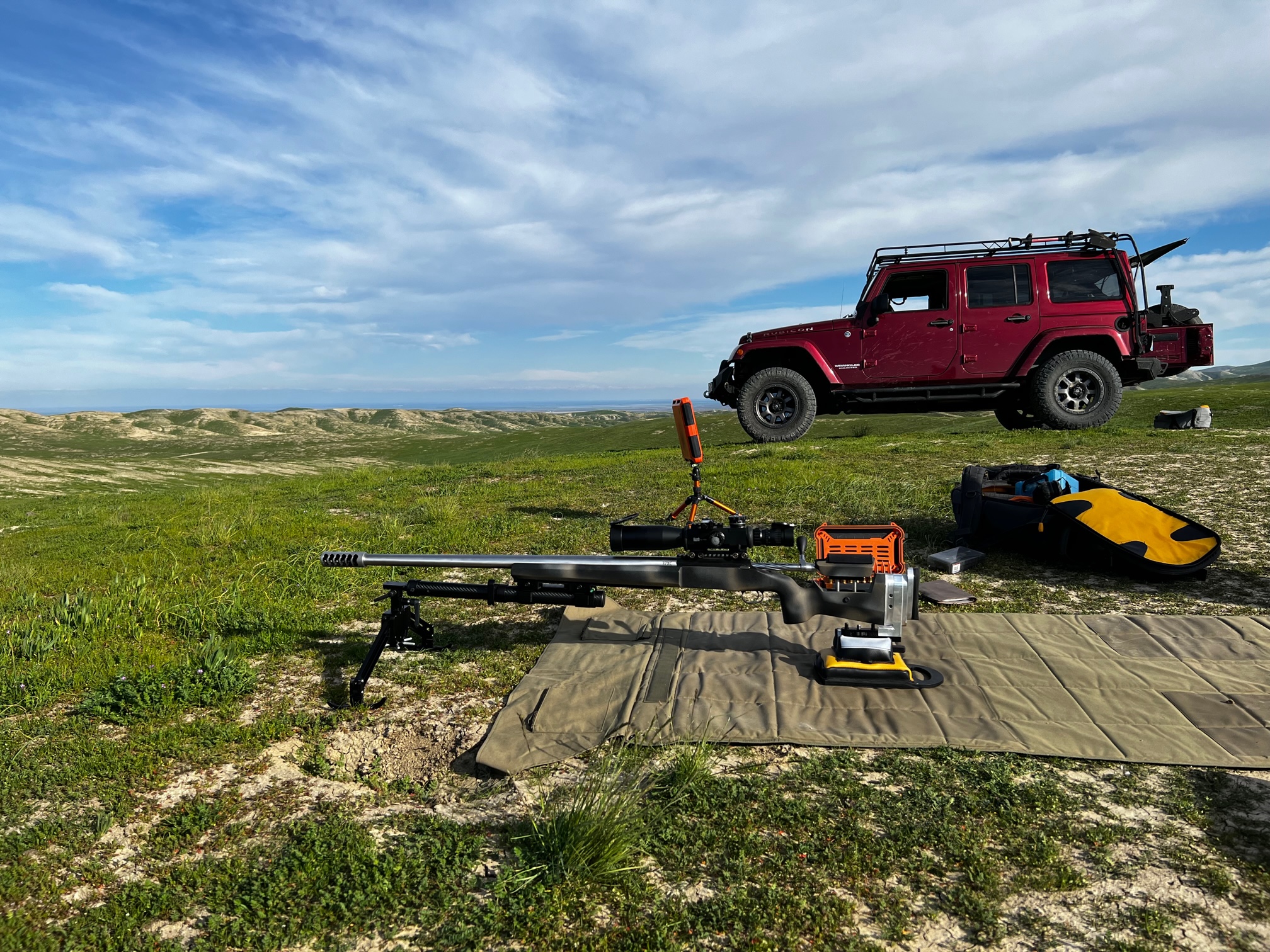

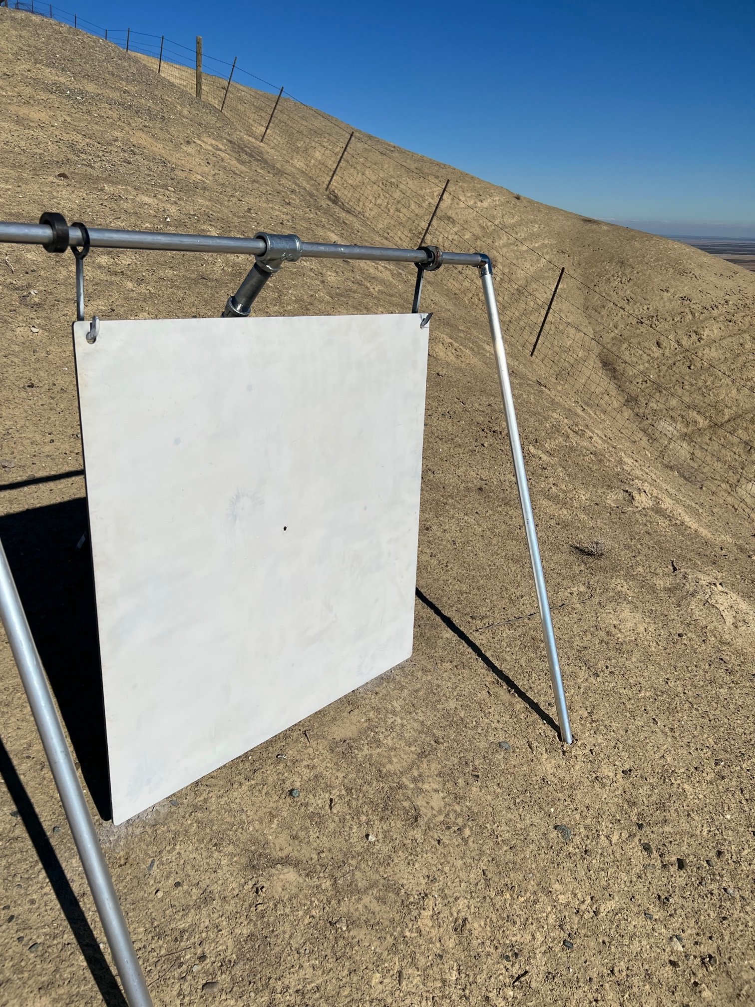

Set a new personal best range for me today when I took my 37XC out to 2504 yards.
- Unfortunately, my load was not working well - velocity was all over the map.
- I was self spotting - I didn't expect it to be easy, but it was insanely difficult. Especially because...
- I had a tough time getting the range and I needed to walk out a hefty distance and get two ranges then guestimate. That put me well off on my initial guess (2400). Getting that first spotted miss was a royal pain.
- You can't spot hits with solids. I'm kind of over them for this sort of distance. Note the tiny mark below - this is a 1/4" AR500 target (33" square). It didn't move. I might get a 3/16" target made. A Long Shot target cam may also be in the cards. I just don't want even more gear...
- Wind was 7 mph and variable. Even though it was low, the variability in direction played hell with the wind call
- I hit one out of 30 - but given the factors acting against me, I'll take it! (And the one hit was dead center :) )
- I validated the range after the fact using the GPS in my Jeep. I need a handheld...
You need to get a spotter! Although your shooting spot looks good. I bet the wind is nuts there. With the small rolling hills no wonder you only got one hit!!
Switching to a-tips may help you to see splash. Mine put up a plume of dust when its dry.
Yeah, this was a somewhat impromptu trip and none of the folks I shoot with could make it.
This area is really interesting. In the image below, I've pointed out the target and another area that's about a mile out. You can see the difference in the soil makeup. The target is against a more typical dirt hill, while the white areas are made up of a different mineral. I shot a few shots at rocks at the ~mile spot, and it's incredibly easy to spot. Then, just about a half mile away, the composition is totally different. Heck, the white stuff is just about 100 yards to the right of the target.
Of course, the target access is the other part of the equation. There is absolutely no way to get to either of those areas. There's a fence line just to the right of the target.
As to the wind, this whole area is tough. As a matter of fact, the best shot I ever made was about 5 miles south of this spot. Wind was about 20 mph and gusty. I was shooting my 6 BRA at a 5 inch target at 1000 yards. I was trying to read the wind - I had communicated my wind hold for a certain condition and my spotter felt that condition was there and said, "send it!" Seeing that little target spin all over the place was oh so rewarding.

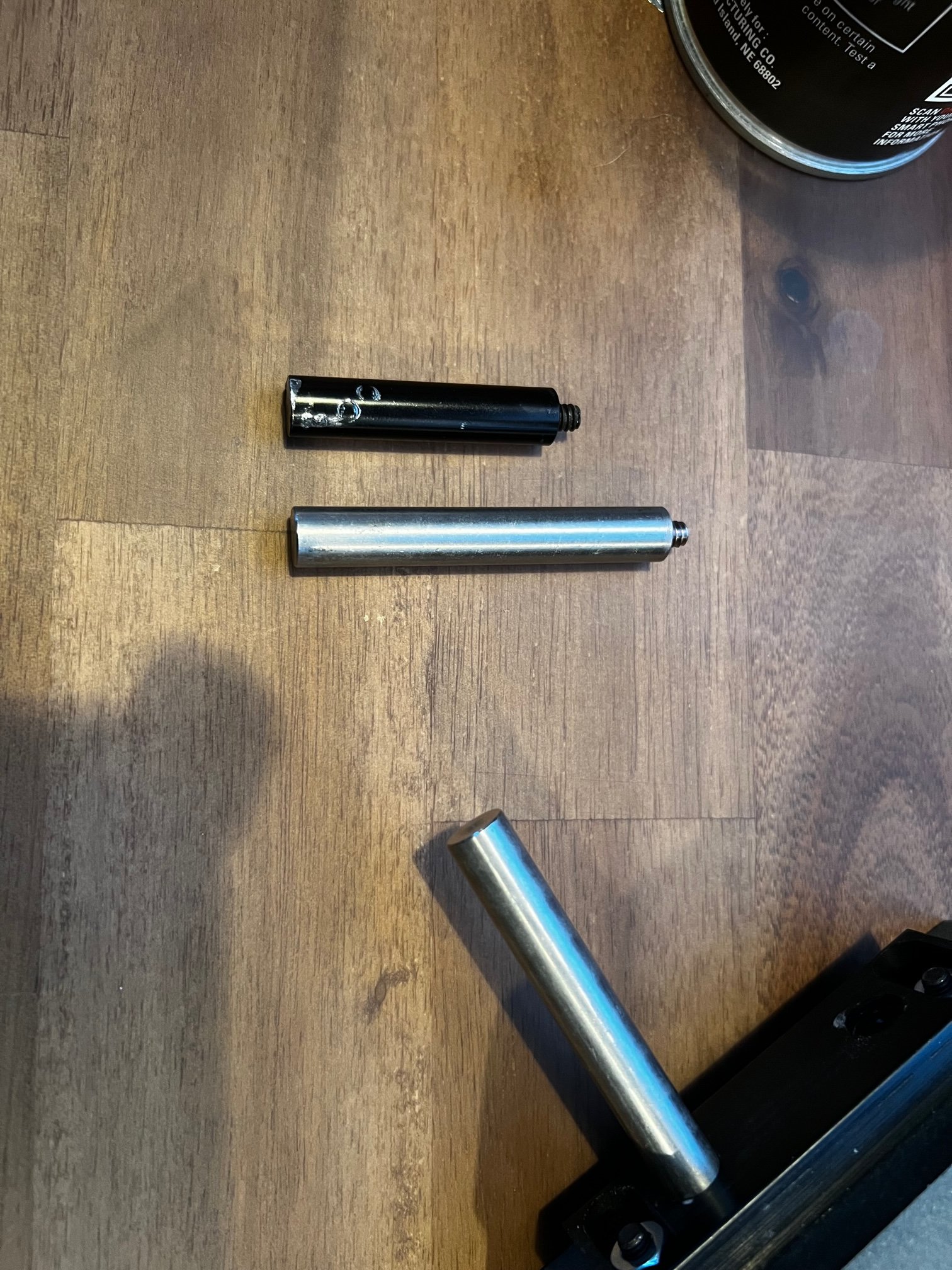

In my last trip out, the amount I had to dial in on the scope caused the rear of the scope to be higher than my cheek rest could adequately accommodate. Remember that I'm using the March Genesis which has the entire tube move when you dial. The more you dial in, the more the front end lowers and the back end goes up.
Considering that this was 2500 yards and I have desires to take this to go to 3k+, it was a situation I needed to rectify.
I called McMillan and asked them if they have longer posts, but they do not. Instead, I went to a local machine shop and had them fabricate a couple out of 3/8" stainless. They are .75" longer and tapped a 10-24 female thread in the top. I got a couple long set screws to act as the posts.

Question - how much does the rear of the scope cause you to have to continually adjust your cheek rest. If you go from 600 to 2500, do you need to move your cheek rest?
Note to McMillian - maybe you guys should sell some extra-long cheek posts - cut to fit. I think most of us own a sawz all or grinder. This would be a huge time saver rather than trying to run down a 'local' machinist.
Prior to my last trip where I took it to 2500, I had only dialed like 8 mil. At that amount, it was very similar to when I zeroed it. Still, at the zero mark, the cheek riser was maxed out in how high it would go. I maybe had 5/16 to 3/8" of the posts engaged in the locking mechanism. At 2500, I had dialed in about 25 mil and I was down to slightly less than 1/4" of the post engaged. It was not enough, and occasionally the cheek riser would come out.
The posts cost me $60. The funny thing is that when I was talking to the guy at the machine shop over the phone, he sort of sheepishly told me the price, as if I'd balk at it. I told him it would be fine :)

Took the 37XC out to the hills again today. I have to say that I still hate shooting the solids - very difficult to spot. Still, a great day to be out - 60 degrees, winds variable up to 10 mph.
37XC set up using the BipodeXT. Honestly, using this before I had the ABR was not feasible. Now, being able to adjust at the rear of the stock makes all the difference. You can also see my new custom Protektor rear bag in use for the first time. Very happy with it.
Looking back from behind the target. Normally, these hills are dry as bone and brown as [insert analogy here], but with all the rain we've had, it's super green (and this makes it more difficult to spot).
Reactions: wildcats and Balor
There is no way I could have done this solo today. Even with the target being set up against dirt, it was very difficult spotting the solids - I mean really frikkin difficult. When we took the target down, we found three nearly intact solids in the dirt slightly up slope. They simply don't impart enough energy to the dirt to create enough splash. If I was in a zombie apocalypse and was desperate for bullets, I could reload these things.
On one shot, I saw the splash about 10 feet to the right of the target and was like "wtf was that?" My spotter responded, "what are you talking about, you got a hit!"
The solid had ricocheted off the target (barely moving it), and since it was tumbling sideways, it actually kicked up dirt.
Also, setting up the BipodeXT is really better done as a two-person job. I looked through the scope, while my friend adjusted the Phoenix to get it roughly on target. Then I used the ABR for final adjustments.
Yuck, your not really selling the solids! Ha!
