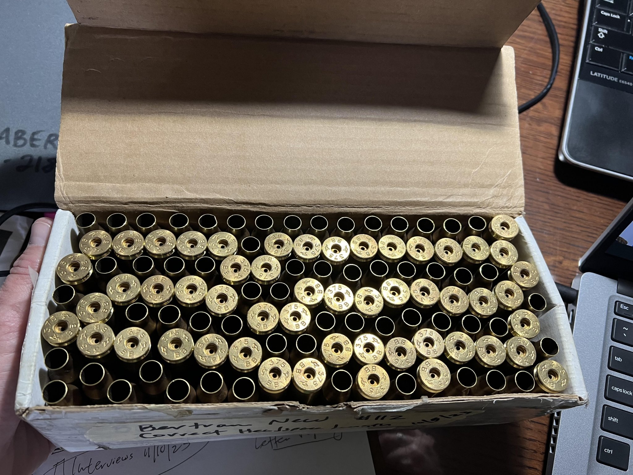

Bertram brass 375CT for sale in PX if anybody wants any. <$2.50 per case.

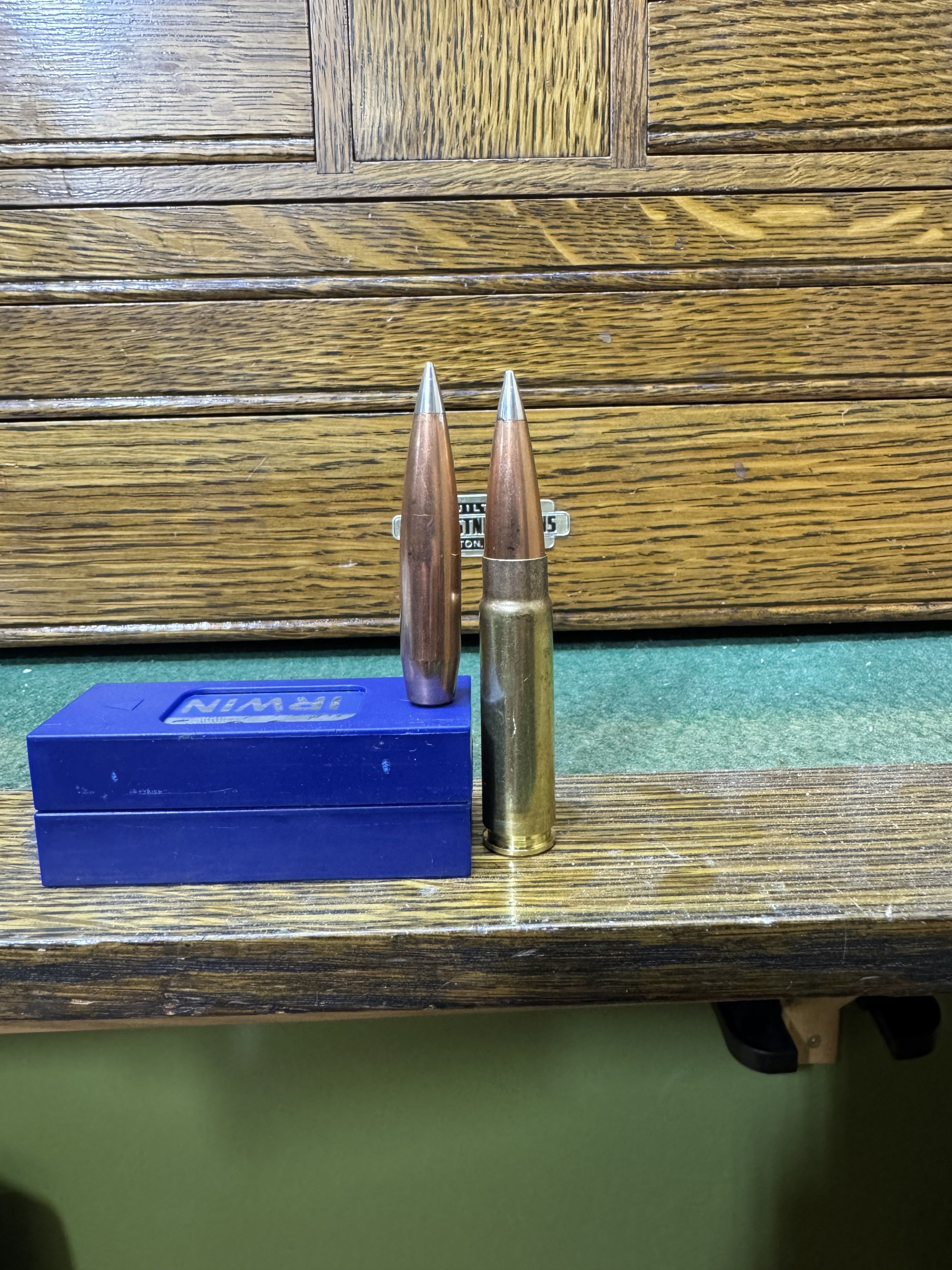

but with G7 .475 and 410 grains, it will barely keep up with the 390s. I wonder if it's going to be easy to load for and what kind of jump it will like and how fast people get them going and with what powder....maybe I'll have to give them a try.
Yea they said there really easy to tune but yea b hard to beat the a tips. Some guys r die hard berger tho

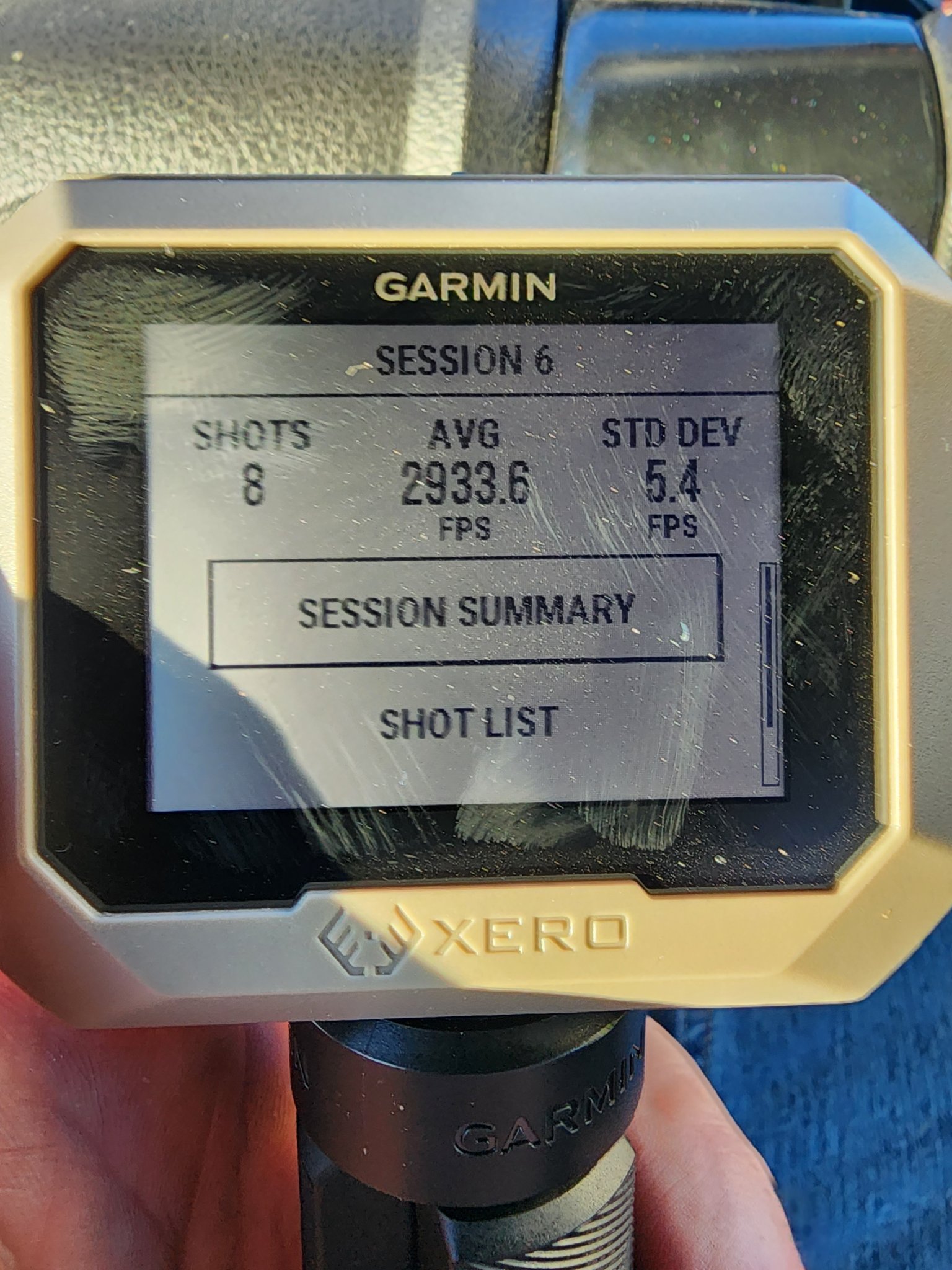

Your load was about 133 grains of H50BMG right? Didn’t you run the ATIPs at 2870 or 2880?

That’s right about where you want to be. I am at 1:35 grains in a 35 inch barrel clocking just over 2900 and you figure about 20 ft./s per inch.
If you have tight groups and a low standard deviation there, I would stay put because you’re gonna get into pressure above that and ruin some expensive cases
If you do go higher, I would use the same case over and over
