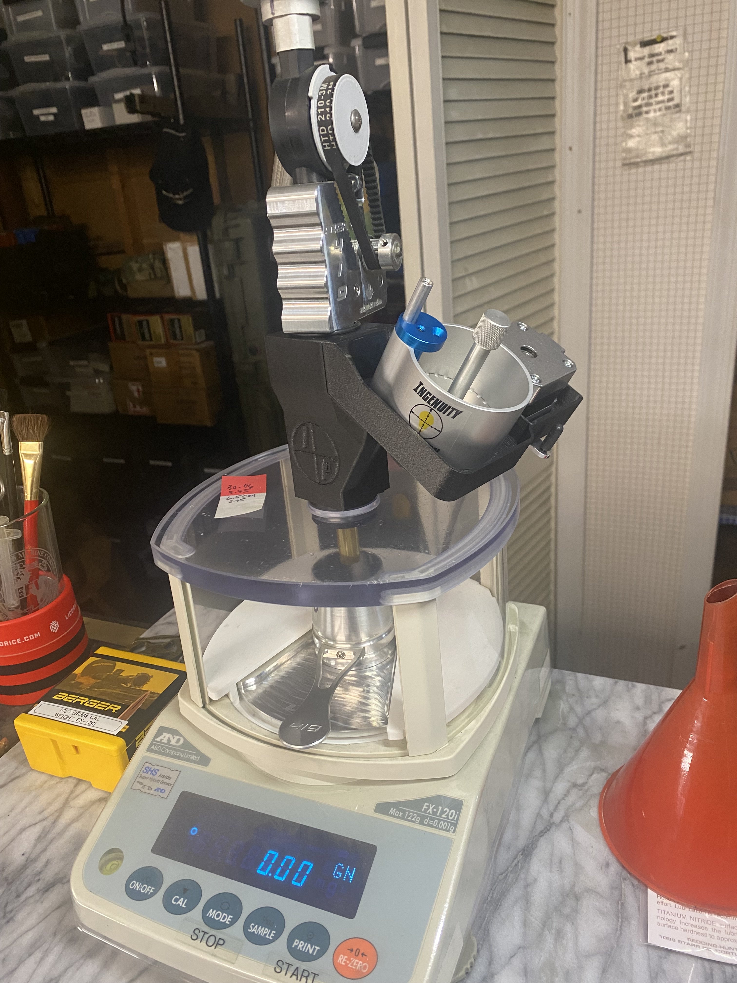

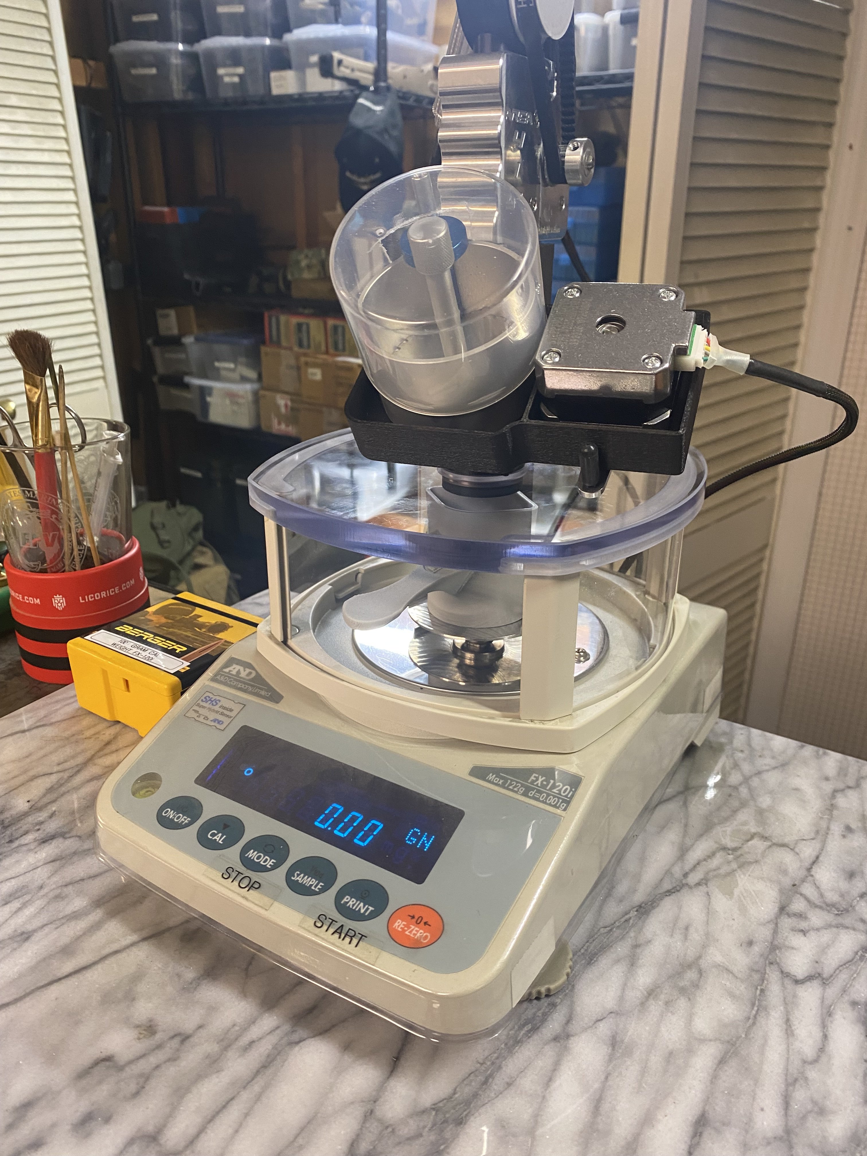

So while I’m waiting for my Ingenuity Precision powder cup to get here from Oklahoma, I decided I’d try a couple of different powder cups to reduce powder bounce from my from my new IP trickler mount.
I’ve always had some powder bounce with the aluminum 419 cup and the IP trickler, even with the original mount.
But the Area 419 cup failed in a big way with the latest mount, bouncing powder everywhere. So I ordered the IP cup.

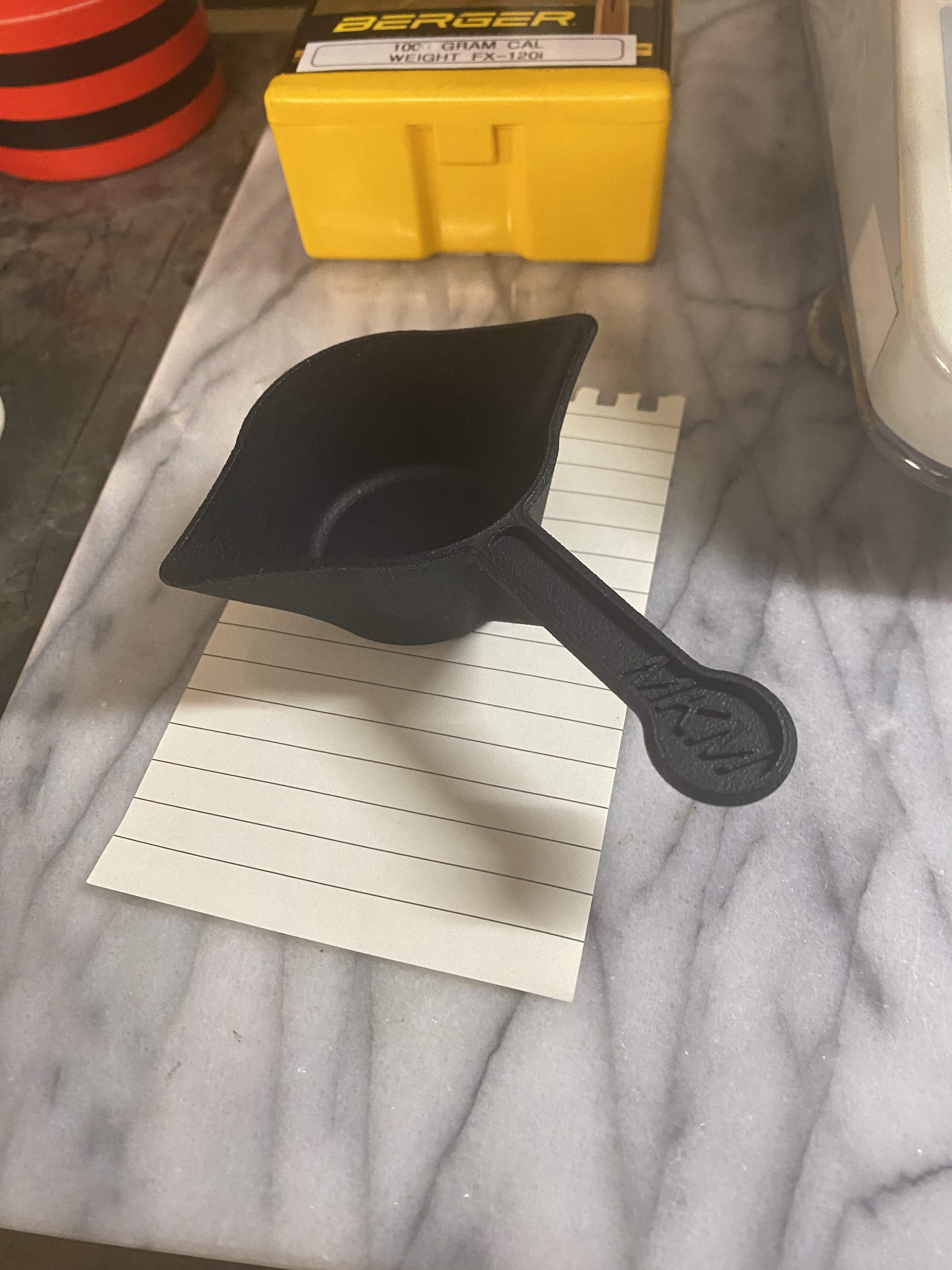

In the mean time I got an MK Machine 3D printed powder cup to try out and it was a failure, as far as powder bounce goes, too.
While I Iwas waiting for the next powder cup to get here I noticed something weird.
The MK Machine cup that weighed 245.08 grains when I got it now weighed 245.18 grains two days later. It currently weighs 245.22 as of this morning.

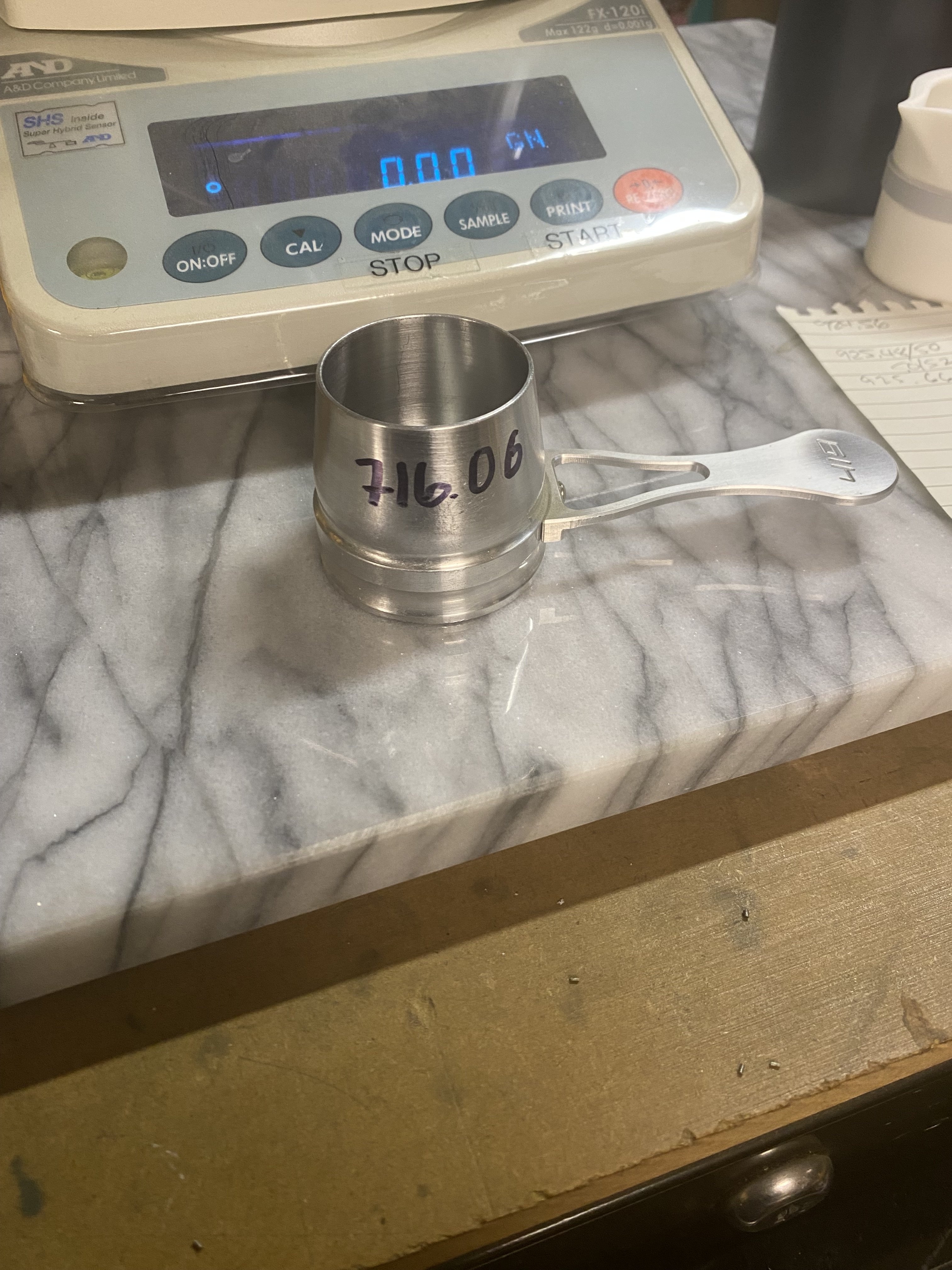

Way back since the ChargeMaster and later the Sartorious days, I’ve been writing my powder cup’s weight on the cup.
The Area 419 cup’s weight hasn’t changed.

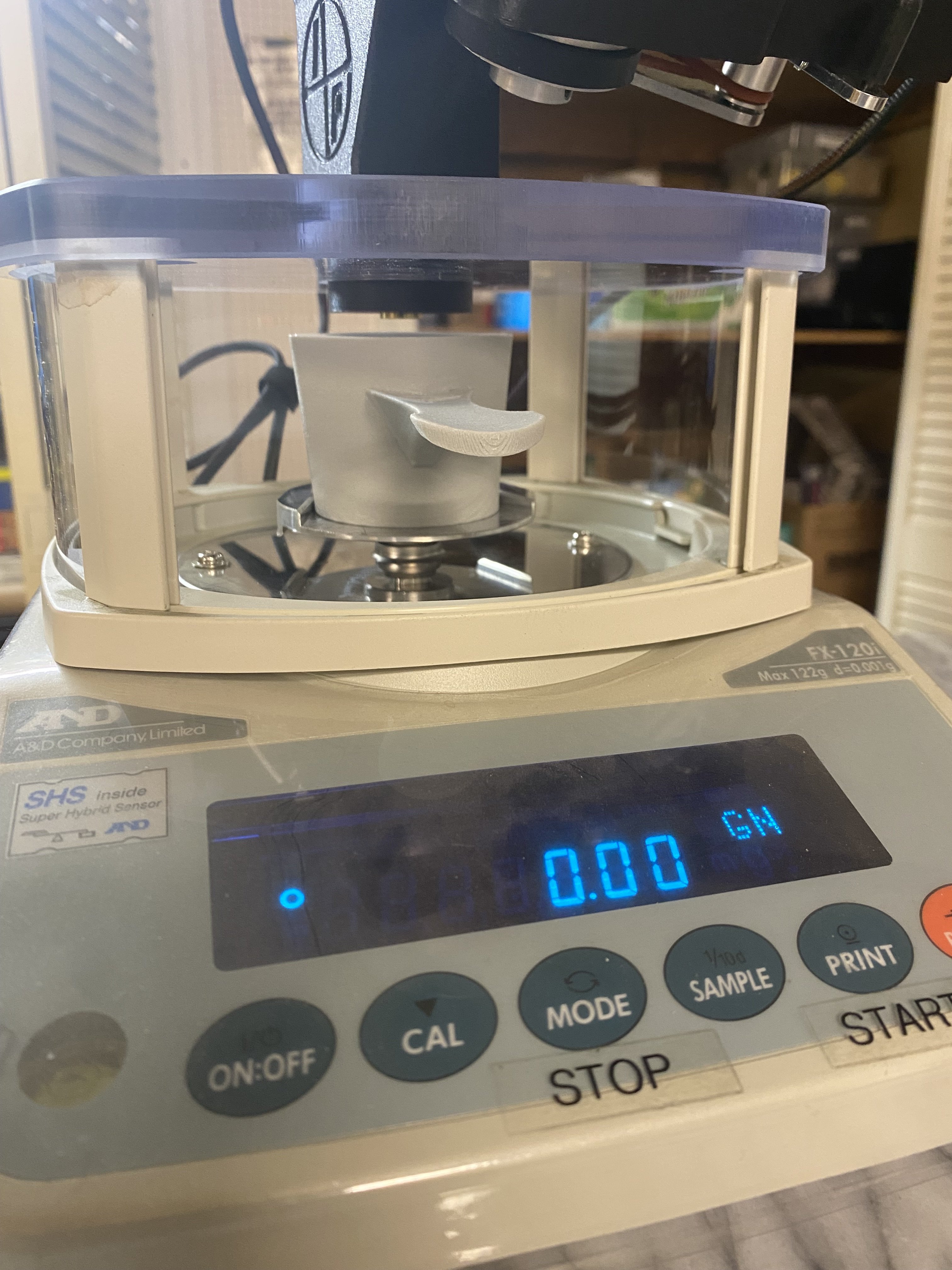

That’s kinda’ what I’ve been doing all along with my aluminum 419 cup with the weight written on it. It’s an easy way to see that the scale is still zeroed during a session.
This all went out the window when I started trying printed polymer cups because of the powder bounce I was experiencing with the new style IP trickler mount.

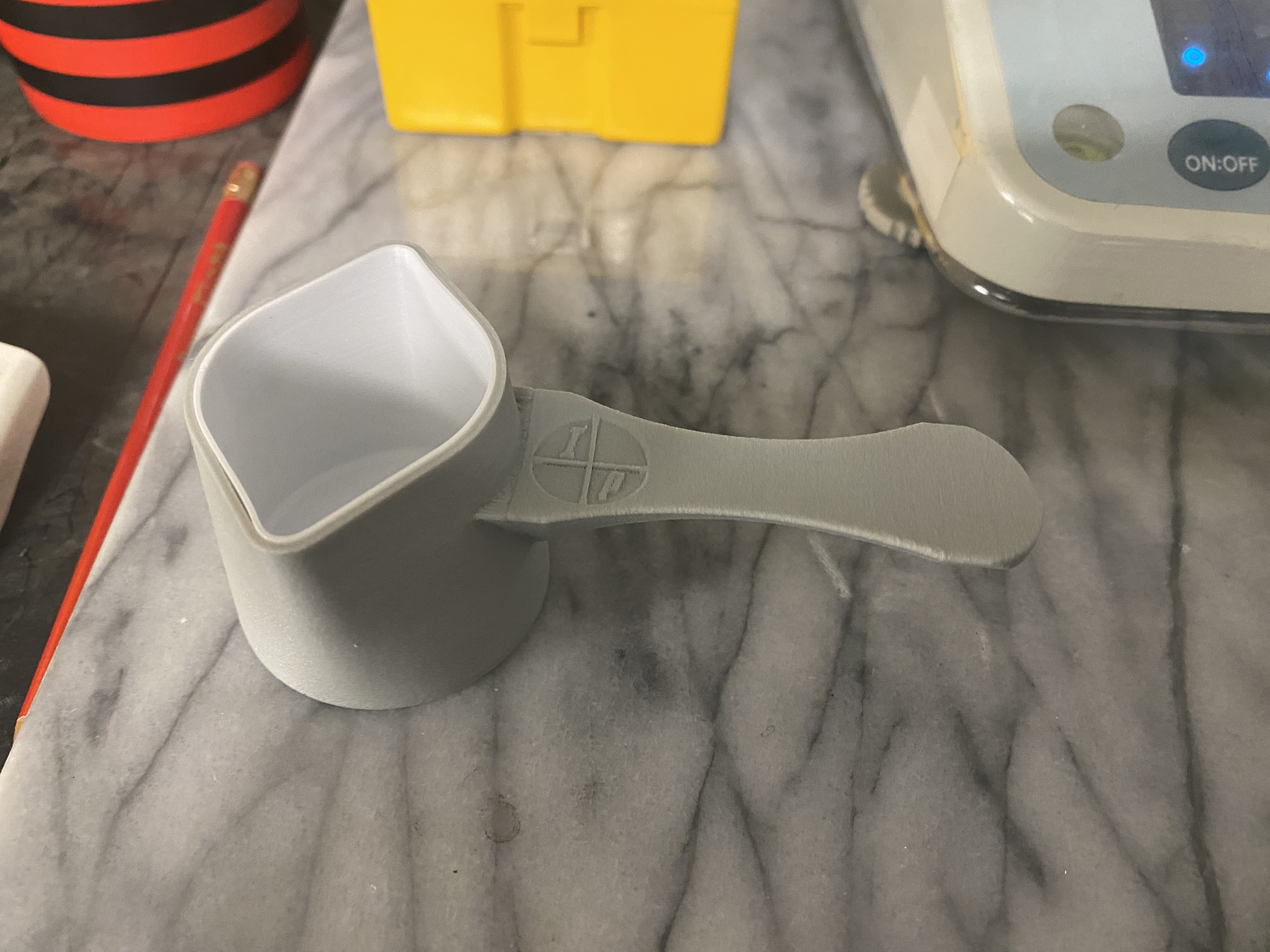

Finally got my IP cup today. Calibrated the scale and weighed it. I’ll post my findings in a few days and see if the weight changes.
