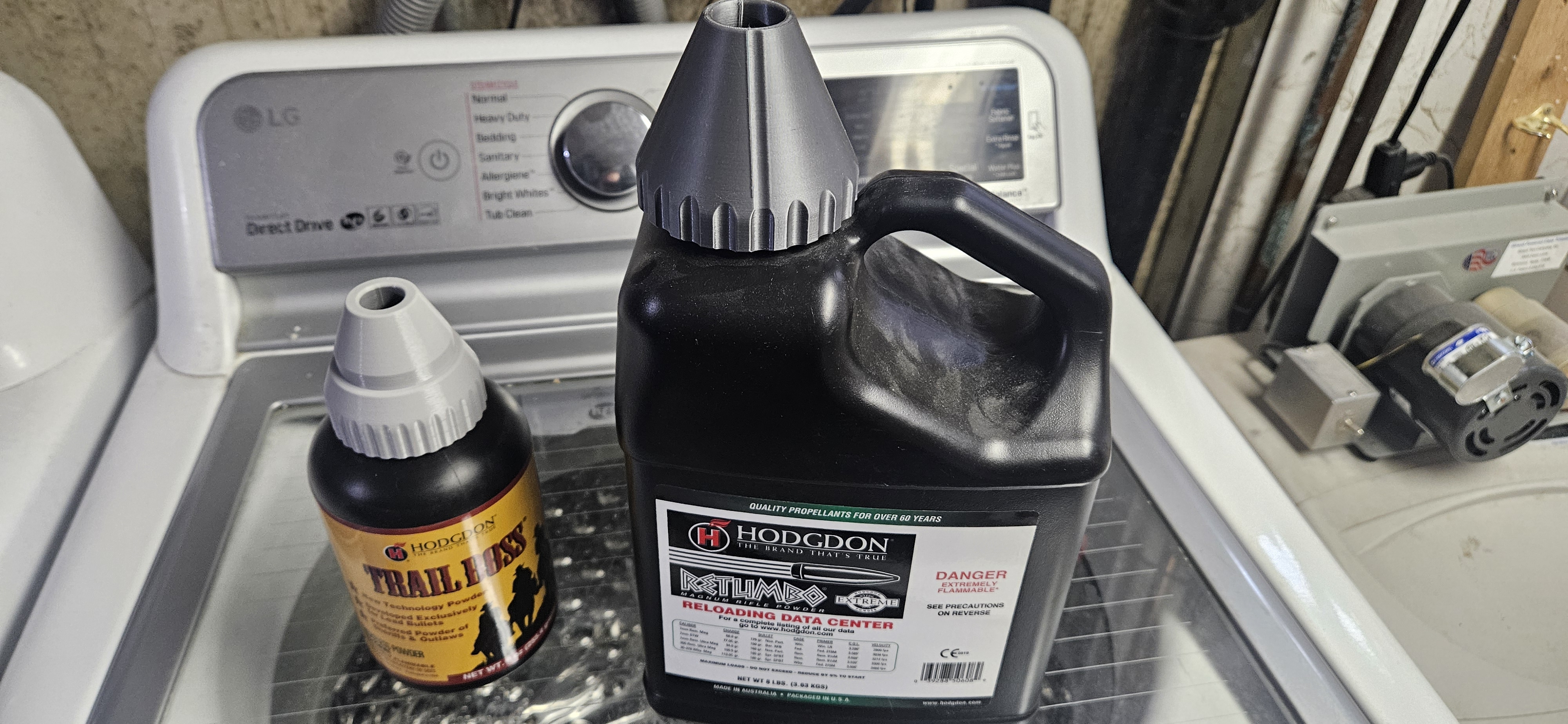

Speaking of filling and emptying throwers....
@pfl338 made me these screw on funnels that reverse to refill the jug
#solid

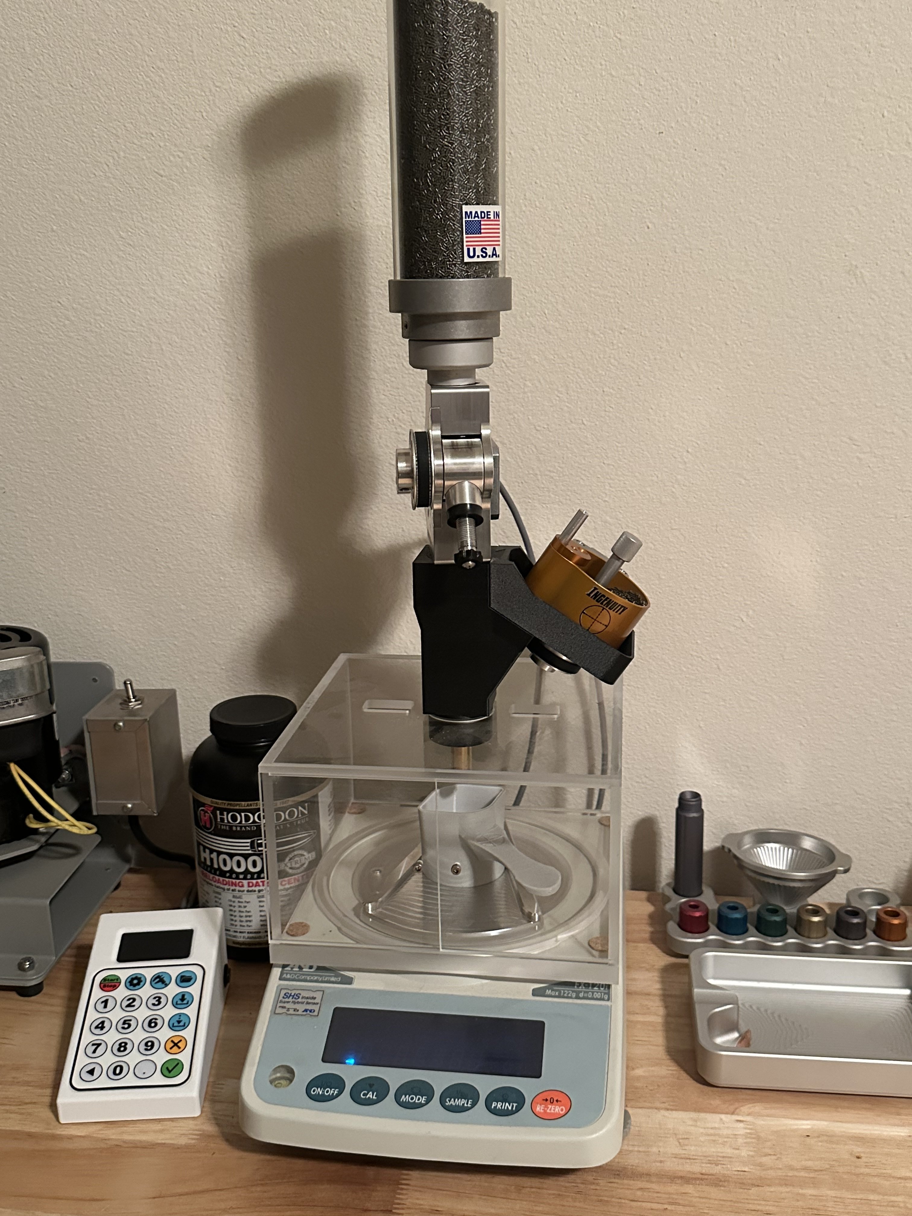

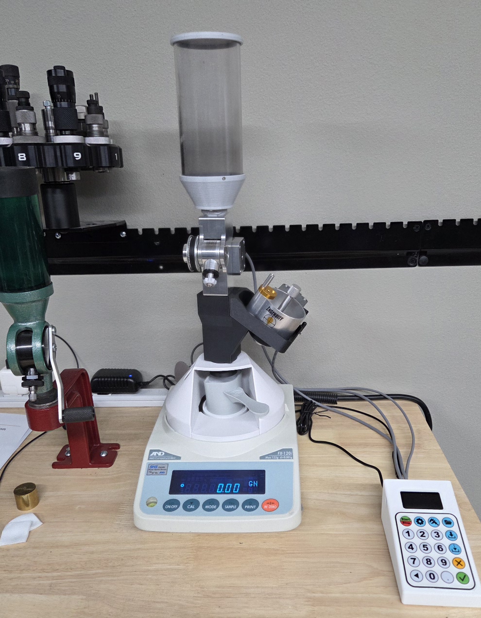

I used to run 2 tuned and modified Chargemasters for a good blance of speed (for what they are) and accuracy. My set up now is an A&D 300, IP electronics, IP trickler and a cheap Lee perfect powder measure. That set up is faster to use than both the Chargemasters at once and far more accurate at .02 vs .10 gtains. I have seen ES improve as well as my charge/seat time. The Chargemasters were just fine until I moved to shooting 1000yds to a mile.
