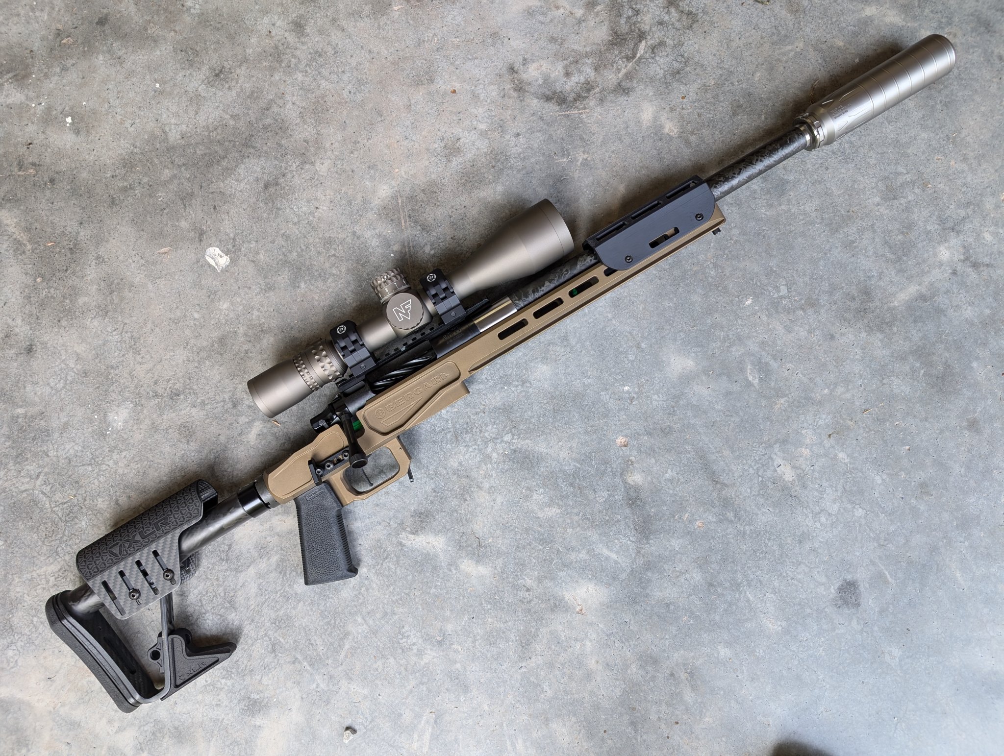

I finally got around to mounting up my 4x32 NX8 and I have been very impressed so far. I think the current batches are looking really good. This thing does not present like an 8x erector at all.
