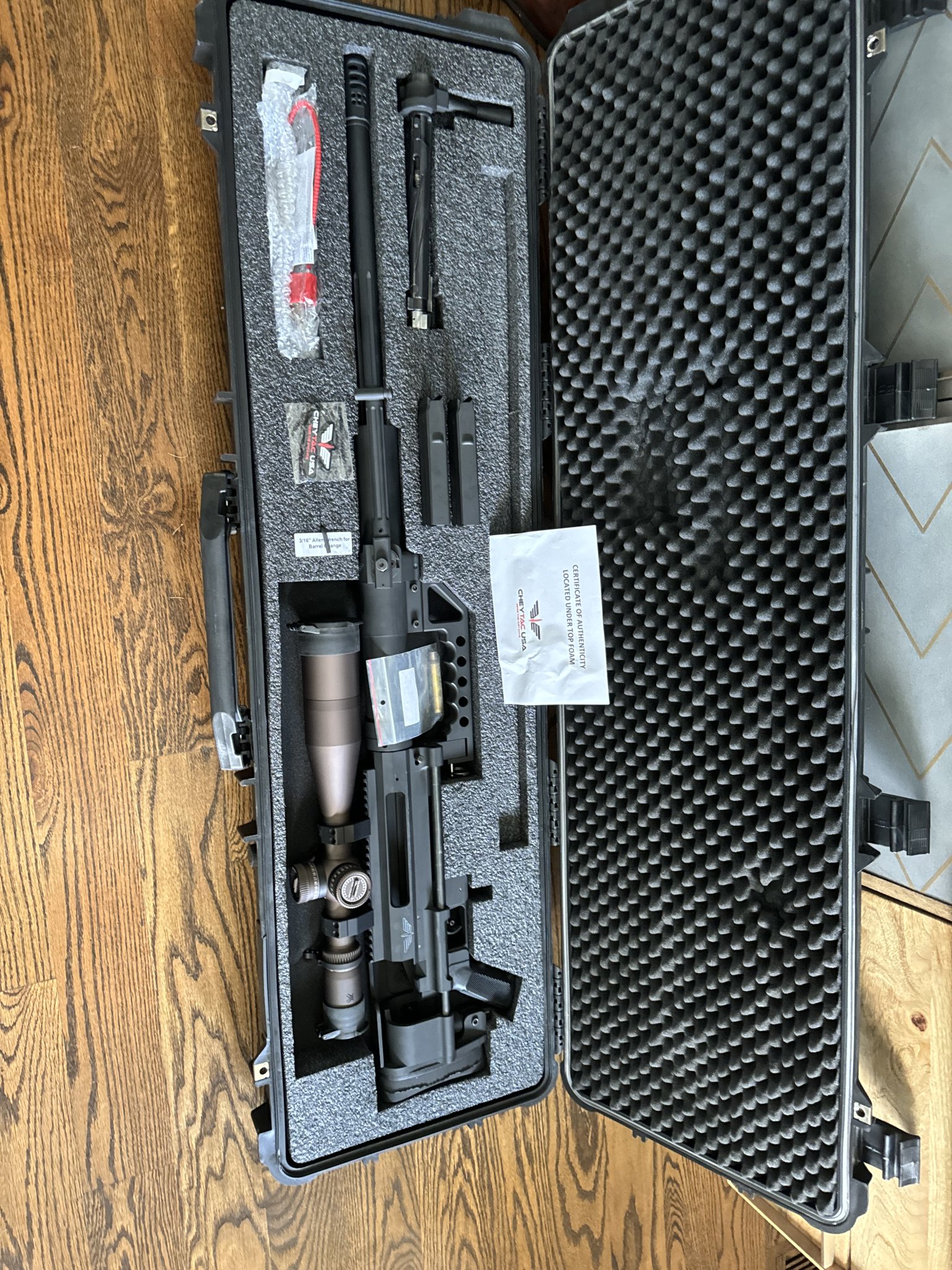

Does anyone have a list of reloading supplies for .408? First time cheytac owner and never reloaded before. But man, ammo for this caliber is scarce!!thanks for any redundancy
Starting from scratch so please bear w me. Press, dies, powder any info would be greatly appreciated. Thank you
