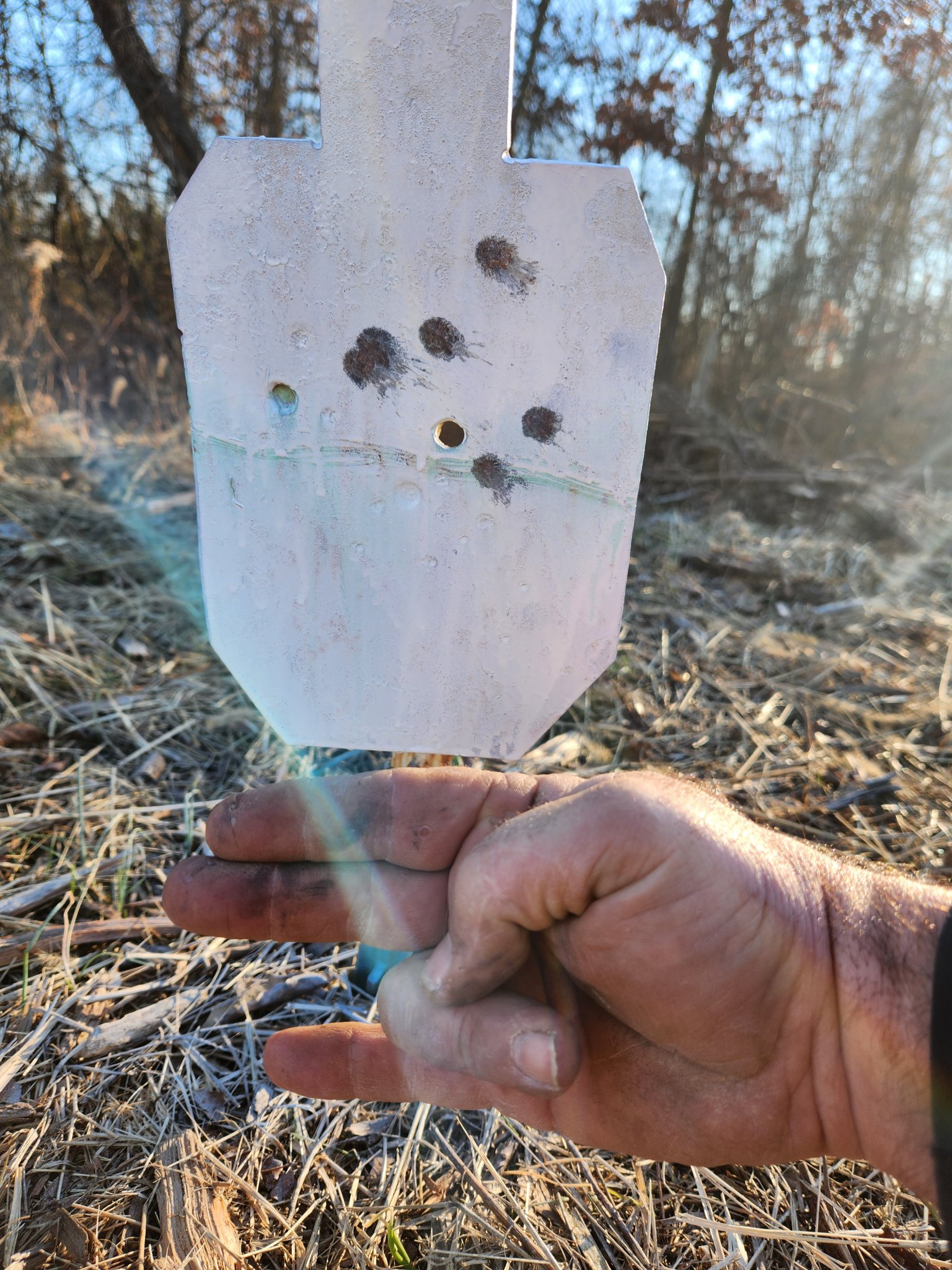

Played with it some today since it was beautiful out. Got some groups at distance and more chrono data. Ill be honest this thing has several rounds down the tube and i have never cleaned it, so that may affect it.
Anyway, im pretty happy with the results. I think it can do better, especially in the es, but a 7 sd for 35 shots aint bad. I didnt touch the tune from last time. Groups were at 7 shots @ 135 yards(4.9 mil) on the diamond, and 6 shots @ 195 yards(9.1 mil) on the mini ipsc. Btw, the Garmin is awesome, I seen one shot was low on the diamond and looked over and it was only 911 fps, pretty cool having instant feedback on that. I know its not setting any records, but good enough for plinking on an amateur tune. 40gr Zan slugs, 145 bar and 3.6 on micro

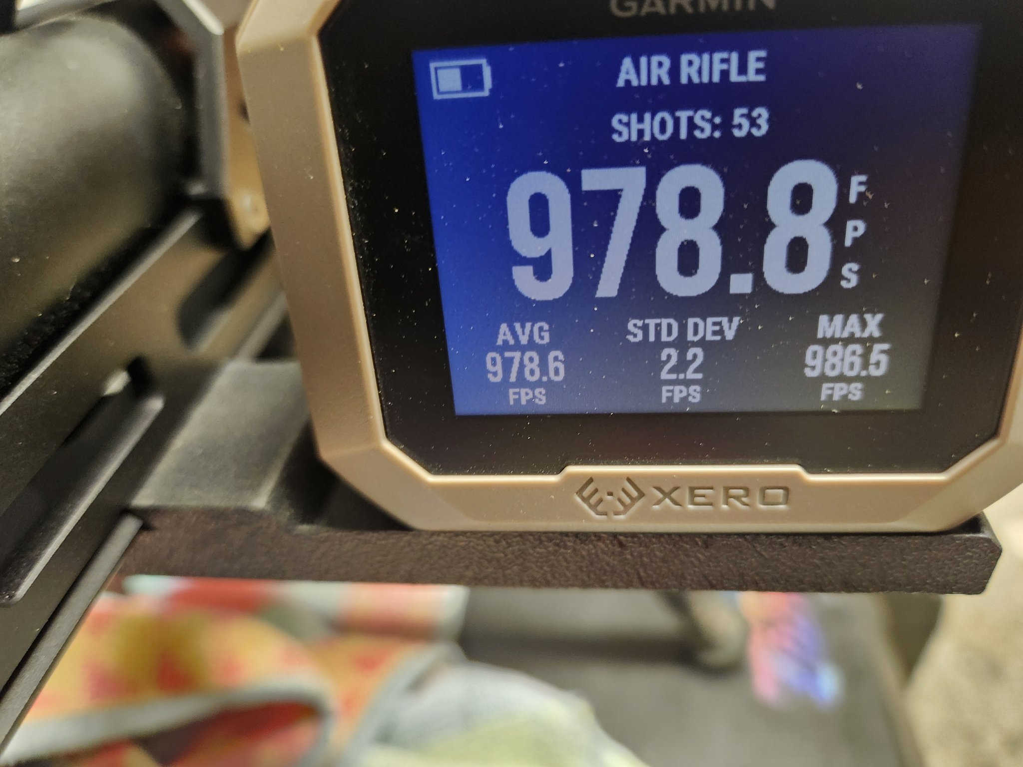

Good results. I have done a ton of indoor 25m testing on lots of variious weight slugs in my .22. However, not a whole lot with 40 grain. In the end, I ended up likely going to 30 gr and maybe 34 gr as a backup. my thoughts are that the ES is bit more of a used measurment then the ES.
Oddly in my gun, the 1 or 2 ES groups don't shoot the best. My best groups happen with an ES around 7 - 10 fps. Which is excellent in my opinon, especially when you compare it to my Vudoo's ES with the competition loads I shoot.
Also my gun must have a different spring then most other guns as I cannot get any accuracy beyond 2.5 - 17. Once I get into the 3+ it justt turns gassy and ther groups fall apart. Getting a 30 gr H&N slug at 992 fps avg with 145 bar at 2.5 - 13 setting with an ES of 7.
