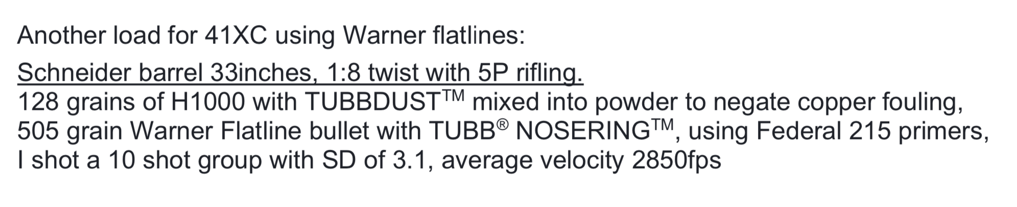

What velocity was he looking for? I'm getting 2870fps with 127gr of H1000 pushing 505gr WF. Oh and 41XC brass is cheap compared to the rounds listed above.
