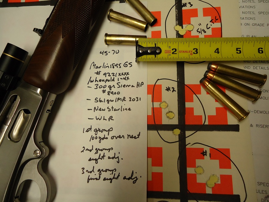

I've got a Marlin 1895GS (JM proof marked 18" barrel) /w 1-4x Leupold. I've been loading 56.1 grs IMR 3031 with Hornady 300 gr HP in Starline cases /w WLR primers. Over my chronograph this load clocks at just over 1800 fps. Accuracy is great. It will group 3 shots in 1" at 100 yards all day. I've had occasional 3 shot groups measuring 5/8" CTC with this rifle/load combo. I have some 325 gr FTX bullets but have yet to try them.
Sorry, my mistake I was using 300 gr Sierra HP in this rifle (other load specs are the same). I have a second 1895 GS with a 1-4x Nikon that shoots the 300 gr Hornady, 56.1 gr IMR 3031, Starline brass, WLR almost as well.
