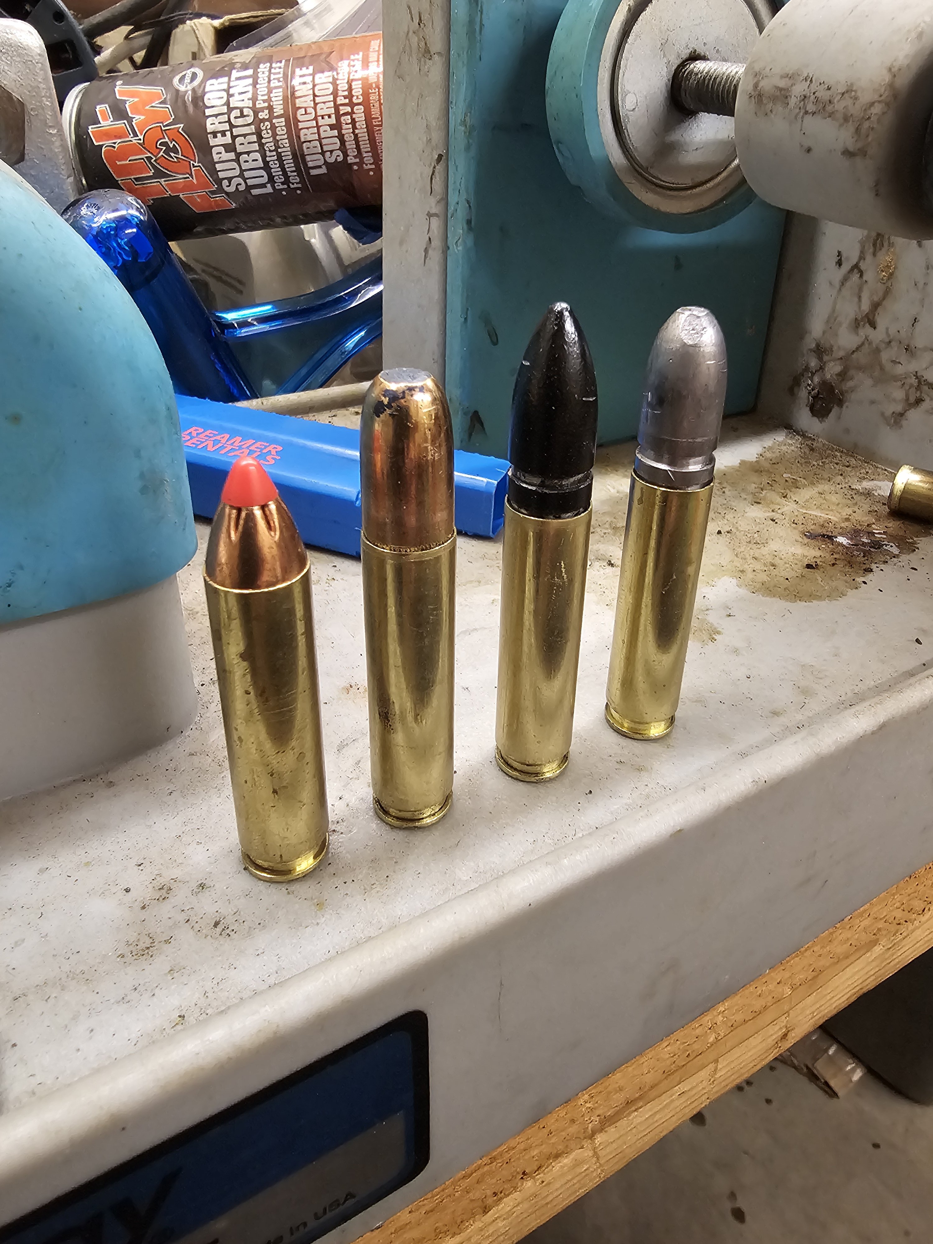

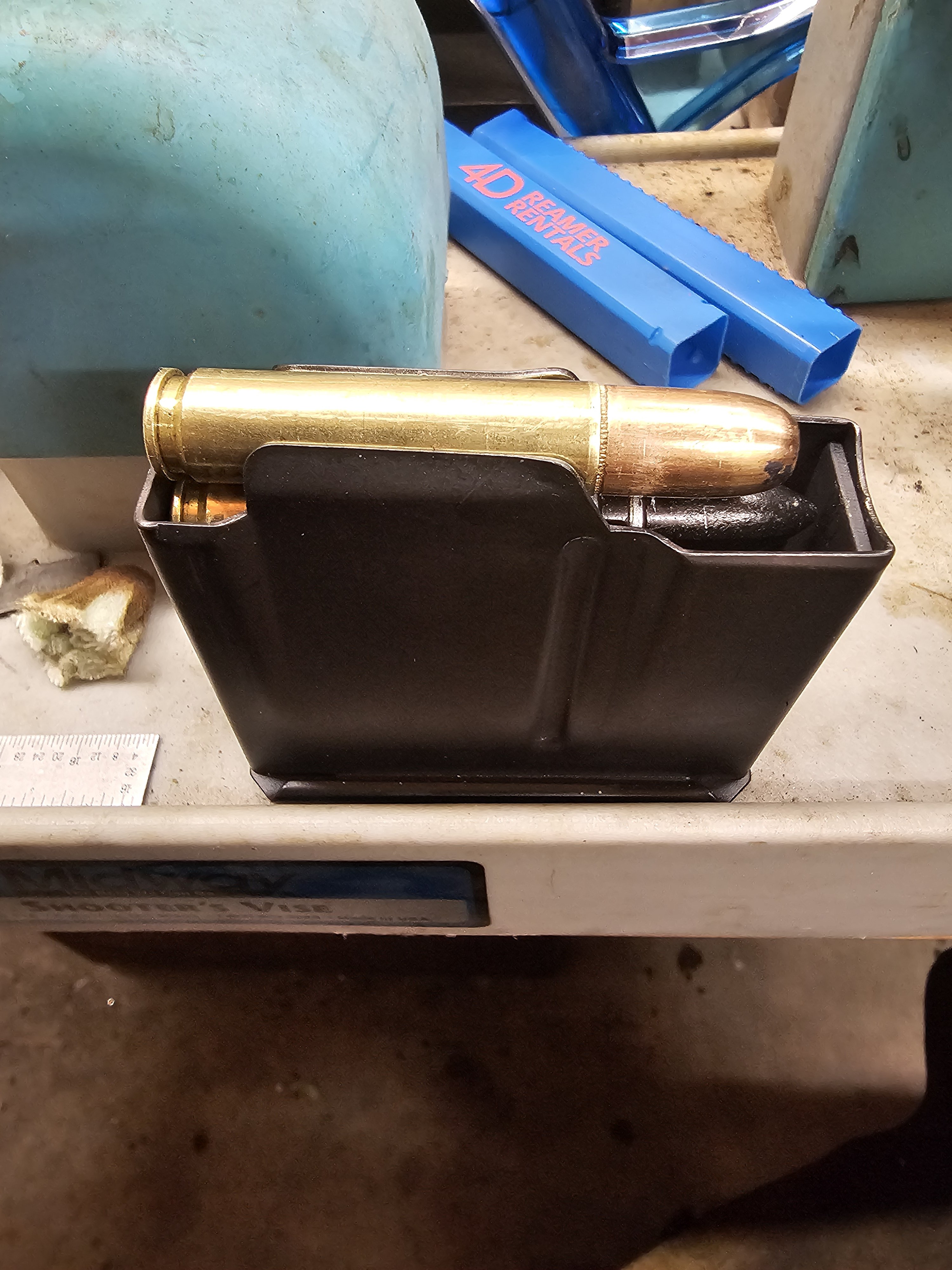

I purchased an X caliber 18" barrel with a mid length gas tube and put an adjustable gas block on it. It is on a Stag AR10 lower. It is LH for what thats worth. I have not had good luck making a mag that cycles to a decent degree just yet so I decided to just work on single shot load development. I have shot 240 XTP, and 250 FTX, 200XPB and currently I'm reloading Hornady 395 Sub-X at supersonic velocities. Using H4227 has got me around 1730 FPS. Doesn't seem too fast but it would be quite lethal to 300 yds if you get the range and drop right. I verified with a tech at Horn that it would perform ok to 2300 fps. I loaded up some CFE BLK tonight to try next time I can get to the range. It is supposed to generate more velocity with less pressure. Never a bad thing. I ordered some 250 and 275 maker bullets in hope they will work out. In my opinion, one of the major drawbacks of the caliber is the need to seat bullets so deep that it limits the powder types and volume you can use. You have to load the 395 SX all the way to the cannelure. That means .6 into the case. If you load it farther, it will not chamber. If you could load a longer bullet, you might not need a specialized mag. To do that, you would need a bullet of longer length that had a significantly tapered nose so it would work in the mag and fit the chamber. I saw the you tube where a guy was using a 500" gr bullet that the manufacturer does not list in the their listing. The H4227 load that is listed in Hogdon Reloading center for 460 sw is for a lead 395gr bullet and my load is actually has a little more powder than that. Start low and work up. When the buffer makes contact with the end of the tube next to your shoulder, you know you are shooting something. I have got some 2" groups with this load. Its fun but challenging.
