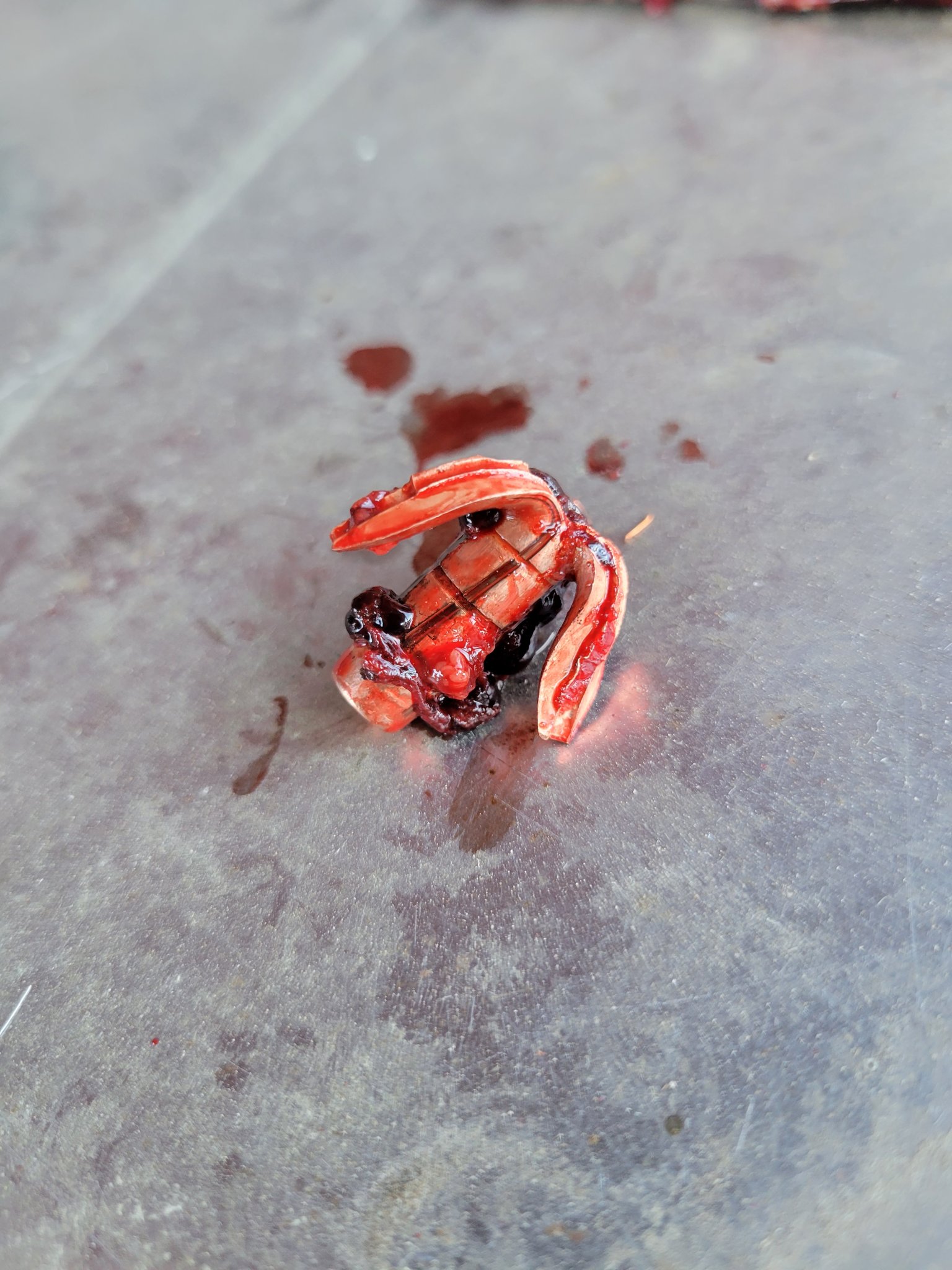

I've seen the Maker Bullets, thanks for the heads up on the performance. I've never used these but Cutting Edge was mentioned at the 450 site. I see Hammer Bullets also makes one for the BM 450. So far I have 50 Hornady 245gr SP to start my reloads once the factory ammo is shot .
I know in the 300bo shooting subs it was like a hammer. 200grain at 52 yards. The opposite shoulder looked like it was hit by a car.
