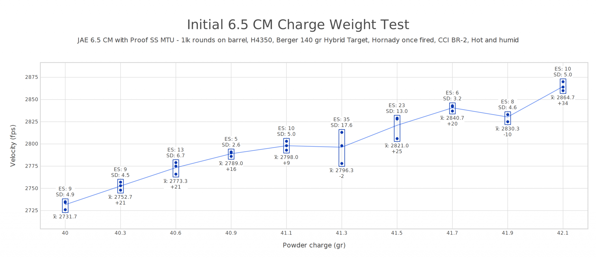

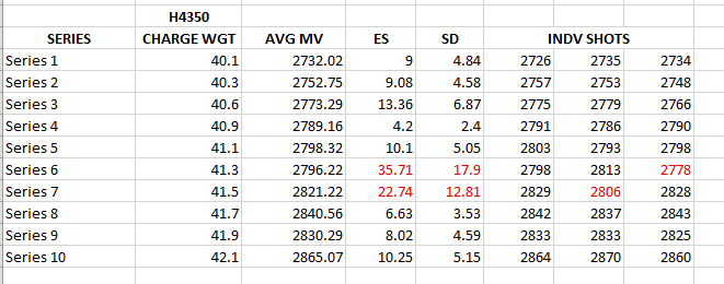

    So, got my first set of finished cartridges done...first ever...and laid out a charge weight test and shot it. Lots of data below.
    Mea culpa....I hated statistics and at 68 I don't remember a damn thing but that's not stopping me from agreeing with those who hold that for a small data set its not possible to seperate out signal from noise. But, I had to start somewhere and this test was done with three shots at each charge weight.
    Question is: next steps. I'm thinking to next load a set of cartridges and focus on the 40.9 - 41.2 range and 41.6 - 41.9 and do so in .1 gr increments. That's eight different charge weights and I'm considering increasing the number of cartridges at each weight up to five for this round of testing. If that gives me a smaller range to zero in on, then perhaps for the 3rd go I will go up to 10 shots per weight
    Not sure wtf happened at 41.3.
    NOTE: I incremented by .3 gr up to 40.9 then went to .2 gr increments with the thought that I wanted more resolution the closer I got to max charge weight. But, in hindsight, that's a bit of a mistake as it skews the slope of the graph so it seems like there is greater increase in V between the lower weight charges than the higher ones but that's due to a greater change in powder charge of those shots.
    And I really love this ChronoPlotter software as it makes it easy to see, for example, that the ES of 41.5 is driven by one of the three shots being slow while the other two are pretty much identical. Also, 41.9 shows AVG MV slowing down in increase in charge, but two of the three shots are identical and the AVG MV was pulled down a tad by the last one.
    At 42.1, I had a small amount of bolt lift resistance on one shot...that one being the one of the three with the slightly higher MV. I'm new at all of this and so I'm probably more cautious about over pressure that some of you who have more experience. However, I did make a post with pics of the base/primers and it seemed that all agreed that there were no visible pressure signs....no cratered primers, no ejector imprints, etc.

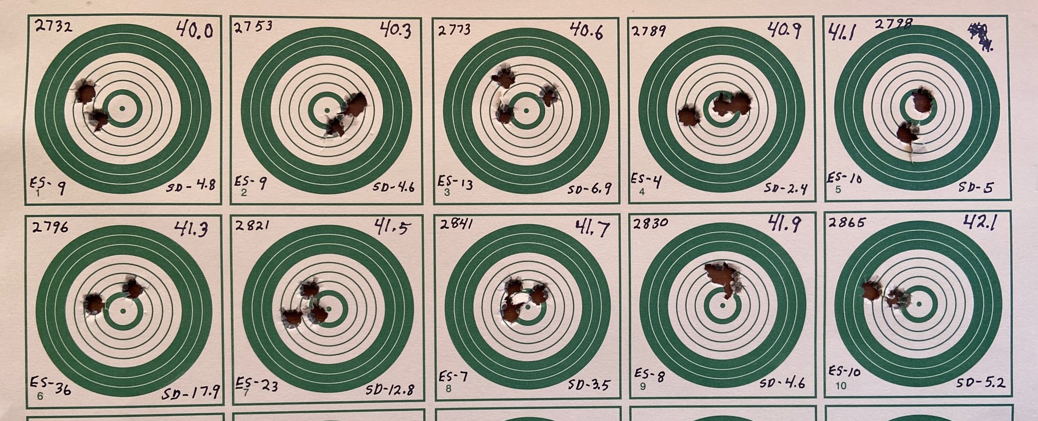

    WRT to the group sizes in pic below, I'm not that awesome of a shot that I cannot guarantee a level of consistency that would absolutely attribute group characteristics to the load and not the shooter. And...for an excuse....It was screaming hot and humid and I was being dive bombed by cicadas the entire time while trying to keep the sweat out of my eyes! haha For example, 41.5 and 41.7 are a bit open which pissed me off enough to really tighten up and I think that shows in 41.9. Either than or my barrel just likes 41.9
    Once again, I have told you my thoughts and plans but I don't know shit and I'm fully willing to discard my thinking in favor of your informed opinions.
    So, what do you guys think the next step should be?
    @Baron23 your series is actually linear.
    The tiny (not small—-tiny...) sample size is teaching you things that aren’t real or true. An sd from three rounds is not valid. An sd from 10 rds is borderline. That’s why the sd bounces up and down—-it’s not real.
    It was pretty well hashed out in the other thread that valid flat spots are so rare as to be irrelevant and not worth the large number of rounds needed to find them.
    Avoid the high end that caused you pressure signs and pick one you like. Tune seating depth for that charge weight and you’re golden.

    so, on what basis would you pick an charge to use for seating depth testing out of these? Why this one vs that one aside from the high end that had the bolt lift resistance.
    Berger loaded 140 hybrids, which shoot quite well in this gun, run about 2875 in my gun w no pressure signs but who knows what powder they use and it’s pressure rise rate. Hndy 140 ELD-M run 2805 and also shoot well.
    but I’m not at all sure that the speeds from loaded ammo are all that relevant given the diff in powder, etc.
    Where would you go from here, my friend?

    Looking at my groups, where would you go next? 40.9...and yes, I pulled that one shot left a bit. Same w 41.1. If this was your data, what would you do next?
    Well, I have Hndy brass while finding Lapua in 6.5 CM seems to be near impossible right now.
    If you like the MV at 40.9-41.1, id load up 10 rounds at those two charge weights, record them over lab radar and shoot them (perhaps two five-round groups each) on one of those multi-target
    papers and see if 1) they perform similarly SD/ES wise [acceptably low as/Es also]and 2) have identical POI centers relative to each other and 3) group tight.
    If the above three things happen I’d roll with 41.1 and take data over the course of the next 30-50 rounds shooting at distance and see if everything holds up then assuming things go as planned, put the load into low rate production (batches of ~200 per prod lot). I would gather data in the winter to ensure it doesn’t have wild swings in performance when subjected to much colder temps vs when it was initially developed and tweak it if need be. Then produce as much as I felt I needed knowing I have a reliable, stable load.

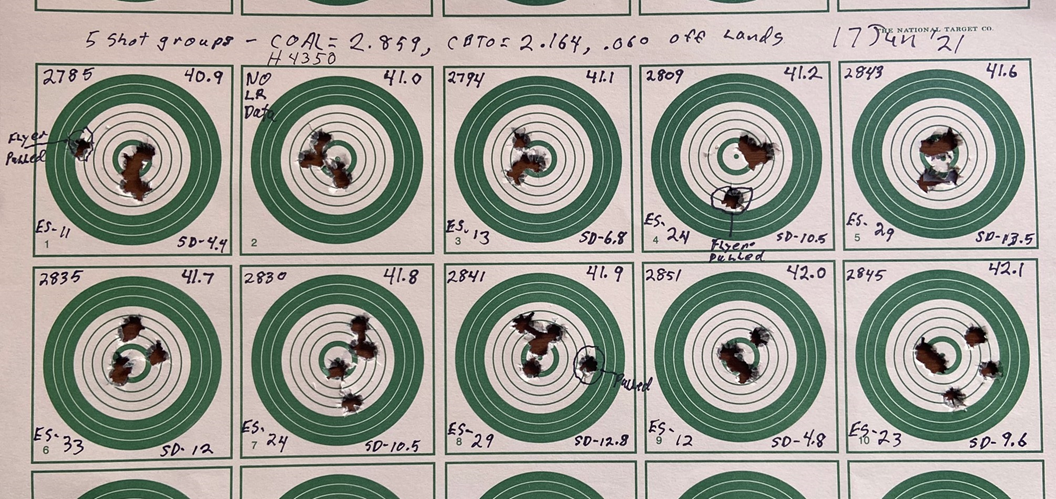

    Hi guy s- so, I'm pretty sure I have worn almost everybody out with my endless requests for input and recommendations....but maybe I can get a new crop of members to reply! haha joking
    I went out for a 2nd round of charge weight testing. For those that think I may be wasting ammo...well, maybe but this is the first time I have done this, I'm retired and need something to keep me occupied (LOL), and at almost 69 I'm not contemplating competing so I'm not terribly concerned about conserving components for match ammo.
    Based on the first test (above in this thread), I zeroed in on two ranges to explore further....40.9 - 41.2 and 41.6 - 42.1 in .1 gr increments of H4350.
    Brass was from the same sized/trimmed brass as first test, primers and Berger 140 Hybrid targets from the same box, powder from the same jug, measured with the same MatchMaster. Seating was done with the same die which was still in place and didn't move as when I seated the first test.
    Seating depth was identical in being .010 off of max mag length at COAL of 2.859 and CBTO of 2.164 for right at .060 off of lands.
    Main diff was to go down to .1 gr increments to see if I could better resolve the data AND loaded and shot five instead of three. Still not a statistically valid data set size and I still discount the absolute validity of the resulting ES/SD, but we do what we can practically and this is it.
    To help any who want to review and offer suggestions, this is the result of the first test place here again to make comparisons easier
    TEST #1
    Now, this is the result of the 2nd test.
    NOTE: 1) I failed to arm the LabRadar for the first shot of group 1 & 3 and failed to arm it at all for group 2 so I don't have any velocity data on it at all (must have been a bad biorhythm morning haha). Also, note the general differences in magnitude of ES/SD for test 1 vs larger numbers of test 2 which is why I stressed that they were loaded identically in every way I could think of. I personally think this goes to sample size...yeah, while still not statistically significant, five shots vs previous three does give more opportunity for variations to show in the set. I feel confident that if I had continued to shoot either set that after a sufficient amount of shots, the ES/SD would converge on some reasonable numbers.
    So, here is the second test results. My uninformed view/plan is to go with 41.2 and leave seating depth where it is. The barrel has approx. 1k rounds thru it and due to throat erosion (and maybe how it was chambered), I cannot get any closer that .060 off of lands without running into mag. length issues. Can't go any further out and I expect over the remaining barrel life (about another 1,500 rounds or so) to have another 45-75 thousands of erosion which will increase my jump from current .060 to .105 to .135. So, I just don't see going any deeper right now.
    BUT, I am open to input, recommendations, corrections, or even derision....bring it on. I would love to know what you think of I my test and plan outlined above. Thank you in advance for your time.
