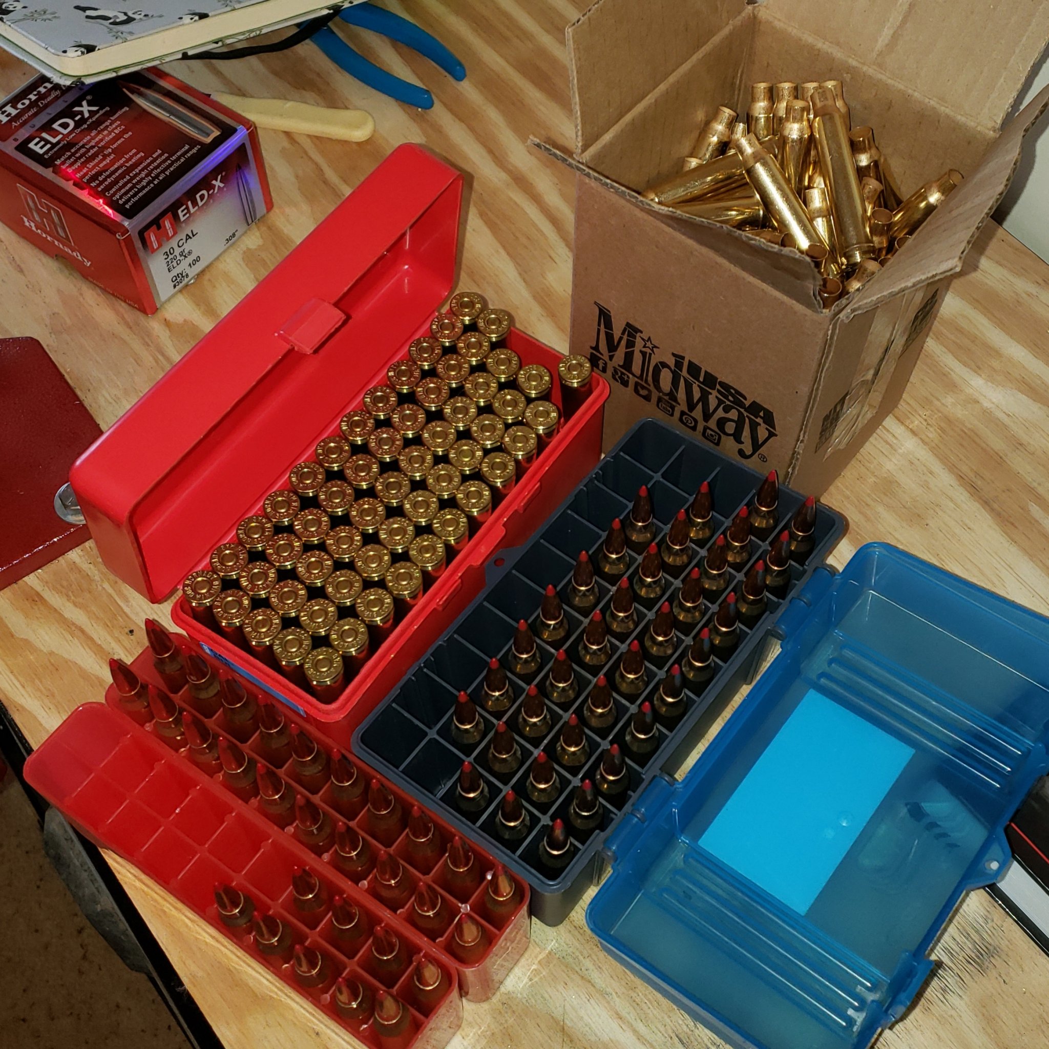

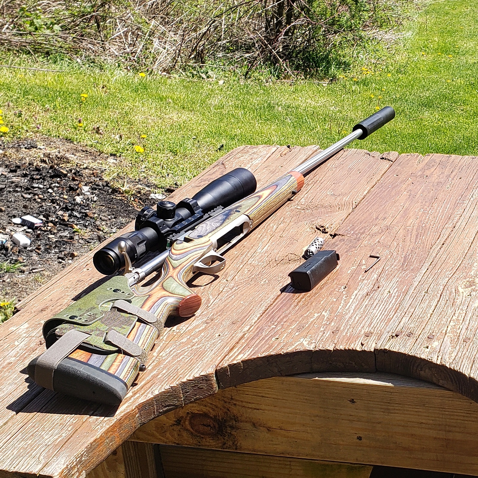

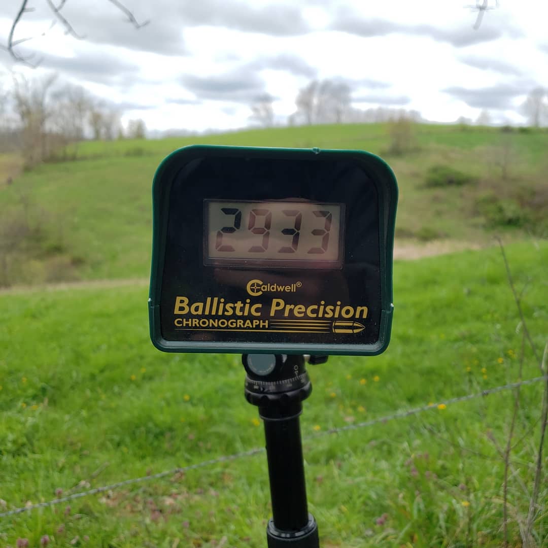

🤣 Ok that's bs. Glad you're here though. Im getting sub 1/2 moa going 0.100 off the lands. I just rechecked the rifles chamber to make sure. The internet is full of "0.001 off the lands" advice. I tried that with different loads and it was never good. Finally backed out to 2.770 and walaa. Bullets stack. Sub 2" at 500 yards. So, is there any merit to the 0.001 off the lands? What's your distance from the lands?
300wm, 77.8 Retumbo, 220gn eldx, 2.770 ogiv, hornday brass, win large mag primer. X bolt LRH. Boyd's stock. US optics FDN17. Bradley cheek riser 👍

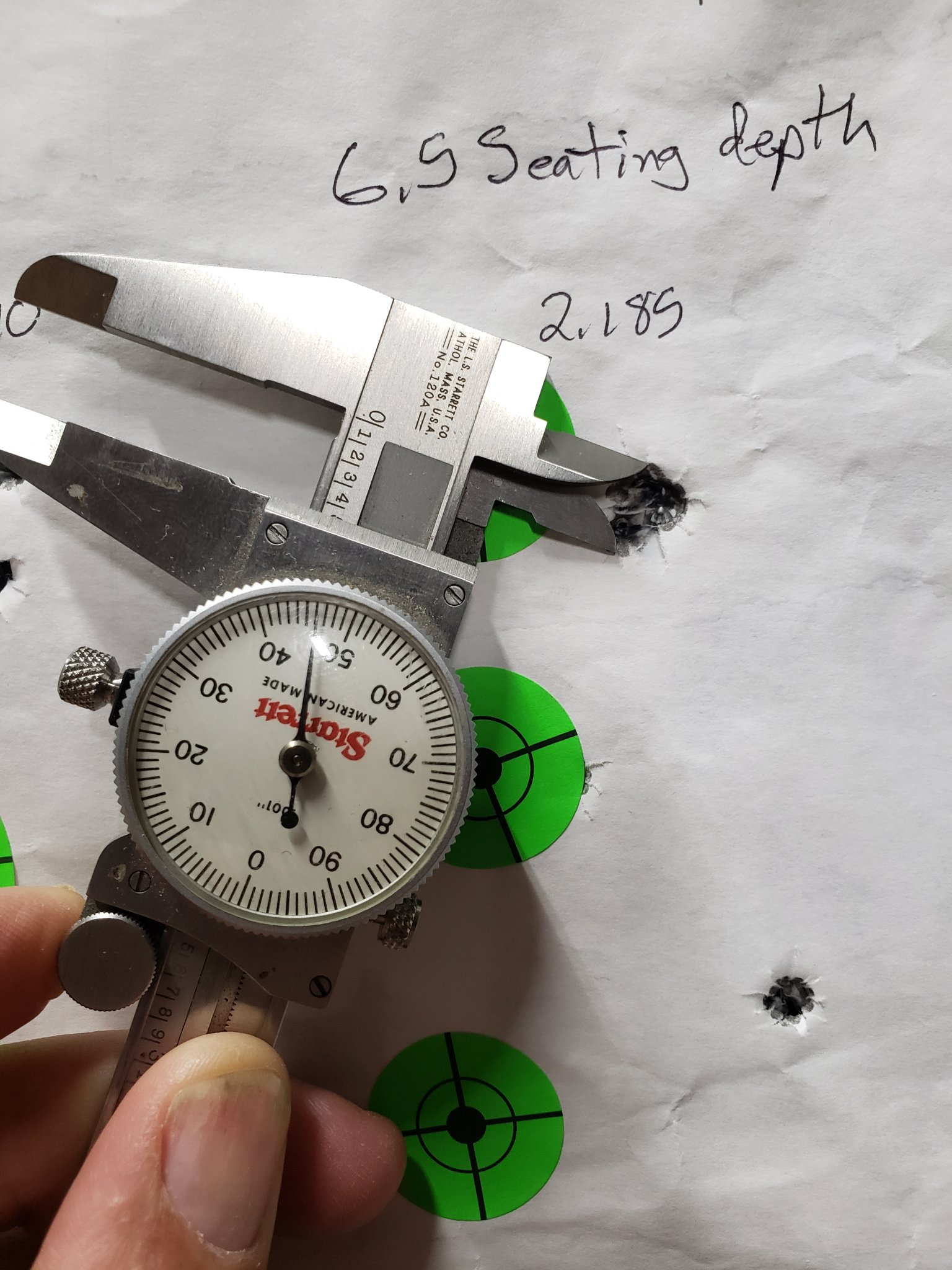

Mine is different for each bullet, I got my best results in my 6.5 cm pushing 140 eldms at .020 off, but with the 130 rdf I was at .070.
I think different bullet styles do better with different jump lengths, some are very picky and some can be loaded anywhere and almost no difference.

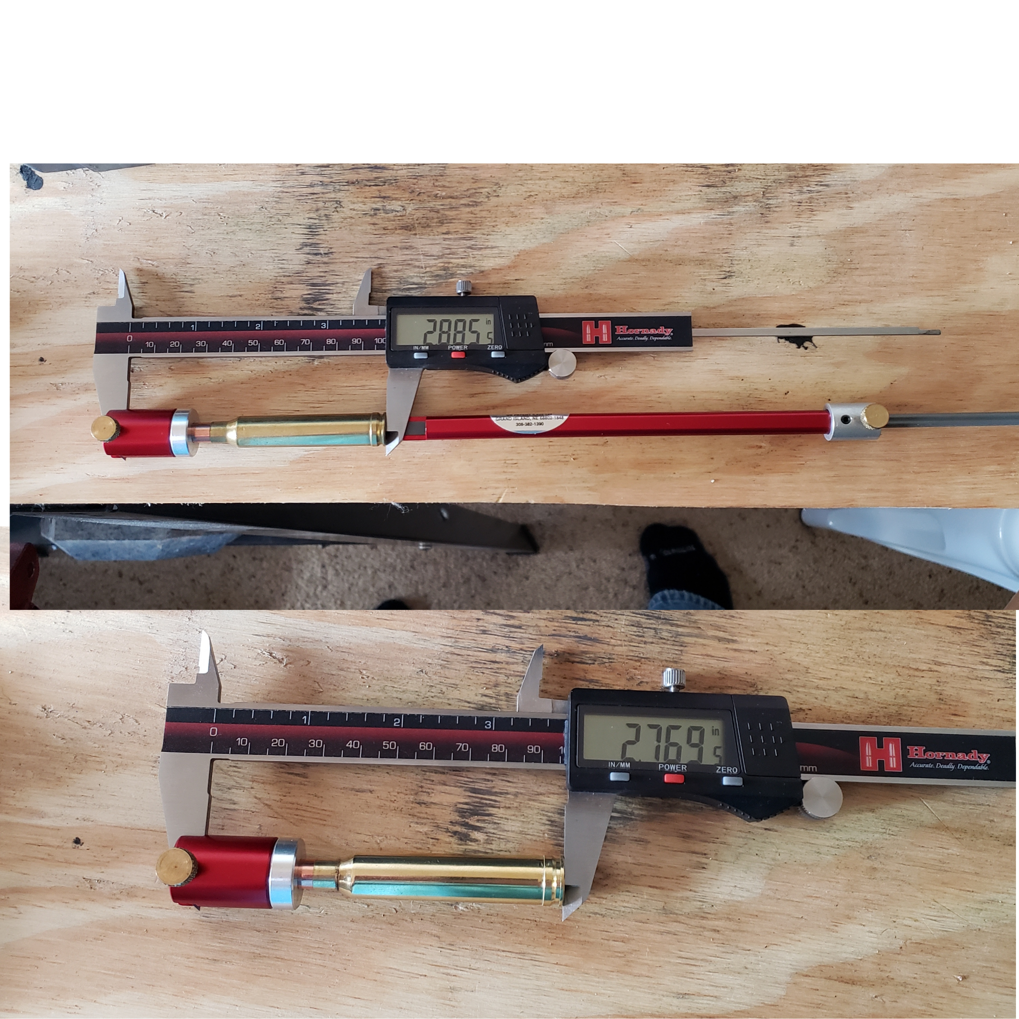

After reading the Precision Rifle Blog, I did a seating test on my new 6.5 Creedmoor barrel with the 140 ELDM. I had a load that shot in the .25" range that was loaded .020" off the lands, so I seated 10 each from .025" to .060" and shot them at 100 yards round robin style, 5 shot groups. The .055" shot the best at .18", but everything was less than .35". I shot 3 of these on steel at 416 yards, but didn't have anything on hand to measure the group with, measured the knife in the picture and it looks to be just under 3/4" center to center.

Sorry for the tangent but which methods and tools do you folks use to measure ogive to lands distance?
Just takes a few tools. An OAL gauge, brass, bullet, micrometer, and that thing on my micrometer. Comparator? I think. The OAL gauge pushes a loose bullet into you barrel. You lock the push rod in place and then remove everything from your rifle. With the oal gauge out, put the bullet back into the brass until it hits the pushrod you locked into place. Now measure the bullet from the ogiv with your micrometer. Simple.

Worked fine on my 243 and 300wm. Both under 1/2 moa at 100 the 300wm is much better than 1/2 moa at 500. Gotten the same measurement from my 300wm for 3 years now. Just did a velocity check earlier. 2933 and 2923 and error. First round I wasn't aimed flat over the thing and cause the error. Same velocity as last year.
Hey man, I am glad it works for you. I just cant seem to get any consistency out of it.

I'm just over the max col. To be honest I can't say that the Hornady OAL gauge reading is true. It just give you a starting point. If you press harder or lighter when seating the bullet with that tool you can change the reading. When I say .1 off the lands what im really saying is ".1 off the measurement the OAL tool gave me." Im sure, if you are truly after perfection, there is a better way. All good guys! Thanks

After reading the Precision Rifle Blog, I did a seating test on my new 6.5 Creedmoor barrel with the 140 ELDM. I had a load that shot in the .25" range that was loaded .020" off the lands, so I seated 10 each from .025" to .060" and shot them at 100 yards round robin style, 5 shot groups. The .055" shot the best at .18", but everything was less than .35". I shot 3 of these on steel at 416 yards, but didn't have anything on hand to measure the group with, measured the knife in the picture and it looks to be just under 3/4" center to center. View attachment 7307303View attachment 7307304

Red tips up are life cycle 5 to 8 brass that's about to start not holding primers. Red tips down ars stupid levels on consistency built. New brass is here but after all this discussion Im gonna wait. **surprised to see everything I typed still here** Left this on read. Barrels change! I went to 2.770 because it was a generous feed. Buttery. But going to 2.75 wouldn't be an issue. Hodgdon should do some tests with more than min load jammed into a rifle barrel. That's why I posted this really. I don't think 90%+ of us needs to be chasing the distance. But when you look it up. 001! I think my 243 is 2.430 just because I'd be able to remember it. I think. It's written down. Out put great retention eh lol
