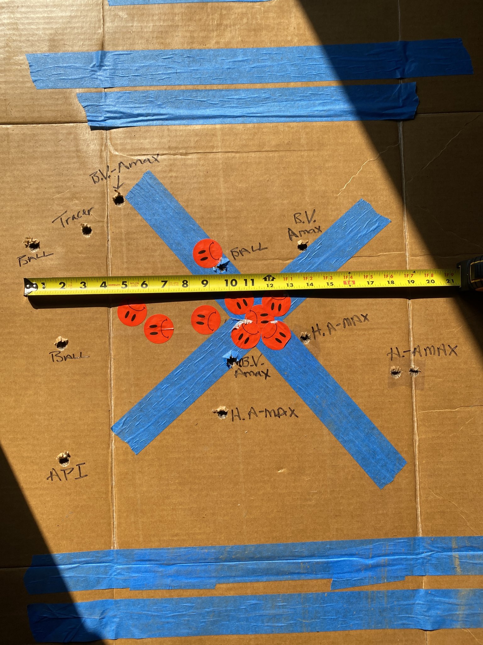

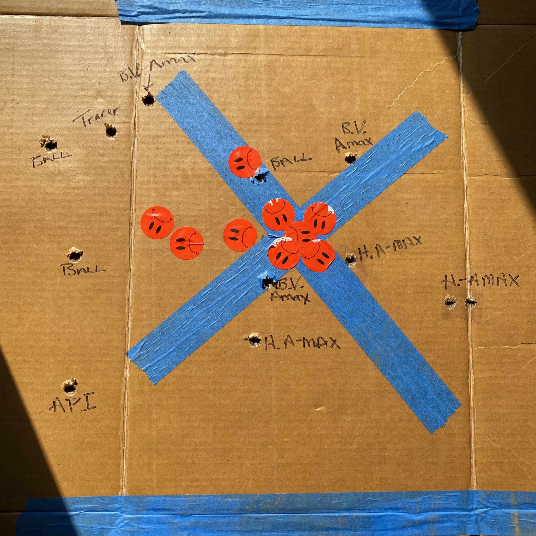

hopefully it will let me attach a picture this is what I shot yesterday at 300 yards I am all out of the Hornady A-max I only have the Bitterroot A-max left and plenty of PMC Bronze and military ball.

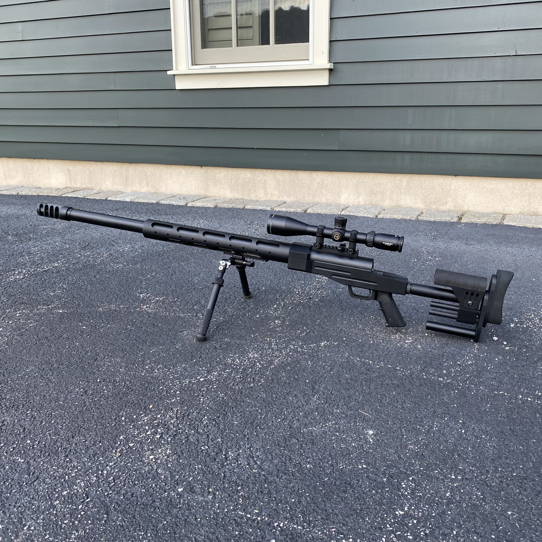

Noreen ULR Rifle mounted in a XLR Chassis that was specifically designed for the rifle if you’re not familiar with Noreen Firearms out of Belgrade Montana you can check their website online they still sell the rifle. Atlas BT-72 Super Cal bipod on a pic rail off the barrel shroud, I will admit I thought this was my weakest point the movement (wiggle) there is very noticeable but it’s the same on my other rifles different calipers of course but they all shoot fine with the same type of set up and I have played with loading the bipod light-medium and heavy and the accuracy doesn’t change. Also I have deleted the bipod theory of potential accuracy issues and have shot off a very steady bag to no avail, at least no difference from me. Let me know what I’m not answering for you. Thanks.

I will admit to not being any kind of expert with a 50, however, I do feel I can help answer a few questions you asked.
When I mentioned cleaning all I will say is that when I first had the gun I’m sure I over cleaned it and scrubbed it with a brass brush more than I needed to could I have ruined my barrel?
No, I wouldn't think so with a brass brush, unless you cleaned this thing an unbelievable amount of times or did so incredibly poorly.
One question I would like answered is, is there any truth behind someone telling me that shooting this cartridge at 100 200 or even 300 rounds I will have worse grouping than if I’m shooting at five or 600 yards, that this bullet stabilizes and calms down the farther it goes out? True?
No, not true. You may happen to shoot a smaller group further out occasionally but that is coincidental and that group would have been smaller at a closer distance had it been shot at that closer distance. The bullet should be settled completely before it is even 40 yards down range.
My best guesses in no particular order would be scope, mount, rings, ammo, or shooter. If you already checked the torques on the rings and base I would try a different scope (50s can be tough on scopes). If that doesn't help I would try a different ammo. Finally, if that doesn't help I would say try to find another good shooter in the area to try it as well and see if they have the same issues.

Move your bipod out as close to the muzzle as possible. It's more stable.
Also I think there is less movement at the muzzle with the same amount of movement compared to if it was closer to the trigger. Something about fulcrum points and radius. Could be wrong on that. If someone could tell me if I'm correct, or an idiot.
