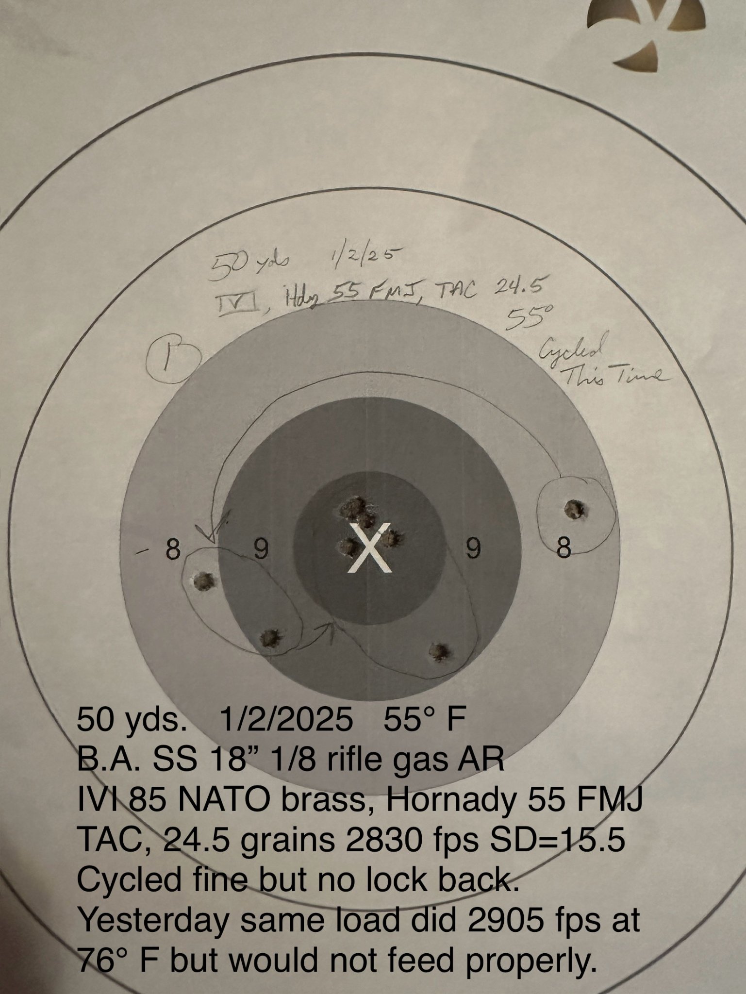

Yesterday I went back out to the range for further testing with the 55’s. Long story short, everything seemed to work better at first. It was 55° as opposed to 76° the other day when I had such problems. Not sure if this was affecting things. I was zeroing a scope this time instead of Romeo 5 + Juliet 3 magnifier to be a little more precise. I mounted a Burris E1 2-7x running at 7x.
I used my remaining 55’s in IVI 85 NATO cases and 24.5 gr TAC. These are the ones that gave such problems the other day. They ran fine. ???

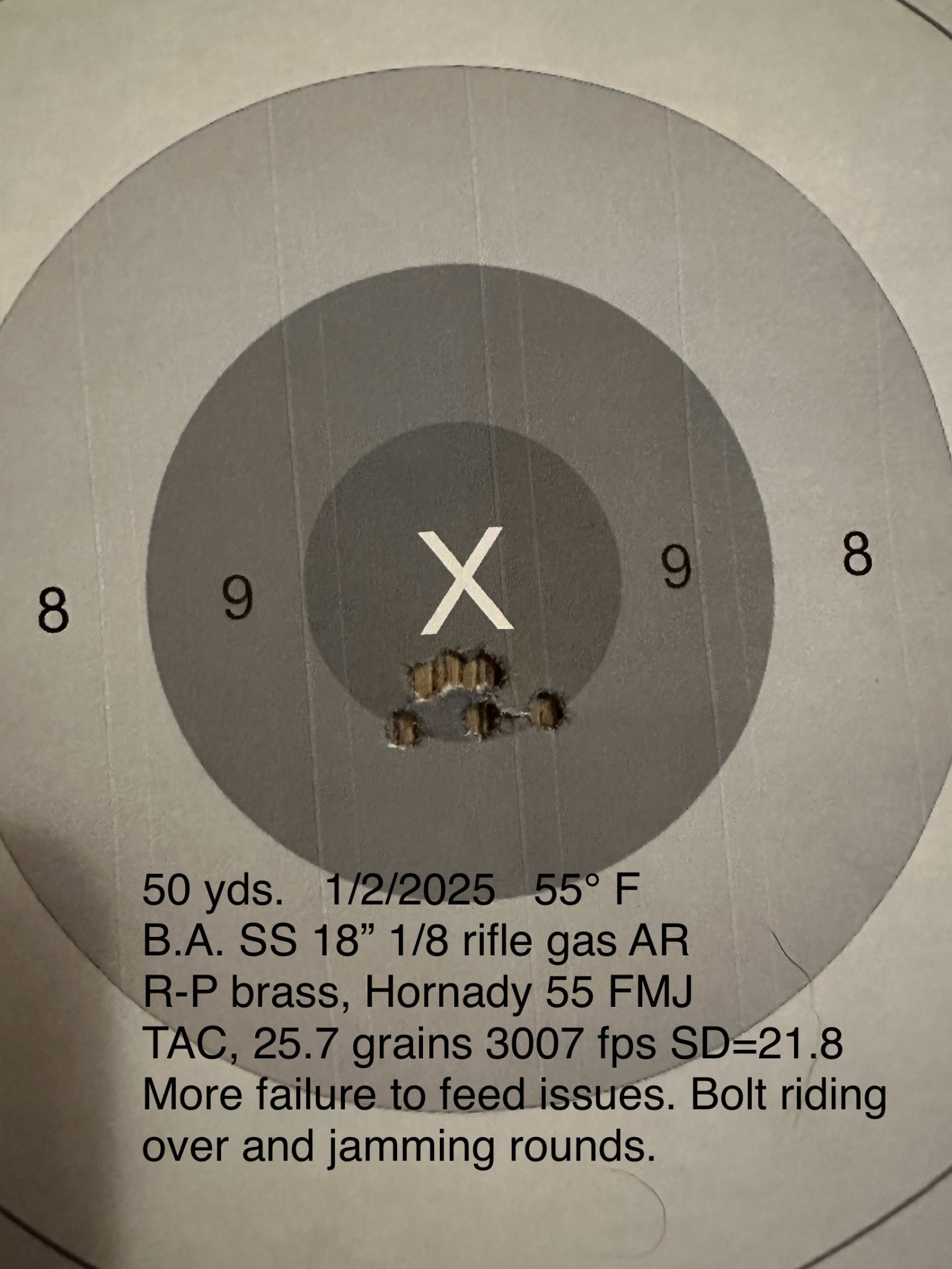

Just didn’t lock back. I continued with increasing charges in R-P brass and started out fine but progressively got worse, even once I broke 3000 fps. It must be a gas issue. Probably my poor alignment.
Here are my results from range tests yesterday 1/2/2025. 55° at 50 yards. I tested mostly the 55 grain bullets with increasing charges of TAC powder. I did test one load of N–140 under 77 SMK’s. Those seem to function fine, and lock back. The first target shows my adjustments to zero the scope with the final five shot group at center. As you can see that particular load of 24.5 grains TAC groups nicely. If only it would cycle properly.

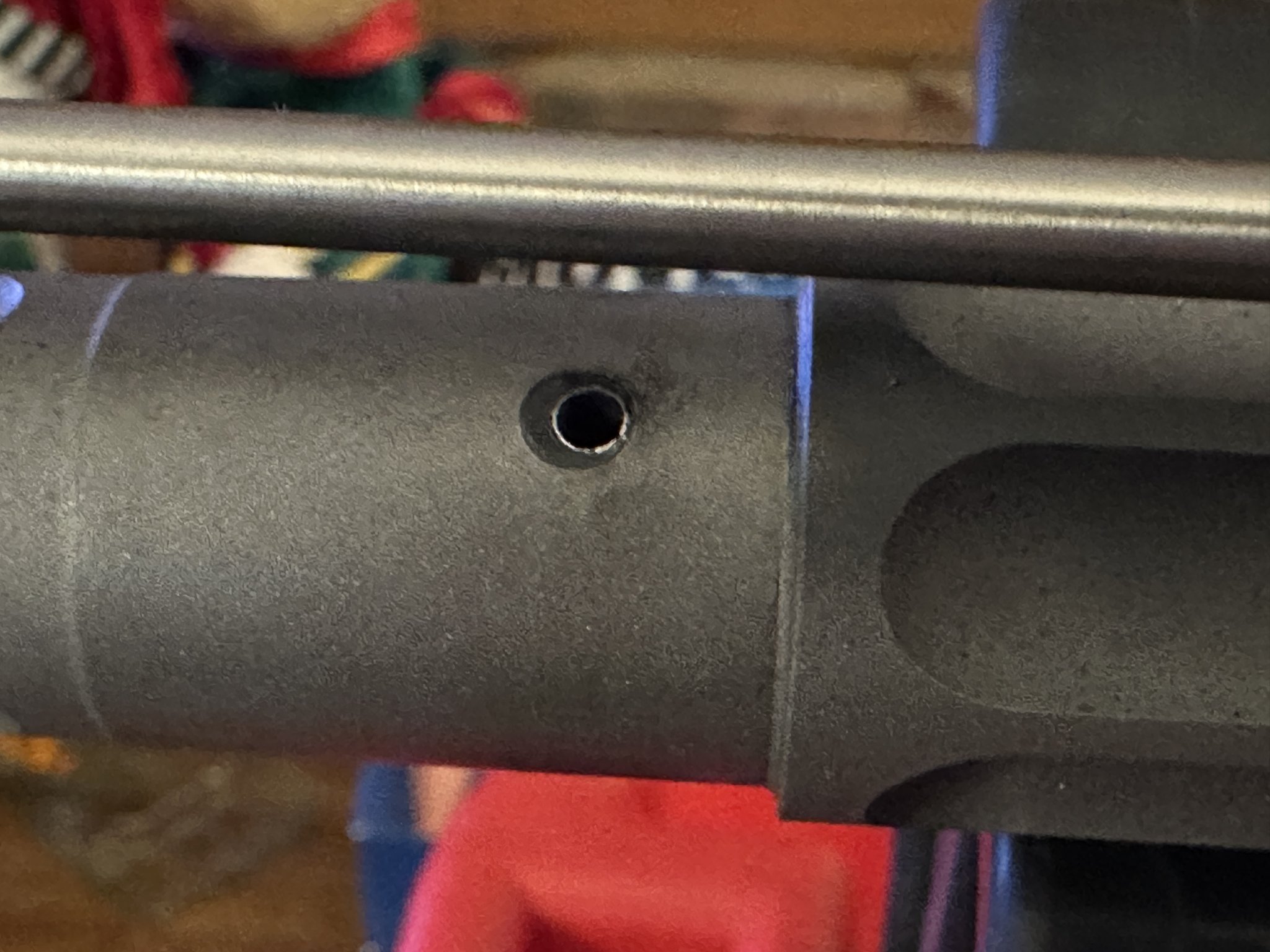

Looks like gas block was lined up enough. But I discovered I have failed my marine corp training/ brainwashing and never deep cleaned my rifle since the last time I shot with a suppressor. It was disgustingly dirty. Not sure if that would lend to the issue. If not, the only other possibility is gas port too small.

I am Marines. I am not brainwashed though. Anyway, here are some observations.
There could be some excessive leakage of gas. and the gas hole looks right. it should be around 82k in size. What you can do is "chamfer" the gas block slightly so its more forgiving. Also, check how clean the gas tube is, see if it flows easily. Blow on it. Doesn't look bad. I still bet on gas issue. In 55 grain bullets (TAC), all AR15 should cycle as low as around 24 grains or even less. Optimal load for 55 grain using TAC is 26.0 grains.

I did blow on gas tube to check clearance. It’s fine. I cleaned thoroughly though. Che led gas key and it’s tight. I noticed a lot of gas residue around tube where it enters upper receiver. I’m going to get it all good and clean and try again, picking up where I left off at 25.7 I believe it was. Will ease my way towards 27 if I can get it that far. I really shouldn’t have let my weapon get that dirty. Now I’m pulling out all of them one at a time and doing a thorough clean. 🧽
Try this .... Spray Free-All all into gas tube. Let sit for a minute or two then blow tube out with compressed air. Free-All has chemicals in it that dissolve powder and carbon . This fixed my issue that occurs after shooting dirty ammo

It has been suggested to me that my bolt may be traveling too fast since it tends to override the next cartridge and jam it in the chamber, halfway pinching the cartridge. I’m not sure if it matters, but one thing I neglected to mention was my ejection pattern. Most all rounds that function properly and the ones that would not cycle properly or caused an override or ejecting at about 430 and would sometimes land on the table next to me or go out 4 to 6 feet. I believe some of the ones on the table were just being caught by my range bag and they would have gone on out further. I will finish cleaning the gun and lubing it today and will reattach the existing gas block and tube to try again and possibly try a heavier buffer to see what happens. Removing the gas block tube will require cutting the pressure washer off.

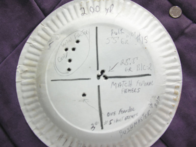

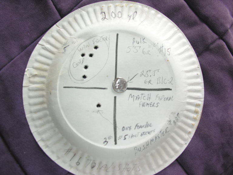

MEASURE the port while it's open ,BEFORE doing any Drilling . IF it's not 0.088" MAKE it so for 18" tube Rifle gas .
I run Mine at 0.092" ,yet all My barrels are minimum 20" and I've had zero issues with any factory ( other than Turan M193 crap ) loads or hand loads . Either that or run a lighter spring ,as it's not allowing the bolt full travel ,thus not locking back .
Below with a Bone Stock XM15 A2 Bushmaster 20" ,in Early 90's at a LEO shooting event ,demonstrating precision handloads .
Same POA ,ran #5 Winchester white box crap ,then one of My foulers purposely low . I then popped #15 bulk 55 gr. Winchester bullets W/C no less ,using 25.5 Gr. BLC-2 all cover with a dime and leave change at 200 yd. Hell I was using a Simmons AETEC scope and off the turf with NO mat just a pack for a rest . I later swapped out that scope with a Nikon Monarch 3 .
Don't ever let someone tell you chrome lined bores are no good for accuracy ,one of the biggest BS stories of all time .
They spared No expense for targets however Chow was Great . ;)

Based on the pic the OP put up, the gas block is partially occluding the barrel gas port.
As in there is not enough offset between the gas block and the shoulder of the barrel.
Is this the culprit, maybe, maybe not.

Look at it again. Nothing wrong here unless maybe TOO MUCH offset, which still isn't blocking the port at all.
IF one knows what they're doing you can lightly Lap a gas block to your barrel for a better fitment , IF need !. Also carefully placing Blue Loctite ensuring a better seal . MY opinion is just that but after buying a couple of AR'S way way back and before building a total of #17 now , I measure the gas port diameter and ensure NO burrs are left . Then use a formula obtained from Lija and Schneider and so far so good as ALL mine function flawlessly . I however don't suppress ,a little to late for this old dog .
