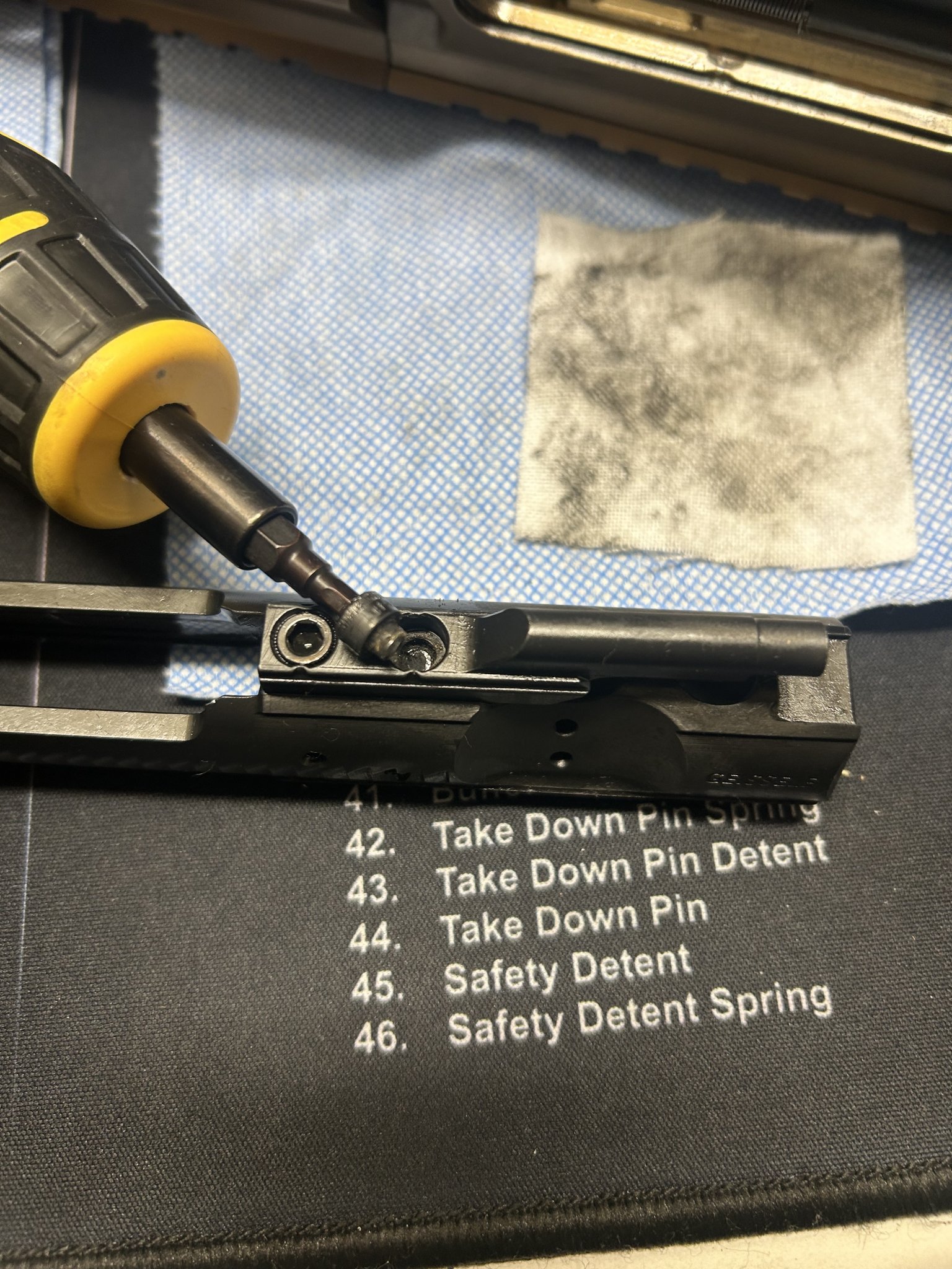

I definitely just found the root cause of the short stroking problem. I finally got around to field stripping the gun/bolt since my range session on Friday and tested out the gas key screws to see if I could break them loose at 30 in-lbs for a general test. One of them was fine but the other I barely touched and it came loose with some amount that was way less than 30 in-lbs. I have a spare brownells complete bcg with bolt so I'm gonna throw the geissele bolt into the brownell's BCG for now so it's operational and the headspace will stay the same for my handloads. I will work on the geissele BCG to re-attach the gas key properly.
Don’t know if it’s been mentioned yet, but did you check your gas key screws/bolts? They may not appear to have backed out but it doesn’t take much to let a lot of gas escape if they aren’t actually tight.
You nailed it here, thanks for the reminder! It's always the last fucking place you look right? Glad I found this b/c the one screw was so loose it likely would have caused a major jam in the gun next time I shot it. Like you said, the staking still looked perfectly fine but it was barely attached......Whew...
Glad you found the issue! It’s caused me more than my fair share of head scratching before. Like you said the last fucking place you would think.

Looks like it got sheared off. Here’s a pic:
Update, Geissele customer support responded today (less than 24hrs) to my warranty request and they are going to ship a new carrier with key out to me today. Props to them on the quick response! They asked me to send back the old one so they included a return shipping label which I’m happy to do.
Good sign they asked for the failed parts return. They need to do a deep dive into the issue.
All tapped threads are a risk. In steel parts, quality controls on threaded holes and fasteners is a constant battle. So is cleaning and prep.
The torque tools also require discipline in the calibration labs and some care and skill on the part of the operators.
When they get these parts back under a microscope, there will be several places that get investigated to learn what went wrong here.

Yep, definitely a good sign for QC. I'd hope that it's not too common for gas key screws to shear off like that after only a few thousand rounds.

Great stuff, thanks for sharing! This info will definitely get filed away/bookmarked. Based on that article I guess the summary re: my rig was stove piping (fucked up a few pieces of nice LC brass) and short stroking due to a loose/sheared gas key screw. I was able to get the gun running again by going to a lighter buffer weight and weaker buffer spring but as many on this thread suggested I still needed to find the root cause and not band aide around it.
It's nice Geissele is sending me a new one free of charge but I'm also investing in some spare gas keys, screws, sealant, etc. so I can repair one myself if needed.
Reactions: Ex E6
Let us know how it shoots with the new carrier.
Curious though, I thought you had said at one point both rifles were doing something odd. One short stroking and the other iirc would cycle but not lock the bolt back?
Will do.
Sorry you might be mixing me up with the OP. I kinda hijacked this thread for a bit ha ha. I only have one 5.56 gas rifle and it has a 14.5 inch super duty upper which shot fine for several thousand round and never had a problem. Then the last two sessions I was at the range I was getting stove piping and short cycling and no lock backs with familiar ammo. When I switched to carbine buffer weight and weaker spring I was able to fix the short stroking and it was able to lock back....but something still didn’t sit right with me because it was odd that it was randomly not working anymore, and @.505gibbs suggested to check the gas key screws and that was the root cause of the problem.
Will do.
Sorry you might be mixing me up with the OP. I kinda hijacked this thread for a bit ha ha. I only have one 5.56 gas rifle and it has a 14.5 inch super duty upper which shot fine for several thousand round and never had a problem. Then the last two sessions I was at the range I was getting stove piping and short cycling and no lock backs with familiar ammo. When I switched to carbine buffer weight and weaker spring I was able to fix the short stroking and it was able to lock back. But something still didn’t sit right with me because it was odd, it was randomly not work anymore, and @.505gibbs suggested to check the gas key screws and that that was the root cause of the problem.
I certainly wish I'd read your original post closer as in ;
" Then the last two sessions I was at the range I was getting stove piping and short cycling and no lock backs with familiar ammo."
I for one should have paid attention to that statement ; That's a sure sign of insufficient gas and Your gun worked just fine previously !.
So through inspection of the entire gas system , is a WAKE UP call for any of us who have similar issues ,as we can assume NOTHING without verification . (y)
Reactions: WeR0206
Yep, I will likely check the gas key screws with up to 30 in-lbs whenever I take the BCG out for any reason. This will at least see if anything is egregiously loose and catch it earlier if it happens again. I also have a spare gas key, screws, and sealant on the way so I can fix it in a pinch if needed.
Will do.
I thought you were the OP. That makes more sense.
Reactions: WeR0206
