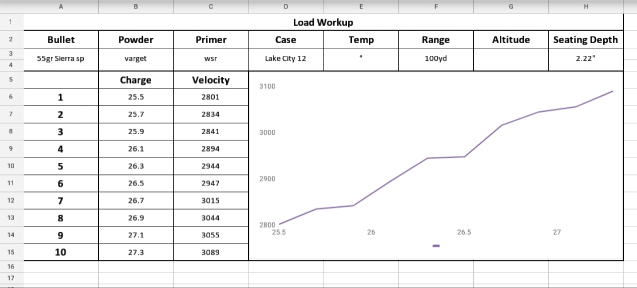

    I would like to shoot a carbine course at Sig one day hopefully. I've always shot 69 SMKs but I am not gonna waste them on a course, and I was just gonna grab a bunch of cheap 55 gr bullets. I have been using Varget for years. Rather than have to buy another powder like Benchmark, I'd rather not have to go that route and just use what I have. Any of you guys choose to run Varget with lighter projectiles like the 55s in your AR?

    I don't choose to run 55 grain bullets with Varget, but it can be done. Varget will fill the case close to the top with 55 gr. bullets. 25-26 grains will work for your class, if that's what you want to do.

    All my guns like 26.4 of Varget with a 55g projectile.
    Mine as well, out of an 18" barrel.

    Varget for 77's, H335 for 52-55's. The 77's are 24 grains of Varget, 55's we're around 27 I think. 25 grains of H335 is good for 52 and 53 SMK or 55 FMJ. Less powder, more loaded rounds.
