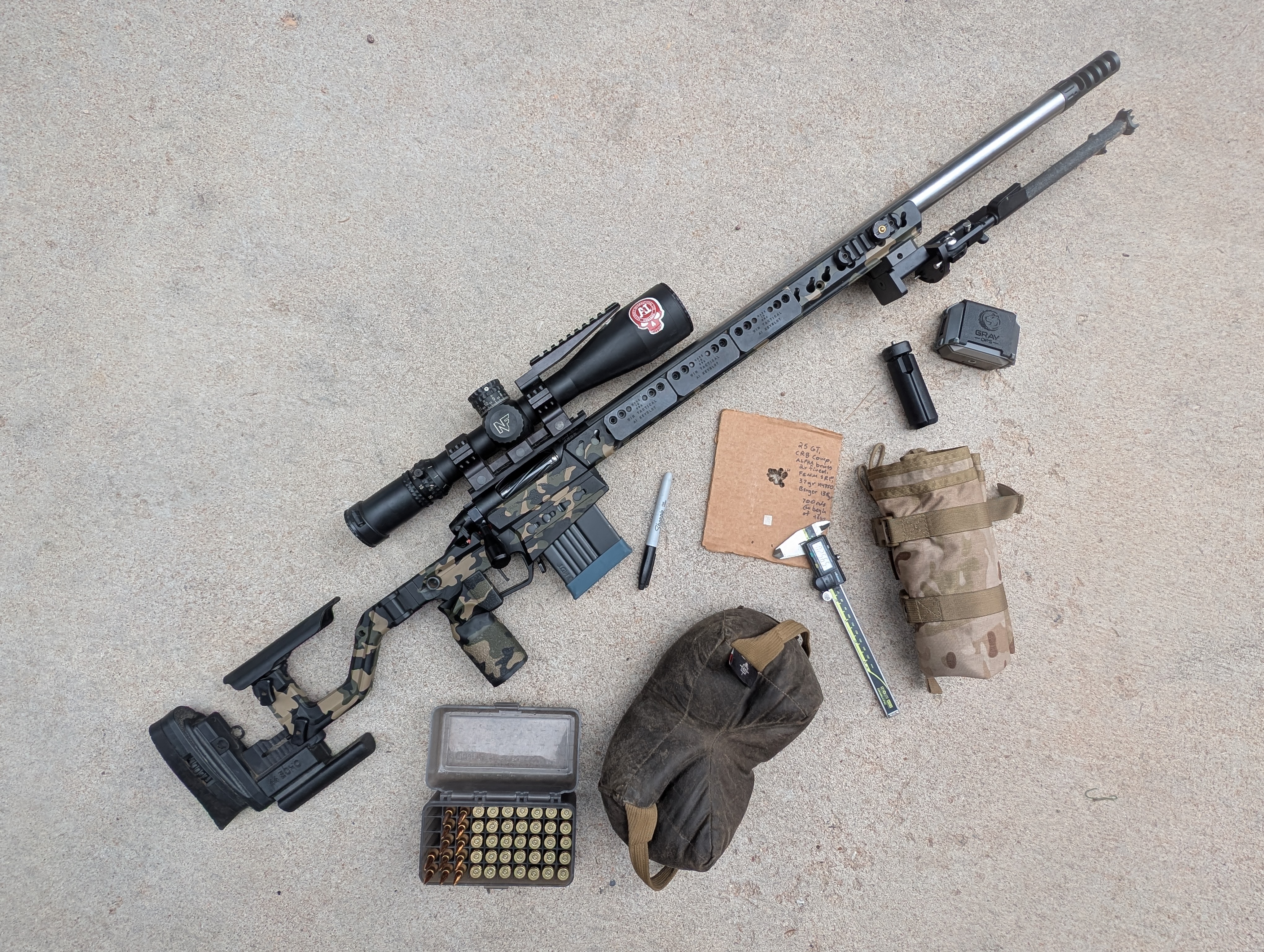

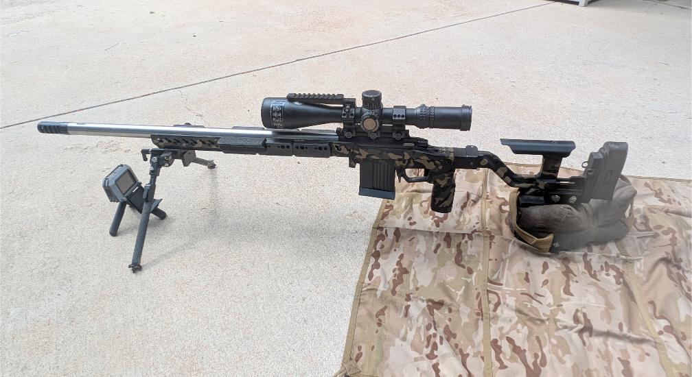

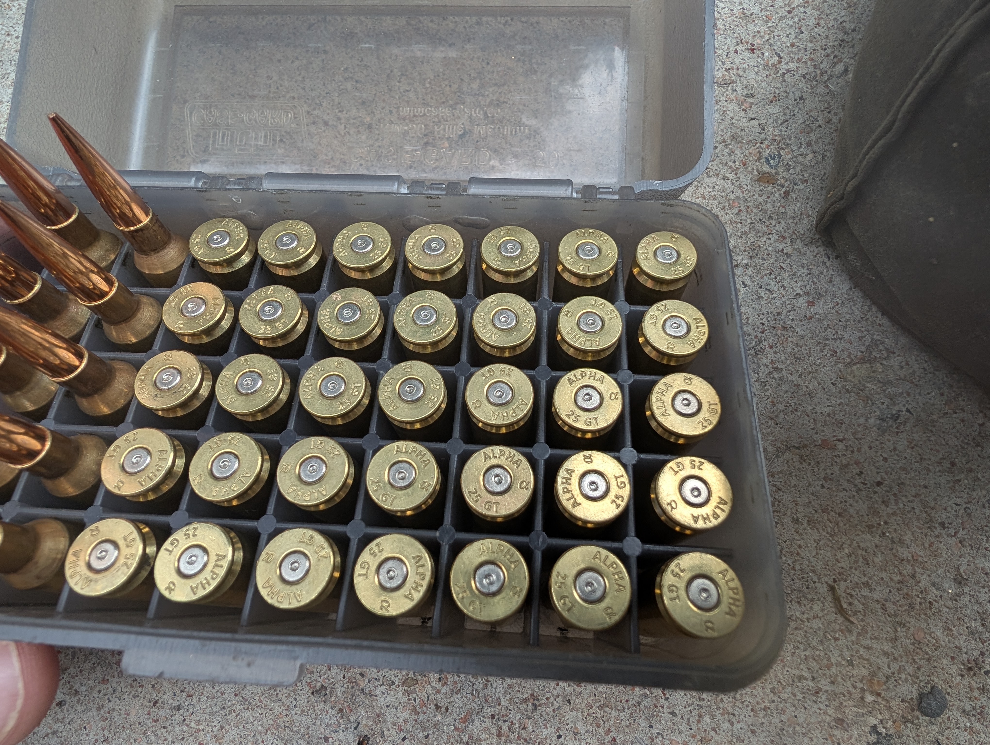

Equipment:
Zermatt TL3 in a bedded AI AICS ATX chassis, CRB .25 cal Comp Contour barrel chambered in 25GT, NF ATACR 7x35 T3, Hawkins Heavy Tactical rings, Hawkins updraft brake, TT Diamond set at 16oz, Gen I CkyePod, Accurate Mag 12rd mag

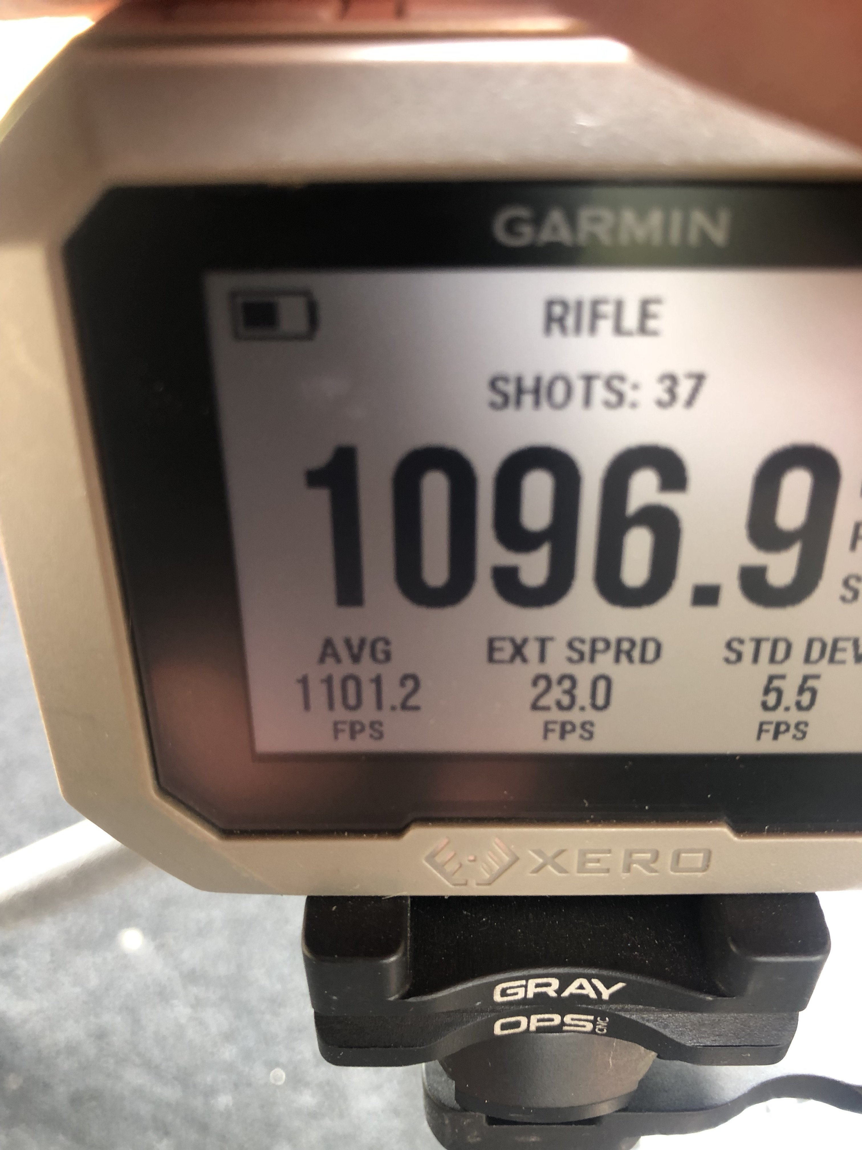

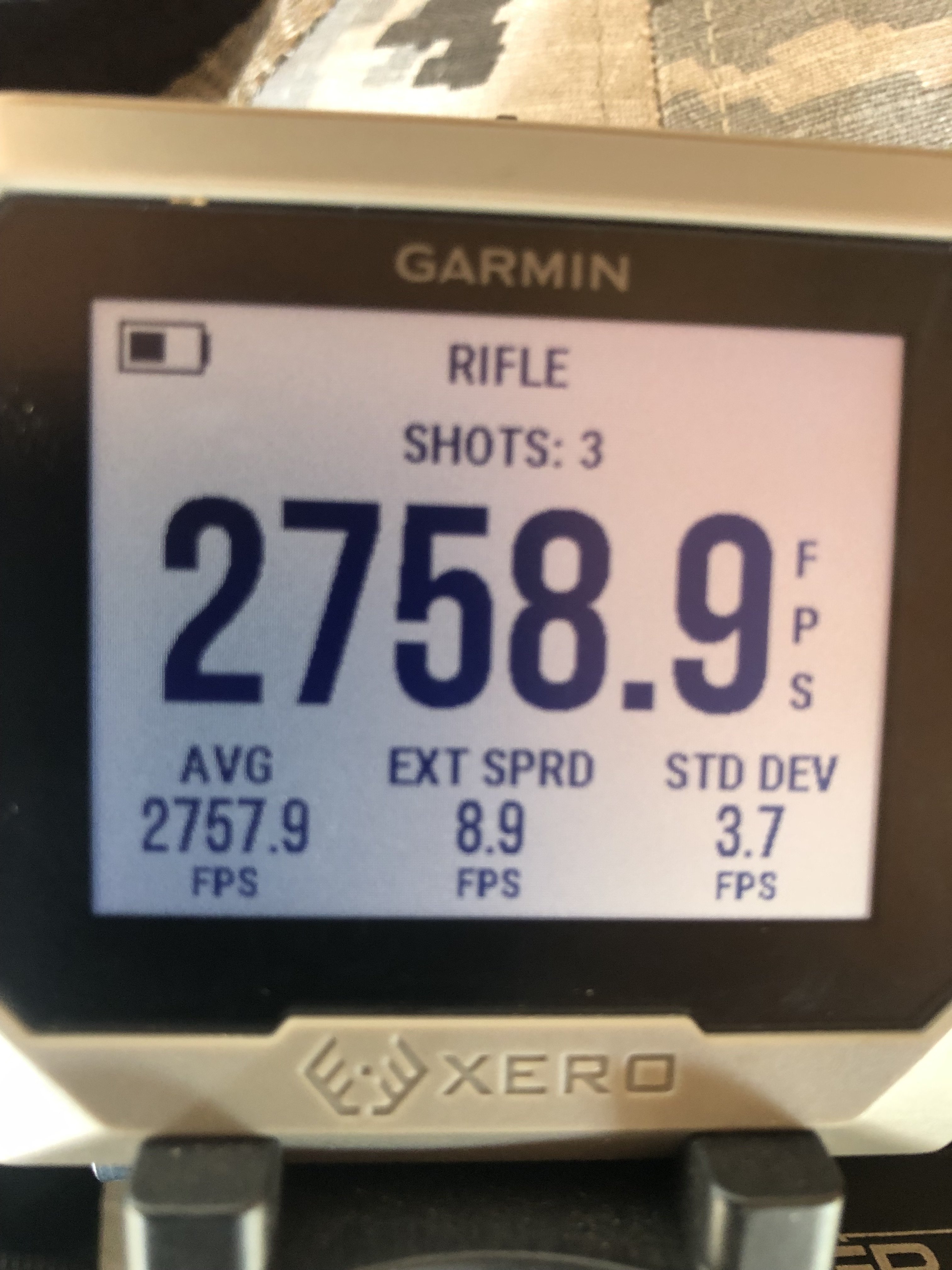

Garmin Xero, Schedium GC with heavy fill, TAB Pollock shooting mat
100yd Indoor range
Alpha brass(2x fired), 37gr H4350, Berger 135gr LRHT, FGMM SRP
Method:
Brass prep Consisted of Decap with A419 decapping die, wet tumble for 20mins (no pins), dry, anneal on AMP MKII using code 142, trim on Henderson 3-way trimmer, lube with imperial sizing die wax on the body, and swab Neolube 2 inside the necks, size using a Forster FL bushing die with .278 bushing and mandrel with a SS Sinclair mandrel turned to make a .279" neck diameter for a loaded .282" neck. This Alpha brass has a .012" neck thickness. Finally dry tumble in walnut. All in a 21 year old Dillon 550.
Load Prepped brass was loaded on a Dillon 550. Prime in station 1 using FGMM SRP, nothing in station 2, charged in station 3 with a Dillon powder thru die and funnel insert with a A419 funnel. Powder is dropped, weighed, and trickled on a FX-120i equipped AT V2+ and IP trickler. Powder was dried to my ambient RH and gained approximately 50fps since opening the jug. Charged round seated in station 4 with a Forster Micrometer seating die in 25GT. Dumped into an Akron bin. Every 5 loaded rounds were gathered and placed in an MTM ammo box so some loading sequence was maintained to be carried over to the test. All charges trickled to either 36.98 or 37.00.
Barrel The barrel had 700rds on it since early June. This consisted of 5 matches. It was recently cleaned thoroughly after the last match two weeks ago so I had a clean bore. I loaded 5 more rounds to season the bore prior to shooting the 30rds for record.
Equipment I shot the test in the prone using the Ckyepod and heavy fill GC as a rear bag. I laid on the mat, placed the Xero just in front of the bipod, under the barrel so the brake didn't blow it around. The test was shot in an indoor 100yd range. The distance from the front of my scope to the target measured 98 yards.
Environment: 9500ft DA, 23.12inhg, 75°, 50% RH Indoor 100yd range. No wind, mirage, or lighting changes
Shooting method I fouled the bore using 5rds. Let the barrel cool for 3 mins and commenced testing. I used a .3" white paster and dialed .5mrad into my elevation to place my group roughly 2"(1.98 actual) above my POA on the white paster.

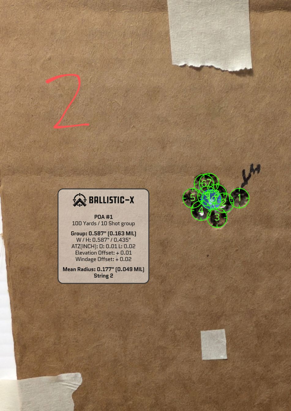

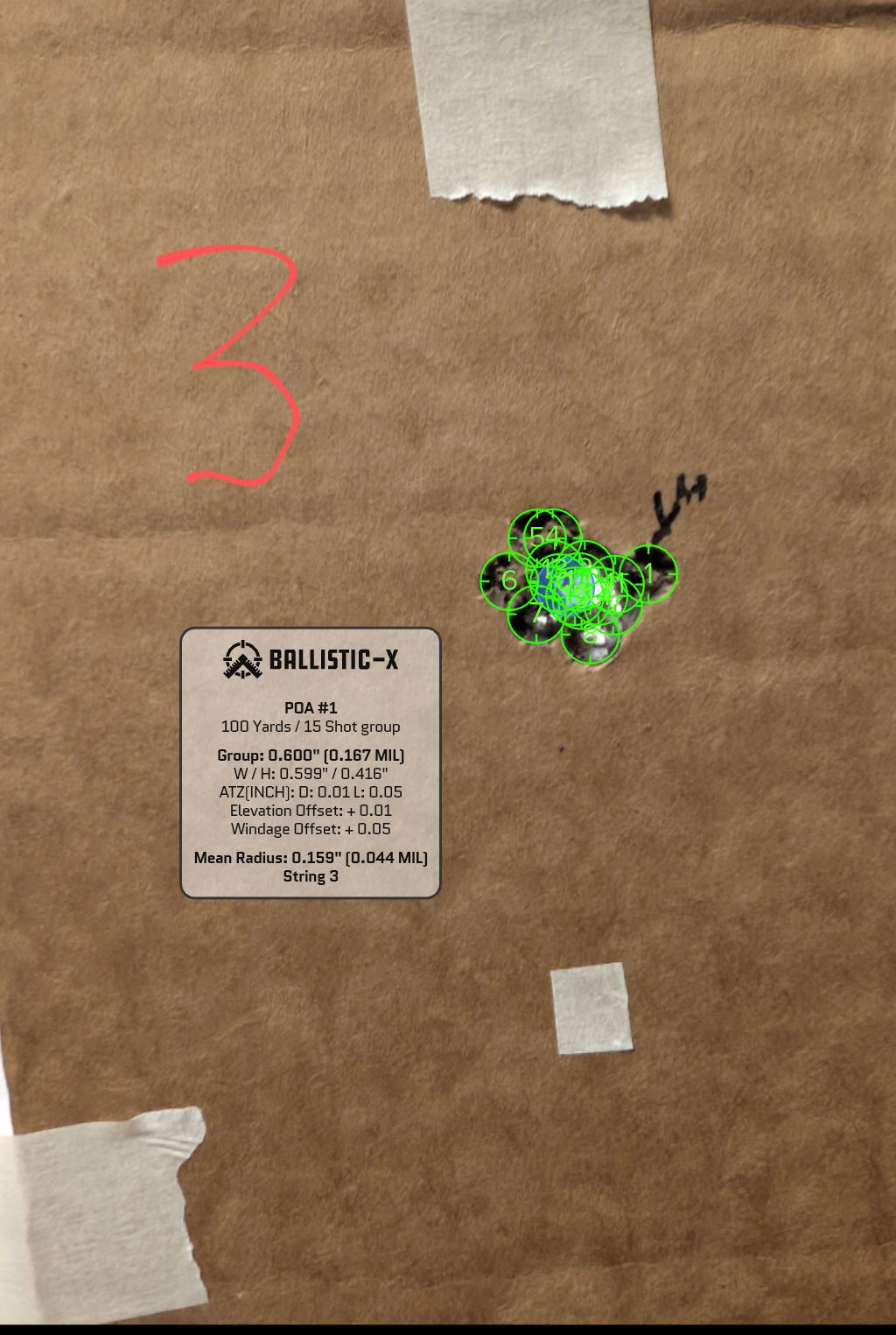

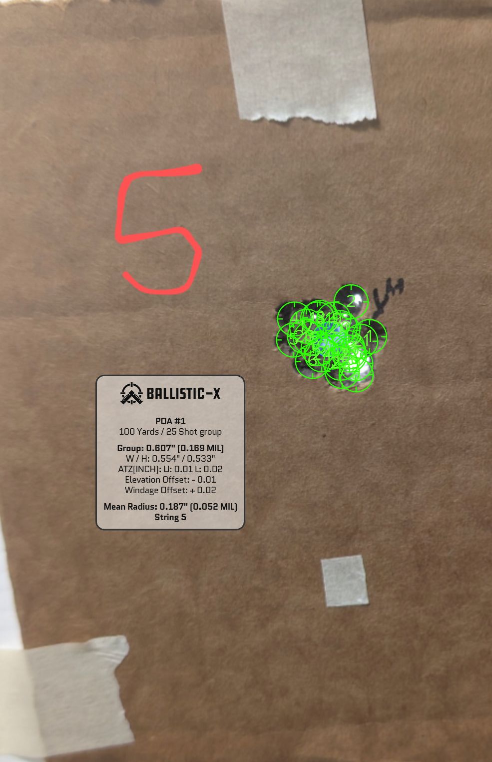

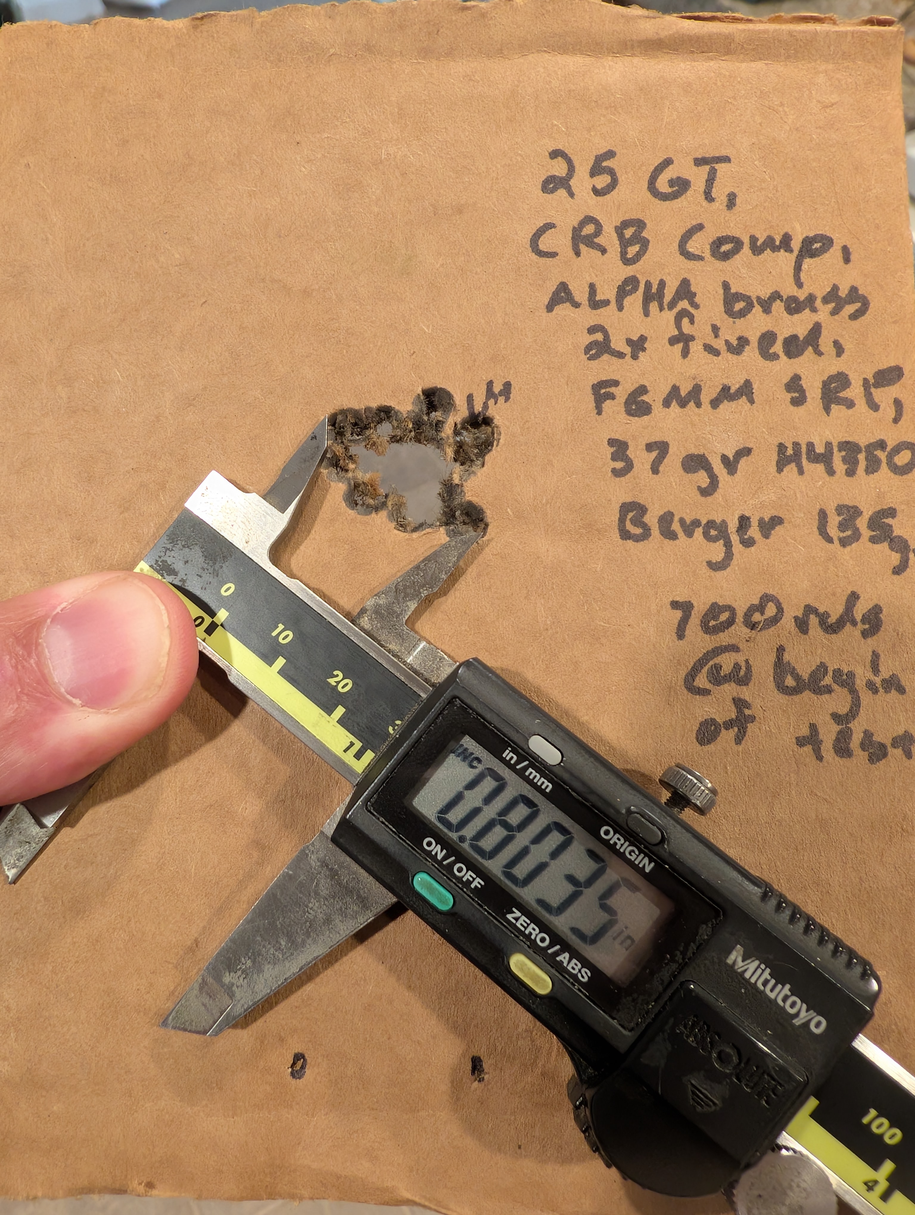

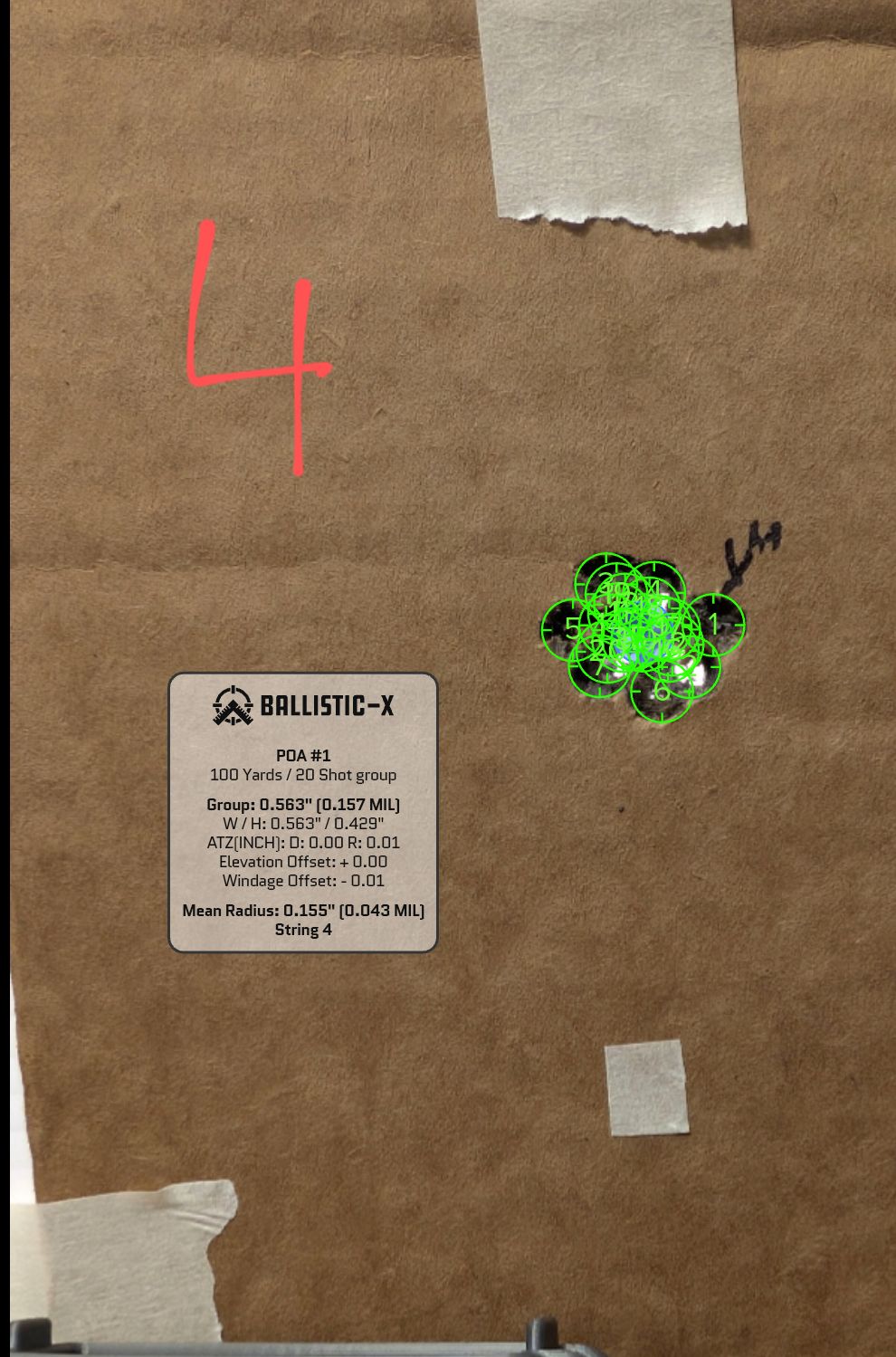

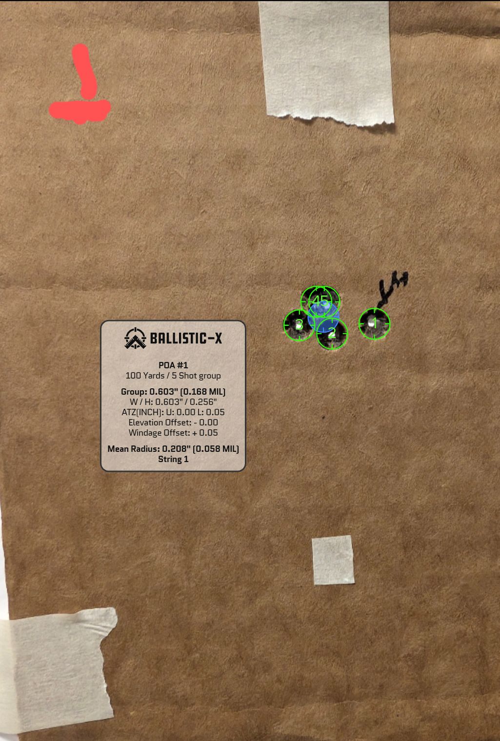

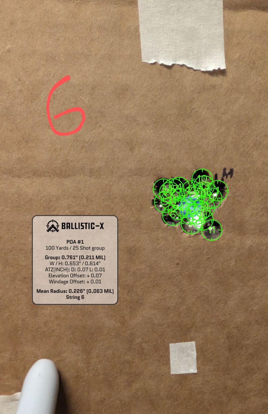

I shot 5rds at a time, stopping to run the target back up range , take a photo, run it back, write down the individual velocities from the Xero, load 5 more rounds in the mag, return to Xero to it's position in front of the bipod, and commence shooting again. This process took on average 2 mins to shoot a string and 8 mins to reset. I repeated this for 6 total 5rd strings of 30rds. The Xero ran the entire time and recorded every shot as a cumulative 30rd string.

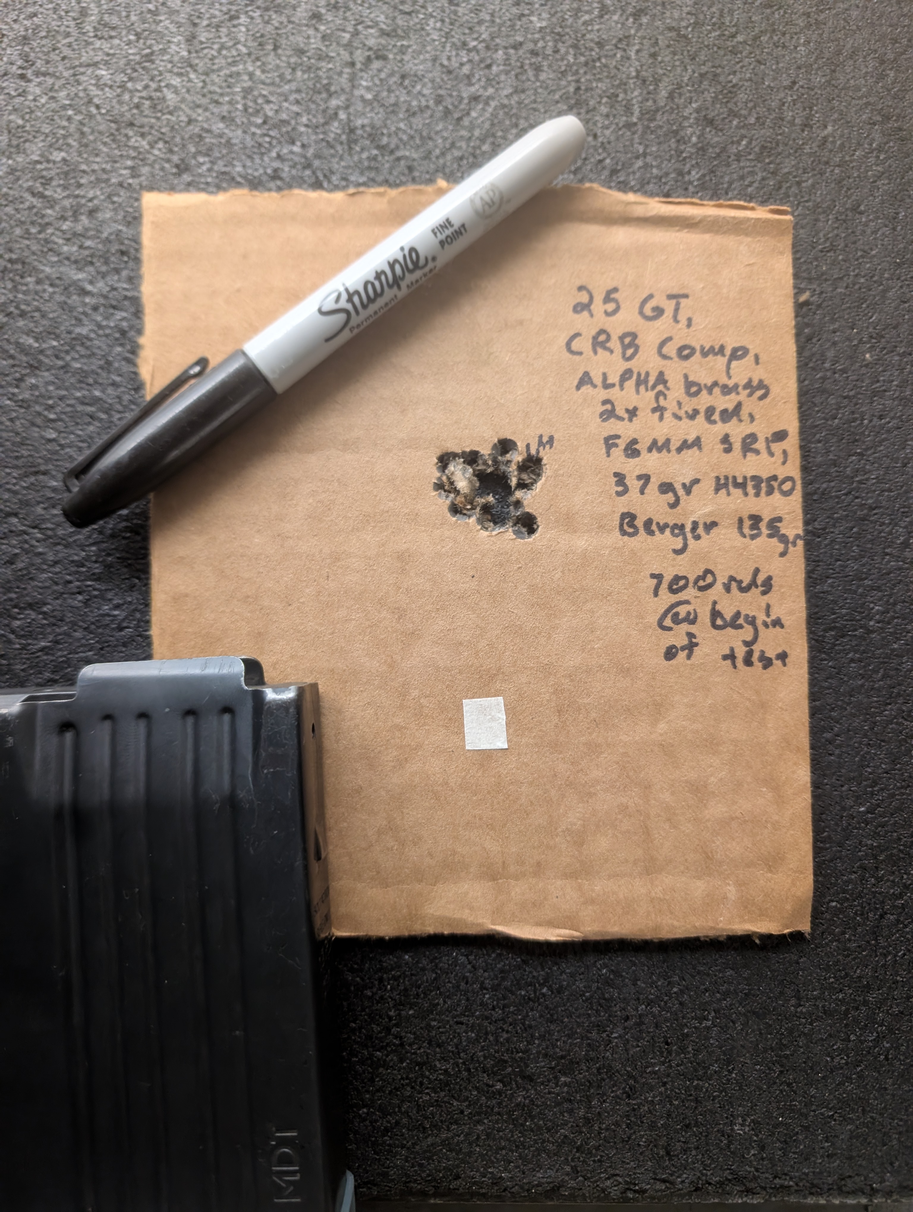

Results:

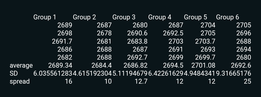

Here's the raw data:
30rd Mean/Standard Deviation/ Extreme Spread
Mean: 2691.5
SD: 7.9
ES: 27.5
String 1:
Mean: 2689
SD: 6
ES: 16
String 2:
Mean: 2684
SD: 4.6
ES: 10
String 3:
Mean: 2686.8
SD: 5
ES: 13
String 4:
Mean: 2695
SD: 6.4
ES: 12
String 5:
Mean: 2701
SD: 4.9
ES: 12
String 6:
Mean: 2693
SD: 9.3
ES: 25
Here's a comparison of each string vs the running total as the 30rd data develops. * Indicates running total:
String 1:
2689/5.4/16*
String 2:
2684/4.6/10
2687/5.4/20*
String 3:
2686.8/5/12.7
2686.9/5.2/20.1*
String 4:
2694.5/6.4/12
2688.9/6.3/25.3*
String 5:
2701/4.9/12
2691.3/7.7/27.1*
String 6:
2693/9.3/25
2691.5/7.9/27.5*
Observations:
Let's inspect the data. My mean SD across all six strings was 6. My lowest 5rd SD was 4.6 and the highest 5rd SD was 9.3.My total finished SD across the larger sample size was 7.9.
The mean of my means was of course 2692fps. The difference of my means was 17fps. The 95% confidence interval is 2688 and 2694. Just 6fps!
There is a trend in the last two 5rd strings where the velocities were increasing. I was seeing mirage off the barrel that correlated to the increased velocities. String #5 was the highest and had an interesting result that we'll talk about later.
As a note, AB is saying for a 135 Berger at 2692fps in a DA environment of 9500ft, it takes 14fps to generate a 0.1mrad elevational difference at 1000yds
Discussion:
Okay. What does all this mean? Well, first I want to point out something that I picked up from my wife who has 20 years of experience in clinical research and deals in stats all the time. What is statistically significant isn't always clinically significant. I mean sometimes it is, and researchers absolutely use P values to demonstrate statistical significance as a way of proving clinical significance, but the two aren't always reciprocal. This is a key concept because it's the same with shooting. What is statistically significant isn't always ballistically significant and there's a data set in this population that proves that point. So for all the nerds still using Dandy tricklers and tucking their tshirts into their underwear and thundering on the Internet shooting forums, "Your sample size isn't statistically significant!". This data set is about to prove you wrong.
As you can see each 5rd strings is under 10fps and almost all of them were under 8fps. String #5 had an increased Mean. The increased mean was due to a general speed-up in individual velocities. I believe this was the consequence of the barrel and chamber heating up. If this is true it would be a false artifact of shooting a large sample size. I was seeing mirage and shooting through it during strings 5 and 6. The 8 mins in-between strings wasn't enough to adequately cool the barrel. Perhaps once you get a CRB Comp Contour hot enough, all that steel retains the heat longer. Not something you would encounter at a 10rd stage PRS match. This makes for an interesting counter-argument against the 30rd group folks. The increased SD in string 6 is due to one round. 2980. It's not even the lowest velocity in the extreme spread. And I would not call it an outlier. In my estimation, it still falls within the category of random chance. It wouldn't cause a miss, I'm not going to change the way I load ammo due to it, and it still doesn't generate a full 0.1mrad of difference at 1000yds. (Remember, 14fps to generate a dial'able diff)
We ran a standard T test to compare the individual strings against each other and the overall 30rd data. The goal was to compare the differences to each other and use a standard statistics metric to determine if a "statical significance" existed. This will answer the question, through a statistics metric, if the 5rd groups provide a good estimate and are representative of the overall 30rd population. We assumed the standard Alpha of 5% or 0.05. The standard T tests generated a P value to be judged against the Alpha. The only string that generated a P value greater than the Alpha, or demonstrated a statistical significance in difference from the other strings or the 30rd population, was String #5. You can see the mean MV falls outside of the 95% confidence interval. This means this result should not happen often. Hence this one 5rd string is not representative. Statistically speaking.
Oh! So a win for the 30rd group crowd, right?!! I shot a 5rd group that isn't representative of the normal outcome, right? So if I shot one 5rd group and got this result, it would not be representative of a 30rd sample size. Well, case closed! The 30rd group guys win the argument! Well, not so fast. This one string would make me think my SDs are worse in a 30rd string than they actually are. So, if the argument is that some guy posts a a 5rd group with a single digit SD and 30rd group guy says, "Cool, good for you but that SD in that 5rd strings won't hold up over a larger sample size." ..... then.... Akshually.... this unrepresentative String #5 ... doesn't actually prove that. In fact the difference in SD of 9 vs 6 is pretty F'ing immaterial. You can refer to Bryan Litz's WEZ to determine the hit probability difference of 3fps SD. Okay, well... you'd have 2701 plugged into your Kestrel instead of 2692 if you went off this one 5rd string. Okay, so what? Is that ballistically significant? It's 9fps difference. You still can't even dial that at 1000. And certainly inconsequential at 560, or 735, or 865. So this demonstrates the thing I was saying about what is statistically significant isn't necessarily ballistically significant to us as shooters. And let's not forget there's a decent chance this is only an artificial result of increased heat from shooting an annoyingly large sample size.
The remaining 5 strings are both statistically representative and practically representative.
Conclusion:
This 30rd data set demonstrates that when you use instruments that are capable of reproducing accurate and precise data, a 5rd string can provide a good estimate of the greater population and is representative of what your rifle and ammo will do throughout a match and larger population size.
Now, if the data were different, this conclusion could be different. If your data was less accurate and precise, then yes, you probably do need a larger sample size to have a good estimate and be representative of what your gun and ammo is capable of. Both of these two things can be true. It depends on how good your ammo and gun is. It's not a truism that you need a larger sample size to have a good estimate of what you're setup is capable of. It is absolutely a statistical truth that a larger sample size will provide a better estimate and be more representative, but it's about the context. A lot of us don't need this better estimate and representation. We're in the range of splitting hairs when your already using really precise and accurate data. And it's not usable to us as shooters. This is where the confusion comes in. Just because it's a statistical truth that a larger sample size will provide a better estimate doesn't mean a handful of 5rd groups can't provide all the precision and accuracy we need as shooters to understand what our ammo is capable of throughout a match.

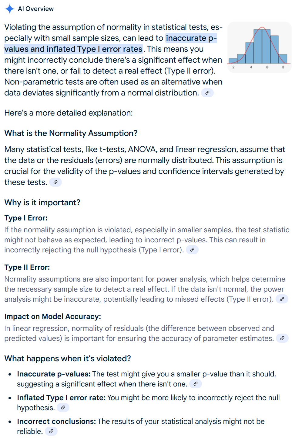

Google's bot actually gives a surprisingly good, easily understandable (with some minor digging) summary on it.
Assuming there was in fact a Normal Distribution to begin with...

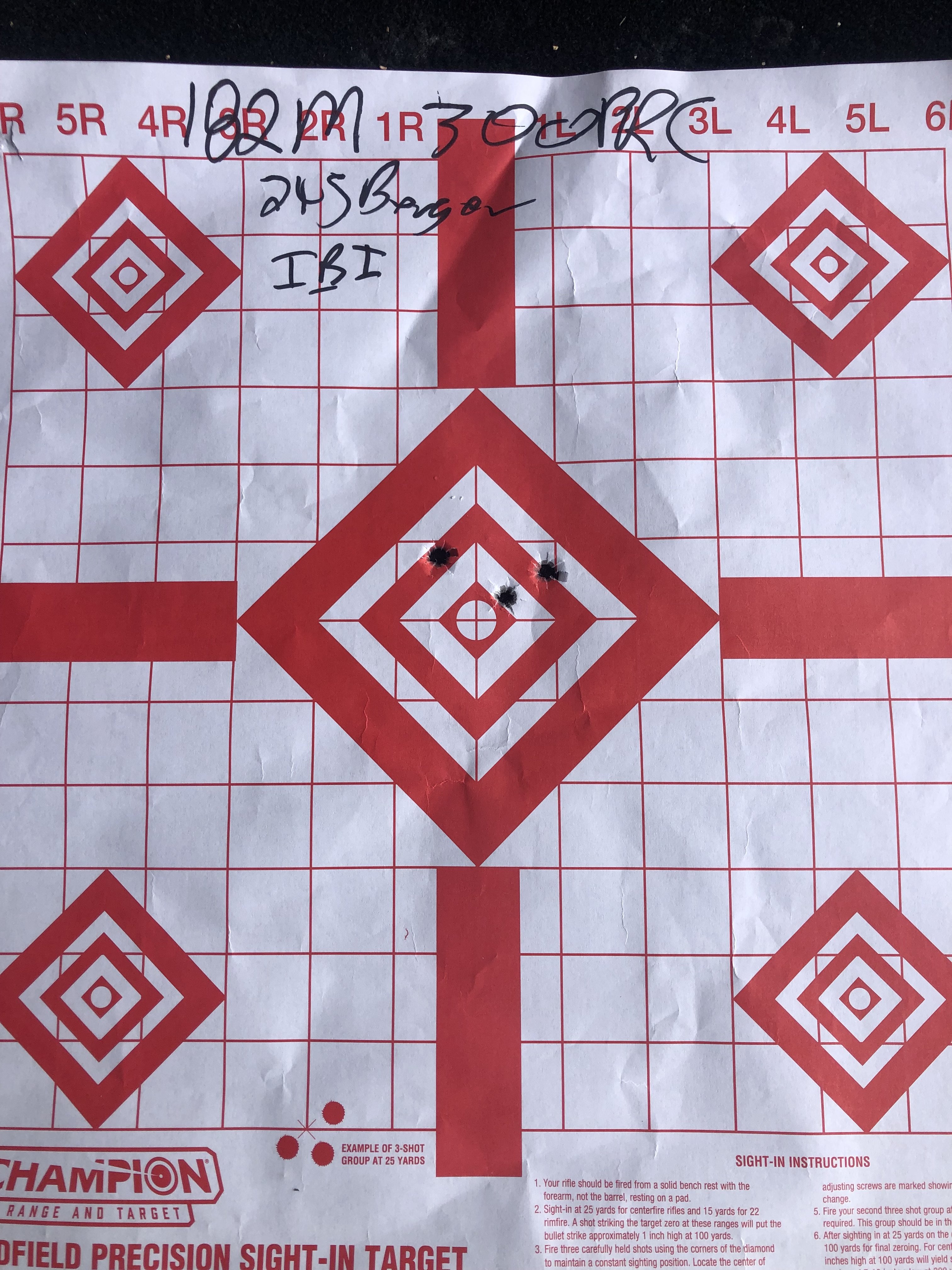

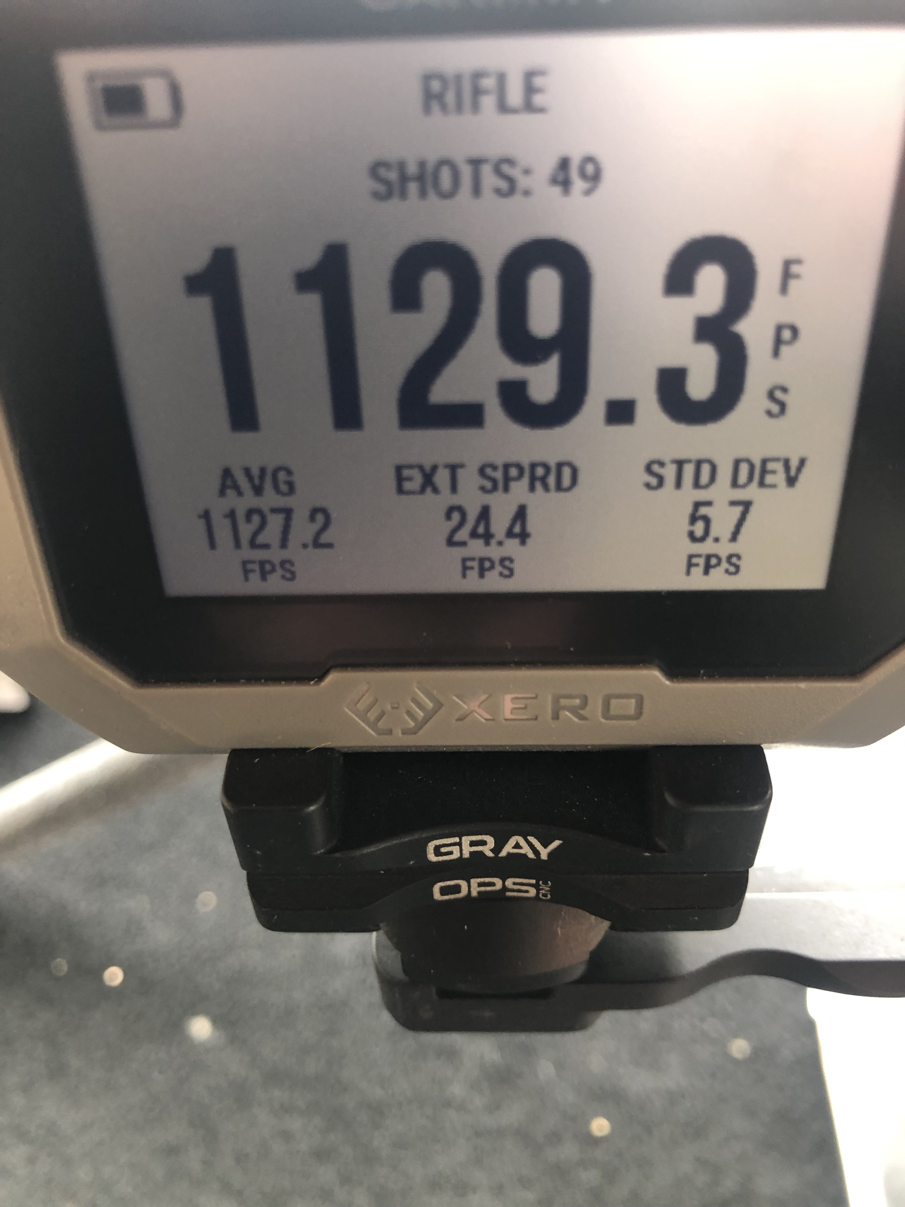

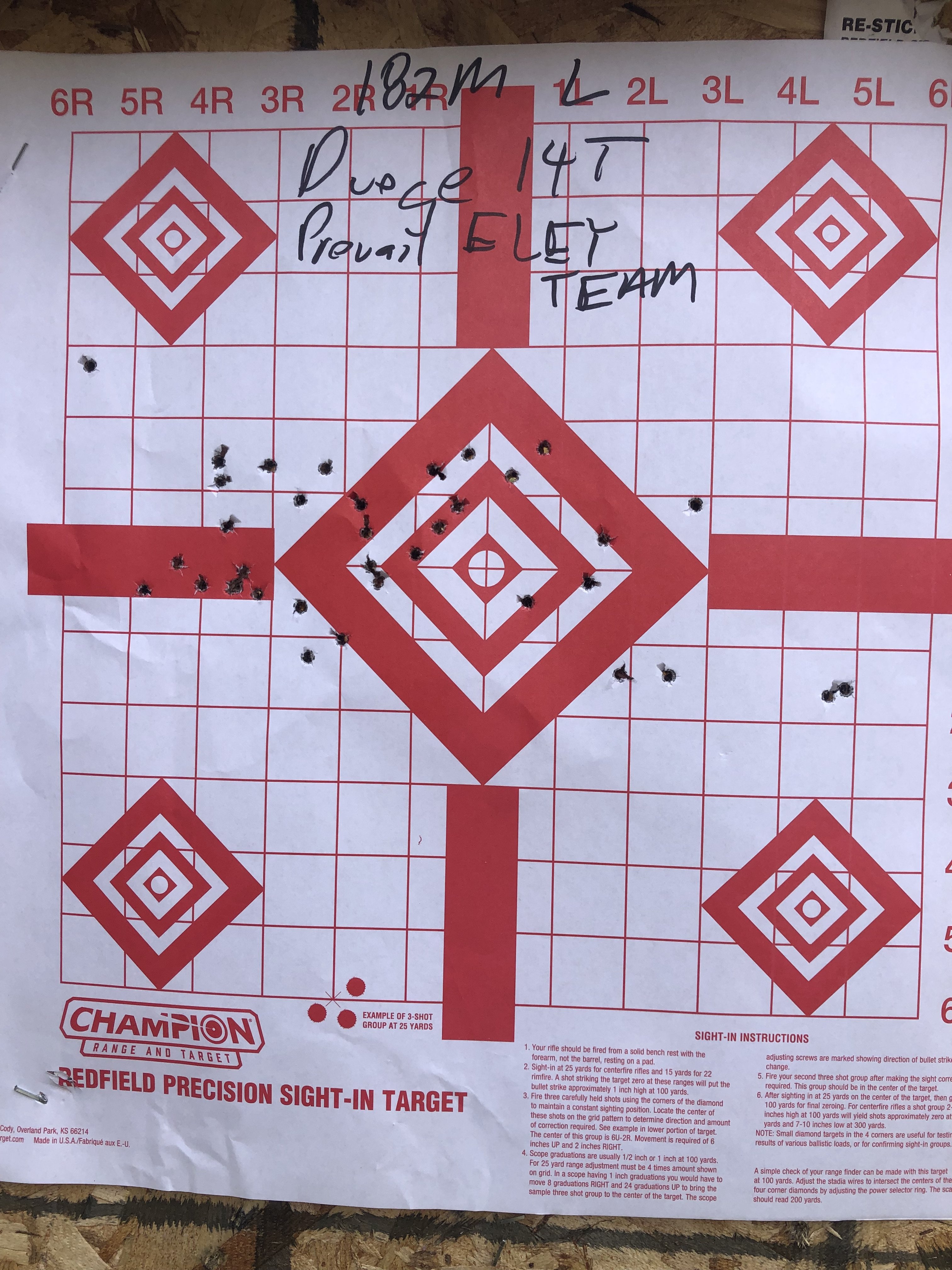

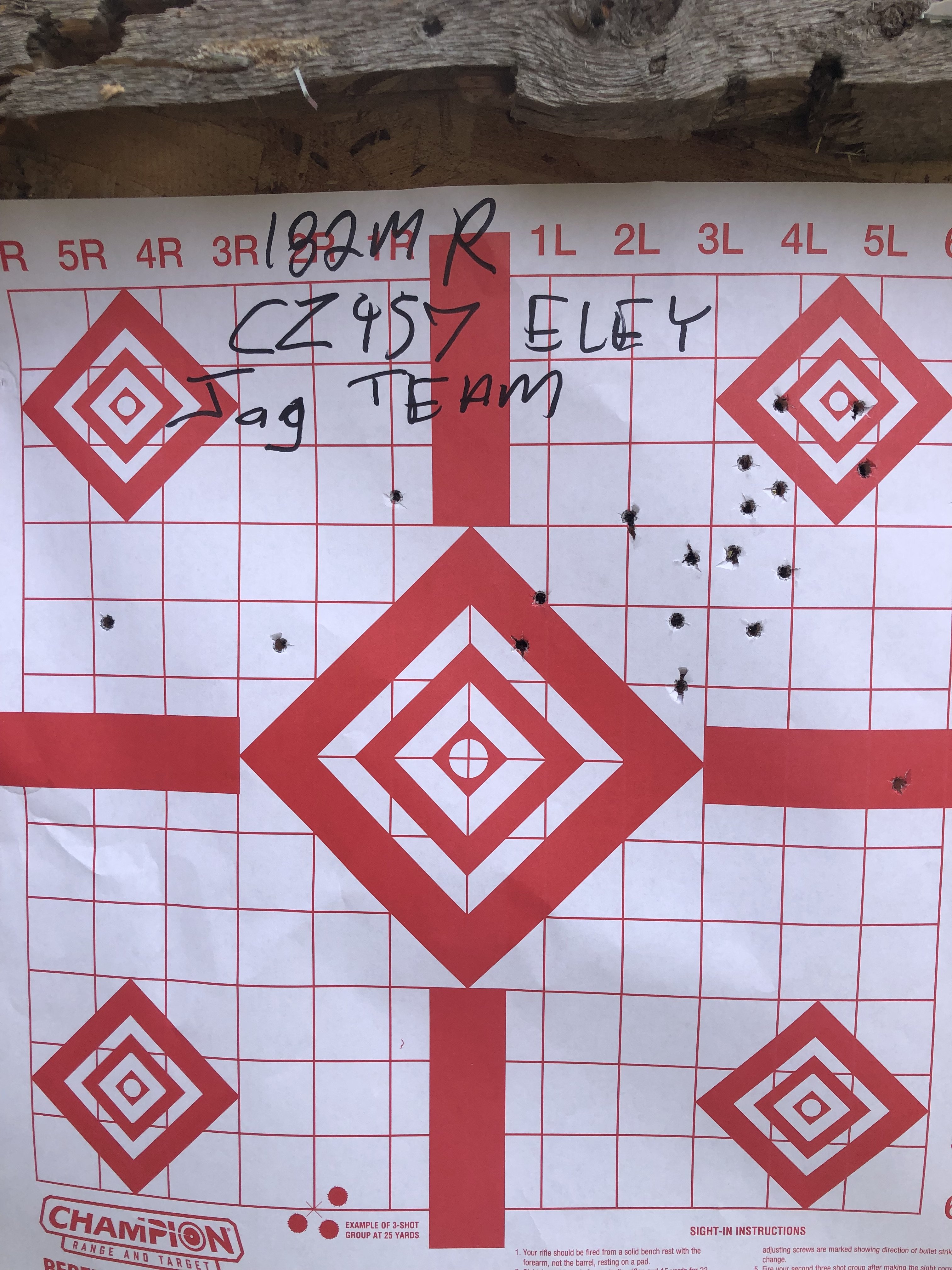

On the other side of the statistical coin there is me today. I moved a scope from the CZ 22 to the 300PRC. Zerod with pre loaded known hand loads. Bore sight and one shot on steel at 200. A few clicks to Center-ish on the paper and send 3. 0.1 mil down and zero the turrets.
Of course my 22LR data collection was a different. That stuff is a lot cheaper.

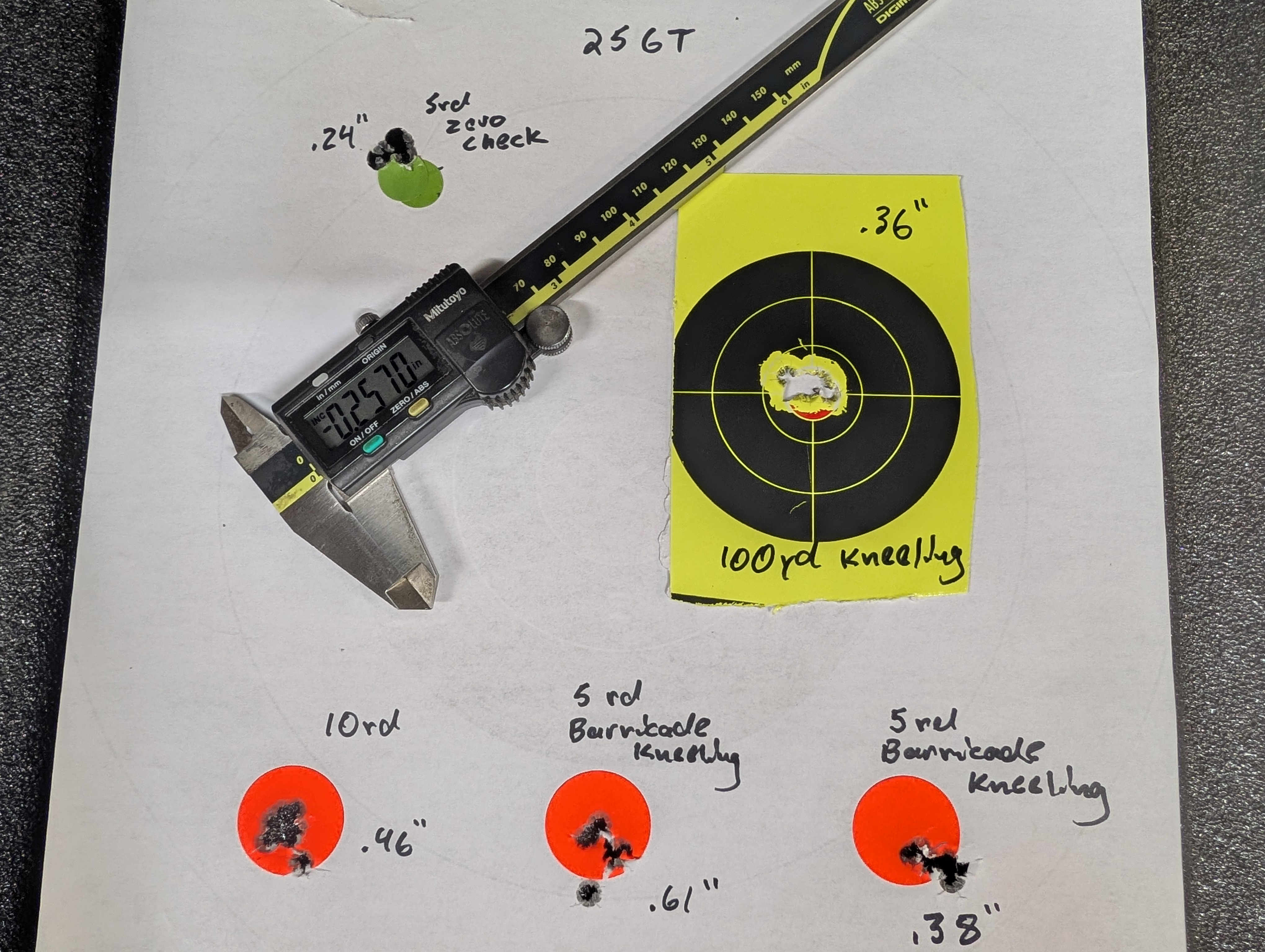

I shot about 100 - 150 rounds through this barrel and took it to it's first match. This white target was the 25rds of zero confirm before I ran the press on the 100rd sample and shot the match. The yellow cut out was from a later "check" and I don't remember when.
I shot this prep session on 18 June. Looking back into my Xero, I have two strings. A 5rd AVG MV 2700, SD 7, and a 19rd string AVG velocity 2698.7, SD 6.4 My Xero occasionally misses shots, but this is a good example of what I'm referring to. When this just keeps happening, do you really need to shoot a 30rd group every time?

It would have been cool if you recorded the group size of each 5 round group. Seems like that was what hornady emphasized more?

I'm not telling rookies anything. That is your world-building. I'm simply proving that we don't always need 30rd samples. You're having a hard time with absolutes.
I think a lot of people are stuck on the very simplistic, yet true fact in statistics that a larger sample size will expose more random variation. But what they're not thinking about is the fact that variation sizes and their effects can be inconsequential and the additional variation that a larger sample size exposes is immaterial if you're working with accurate and precise data set that is well under the real world requirement.
It's not always true that a 5rd group with an SD of 6 WIL BE an SD of 15 in a 30rd sample. And not just by random chance. Our equipment is getting to the point where we can control this.
Reactions: LR1845
And here's another point that I forgot to tease out. That one low MV in String 6 that caused the SD to shoot up to 9. That one round had the statistical power to blow up that SD in a 5rd string, but when factored into the total 30rd sample it became muted by the volume of data. And this is something that experienced shooters intuitively understand. That larger sample sizes don't always generate larger SDs because an errant single low or high velocity can be somewhat concealed actually. The normal distribution settles down over time.
Reactions: Fig
I'll make one more comment and let the rest roll.
It is also not true that you can always know the SD/ES of an unknown system before you know it.
Taking the stance that your specific 5 shot samples prove this is only because your population was tight, and it is a disingenuous argument against statistics and ballistics.
We are not saying that every SD grows just because the sample size is small, but we are saying that unless you already have some view of the real population stats, that sample sizes smaller than 30 run the risk that the 5 shot samples are wrong when there is unknown ES.

You have me all wrong.
I am never going to tell folks they "need to" burn 30 shot samples doing their testing and personal load development. However....
I am going to warn them that there is a risk when they hang their hat on just 3 or 5 shots to make decisions.
I then show them that in real world ballistics, we often do not see a clean normal Gaussian Distribution and that means we sometimes can't assume that even 30 will show the real story.
Few of us have DoD or corporate sized budgets to burn for personal use, so most of us run our lives taking some risks that we can make decisions with less than the whole picture, much less.
We run on accumulated experience with both good and bad barrels, guns, weather, etc.. Some of us can also do the math, and have professional industrial experience to lean on as well.
However, when we make posts that are very specific to a system that is very tight, and set up a straw-man hypothesis that because we can show 5 shot samples that lays inside the distribution, it doesn't cancel the statistics text books.
If there have been folks who banged the table and insisted that only 30 shot samples will work, let them be. Don't let them bother you.
At the same time, we have to highlight we take risks when we use smaller samples and that time (more samples) will tell if we were correct. Your example shows only a very good ES and as such the 5 shot samples line up well. But we also only know this because you have 25 more good shots to prove it.
We must be careful to help the rookies learn what happens when they are starting up, not just what happens when a Satterlee puts on another barrel that matches the last good one. The context matters.

I'll take your acknowledgement that this test proved out the conclusion as a win, even though I feel you didn't read that part.

I highly suspected folks that really know stats would sense blood and come in to nibble at small details, without disproving the conclusion.
I stand corrected and owe you the result. With an ANOVA model pooling the error together, which is more precise than a bunch of t-tests as you did, and an error rate adjustments with Tukey in the p-values and 95% confidence intervals, Group2-Group5 MV difference is significant at the 0.003 level with a difference in averages of -16.68 and CI of [-28.95, -4.4] and Group3-Group5 MV difference is significant at the 0.016 level with a difference in averages of -14.26 and CI of [-26.53, -1.98].
Should say P value less than Alpha and show which comparisons have a difference. And also be specific what you’re comparing when making a statement. Group A vs Group B and the estimator.
a 5rd group CAN be a good estimator.
A five round group isn’t an estimator. The statistic estimating a population parameter is an estimator. So, the sample mean is an estimator for the population mean and 5 rounds, assuming the variance is low, can be quite good as an estimator. But the same cannot be said about sample standard deviation for population standard deviation. The variance is quite high at 4 degrees of freedom. This applies to ES as well. Worse, ES is dramatically more biased than SD and has a larger variance.

- I literally just proved they absolutely can be

@JR1200W3 Thanks for your effort. If anything, it replicated what I've seen around here and gave me more confidence that I'm not completely we-todd-did.
