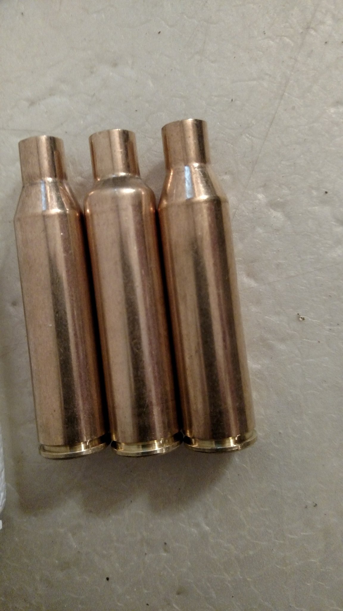

Thanks All ! Appreciate the info and feedback. I guess for my particular rifle and situation it will ultimately come down to testing and experimenting with diff loads bullets loads and powders. Which is why we do all this to begin with! Gonna try retumbo, RL-19, H4831SC, and H-1000 and see what’s works best. Thanks again
One bud went ai with n170 and easy pushed 3150 with a 140. Pushed a 120 nosler 3300fps (dont remember the load, bud no longer around to ask). Coyotes exploded.
I just hate fire forming brass to ai.
Yeah that’s the one drawback is the fireformimg and eating away at the throat/Barrel life in the process

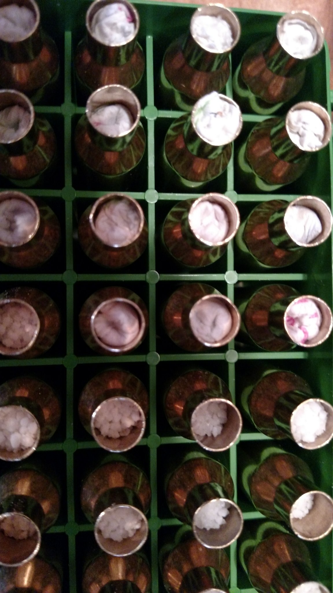

Second.... can you describe to me how to do the cream of wheat or instant grits thing to fireform brass? I’ve heard of a lot of you guys talking about that but I would like to know the procedure as I am thinking about rechambering my 6.5–06 to AI
You use a soft primer.
You put 15 grains of fast powder in the case 700x Unique Red Dot.
You then fill the entire case with Cream of Wheat Tapioca Pudding or instant grits.
Now you tap on the outside of the brass with the spoon you used to fill the cases. You do this until the cereal settles to the neck shoulder junction.
Now you can use paper towels or toilette paper to put inside the neck to keep the food from spilling into the chamber.
Fire the round.
Before you reload the newly formed brass take a paperclip and run it inside the case around the new shoulder.
Upon firing the cases the cereal gets forced into the shoulder and sometimes it will stick there.
If you go to fill the cases with powder and one or two of them overflow it's a good bet you have cereal stuck against the new shoulder.
If you forget the paper towel or toilette paper and spill the breakfast cereal you have to quit shooting and clean the gun. Any cereal on the outside of the case will dent it.
