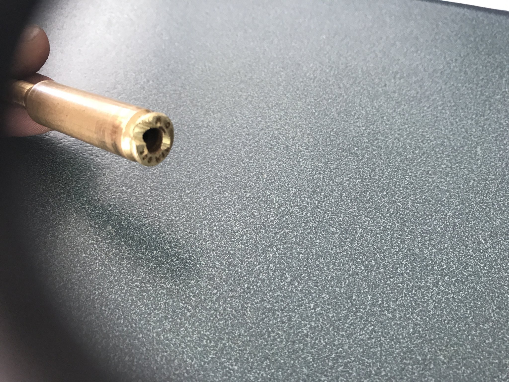

Howa HCR 6.5CM 140 ELD-M CBTO just touching with the Hornady 5-26 insert in mine is 2.271”
A good load at this stage is at 2.2555.
This is using the semi stripped bolt method. Semi stripped as in the ejector is still in the bolt as it’s a bugger to get out so I grind a relief in the case so the ejector isn’t interfering with the case. You also need a dummy round with little to no runout as that will affect your result.
