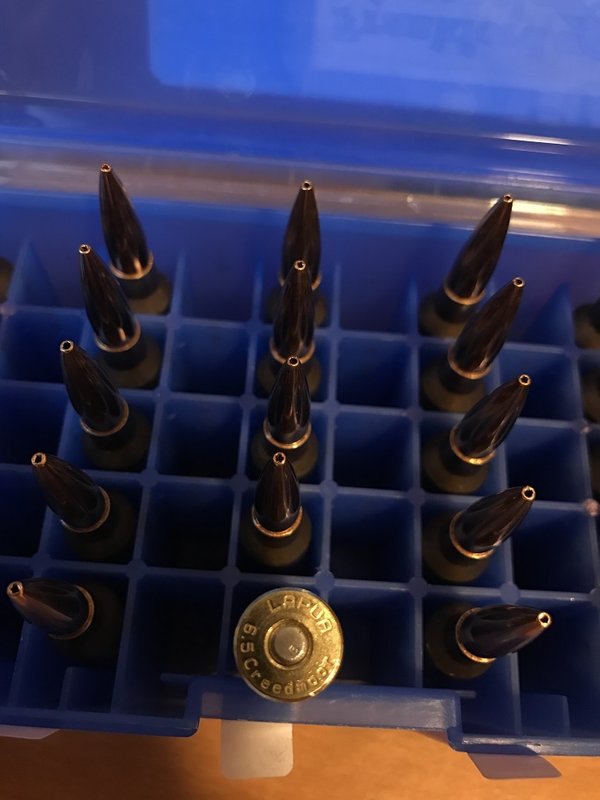

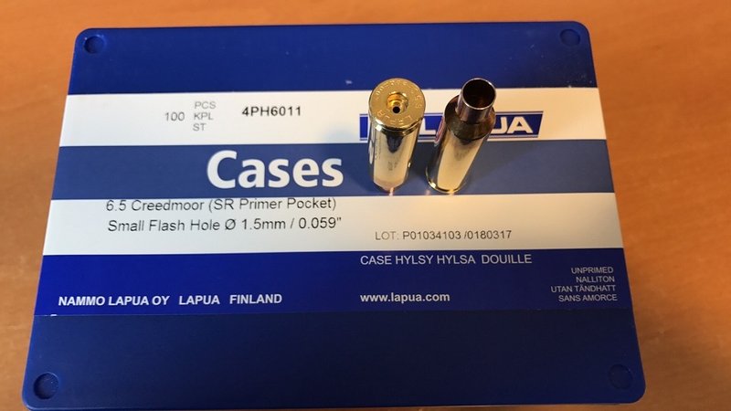

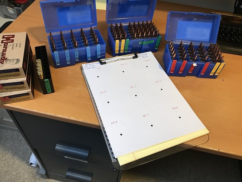

So I wanted to see if anyone has had a chance to try the new Lapua 6.5 CM Brass yet. I'll be doing so tomorrow with my DT SRS A1 with a new 6.5 CM barrel from SAC.
I haven't used VV before but got some N550 and am going to do some development with this as well as Varget. My old "go-to" load was 37.5 Varget with a 136 scenar l .005 from the lands and it was a laser.
This brass isn't fire-formed yet, so after I fire these 100 and get a good load node I will then play with seating depth. Then I plan to do a comparison of Hornady original large rifle primer brass vs Lapua Small Rifle Primer brass.
I've never been able to change a cartridges primer size....so very curious at what I will find...or not find...?
Thanks in advance for any feedback.

Niles and I posted a bunch of infomion in the original thread. He saw 25 fps gain, mine was similar, another shooter saw 50. I attribute that to smaller internal volume. There are water weights for each in that thread as well.
Lapua does the small primers for more consistent ignition. It does make the case head very stout as well. You'll find that these cases are much stronger than hornady. More importantly though, the neck wall thickness is far more uniform than hornady.
P.s. No need to fireform, just load your OCW go to town.

Thanks guys. Just went through the post and extremely helpful. I shot this new brass today and was very happy with it. I also shot box 120,140, and 147, and that shot better than I've ever experienced. This was all through a new barrel. Next week I will load up some original hornady 6.5 brass, but I'm sold on the Lapua now!
