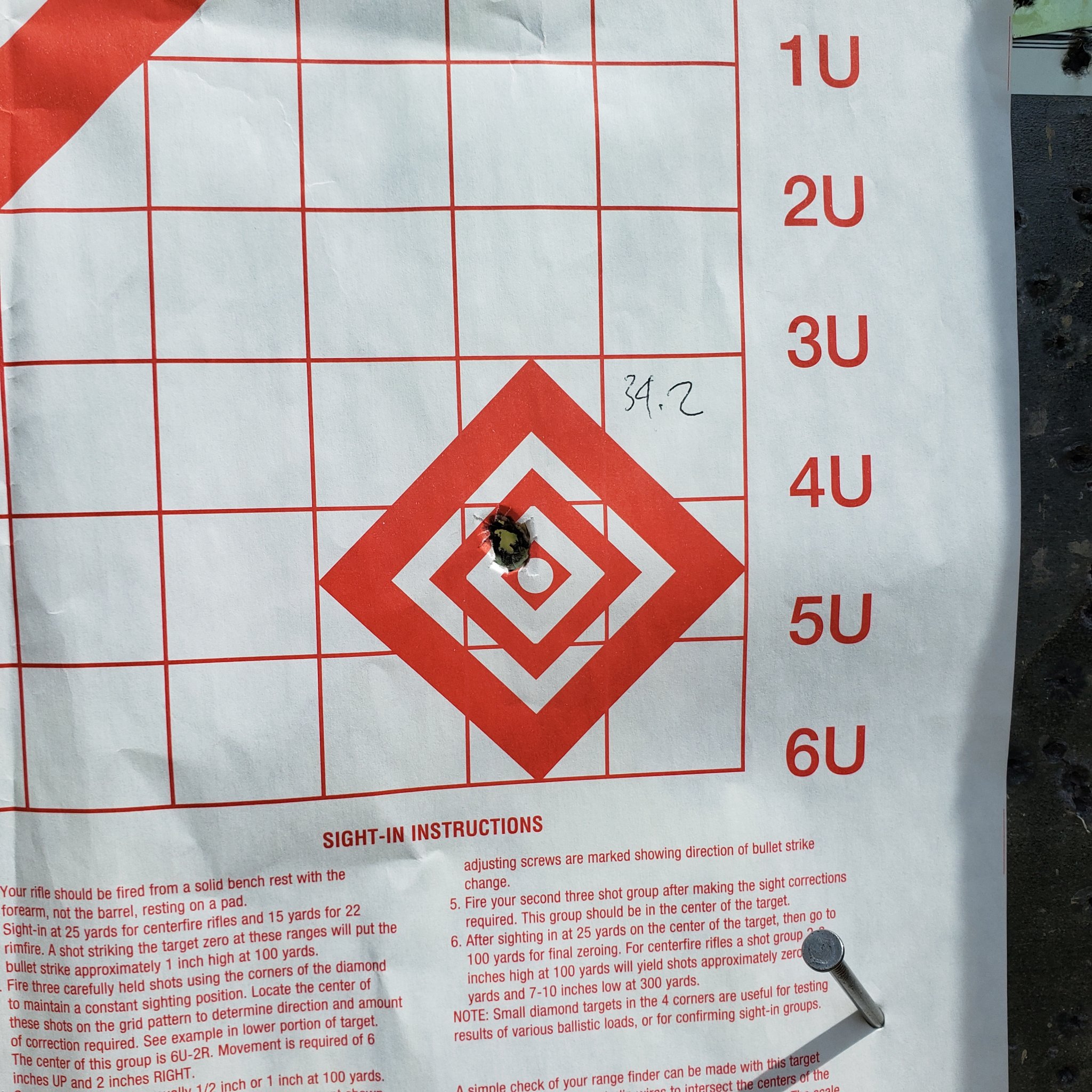

    Worked up a load doing what the manual told me to, (i think it was Bergers) which was to start at their lowest load and work up. It wasn't long after (i think my 2nd load ladder) that I started to get sub .75" groups very easily. I then took the 4 charge weights that were the smallest out of both ladders and competed them, and shot this 5 round group. The charge weight was 34.2 of Varget in Alpha brass with 140 berger VLDs loaded to 1.988" BTO.
    I then had a reloader that is much more talented than myself tell me this is too little of powder and that I risk a high pressure situation due to the powder not burning in the desired order of back to front.
    I shoot for group size only and velocity is not a care of mine. Does anyone else shoot loads more torwards the minimum side of the manual?

    You are fine with that load . Some published data for 140s goes as low as 32 grains of Varget . Looks like you found a load your rifle likes .
    Edited to add...Berger book has 33 grains as starting load at 2388 fps w/ 36.7 as max load at 2618...fill rate at roughly 88 percent .

    I think the reason you have to use such little powder is because varget is a faster burning powder. You're also trying to push a heavier type bullet. This means varget will reach peak pressures before giving you the best velocity. That powder is not the best for the creed.
    The slower burning h4350, r16, etc will allow you to use more powder. You're gonna have enough powder of those charges to reach decent velocity before reaching peak pressures.
    All this does not matter though since you are not chasing speed and the load is shooting perfectly fine.
    That amount of powder seems reasonable for that bullet weight being that it's a slightly faster burning powder.
    Keep up the good shooting.
    “I then had a reloader that is much more talented than myself tell me this is too little of powder and that I risk a high pressure situation”
    That’s a reference to detonation, which is why you shouldn’t start below a manual minimum. You’re in the book range, it won’t be an issue.
    One other thing. That single group looks really good. I would want to see at least five to ten additional groups that are just as good or even close to it before declaring success.
    While your load appears sound from a loading manual perspective, Varget is indeed a little fast for a 6.5CM, especially with a longer ( >=26") barrel.
    But hey, if you're getting consistent sub-1/2" groups with that load, drive on and enjoy!

    Understood. This is the 2nd group this size with this load. The other I think 3 groups were just a TAD larger than this with the other charge weights. The barrel's a rem varmint contour Douglas that I sent in the action to have barreled. Its not a finicky barrel to load for in my amateur opinion.
