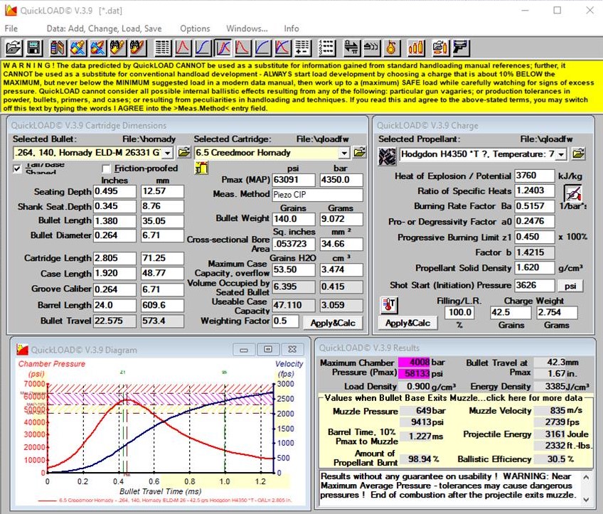

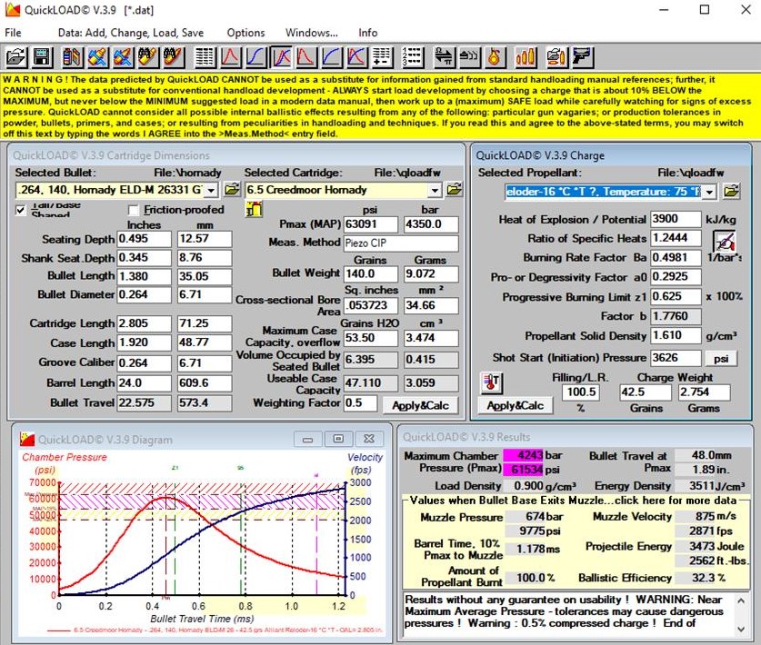

Here's some numbers that might provide some perspective:
I have QL, I know what number it should push out. Hit the little +- icon and it will tell you. You also have to play with the case capacity to get a true number. Every gun is going to be a little different. The 42.5gr of H4350 is a pretty well known load. A little high, but I don't have issues in Lapua or Normal brass. I have shot as as high as 43gr of H4350 with very good accuracy but back it down to a a safer level.
Yes, you're right on that one can work the numbers to get a more "true number." I mentioned the issue of dry powder simply to suggest the burn rate of your powder might be higher that the base number. The QL illustrations wasn't really for your benefit as much as it is for those who might see your numbers and wonder why they didn't/can't achieve that velocity in order to see some perspective. That's all. 🥴

Reviewing published data (the book kind not what people “say” on the internet) demonstrated that Superformance was giving a marked increase in velocities. So, I switched. Velocities matched the measured velocities of Hornady factory loads using the same bullets. (And I was not having to push the rifle hard) Velocities of handloads and factory laods were determined by a Chronograph, being shot on the under similar conditions on the same day. .
Now, why would I consider staying with that powder. I am getting better velocities with Superformance using moderate loads than when using other powders with close to max loads. Accuracy has been exceptional for this old shooter and metering is so much easier. Lots of reasons to “stick” with the that ball powder. (Pardon the backwards pun)
The only surprise this year, when working up loads for the Norma 130 H4350 (which is almost unobtainium) were very close to Superformance velocities. Since I can get Superformance, live in a moderate climate where temperature swings are all but non-existent, I really find no reason to switch.
