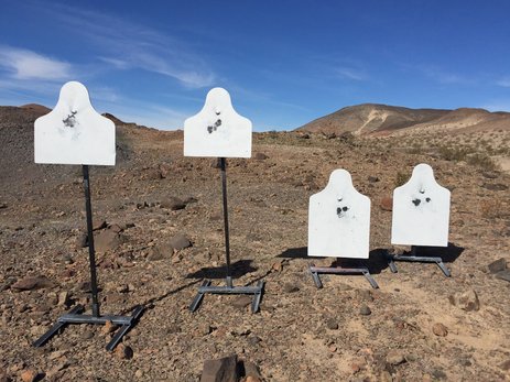

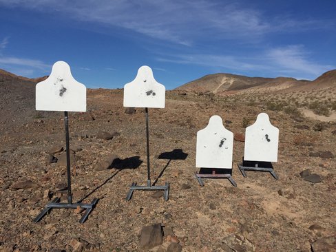

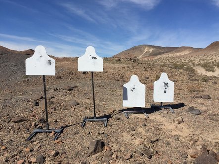

Below are three back to back tests using 42.5 gr of h4350(24" broughton,2930 fps). This was with no prep virgin brass, no sorting or truing of any type, and chambered with a saami creedmoor reamer. In the first two pics, the left target is .040 jump, then .030, .020, and .010. In the third pic, the left three targets were shot with "touching" loads. All three shot groups at 640 yards. Shot over an hour and a half or so. Same holds, group placement is caused by variable light winds. It was interesting to note that between .020 off and .040 off, velocities were very close between those jumps. .030 and .040 were dead even, and .020 was + 4 fps. As you get closer to the lands pressures begin to go up at an increasing rate. The jump from .020 to .010, and .010 to touching each produced an 11 fps increase(22fps increase from .020 to touching). In my pea brain, I like the fact that I can load at .020 for example, and never chase the lands, because out to .040 off, there is no meaningful change.
Ive duplicated this a number of times with different rifles, and typically load off the lands because of it. Pair these results with an OCW test, and you have a very consistent load.
On a slightly different note, I pushed this load to 44.5gr in lapua brass(same barrel, same bullet), which produced 3037 fps average. Brass lived fine. I settled on 43 gr and 2965 fps.
