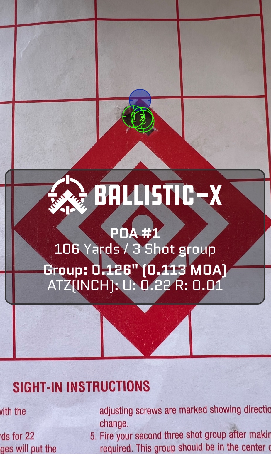

Try to run them around 2.810 and see how they like it. I’m running the same bullet at 41.5 grains around that seating depth and it’s a laser. The jump is over .100.. .125 iirc. Had trouble at mag length and just ran depth tests from 2.87 down to 2.780 and found a sweet spot around 2.800 and 2.820 image_cropper_5E9B2EF8-42D1-4282-9D3B-AF7A6C86C165-2936-0000013AB99D4214.jpeg
