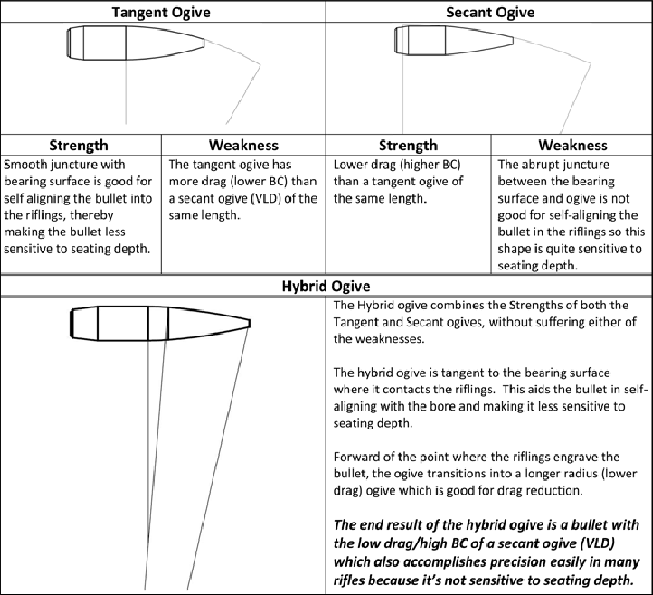

Not shorter, it's a pretty long bullet but has a longer nose section with the bearing surface further back similar to a vld design.
By going with a slightly shorter freebore it would give you more room to chase the lands and stay within mag restrictions for longer.
It's also a trade off if you decide to use the more common tangent profile of bullets as you will be in the lands at a much shorter COAL and also eating up case capacity a little.
