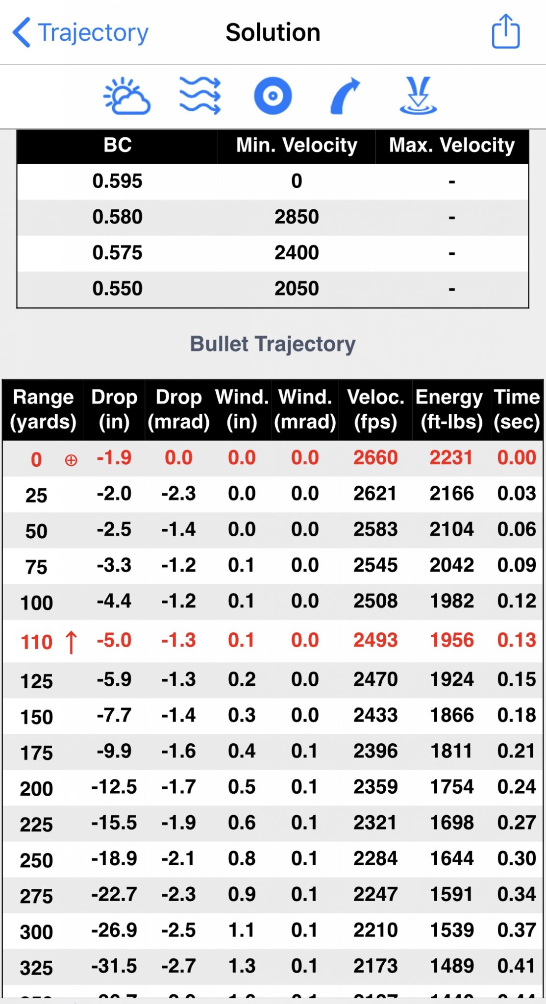

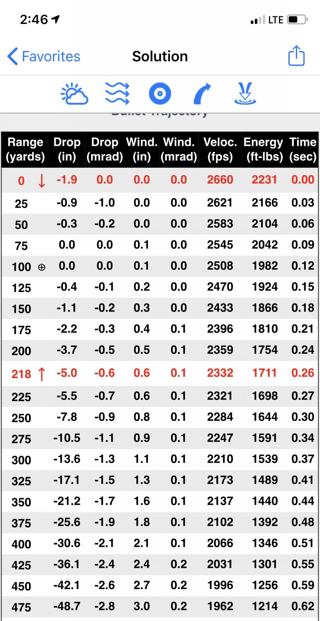

I thought a bit about your issue and thinking just outside the box I put together this info.
trajectory calcs using 0 yards as zero:
Note the between 100y and 200y, there is roughly an 8” drop.
Now look at trajectory calcs using 100y zero:
This doesn’t explain anything really. Unless of course your zero stop wasn’t really set at 100y for this round.
Trying to understand this using conventional ballistics logic doesn’t work at all, so I am offering another view. Think about it for a while.

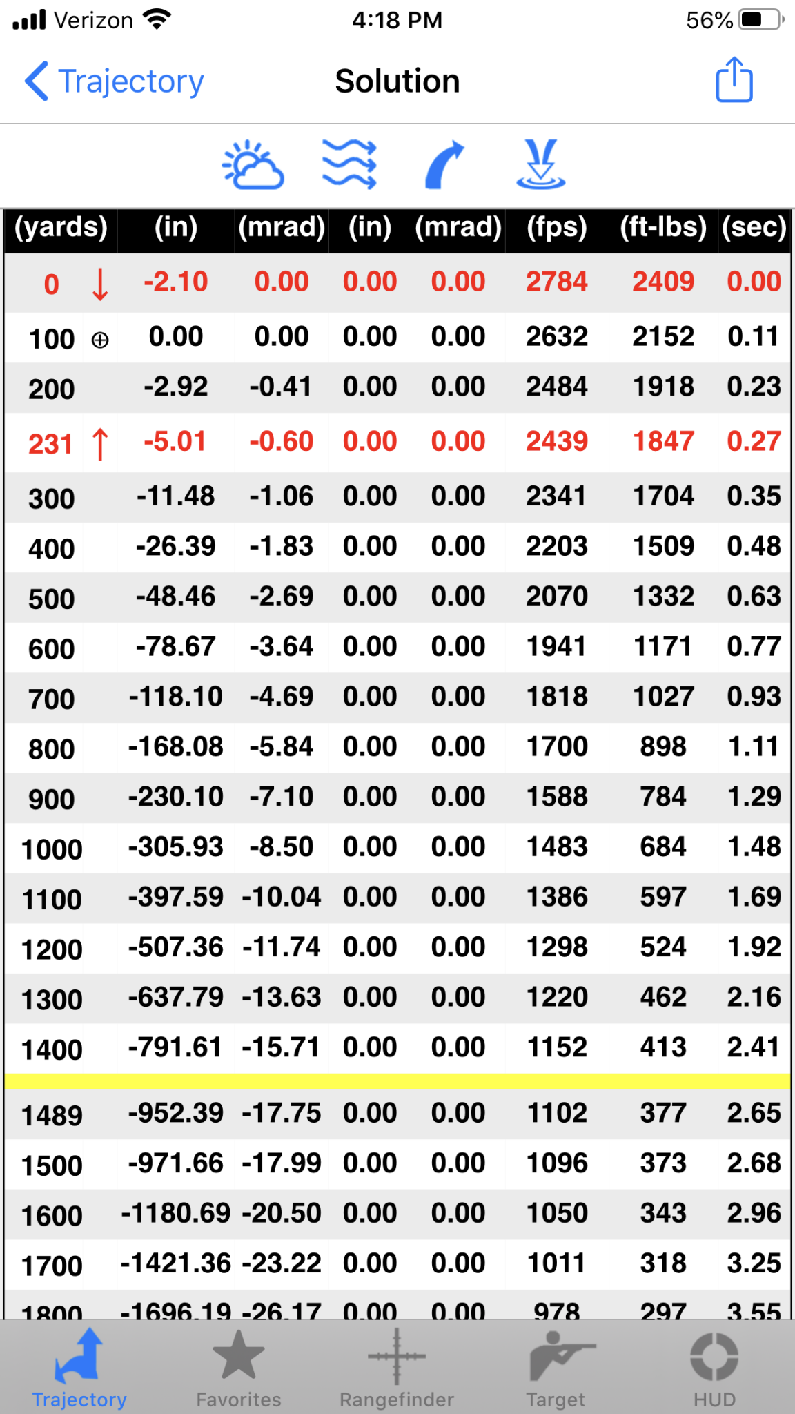

Here’s my 260 for comparison with a 140 BTHP at 2750ish.
I’ve ran this load for a lot of years in a lot of conditions.
