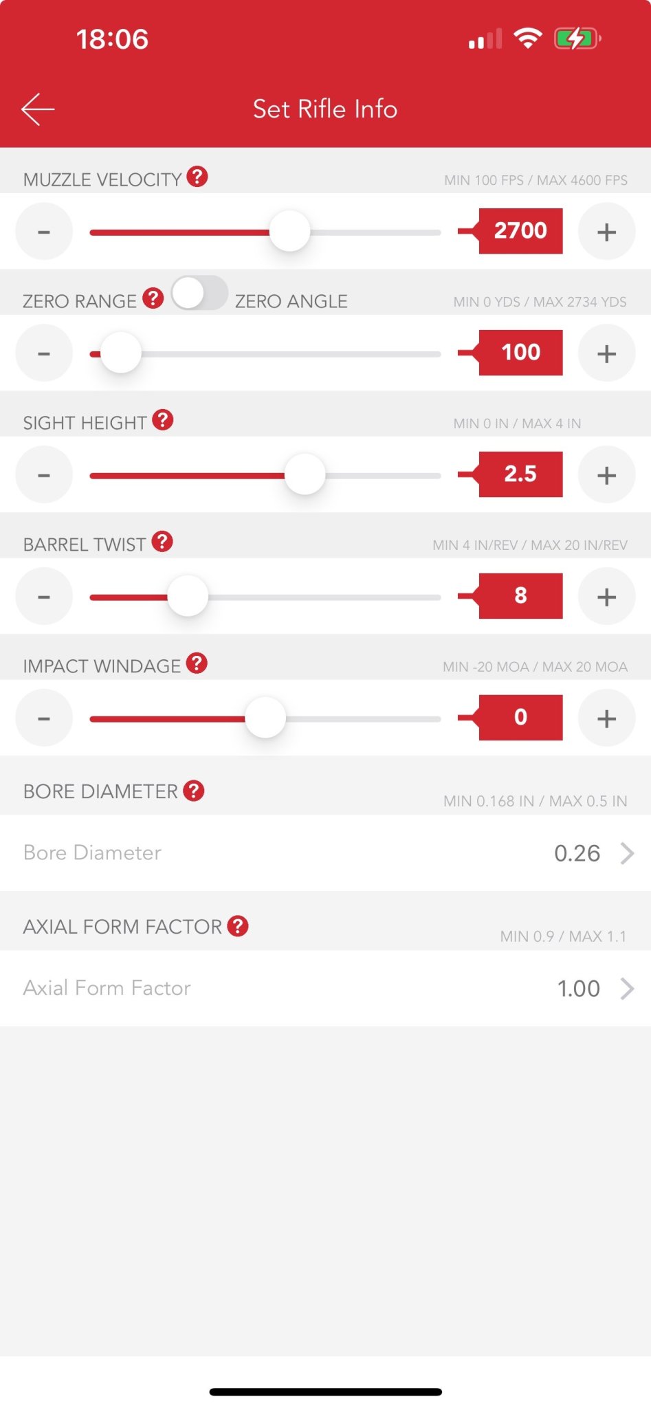

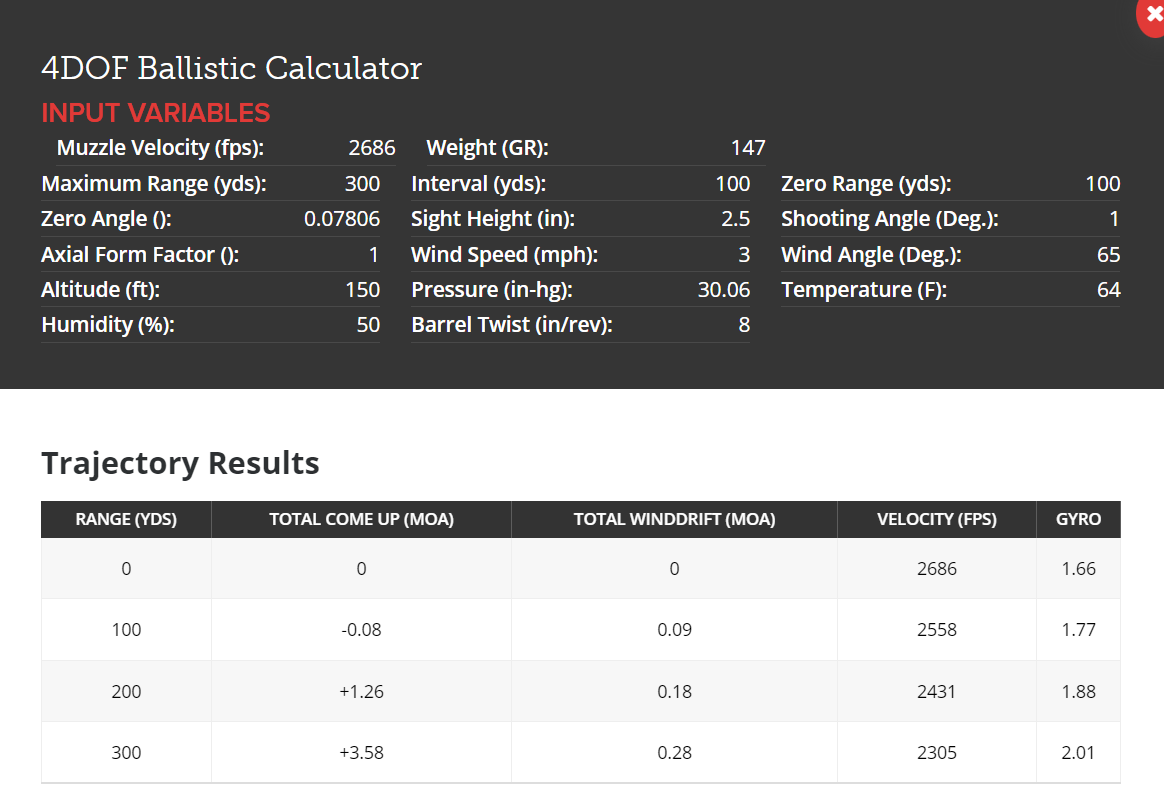

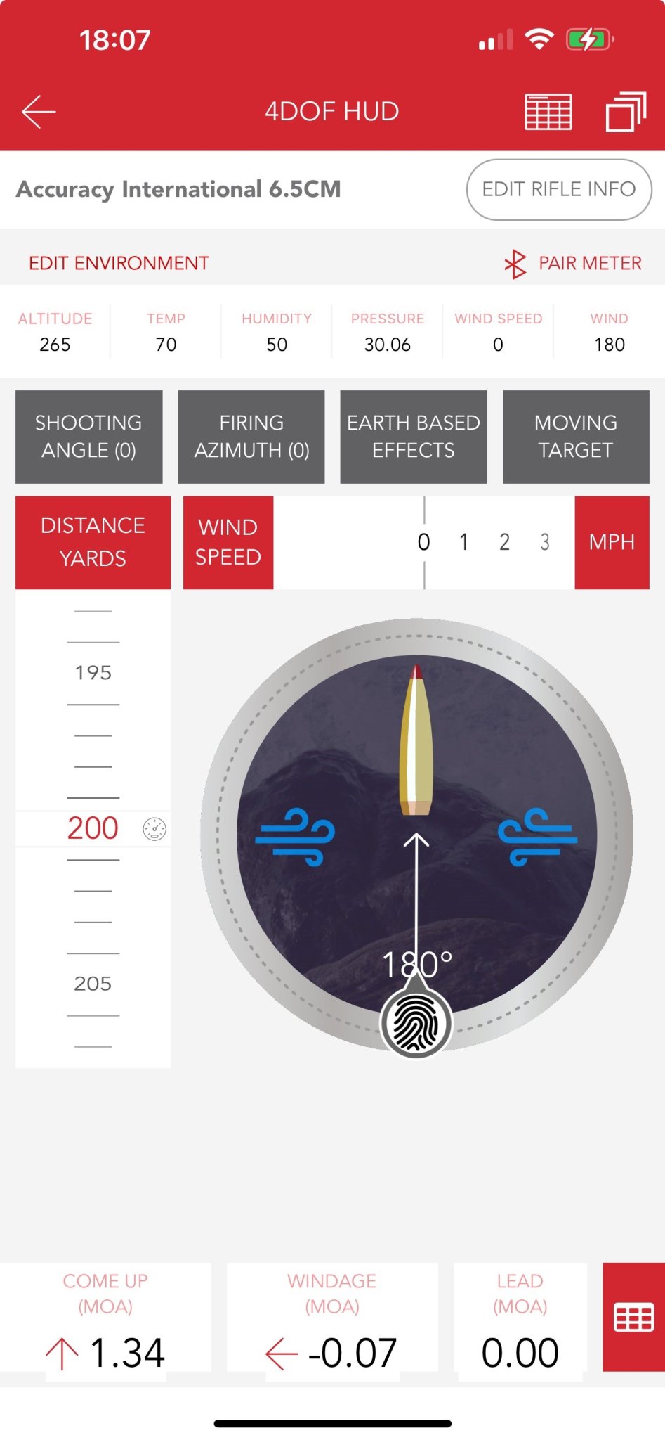

Not disagreeing that it's likely #1. However you say 1.8MOA, this is what Hornady 4DOF suggests:

I've replicated your inputs on my app and get the same results. I did have to turn of earth based effects and manually zero out azimuth as well to mimic your results. At 300 yards it shows 3.66 MOA which would be reasonable (almost exactly 1 mil).
It seems may have another type of error, not a ballistic solver error. A tall target test would be my first thing to test.

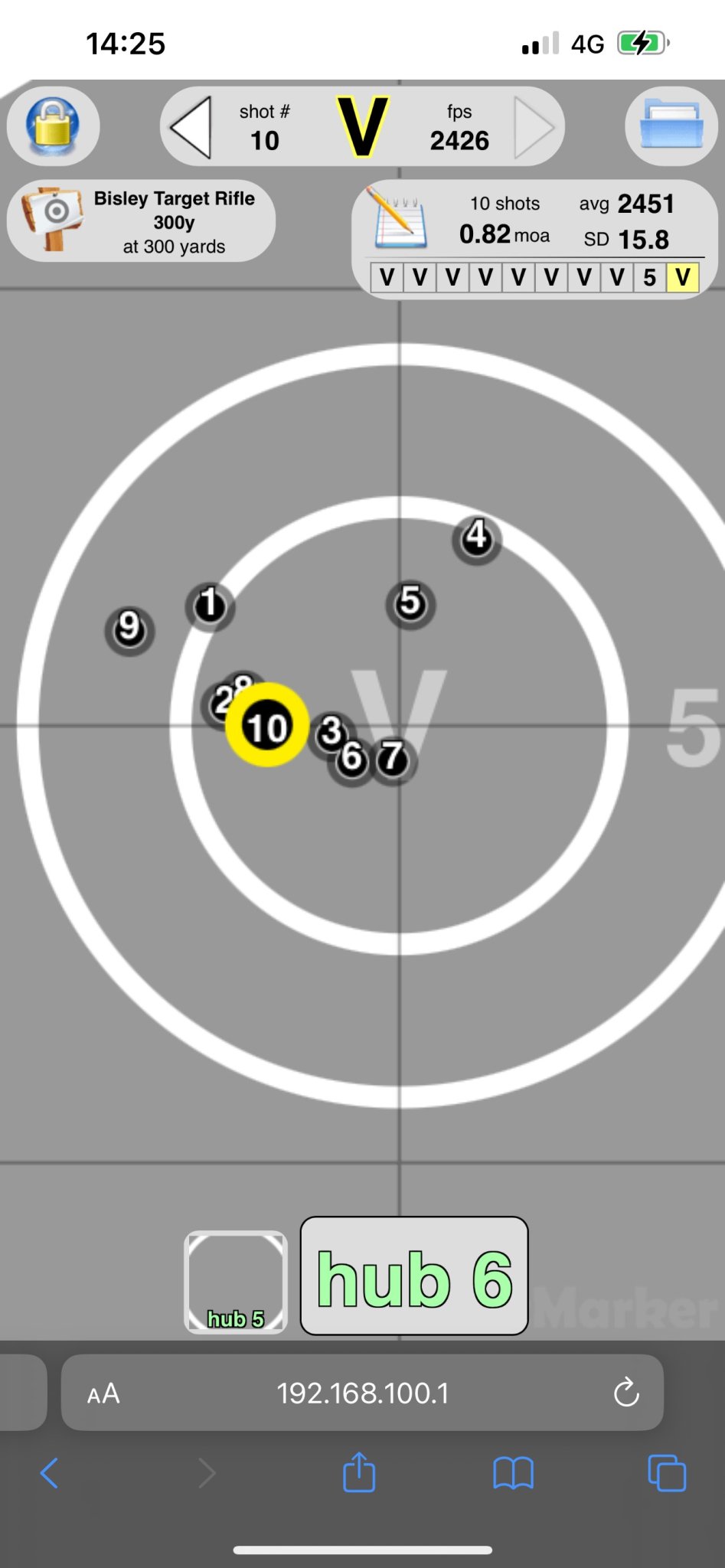

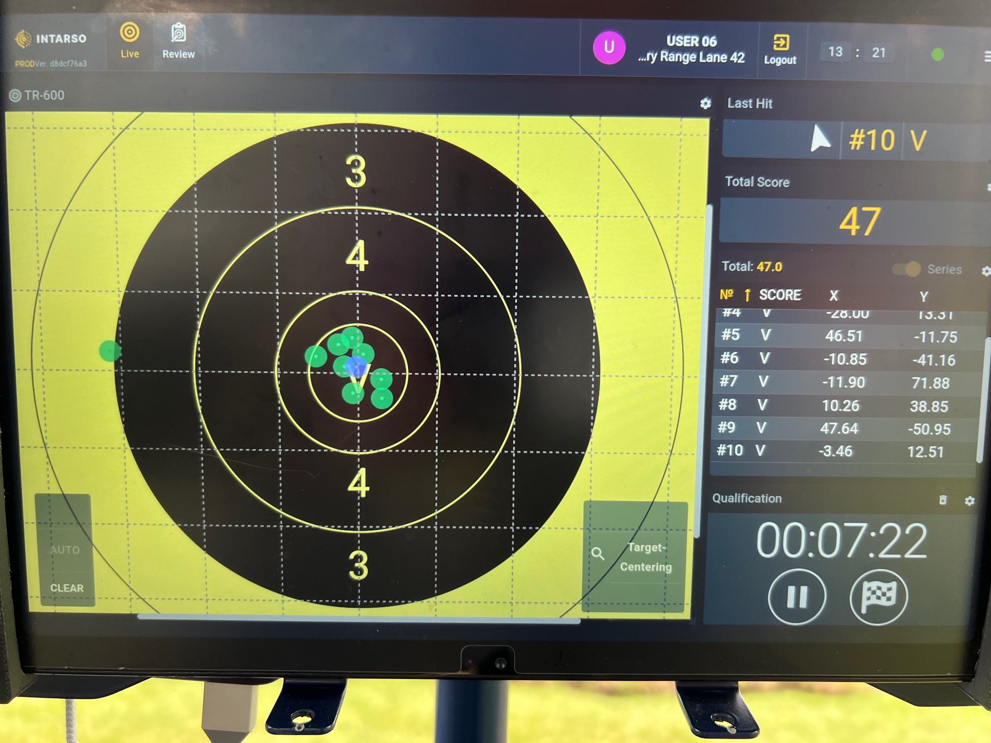

So I zeroed at 100 yards and then shot another 60+ rounds at target. Example of my results below, I think after about 40 rounds. What potential issues could I have with my 100 yard zero then, so that I have some idea of what to consider and eliminate?
Your group center is showing close to half moa high if this depiction is accurate. I would say that’s a big part of the problem.

Where does that velocity come from? Because if its at the target, you are only 16 fps slower than last week at 100 yards. That doesn't make sense either. Or do all the electronic targets use the 100 yard velocity?
It's calculated by the Shotmarker electronic target although I've no idea how it generates the velocity or whether it varies based on distance.
Garmin chrono showed MV from the AI with a low of 2655fps and high of 2721 with an average of 2685 which I used in 4DOF.
Out of the Ruger I had a single round register 3051fps which was 453fps faster than the slowest! 147gr ELD-Match.
It is calculated by the Shotmarker by measuring the passage of the shockwave past the two microphones in each sensor and then averaged over the 4 sensors.
Might not be 100% correct, but close enough to say that it is the average velocity of the bullets at the target.
I think three sensors are required to accurately triangulate the position with the fourth for redundancy.
That is indeed how it determines point of impact due to the time deltas to each microphone but not clear how that helps with determining velocity? Clearly I don't know the tech well enough. It would be interesting to know the level of claimed accuracy.
Every sensor has two microphones around 12 inches apart; the front microphone and rear microphone. This distance is far enough apart to use the sonic wave passing to caculate bullet velocity to be accurate to +-20ft/s. This is done as a data and sensor quality check.
The four front microphones work together to get a shot position in the front plane. The rear microphones work together to get the shot position in the rear plane. These two positions are then used to plot the angle that the bullet went through the target. This angle is used to differentiate cross-fired rounds.
Now, if your shot positions are correct, the velocity through the target must also be correct. If not, contact Adam MacDonald for fault-finding.

Responding to several comments here.
I haven't yet returned to 100/200 yards although I intend to. My suspicion is that my 100 yard zero wasn't 100% accurate which I suspect is the cause of the 200 yard discrepancy. It's either that or a kit set up although I did take a lot of care trying to level the scope using a gun vice and Wheeler scope level.
What is interesting is that my Vortex LRF paired with a Kestrel said that I needed a 13.0 MOA elevation at 600 yards. I dialled that and got this result.
The far left shot on the 2/3 ring was my cold bore sighter shot after which I applied windage. Inner bull is 7.8 inches so 1.3MOA at 600 yards. Given I'd never call myself an expert shot I was happy with this but will continue to work to tighten up my grouping.
