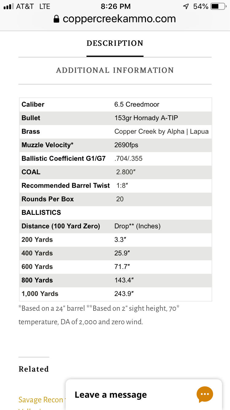

You can look on copper creek ammo’s website they list, you can click on the different ammo they sell and it list muzzle velocity and drops at various distance they don’t have tons of info but some, here’s a pic of the 153 a-tip info
Thats what started my wish for a comparison list on one page.
Lots of usefull data for one bullet but that left me wondering if a lot of ammo could be compared on one page
Like this one from Hornady but I was also looking for multiple brands of the same calibre ...one one page
