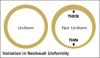

If you have turned necks you can use just a bushing die because it only needs to size down to your desired dimension and there are no discrepancies in the neck thickness that could get pushed to the inside. But because turning necks means that there is even more empty space that the fired brass expands to fill in a normal saami chamber you actually just increase the working of the brass.
To counter act the discrepancies in the brass thickness getting pushed inward on sizing down you have an expander ball. The fired necks are large enough for the expander ball to go inside of the neck freely but when the case is fully inserted into the die its neck gets squeezed down smaller above the expander ball sealing it inside. When you extract the case from the die the expander ball is now larger than the neck opening so the expander ball forces its way through and leave the neck that new expanded size. Because it is pushing from the inside out thosethicker areas will hopefully be moved to the outside leaving you a clean perfect circle on the inside to hold the bullet. Typically the expander balls are .002-.003 under your bullets diameter. That’s about how much interference fit/“neck tension” people typically have the best results with.
Brass is a metal and it has some elastic properties as well and plastic. The more times it gets fired the harder it gets. The harder it gets the more it wants to return to its prior shape. So when you size that body and shoulder back it won’t stay perfectly small, it will spring back larger a bit. Going back with that die a second time with the bushing installed then will still work it some, working of the brass leads to shorter case life. Double working it only does so even more. Sure you could screw the die up higher that second time to not touch but what’s the point? You’re doubling the work and number of pulls you make on that press for, well, nothing.
Now, if your bushing is only sizing it down to .002 under loaded diameter then the expander ball wont do anything for you, it will just slide along touching inside but not doing anything. So because it needs to exert force on the brass typically a bushing is selected that is .003-.004 under, that allows the expander to open it back up .001-.002" which should be enough working to move those thicknesses outwards.
You might hear someone mention mandrels for expanding the sized necks, that does the same thing as the expander ball but inside of dragging the ball up and out you force a mandrel down and inside in a second die/step. It should help leave the case necks straighter but thats not to say expander balls are lacking, they do a fine job I think, when you start with benchrest or higher level competition or just tinkering to fill time then look into it.

If you’re using lapua it typically has .0015 difference from one side to the other. Some people are fine with that and use just a bushing with the expander removed. If you are fine with that (or turn necks so they are perfect <but don’t>) then measure the loaded round neck diameter with your calipers and select a bushing that is .002 smaller than that. Be aware that due to the spring back it might not actually do that .002 and could actually spring back to to only .0015-.001 under loaded diameter. Fortunately you can get the next bushing up or down depending on what your results are.
Some other brass can be really bad and have .002-.003 difference side to side. In that case or just to be sure you can take the loaded neck diameter and subtract .003-.004 for the bushing and keep the expander ball installed which will open it back up.
It really all depends on what your components add up to.
Example: .264 bullet diameter + .014 neck thickness + .014 other side neck thickness = .288 diameter of your loaded round. (You can just measure this though without measuring independently)
.288-.004=.284 bushing with expander installed.

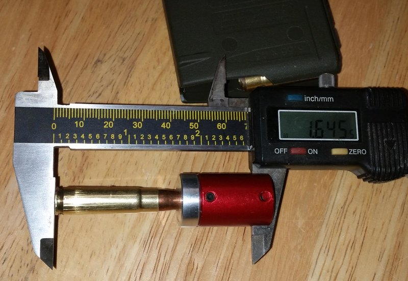

May be a stupid question but sometimes they have to be asked by the rookie. The wilson case length gauge a smart purchase or is there a company that makes better ones?
Some people swear by the wilson gauge but I like just a simple set of comparators on my calipers.
The wilson gauge tells you if all measurements pass saami spec or if one thing fails. It doesnt tell you which dimension failed and it doesnt tell you what all the actual measurements are.

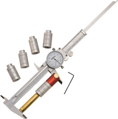

The headspace comparators install on your calipers. You can use just the plain calipers to measure your diameters before and after and you can use the comparator to measure your shoulder measurement.

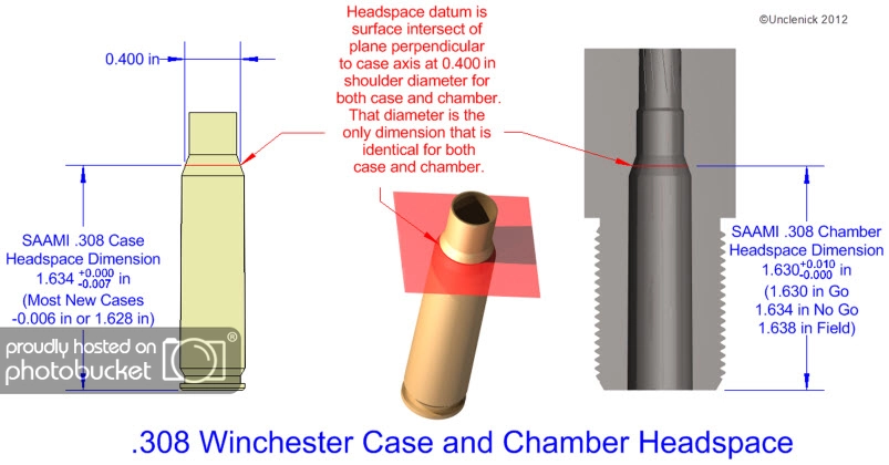

Because the shoulders are a sloped surface you need a consistent way to measure them the same each time. To do so you use a datum, essentially a plane that contacts the same place all the way around the case. You choose a bushing that has the correct diameter hole in it to hit midway on your shoulders, because that hole in the bushing is is fixed the shoulders will settle in evenly all the way around to the same spot each case.
Most cases use a .400 hole, 223 is smaller with a .350, mags are larger etc., which comparator bushing you use depends on the case youre measureing. Hornady puts a slight chamfer on it and sinclair actually makes theirs match the cases shoulder angle and these can vary slightly between batches or case etc so your comparator measurements cant be compared directly to someone elses. These arent absolute measurements. They are relative to your equipment and your processes and thats all that really matters. So long as you use your tools for your measurements you will be just fine.
So that shoulder measurement is what we refer to when we say we push the shoulders back .001-.002 in a bolt gun and .003-.004 in a semi.

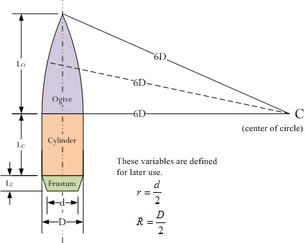

In that same red case body you can also install a bullet comparator to measure your bullet seating based on the ogive. Its basically the same thing only diameters for bullets instead of cases.
The tips of bullets can vary wildly, measuring closer to the bullets bearing surface is much more consistent and is actually more accurate for what we are measuring which is where the bullet interfaces with the barrels rifling.
Technically the ogive is the entire curve of the bullet.
When we reloaders use the term we are talking about the curvy part real close to the cylinder/bearing surface.

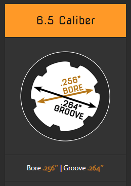

A 6.5 bullet will measure .264" in diameter which matches the bore but the lands of the rifling ramps up to a smaller .258" to cut into the bullet so that it can hold onto the bullet in order to spin it.
The hole in the bullet comparator will measure .260, that puts it right about where the bullet will first touch the rifling/lands.
(I realize this isnt exactly to scale and as-drawn would never obdurate enough to seal off the bore, its just a simple demonstration)
So I like the horandy tools because it allows you to take all of those measurements on your own stuff. Its easier to replicate your ammo from one loading session to the other if you know what you were actually loading.
