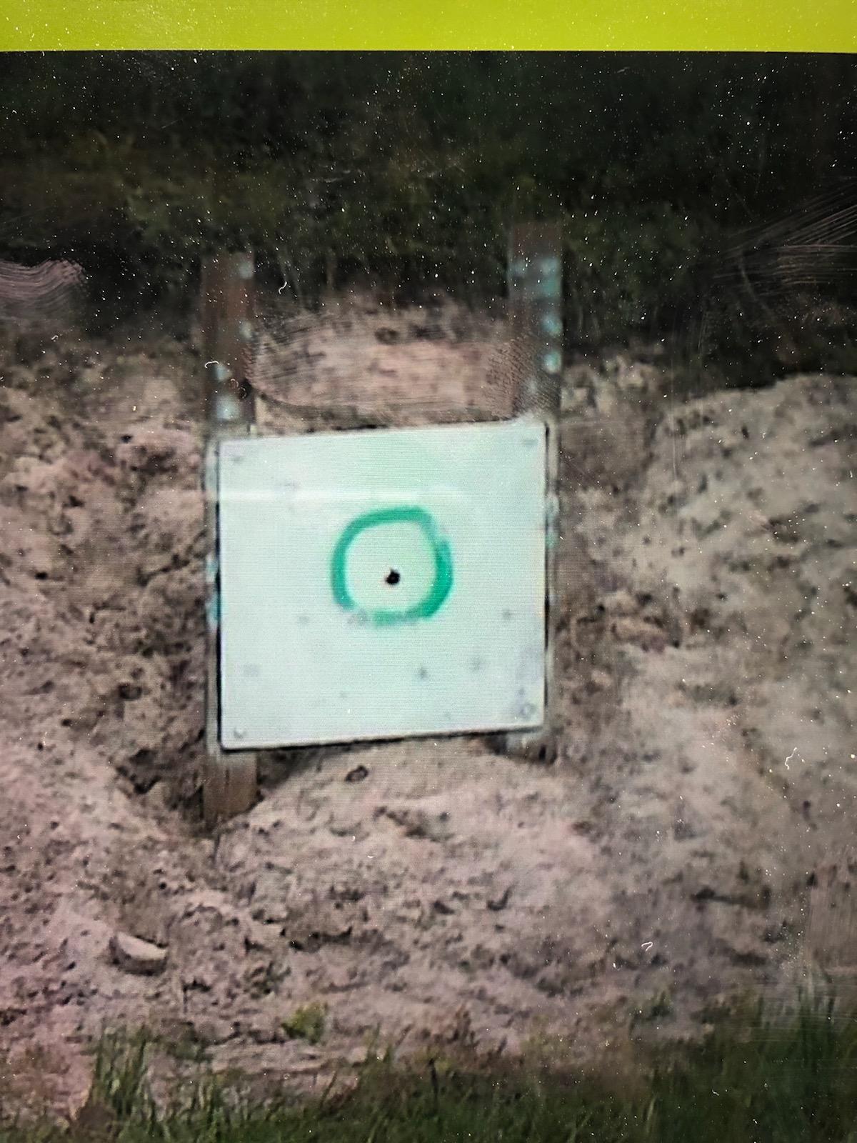

Well you didn't miss much OTHER than bbq that's for sure....I'm gonna brag on you a bit. @Schütze shows up yesterday never having even looked past 1200 yards and with factory ammo. Sea level, hot, humid and 5-7 mph winds with typical FL storms passing through the day gusty and variable. First round perfect elevation just off target I'm thinking ok that's tough to beat here we go. He snuck one just inside the 12" bullseye by 5th or 6th shot. Then went over to the 2moa target and he just got in the zone and punched a bullseye that was maybe 1" high and 1" right of absolute dead center. Was fun to watch way to go man I knew you were going to do well b/c I've seen you shoot, but was under the assumption the factory load was going to be a hurdle(ASSumptions were dead wrong). My gut tells me once you start reloading though it's going to make your mile adventures even more successful as I know that engineering brain of yours will have a load dialed into perfection quite soon But dang.....that was a hoot to watch you Schutze way to go man. The volume of hits you kept within 1.5MOA was extremely impressive with whatever it was you were shooting.
And Mike got his new load finalized for his new barrel last week and being the best shooter I know it was about like I thought it would be......borrrriinnnnngg. Was no different than wtaching him shoot at 400 just had to wait ~4 seconds for impact.....literally yawning after the first few hits wold have been easier to say 'let me know when you miss'.
So, while I was doing cabinet repairs for my Mom, @Schütze was doing this?
Not fair!
Not fair at all...😁
Great shooting T.
Reactions: newageroman
Just pure rookie luck, couldn’t have done it without 8pointer’s support and encouragement. The center 🎯above was perfectly shoot by 8pointer, I think he did this to give me a better point of aim :ROFLMAO: But of course lots of fun, surprised the prime ammo with the 130 Norma got me there. But thank you for the kind words guy’s.
