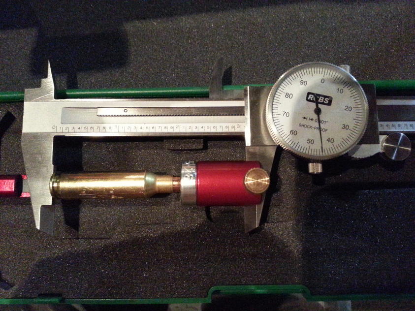

So I just picked up a Remington 700 in 6.5 Creedmoor. The guy I bought it from told me that the Jammed ogive measurement of 140 berger vlds should be 2.160 - 2.180. His last measurement was 2.165. And he loads them for a jump of 0.040 which would give a 2.125 ogive.
The problem I am having is that when I use the Hornady comparator and the same 140 berger vlds, my jammed measurement is 2.055. Which is 0.110 in different from his. If I were load the same bullets with the same jump of 0.040, that would make them 2.015......but this seems really short.
What am I doing wrong?

^^^^ What he said. Reason is your comparator body and insert are longer(?) than his and he may have pushed harder than you. Go off your data, it sounds like you are paying attention. That's never wrong.

It is also possible that your both using different 6.5 Berger VLD's. Berger makes a 6.5mm 140 gr Target VLD and a 6.5mm 140 Gr Hunting VLD. The nose length is quite different between these two similar Berger VLD's....
Berger 140 Hunting VLD nose length 0.721"
Berger Target VLD nose length 0.816"

That could be why! I bought the hunting ones. I would assume the previous owner used may have been using target vlds since this was his match rifle. I think i should find out. Thank you BobinNC!

The 0.816" nose is on the Hybrid Target. The 140 gr VLD Hunting and target have the same nose of 0.721". But yes not all the 140s are the same but it is Hybrid vs VLD that is different.
Loading for my .243, the Berger Target VLD's seat 2.884, touching the lands, the Hunting VLD's seat 2.830 touching the lands
and they are diffrent measuring them with my calipers and a comparator.
Is that a 26 cal comparitor? That would explain the difference if you guys didn't use the same insert. It's still valid for the measurement though.
Yes I am using the correct insert. Its for .260 the 5-26. The problem I was getting was reading the caliper dial. The hundredths/thousandths dial doesnt cross zero. Exactly on the tenths digit on the slide. When at approximately 0.4 inches on the slide, that's where my zero is on the dial. So as I was reading it was actually a whole tenth off from what it looks like....if this makes any sense to you....
