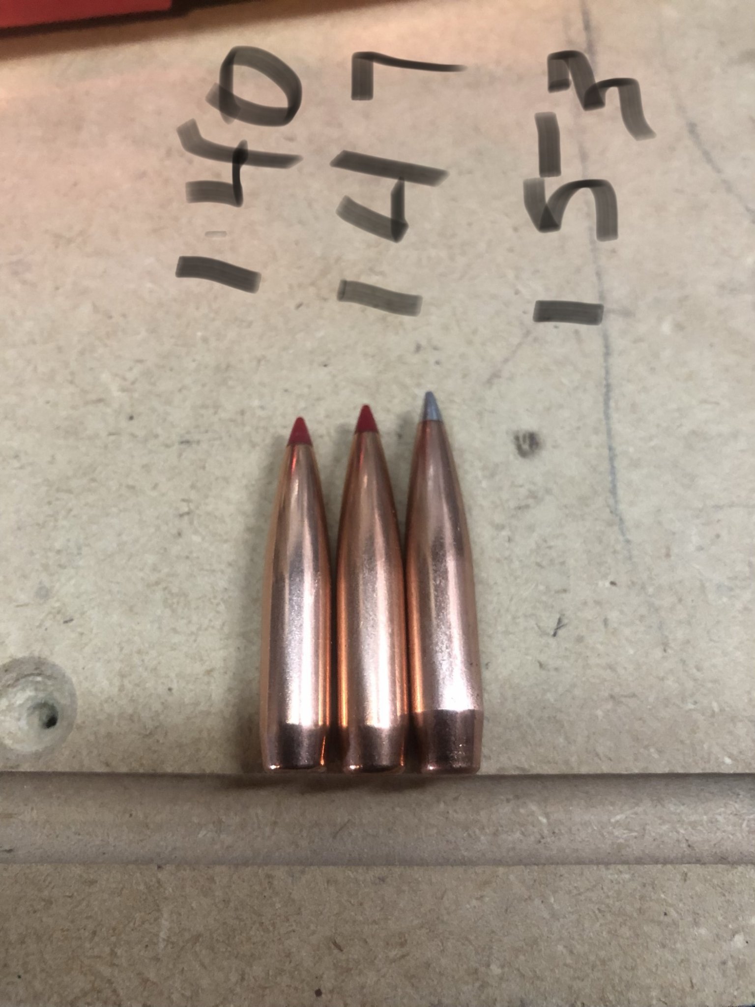

I have searched through here and have not seen much on the 153 grain A-Tip for 6.5 for Creedmoor.
I will say this... they are LONG.
I started working up loads Tuesday and running speeds on Wednesday. First of all, the bullet really drops at slower speeds... much more than the 140's or 147's. However, the wind has minimal effect on it. At a 500 yard distance, while my 140 ELD-M's were being pushed about 4" or more by the wind, the 153's were only being pushed an inch or so.
I did pick up some H4350 to try next trip.
Here is what I have from the Hornady load Data. Shooting from a Savage 10 Ashbury Ordinance with a 24" barrel.
I had the Superformance and RL17 on hand and saw they allowed the 2650 fps speeds, so I tried, what should have been the 2650 and 2600 loads. All seating was done to O.A.L 2.80.
All brass was shot once prior. Cleaned, sized, primer pocket cleaned, flash hole cleaned from inside. Primer was Federal Large Rifle Match 210M. No neck turning or concentricity yet... That's to come later.
This is all for the 153 A-Tip...
The RL17 at 42.9 produced the best. I'm curious to see how the H4350 does. Also, I want to boost the speed a little more. Clearly, Hornady had a different variable in their testing.

I loaded and hit the range in July. Temps were 90-95, so warm.
All loads were done with a digital scale that read to the tenths, so the value could have ranged from -.x5 to +.x49 where x is the tenths position. I really liked the H4350. The 42.1 load was fantastic, while the 41.2 load was not far behind in accuracy.

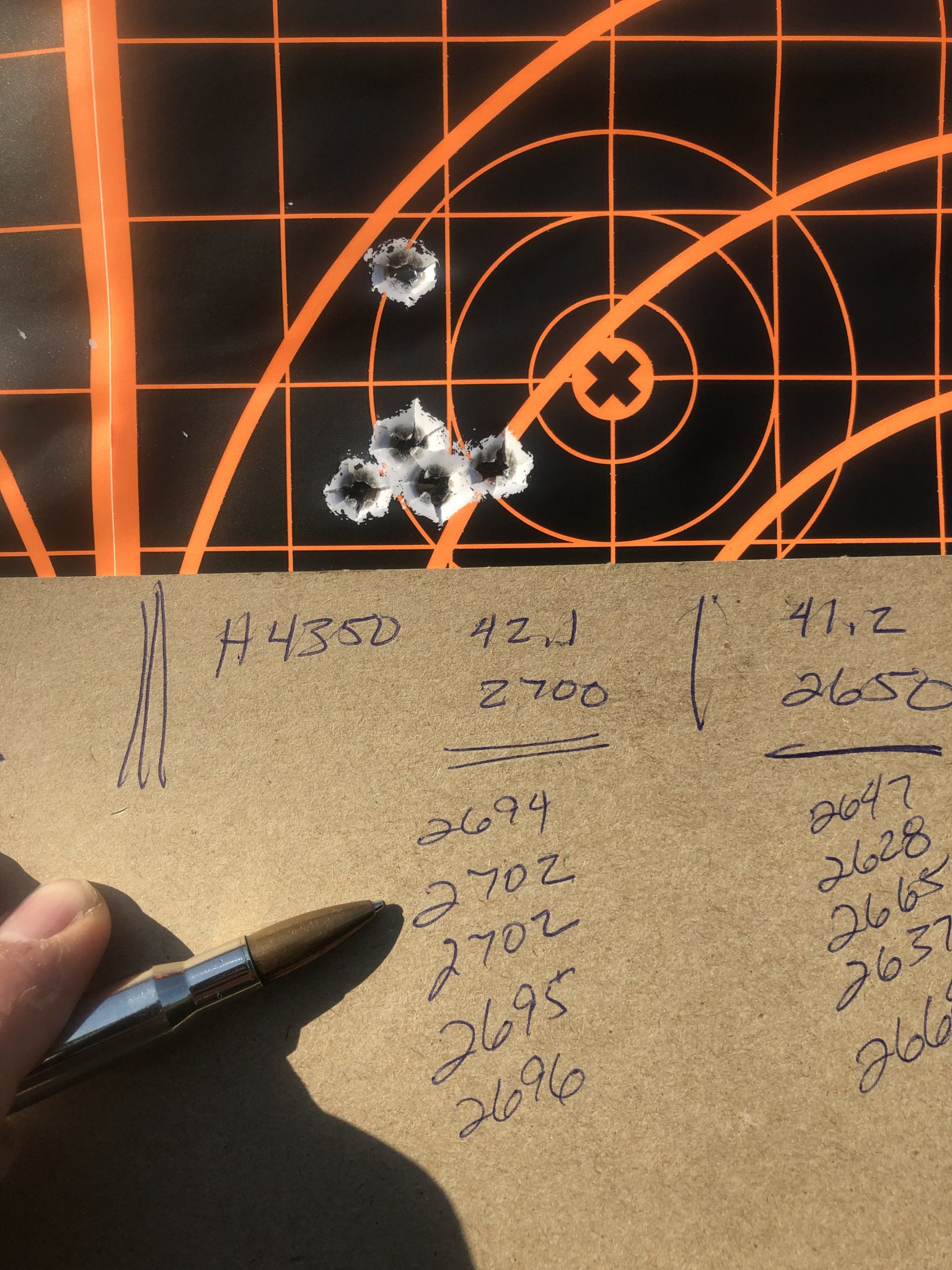

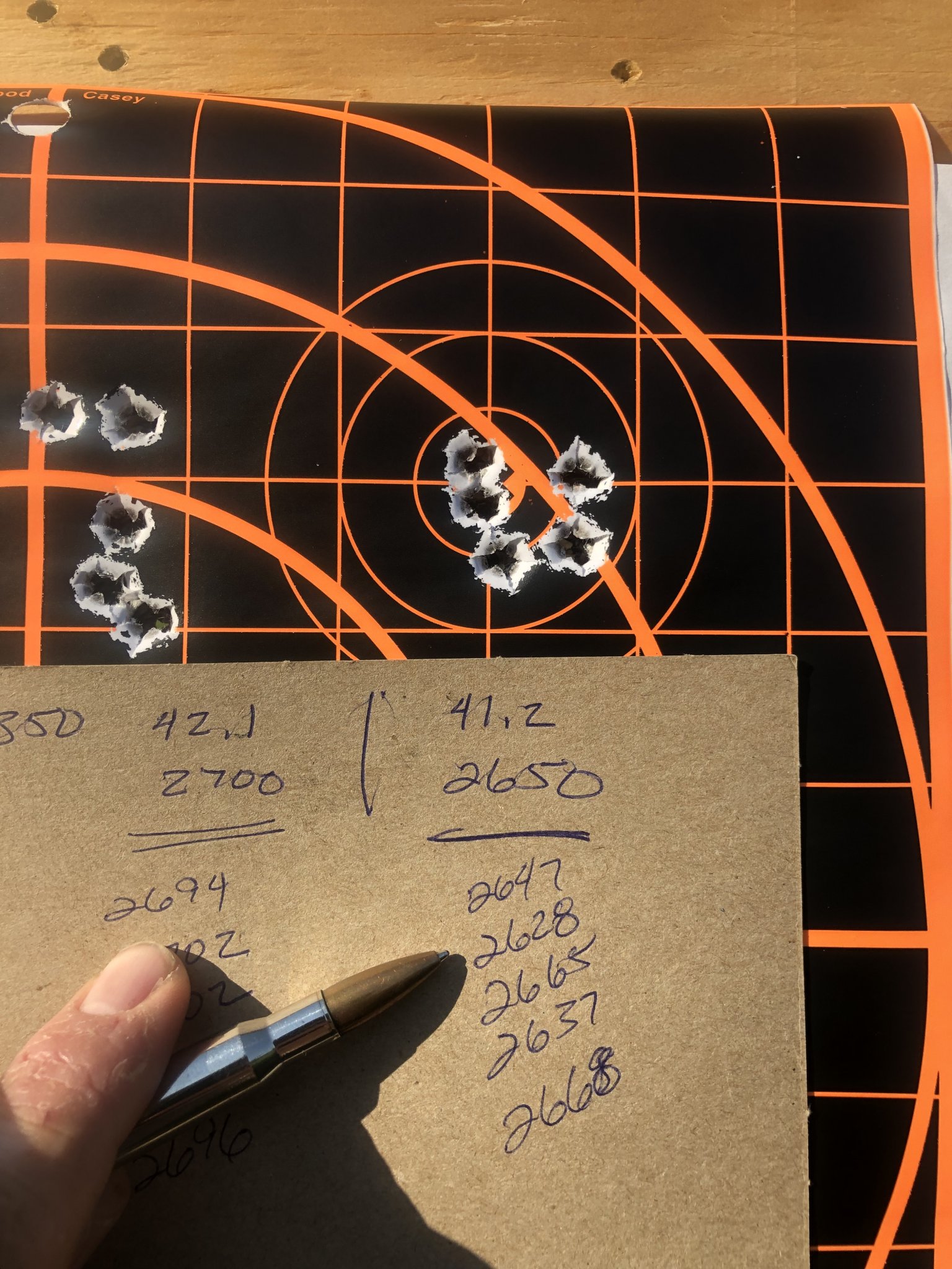

I've attached two images of 100 yard targets. 1" squares, gun zeroed at 500 yards, so holding for the group. I was looking for grouping, not hitting the bullseye.
Image 1114 is the RL17 with 41.0 load. Image 1115 is the H4350 load with 42.1. While there was one flyer, the remaining 4 were pretty tight. I've also included the image of the H4350 load at 41.2 as image 1116. Image 1116 group is the left most (the right is the image from 1114)
PowderLoadExpected12345AvgSpread
RL1741.82750275727652751276627432756.423
RL17412700269926972680267826882688.422
H435042.12700269427022702269526962697.88
H435041.2265026472628266526372668264940

I have been able to shoot these out to 500 and they are pretty consistent in placement. The last time out we had a variable wind from very slight to about 10-15 mph, right to left. I was able to send some 153, 147 and 140 down that 500 yards. The 153 were pushed some, but nothing like the 140, and the 147 was in between. so the wind had some effect, just not much. Maybe an inch for 153 vs 3-6" for 140's.

Shot 153’s at 500 yesterday and H4350 is my go to powder for these pushing about 2700 FPS. I have not had a chance to find the sweet spot between 2700 and 2750, but 2700 very sweet. Grouping was very tight and consistent.

1:8 twist in a 24” barrel. You will see slower velocities with a shorter barrel. Other powder might even work better in your rifle. I’ve pushed these to 2780 FPS but the start spreading from a tight group. Good luck.

What length barrel? "2800 fps With ease" may be a tall order for a 153 and 6.5CM.
Definitely at a disadvantage with my 22" barrel, but when I worked up a load with RL26 I found a high node going 2760 that didn't shoot too bad. I imagine a good 26" barrel would perform better. Once I'm done with this batch of 153gr A-Tip I'm going to try the 135gr A-Tip, because my barrel loves to send 130gr Hornady or Berger at about 2960 which I have a tough time beating with a 6mm.

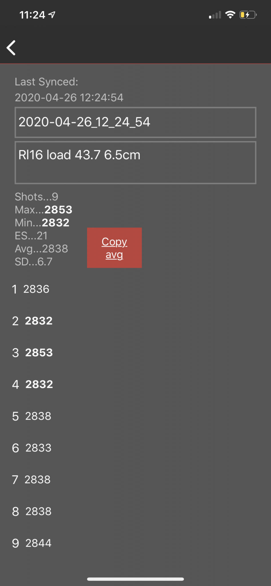

i have a 26 inch barrel. I just did some load development today with RL16 and the 153s, great results, 42.0gr 2804 FPS SD of 6, .005 off the lands.
I was really surprised by the speed today, on my last barrel (same length) I had run 43 gr to get 2756 everything else was the same
Including the case capacity, coal etc. only difference is the new barrel and with this barre I’m much closer to the lands. Other barre I was jumping .050. I wonder if being so close to the lands is causing a pressure spike.

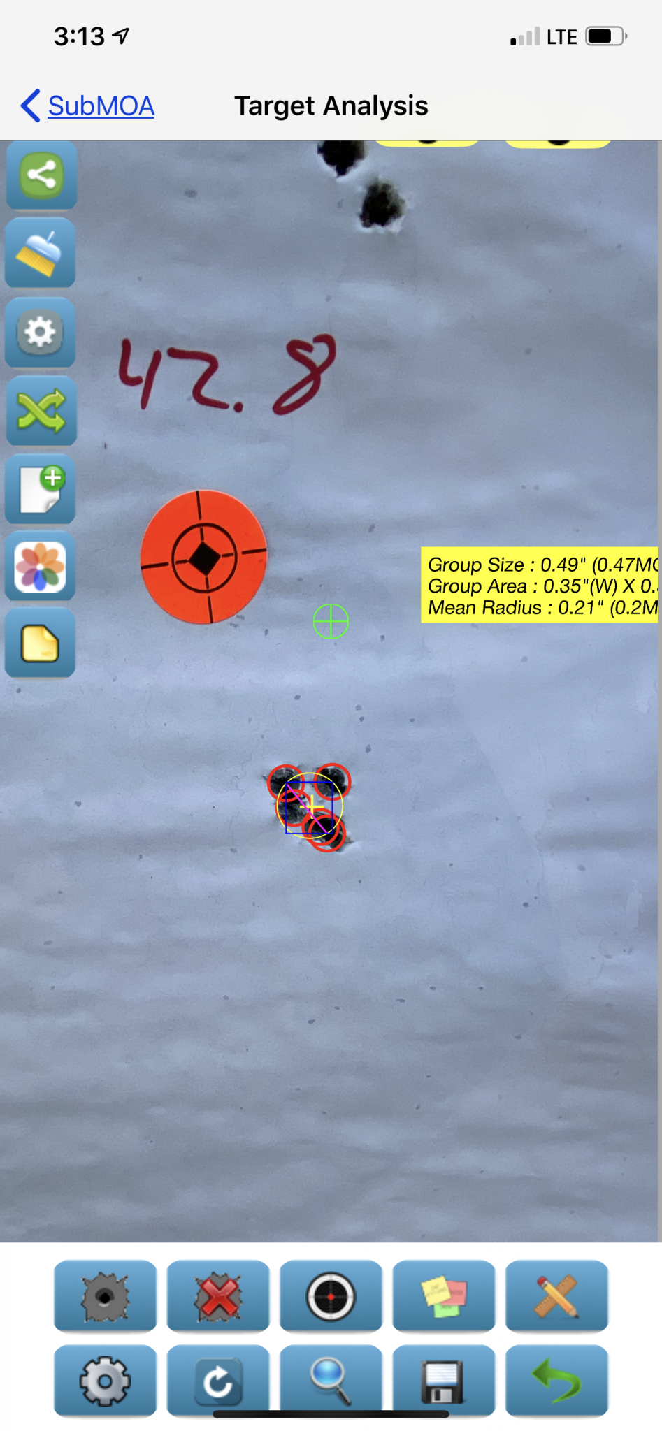

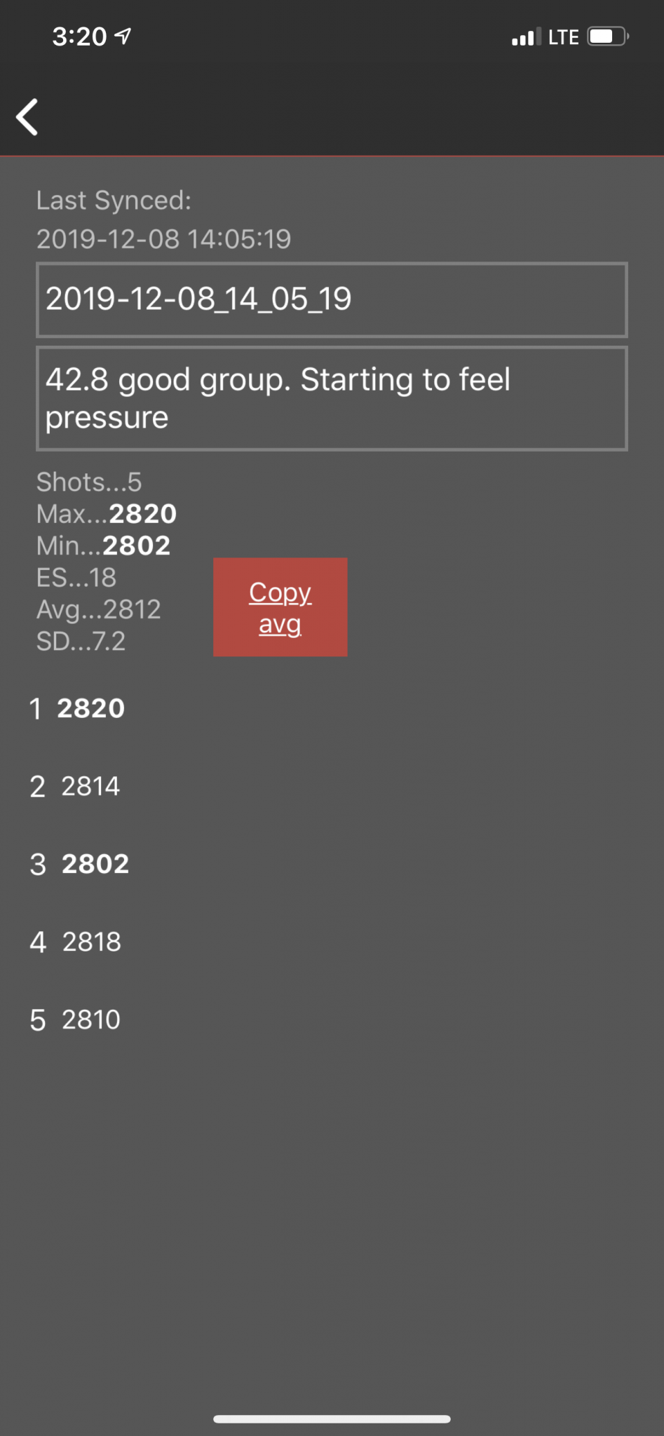

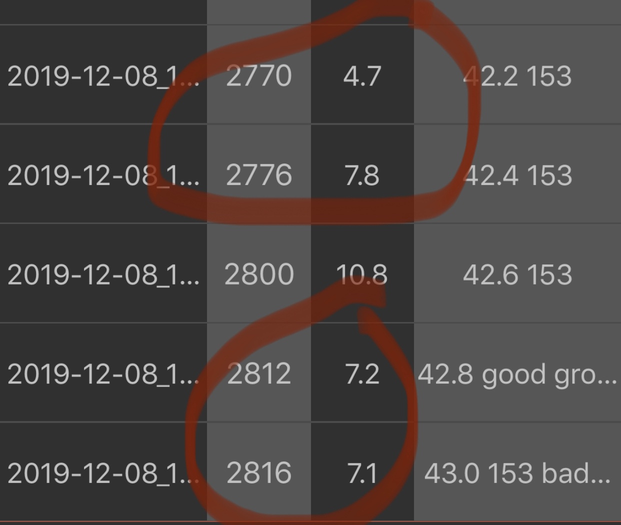

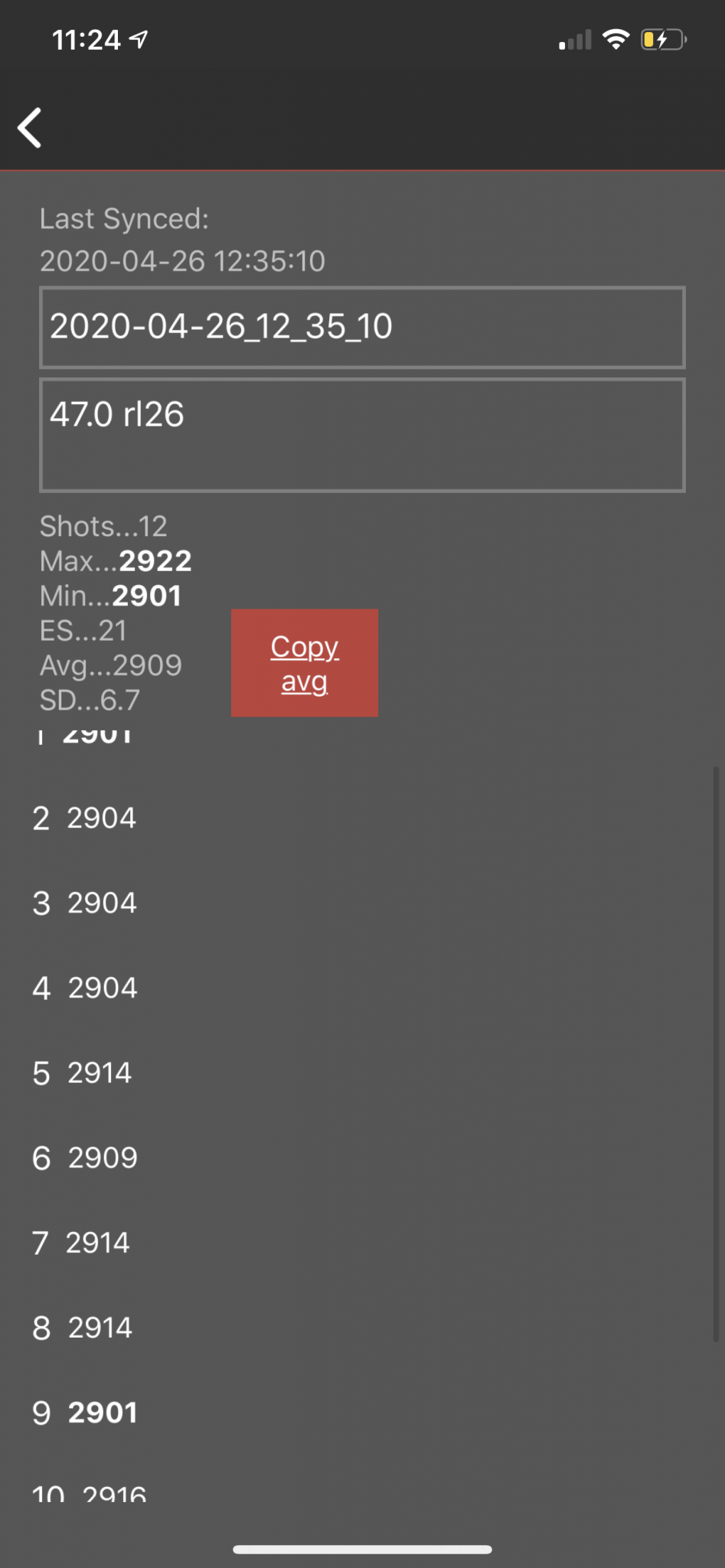

I did some load dev today using rl16 and the 153, very happy with the results. 2800 wasn’t a problem I could have gone hotter as well.
Here are some photos. Note all these were different loads
Try RL26 if you can find it. I was getting 2900fps with RL26 and 147eld from a 28” barrel. I even got as high as 3000fps but started seeing pressure signs.

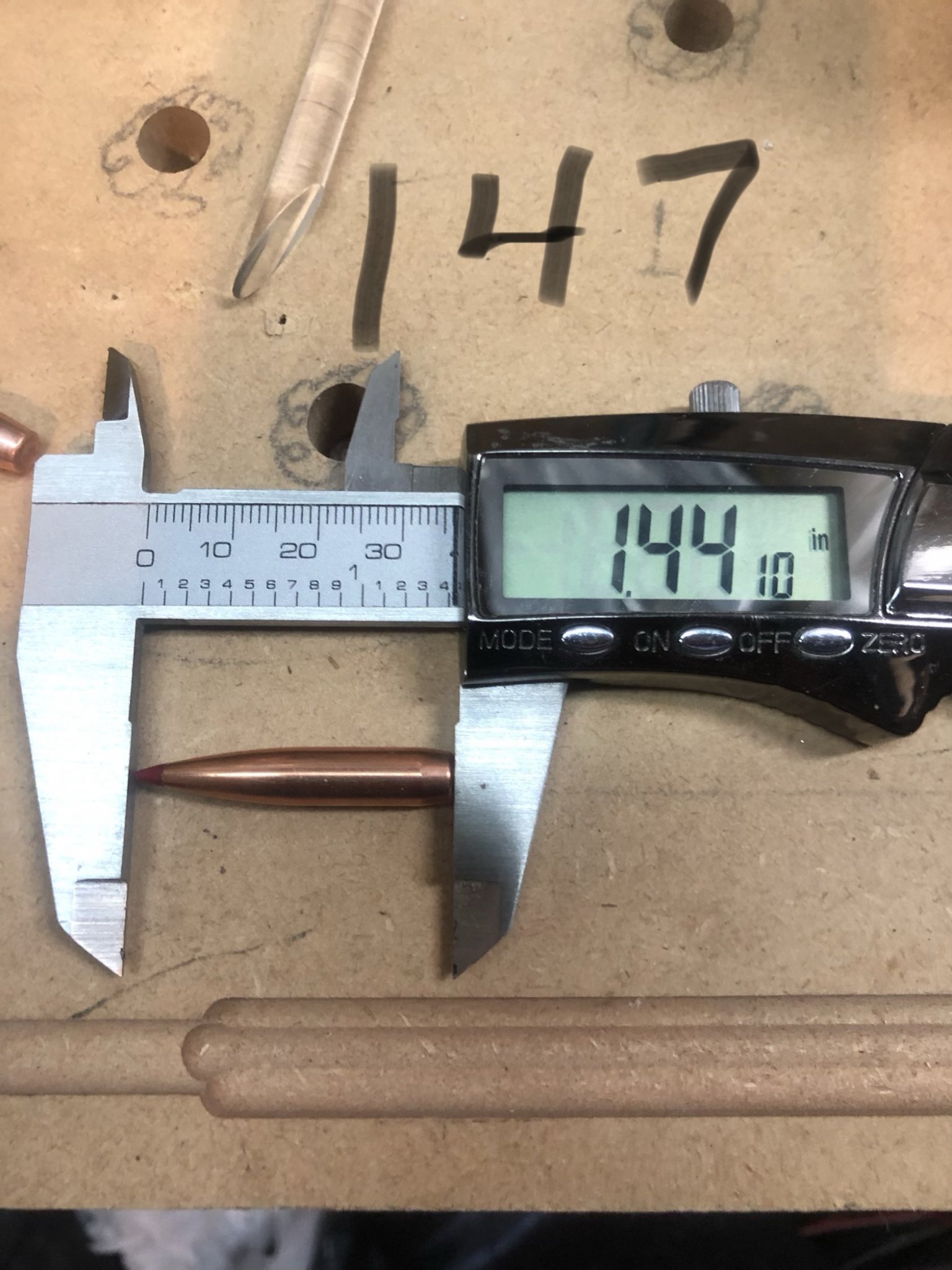

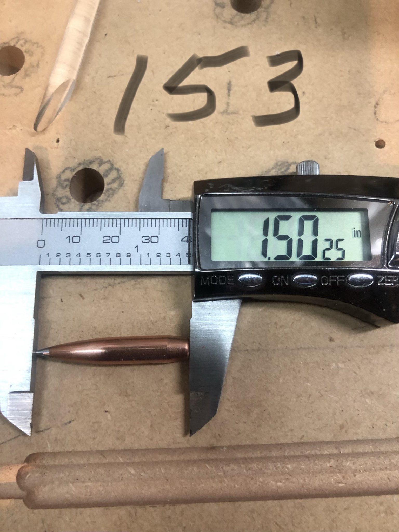

It’s cool to get the speed, but I would say the best powder all around for the heavies is rl16.
This is the two loads I shoot bow, one with RL16 and one with Rl26z
The slower RL16 numbers shoot better groups.

I've had a few 153 A Tip come apart out of my PRC. I have 200 more and them I'm going to try the new bergers.
What speed are you driving them at, and at what spin rate?
I have several 6.5 mm barrels, one is a 7 twist 30” Shilen Select Match barrel and with the right Reloader powder could drive the 147 ELDM and the 150 SMK to around 2950 (with mild pressure signs), and have not seen a bullet disintegrate. Have not tested the 153 Atip in that fast twist barrel, but will try when i swap barrels again.
I guess if you spin any bullet fast enough, at some point it becomes a real possibility. Always thought that happened around 3400 plus, but maybe it depends more on bullet construction.
Could also be a defective or damaged bullet, so maybe just bad luck?
Would be curious to hear from folks who shoot the 6.5 mm 153 Atip in a large magnum like the Weatherby mag and drive it beyond 3200 fps.
30" 1:7.5 Mullerworks going 3080fps with RE26. The load is probably pretty close to max SAAMI without going over. I have a target with four holes and then 12" over a banana shape where a jacket went through a fresh target. Last time I actually had the jacket embedded in the cardboard backer. It is too bad because the A-Tip is an incredible bullet.
Are you sure you didnt skip it lol? Or was this just at 100 yards? I have shot over 2000 over the 153s never had any sort of issue like that, I also shot a 1:75 close to the same speed. Sounds like you got a bad batch.
Do my posts seem unsure? I doubt my rifle would go from shooting under .5" to shanking a round a foot away sideways. The barrel has 300 rounds through it.
If you count the holes you'll see one missing. The bottom group is .4gr of RE26 higher than the top. I pulled the left shot.
Keep shooting them if they work for you. This wasn't the first blow up and I wasn't going to say anything until I knew for sure. I'm certain they came apart.
