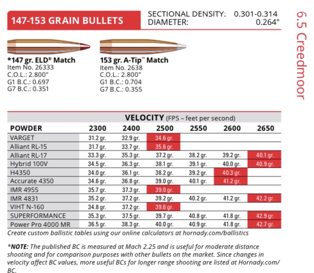

Here is what I have from the Hornady load Data. Shooting from a Savage 10 Ashbury Ordinance with a 24" barrel.
I had the Superformance and RL17 on hand and saw they allowed the 2650 fps speeds, so I tried, what should have been the 2650 and 2600 loads. All seating was done to O.A.L 2.80.
All brass was shot once prior. Cleaned, sized, primer pocket cleaned, flash hole cleaned from inside. Primer was Federal Large Rifle Match 210M. No neck turning or concentricity yet... That's to come later.
This is all for the 153 A-Tip...
The RL17 at 42.9 produced the best. I'm curious to see how the H4350 does. Also, I want to boost the speed a little more. Clearly, Hornady had a different variable in their testing.
PowderGrain LoadShot 1Shot 2Shot 3Shot 4Shot 5AvgSpreadStd Dev
RL1740.1263726362628263726232632.2146.37966
RL1739.2255925752586256025772571.42711.6319
Superformance42.92563258625752594256225763214.0535
Superformance41.82522251725122472249725045020.1866

Use the reloading table below from Hornady as your guide: Superformance, H4831 and RL-17 gives good speed according to Hornady. Just be aware that RL-17 is VERY temperature sensitive and you will need a winter and summer load, so use with sufficient care.
I have a tight chamber comp rifle that hits max pressure at least 1.0 gn before the max value stated in the Hornady reloading book. My Rem700 has a sloppy refinished chamber that needs 0.5 gn more than my Savage 12 to get same/similar speed (and it does not show pressure signs until powder charge is a bit beyond book max). Reloading manuals are useful guides and provides a starting point, but your own rifle will tell you what is best.
Start middle of book range and work up in 0.5 or 0.3 gn increments and watch for pressure signs like flattened primers (pancake primers), severely cratered primers and ejector marks, or heavy bolt lift. Then back off 0.5 gn from this powder charge and assume that as your max value.
Your optimal muzzle velocity (widest flat spot) may be as much as 100 fps helow max. Often 50-60 fps lower. Chasing max speed is not really advisable, rather optimize for best accuracy under variable ambient conditions.
