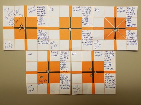

Finished my first ladder test using Reloader 17 with results attached - to say I was impressed is a drastic understatement! The brass is organized from lowest charge (top) to highest charge (bottom)...
Desert Tech SRS A1
6.5 Creedmoor
Vortex Razor AMG
ARC 30 MOA Mount
Atlas Bipod
The rest of the load data is included on each target attached, but basics are as follows:
Hornady Brass - once fired
Reloader 17
CCI BR-2
Full length sized
Trimmed to 1.915"
Seated to .020" from lands
Length to Ogive: 2.225"
Overall Length: about 2.858"
I loaded 3 rounds at each powder charge .020" from the lands in increments of .3 grains from 41.0 to 42.2 grains. No pressure signs and velocity trended steadily until the 42.2 grain group when things opened back up. Group #1 was a fouler group as I cleaned the barrel last night.
Group #4 may have looked just like group #2 (literally one hole for 3 shots) had I not pulled the second shot badly when a braked 300 Ultra Mag lit off to my left. I'll likely load up another 5 rounds at that charge to confirm one way or the other.
That said, my goal was 2800 fps with the 143/147 grain projectiles (supersonic to one mile) - the temperature was only 55 degrees - should I just stick with the one hole group at 41.3 knowing that velocity will likely increase with ambient temperature, or push the charge a bit?
All in all, it should be a VERY good performer with any charge between the broad node from 41.3 and 41.9 grains...
What was velocity for group number 2 and 3 ? I would have a hard time not using those loads

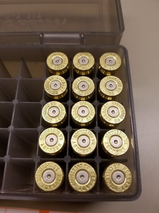

As far as brass pic....nothing looks blatantly obvious but...it is EXTREMELY hard to tell by looking at someone else's pics either posted online or sent via text.......i learned this when seeking the advice of others ....i could not take pictures that fully captured what I was seeing with my eyes in person and I was using a Samsung Note 5 with HD turned on using it's 16mp camera
Velocity is listed on each target
#2 - 2772/2778/2775
#3 - 2824/2813/2874
#4 - 2867/2861/2846 - as stated on the target, I definitely pulled the second shot. Third shot went through the first shots hole...
Tough call- #4 has significantly better velocity, but #2 is much lower SD. Unless the 3rd shot on #4 was just a wild fluke.
Maybe load up 10 rounds of #4 and do 2 more 5 shot groups to confirm accuracy and velocity?

Thought I'd share a few pics of groups for reference with both RL 17 and H4350 - certainly don't be a bonehead and use these for your own loads. These were shot from a 26" DTA with Omega Silencer attached. The question I have is as follows:
Since I didn't like the temperature swings in the RL17 I bought 8 lbs of H4350 - at first glance it appears that my rifle likes RL17 better for accuracy. Given the target data listed below, which combination would you run with?
RL17 with 143 ELDX
RL17 with 147 ELDM
H4350 with both 140 ELD AND 147 ELD
