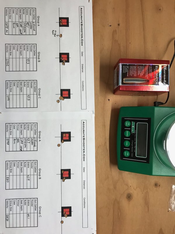

I shot this out of my Tikka CTR 24" today. Looking for a little help where to go with it. not my best range trip but I think i got some decent enough info out of it.
H4350
147 ELDM
Prime Brass
BR2
loaded at 2.895 OAL .030 off
Maybe work on seating depth? i like the Velocity out of the upper end but its showing just a touch of pressure on the highest loading.
Any help is appreciated

Very interested in this data....do you mind typing the results, as I can't read your targets...LOL! Thanks
Sorry about the pic I don’t know how to make it any bigger!
Velocity average for three rounds
43.1- 2678
43.3- 2752
43.5- 2771
43.7- 2795
43.9- 2813
44.1- 2835
That's a big jump from 43.1 to 43.3 Perhaps the first 3 acted as fouling shots or just heating up the chamber? Cleaned prior to shooting?
This was through a fouled barrel about 10 rounds through it before I shot those loads. I shot this through a shooting chrony so you never know why that thing is gunna spit out! Most of the time I just want to put a bullet in that thing!

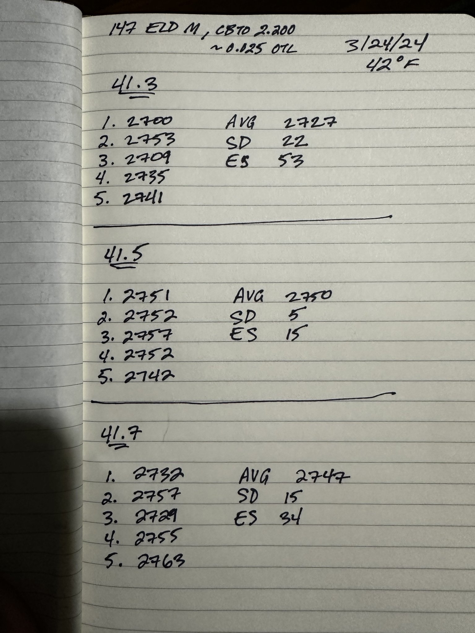

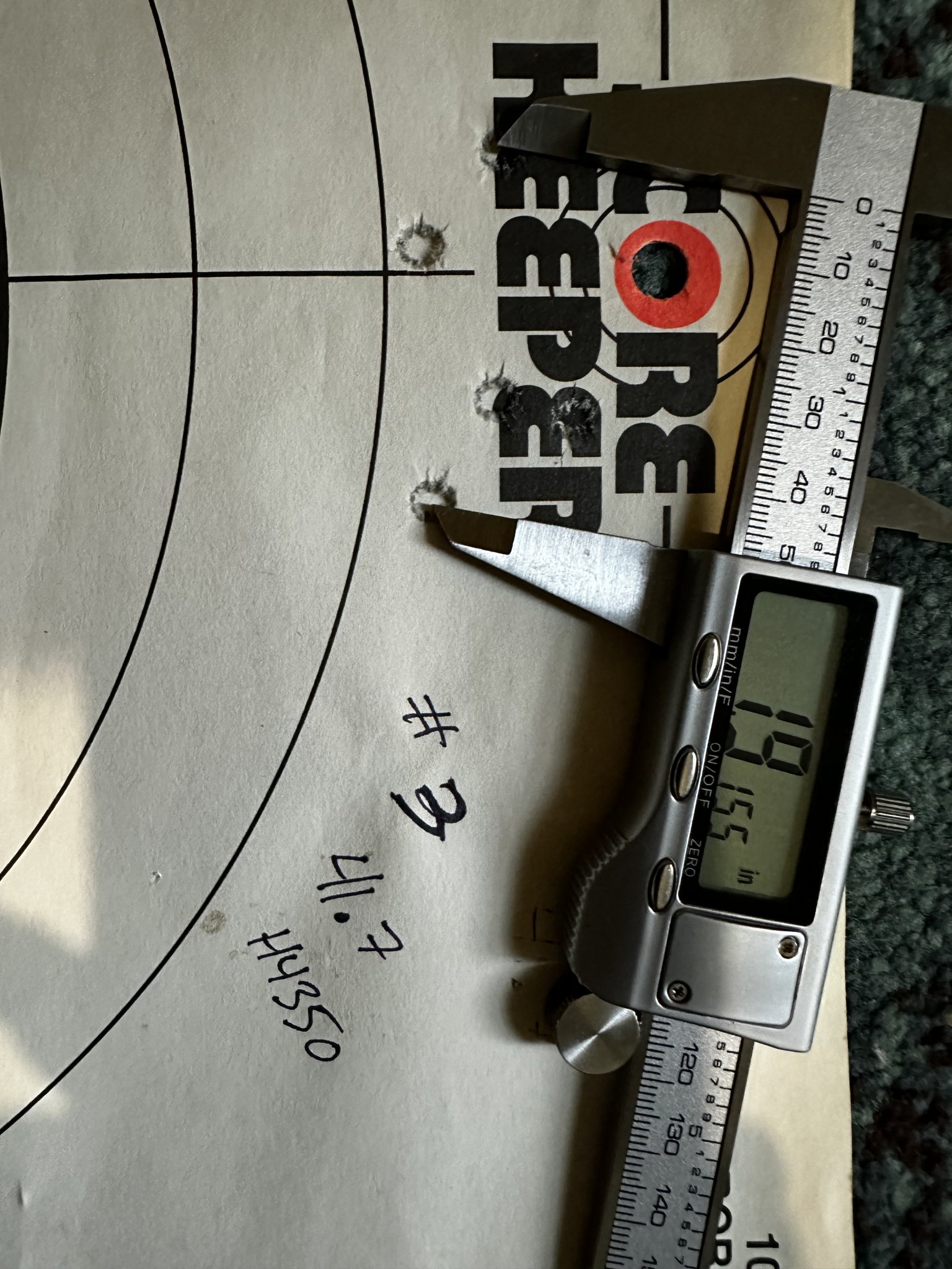

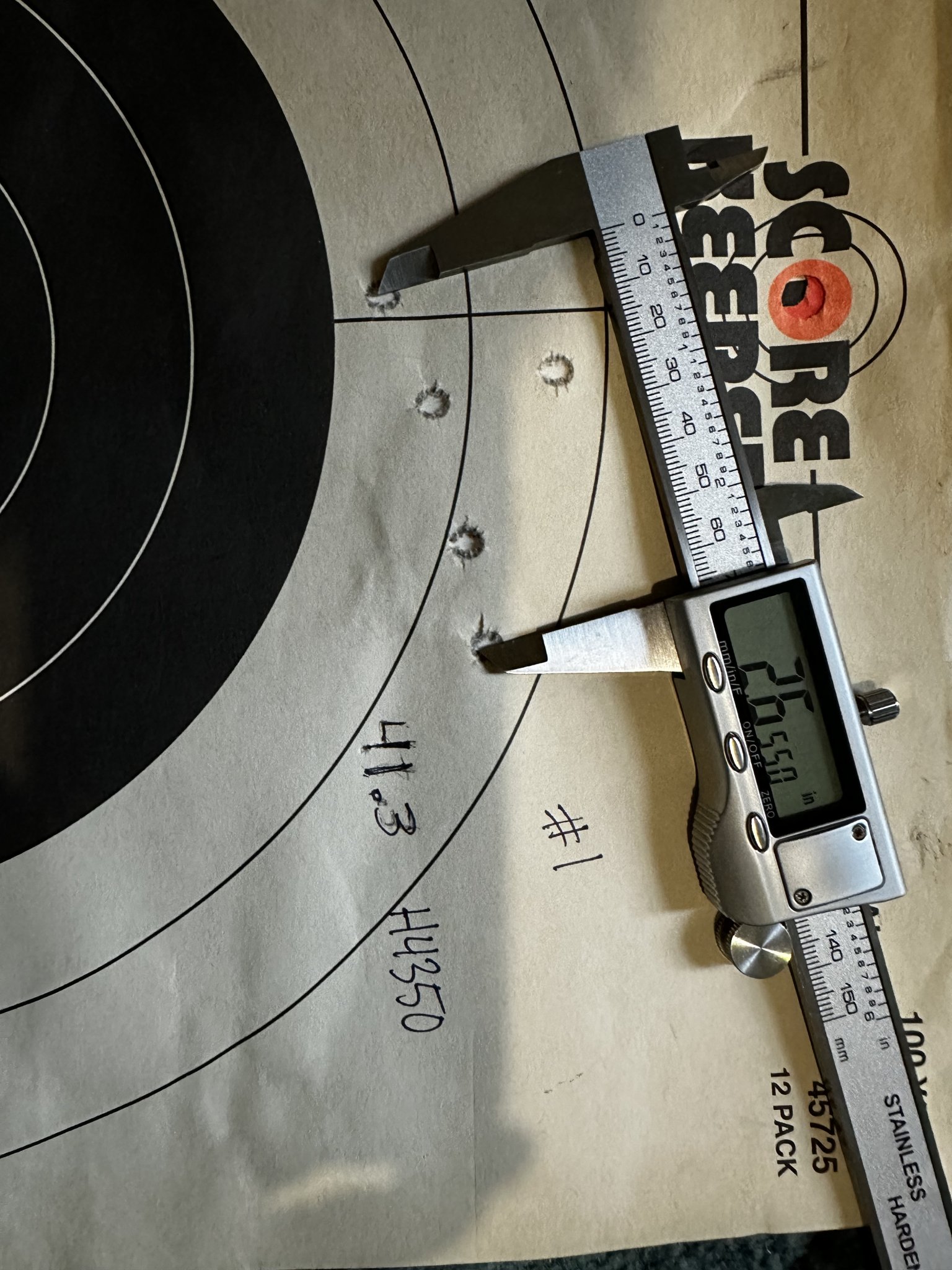

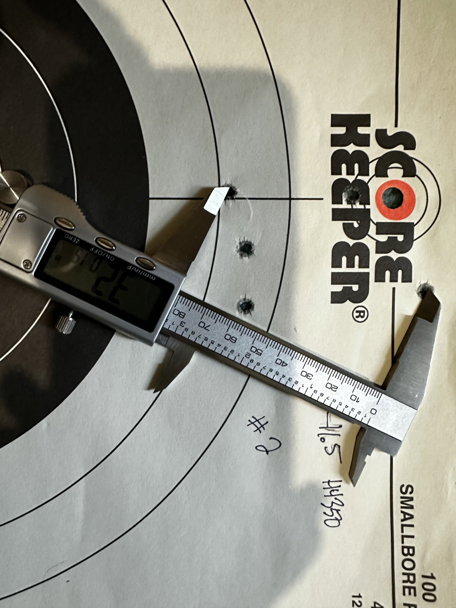

I’m working on a load up for the 147 ELD-M as we speak and could use some help from more experienced reloaders interpreting these results.
I’m running all of these loads ~0.025” OTL and the below groups were all shot at 298 yds.
I’m ruling out #1 due to the extreme ES and SD.
The #2 group size @ 3.20” is the lowest SD and ES, but is significantly larger than the #3 group which is the tightest @ 1.91” — the trouble is don’t know how to read the stringing patterns and I keep finding conflicting info.
I’m thinking about loading up another 10 of the 41.5 and 41.7 and shooting a larger sample.
You guys have thoughts? Thanks for any insight!

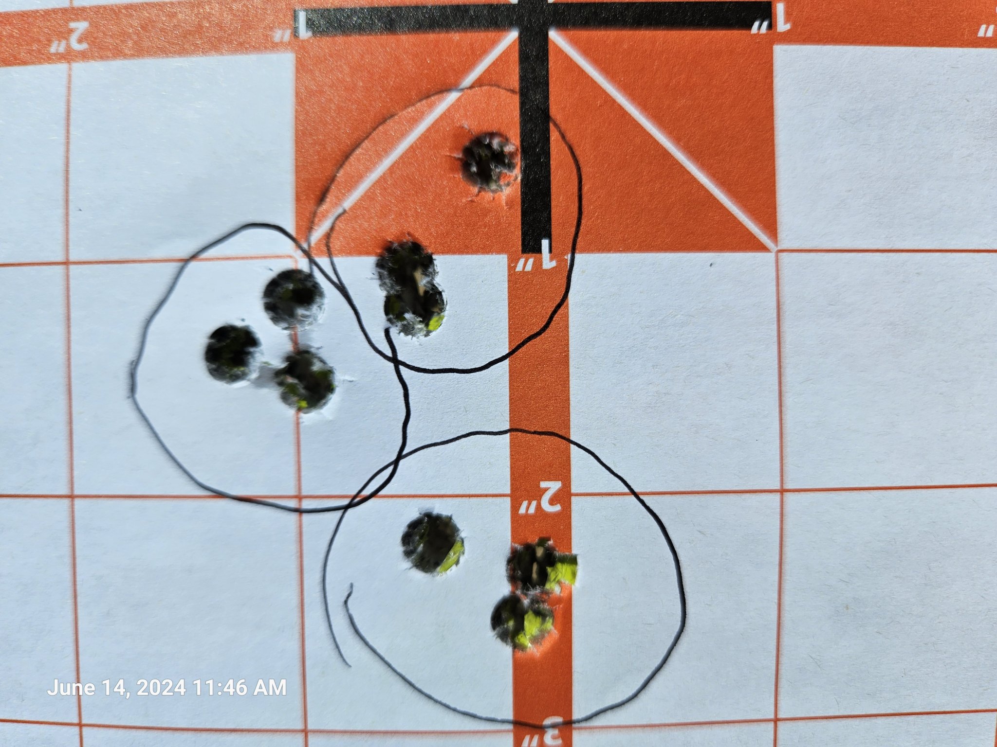

Quick update to this thread - the following load shoots really, really well in both my gas guns and bolt guns.
147 ELD-M
42.2 gn RL 16
Hornady Brass
Either Federal or CCI LRP
I went out to shoot my new CAT ODB yesterday with my 20" Proof/Xanthos/JP AR10 in 6.5 Creed and grouped 3, 3 shot groups (suppressor on, off, then back on/adjusted) with Pic attached. 2650 FPS, 6 SD, and groups measured roughly .35", .5", and .65".
Couldn't be more thrilled with the entire setup minus the Primary Arms GLX Apollo - glass just isn't very good. Time to find a new scope.
