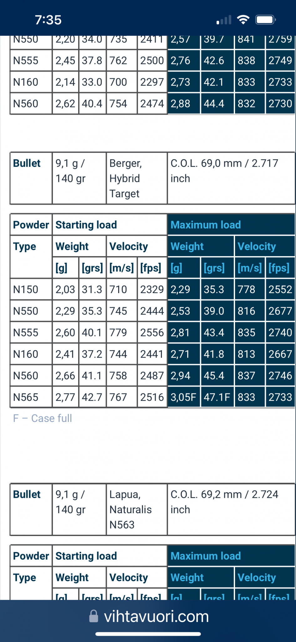

    Here’s a snap of VV’s loading guide info, the 140 hybrid is listed with N565 with a full case.
