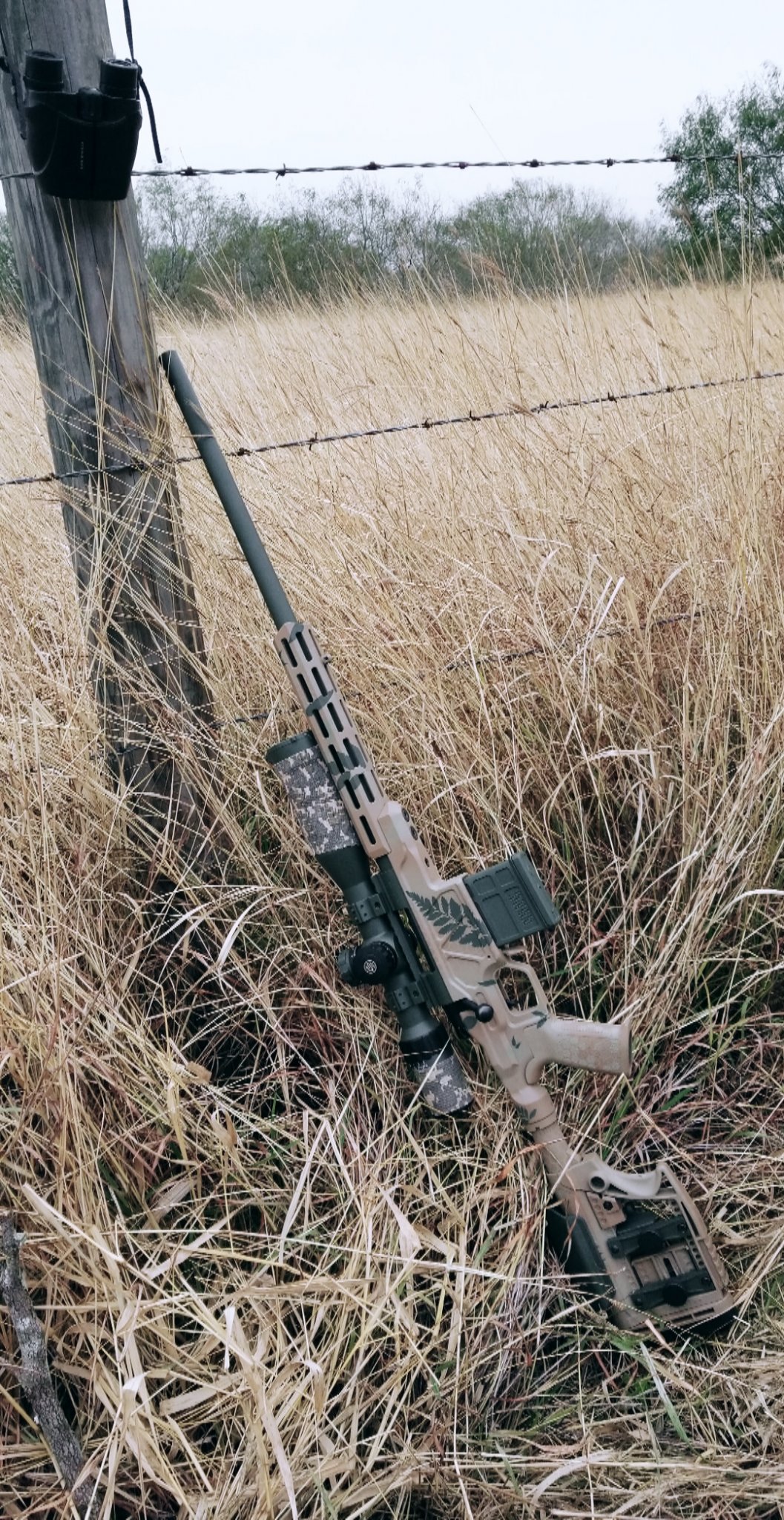

btw, that a really nice looking rifle! Why did you decide to not to use a muzzle break?
At the time I bought mine, Howas were not selling with threaded muzzle nor threaded bolt knobs. It seems now they are. If my barrel was threaded, I'd probably get a break for it but I don't feel the need for it. I hunt with it mostly and shoot steel every now and then.

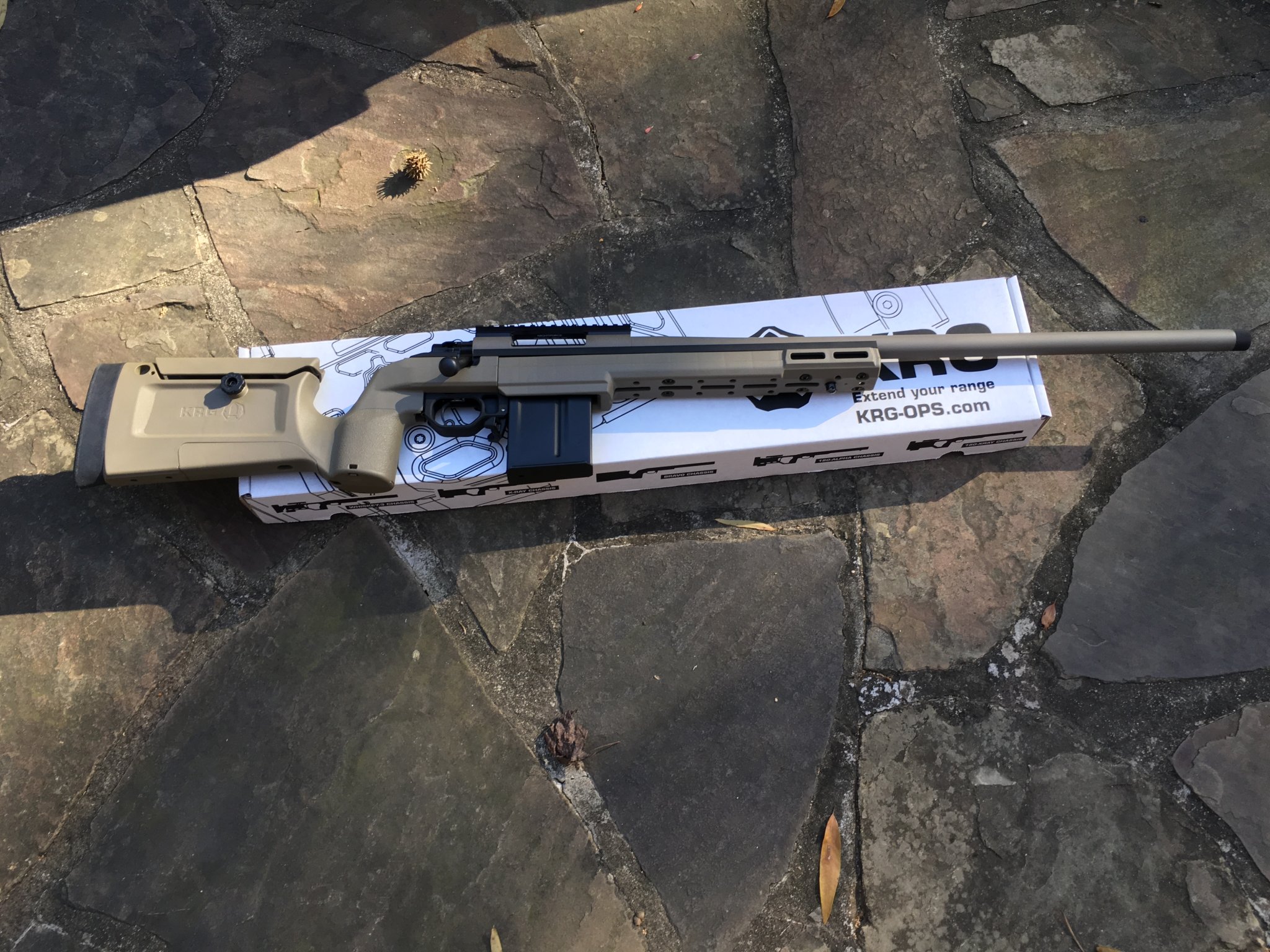

Wow, this developed quickly. I just did this build off one of the 6.5 creedmoor 1500 barreled actions from brownells but have not shot it yet and might never after falling into a deal on a multi-caliber rifle. Pretty slick setup though for right around $1k. It is a good time to be into this hobby:
It has a NF 20 moa mount.
Reactions: stello1001
This rifle is looking good. What was the deal with multi-caliber rifle?
