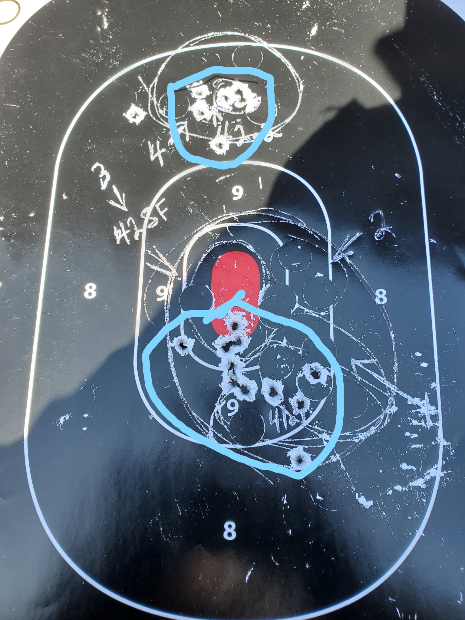

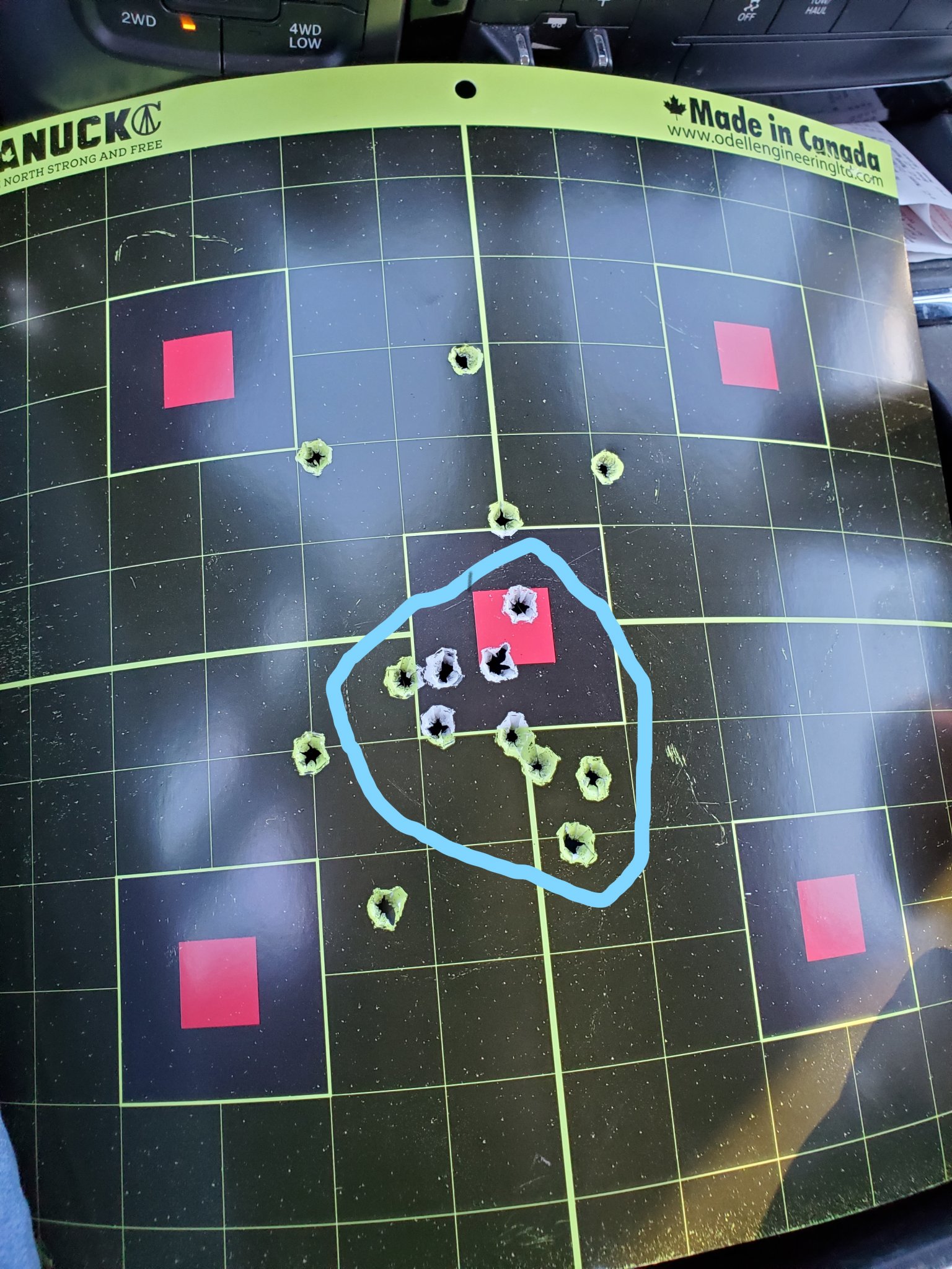

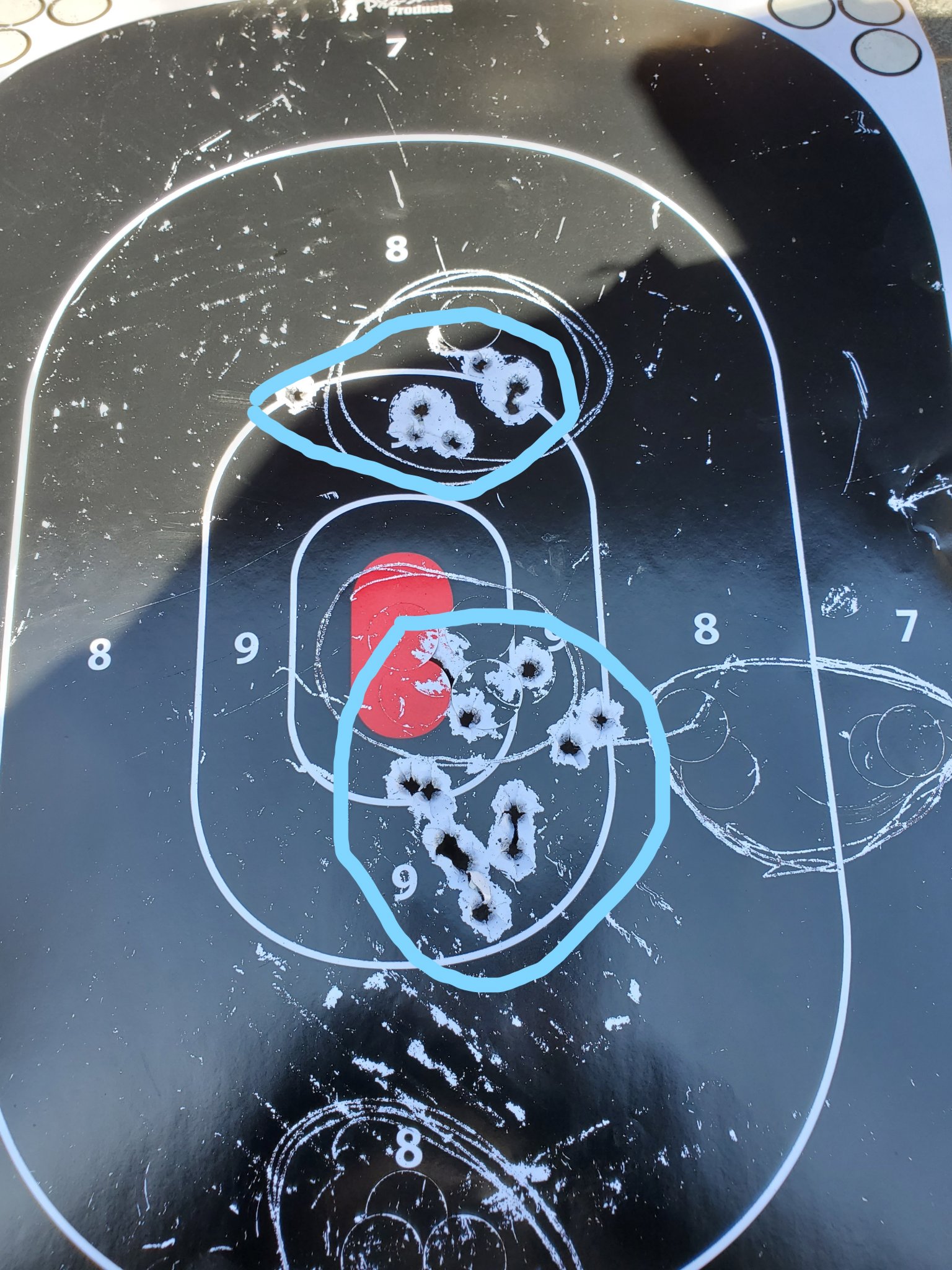

first image is 5 load group from 40.5 40.6 40.7 not bad a little low at 200yards.
second image is 5 load groups from 40.8 40.9 and 41grains on the nose.all 3 seemed to work well.
the last image is of the 40.8 40.9 and 41 grains at 400 yards the top 4 were to high on my scope settings but after a slight 1/4 moa down 40.9 and 41 grains seemed to work best with h4350 with the 140grain eld match ball at a seating length of 2.830 on the nose. what do you guys think??

I'll start by saying that I enjoy reading your postings.
It really reflects how jazzed you are about the process. Rad!
We each have our own goals and what we want to achieve.
The information we viewers share may or may not fit into what you're trying to accomplish.
You can sort it from there.
Ok, so for the pictures you posted...
Job one is max O.A.L. Did that.
Two, load development.
From this step everything you do should be to gather information for which you can better the accuracy of the load in question.
What definitive intelligence did you gain from those rounds you shot?
Your POI changed but that's not helpful unless you're inputting data into your ballistics calculator.
You had no apparent overpressure signs. That's good.
The downer is that you really didn't get anything solid as to what to develop next.
The best I can tell is that overall your groups are good for the distance and you may be completely happy with your 41.0 grain @ +.010" jump.
To keep this short.
Focus your tests.
Am I working on Charge or Jump?
Am I developing at a distance where environmental factors or my Marksmanship is giving flawed results?
During development you can waste a lot of ammo and time by blanketing rather than bracketing.
Set your goal then develop accordingly.
I'll be watching to see what your next move is.

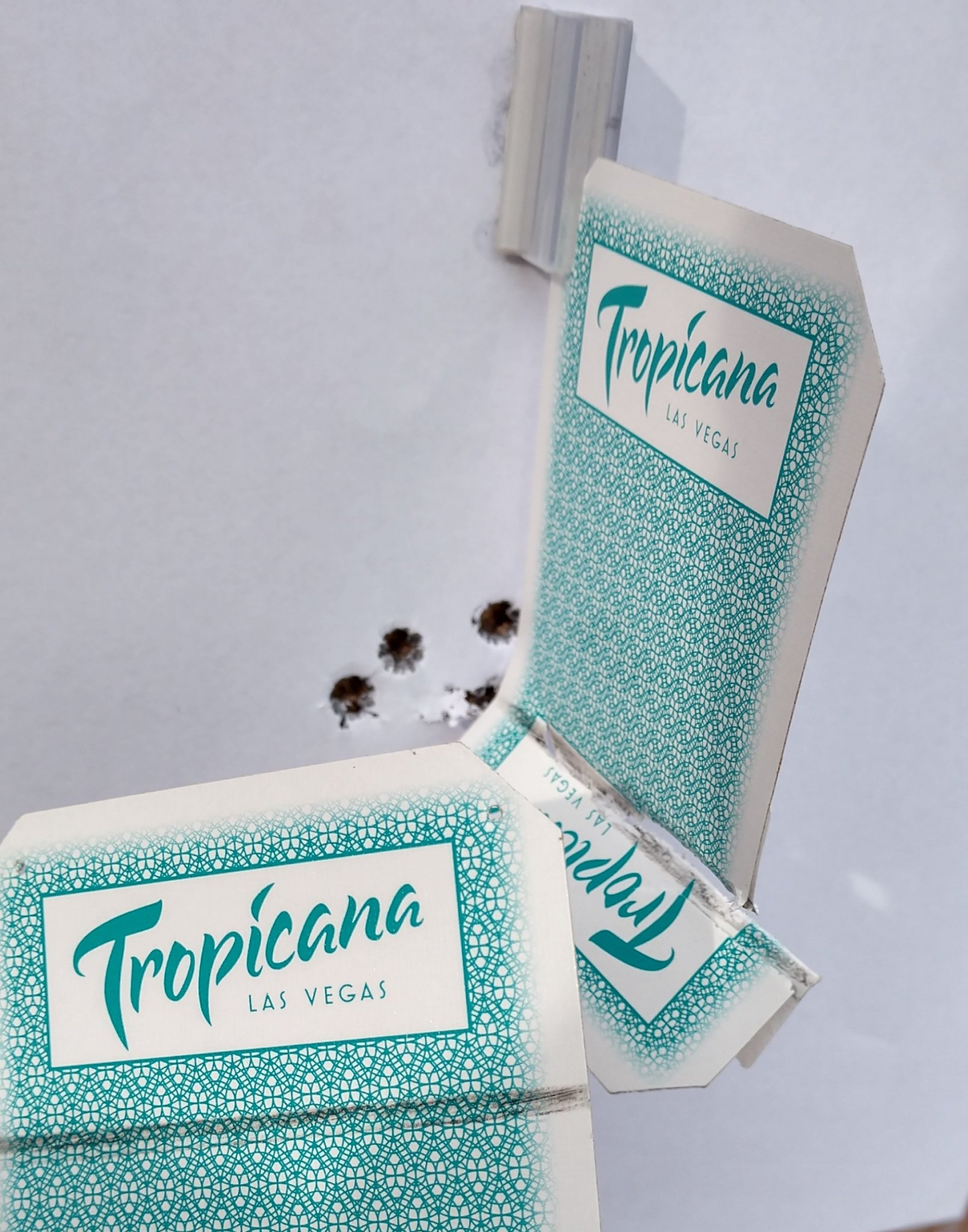

Inspired by your post I took an undeveloped load out this morning.
Two 3 round strings fired.
H4350 40.5 gr
One @ +.020" the other@ +.040".
Velo at 2707 and 2708
From here I would just correct the POI in my calculator and adjust the Drag at distance and be off safely and accurately shooting in 6 rounds.
Photo of the results.
Keep having fun!!

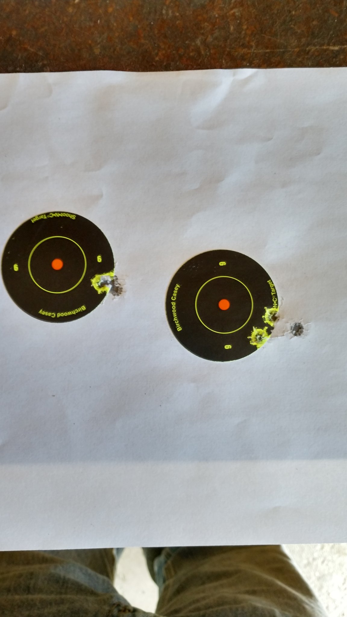

the first 2 target pictures are at 200yards. the last one was at 400yards. to clarify that

This morning I thought I would follow up on that picture I added earlier in the post.
As I said; that was the developmental load fired at 100 yards with scope turrets set to zero. 2 groups 3 rounds each.
From that I measured the mean offset of windage and elevation and inducted that into my BC.
I loaded 5 more rounds to shoot this morning.
Shooting today at 415 yards I fired 1 at 8" steel to get my axial form factor. (Drag adjustment)
After that correction and a finalization of the environmental factors I fired 4 rounds again at 415 yards in comparison to the distance you used in your jump testing.
The group size of those 4 rounds was .7990" or .1838 MOA at distance.
I split one of the cards and creased another.
In all, 11 rounds fired throughout developmental progress.
I'm not a shoot for group size guy. More of a 1st shot probability shooter.
As I said, this was inspired by following along with your post.
Best of luck and success with the new Barrel.
