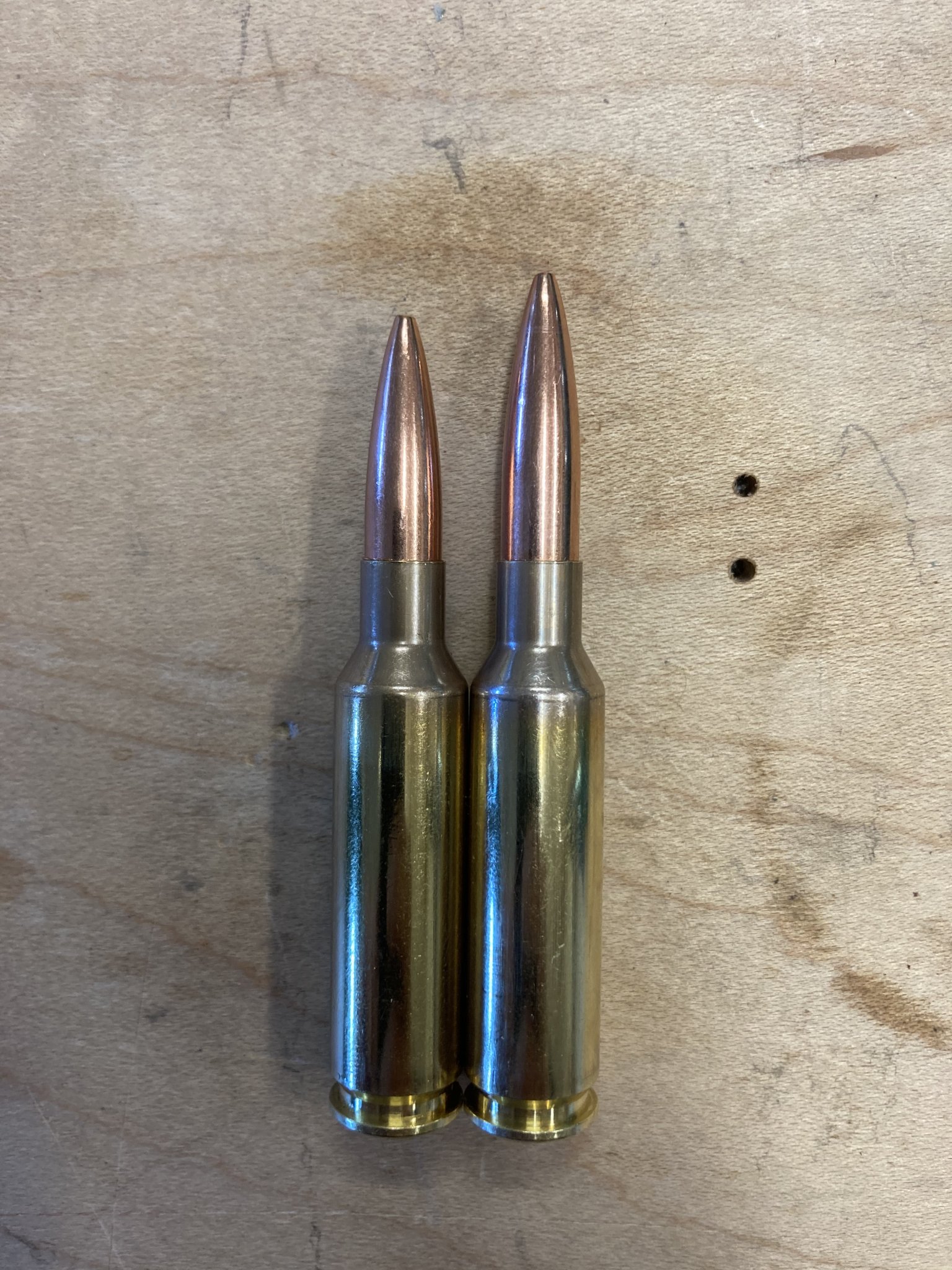

New long range reloader here. Loaded many rounds of pistol in my past to present. Now loading 6.5 CM with new Peterson LR Brass with 139gr Lapua Scenar. Snagged the OAL info off the VV reloading data which recomended 2.717". Sitting at a max load with N555 at 42.6 gr, the powder is all the way up to the shoulder in the case. I see the 139gr bullet is seated way down inside. Is this considered correct? Meaning as safe? Please reference pic. Thanks guys!

You might look at how that COAL relates to the length you need to fit in your mag. You might find you could seat them a little longer and still be in your mag/not jammed in the lands.
That pictured bullet is seated pretty deep but it’s ok if you’ve worked up to the max charge and don’t have over pressure conditions.

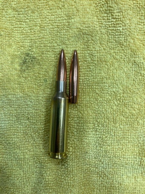

So after my revised measurement to the lands, it came to 2.867. I dialed back .020 to seat at 2.847. The first first rounds I made I seated to the OAL of 2.717 which was specified by VV powder data. Is jump at .15 a bit much and dangerous? Or can I actually shoot that? I’m very new at reloading rifle so please forgive me for all the greenhorn questions. Thanks again fellas!
It's fine to shoot.
