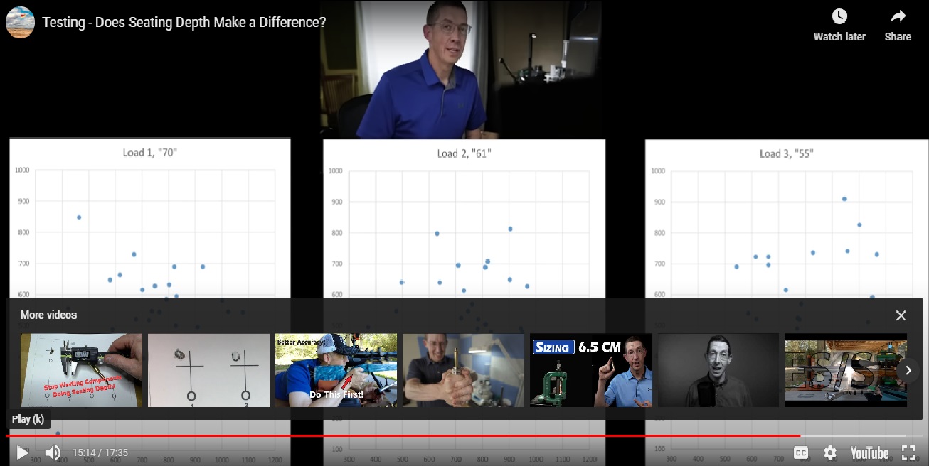

Keith has done this in 3 different jumps in 11×3-shot groups; in total jump range of 0.024'', which is quite small, but he saw the difference:

I've watched a video or three made by extremely experienced shooters (who win). The one that stood out most was (3) 30-shot tests done by Keith Glasscock with one of his F-Class rifles. In it, he explored some of his loads based off seating depth and he - as an engineer IIRC - put a lot of statistical emphasis and data into the presentation - even to include that his samples were too small. I was almost completely sold on the idea that I was just the victim of 'random sample' chasing, until I realized that his three sample groups covered a grand total of .............. .015" seating depth difference. Then it made a lot more sense. I would love to see his results if he did that test again covering another .030".
I think it was only .015", as that is how he labeled his data in quotations. But I've been wrong before.

diggler 1833: thank you for clarifying the total range of jump. I only find Keith's statement: ''Load #1 was .009" from load #2 and .015" from load #3.'', so I thought that maximum total difference jump can be 0.024'', but in reality is probably 0.015''.
