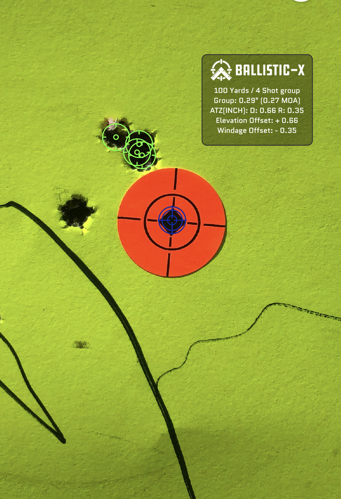

Just broke in a Barrett Fieldcraft 6.5 today. Shot the factory 143eldx with average 2650 for a brand new barrel.... oh and it’s a shooter!! Shots 5-9 on this new barrel. The First four stacked in there tight but pulled the fifth, it might have been barrel heating up as all shots were within 2 minutes with a skinny barrel.
